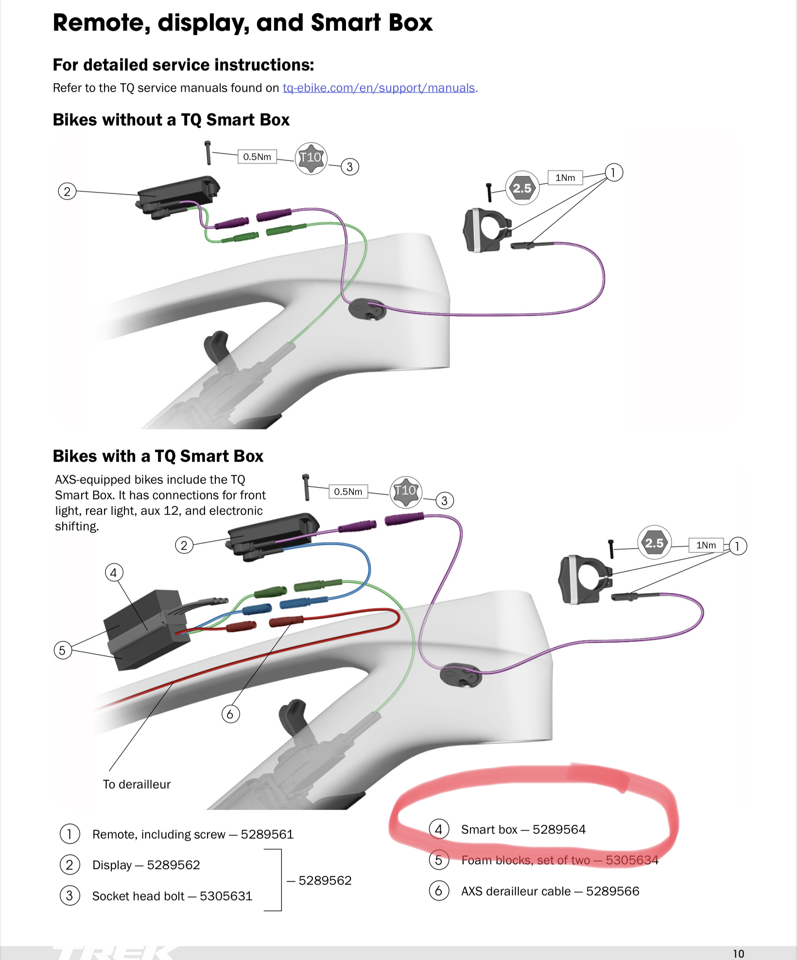

I'm looking to retrofit the AXS system but I'd love to have it powered from the main battery. I can't seem to find the part number for the AXS add-on for the battery, does anyone have it?
DBSwiss
Oct 25, 2022
108
88
United States
Pretty sure you would use the smart box
