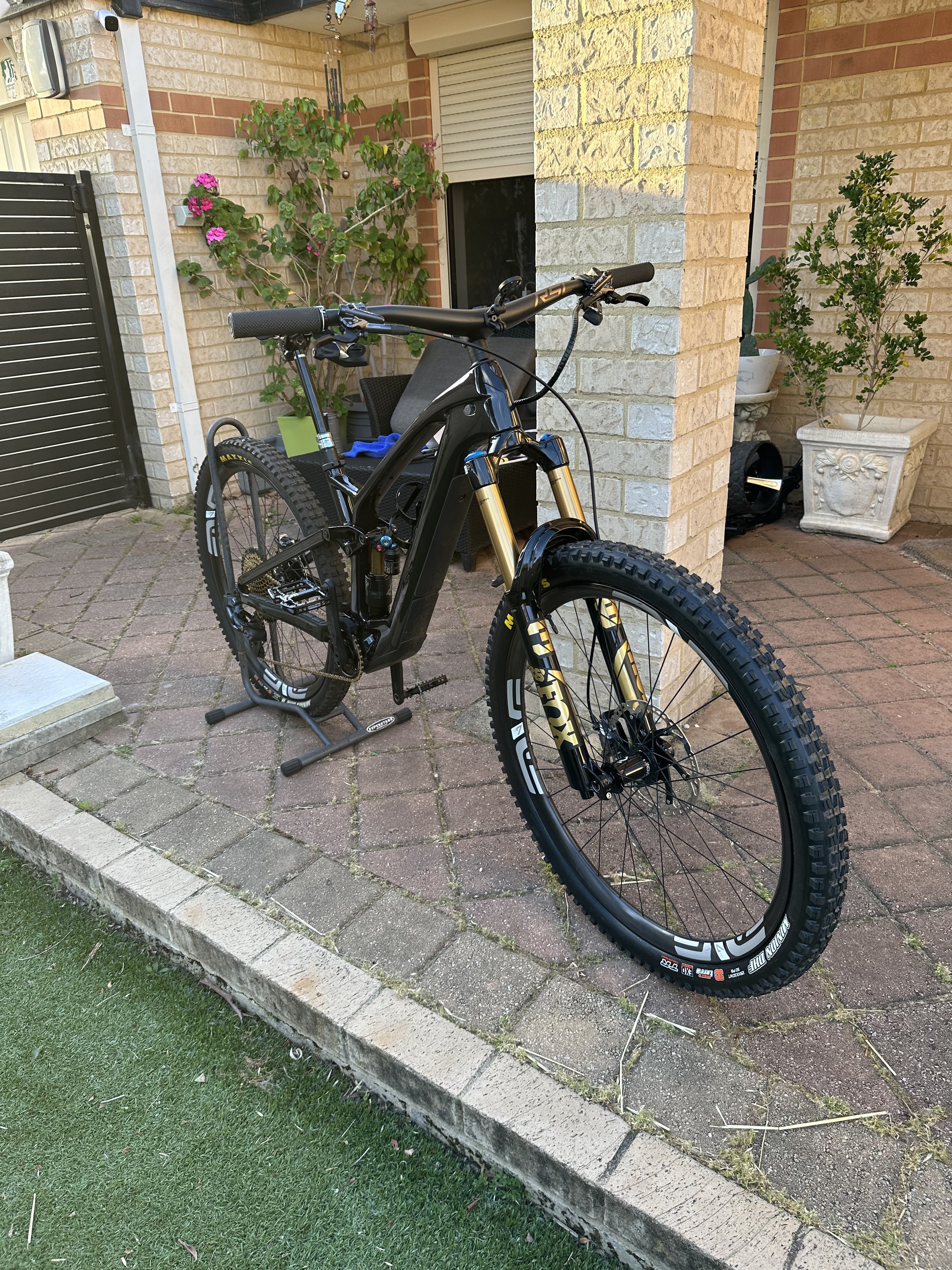

My size large 9.5 just arrived, stock without pedals it weighs a couple of grams over 20kg.
Interestingly, it came with the shimano deore 4 pot brakes, I was expecting tektro 4 pots, so thats a pleasant surprise. And it also came with a shimano xt derailuer, when the spec sheet says it should come with a deore derailluer.
Anyway, it will stay stock except for
-fox 38 fork
- raceface next r bars
-raceface turbine stem
- sram axs gears
- maxxis assegai exo + & maxxis dhri doubledown tyres
I'll wear the cassette out and replace with something a lot lighter, I may swap the wheels for my dt swiss hx 1501 set.
edit: heres a quick pic with the forks ,bars, and mech fitted, apologies for the scruffy garage
So just to follow up on this, with the above fitted, plus some one up alu pedals, the bike weighs in at 20.3kg.
The hub on the wheels that came with my 9.5 is a shimano HG freehub (not microspline or sram XD) and it comes with a sunrace cassette that weighs a ton (650g) - I'll swap this when its worn out. Then total bike weight should just sneak in under 20kg.
Not sure if its possible to swap the freehub for an XD or microspline hub, I would presume not.
Does anyone know how you get into the setup menu on the TQ display to swap between KM and miles etc? I've read the manual and it says to hold down the power button plus down on the remote for 5 seconds, but all this does is bring up some kind of error display - I must be doing it wrong - so can someone explain the technique?
edit : i Have worked out how to get into the setup mode, the TQ manual is wrong, the manual says to turn off the bike, then hold down the power button and the down button for 5 seconds, this is incorrect, you need to start with the bike turned on, then hold down power + down for 5 seconds.

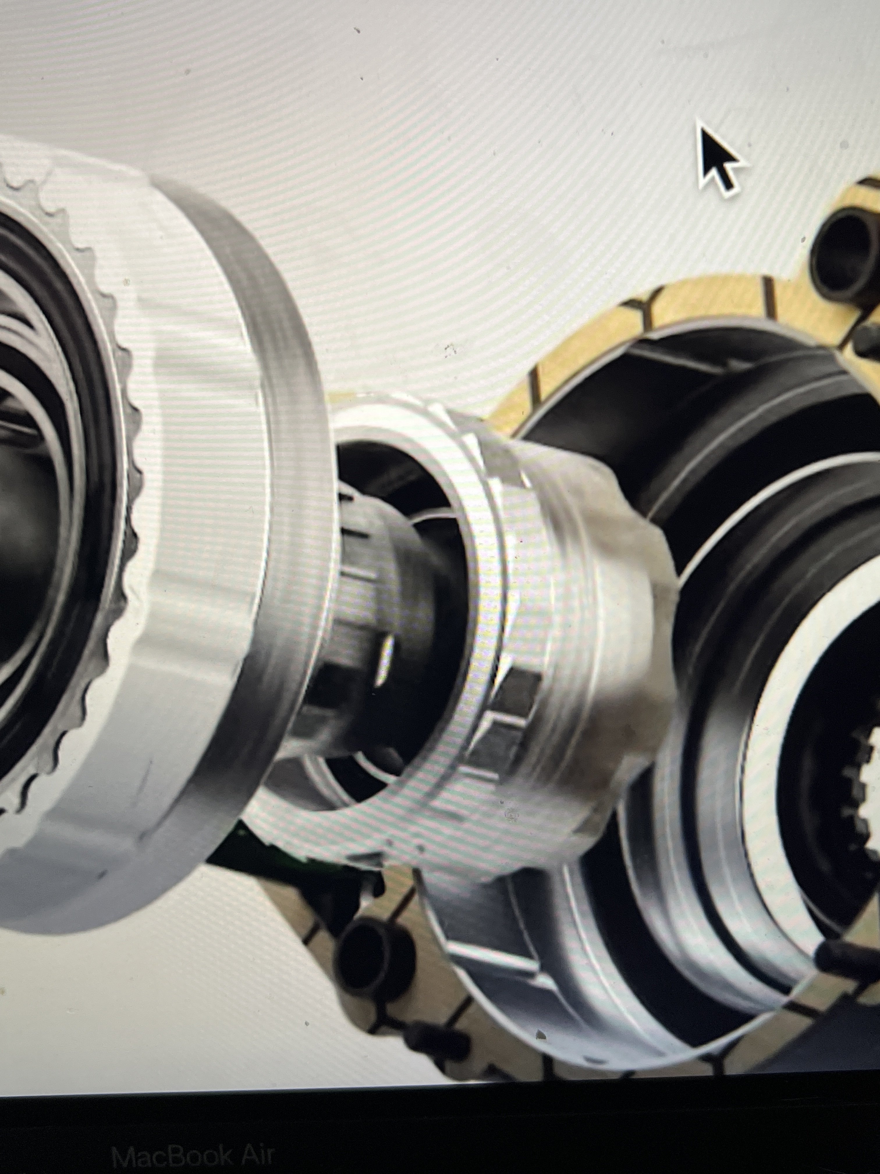

Why not sharing your method here?So everyone that owns one can check on their own bike and share results.
OK, I''ve just now figured the factors that produce the grind sound, for me. Any time, and for me every time, the pedal rate and force i apply on the crank fall below what's needed to activate the motor, the grind sound occurs. For example this will occur while riding on a level surface in a middle gear at a middle speed and starting to coast. When coming out of the coast and starting to pedal, and before applying any real force to the crank, just when you're peddling , kind of free peddling without resistance, the grinding sound will occur. Once you increase your pedal rate and force enough to actually apply some torque to the crank, and I think, turning on the motor, the grind will go away. If you are leisurely coming out of the coast the grind may last for two or three strokes. If you are rapidly coming out of the coast and apply torque rather immediately the grind will not occur at all. If you take your time coming out of the coast and keep no force on the pedals, or very little force on the pedals for an extended period of time the grind will last indefinitely. The grind happens every time I'm coasting into an uphill slope and starting to re-pedal, again lasting as long as it takes for my pedal rate to catch up with the speed of the bike. This may take a half stroke or two strokes. Today after establishing this "undermatching " idea I was able to reproduce the grind by simply pedaling along at grade and slightly backing off on the torque but continuing to pedal with almost no torque and the grind with occur essentially without coasting significantly.
My current thinking is that the Sprag gear mechanism in the motor housing is not engaging or disengaging completely at these times.
Earlier on I told someone this sounded like a plastic gear meshing sound to me.
As I look at the exploded views of the motor it looks to me like there are a couple of ring gears that have ramps on them. one looks like it is plastic, and I'm not talking about the harmonic ring gear that is definitely plastic. I will look at them again now but my memory is they had about 30 little ramps on each gear..... I just looked at it again and it looks like neither of those gears is plastic. The outer bigger gear is looks like it has about 22 points of engagement the inner one looks like it may have 16. My naïve impression is that it's one of these two gears that's making the sound
I listened to the grind carefully today while riding, especially since I can now reproduce it 100% of the time, and I think the frequency of the grind is the same as one of the barely audible frequencies of the motor itself when it's working normally.
When the motor is completely off , I'm not able to produce any of this stuff.
I will try to attach the exploded view of the motor and a video of my grind sound to this reply but I probably won't be successful with that.. A search on YouTube "Trek TQ motor noise " has several recordings.
As I look at the exploded views of the motor it looks to me like there are a couple of ring gears that have ramps on them. one looks like it is plastic, and I'm not talking about the harmonic ring gear that is definitely plastic. I will look at them again now but my memory is they had about 30 little ramps on each gear..... I just looked at it again and it looks like neither of those gears is plastic. The outer bigger gear is looks like it has about 22 points of engagement the inner one looks like it may have 16. My naïve impression is that it's one of these two gears itha's making the sound
I listened to it , the grind ,carefully today while riding, especially since I can now reproduce it 100% of the time, and I think the frequency of the grind is the same as one the barely audible frequencies of the motor itself when it's working normally.
I will try to attach the exploded view of the motor and a video of my grind sound to this reply but I probably won't be successful with that.. A search on YouTube Trek TiQ motor noise has several recordings

By the way, my grind is independent of gear, independent bike speed, independent of motor mode, except when the motor is off, It is definitely a mechanical sound and depends on the crank being turned, and only when the electrical system is on.
This may be true of only a few motors, or it may be true of a lot of motors but maybe For most ridersf the “under matching “ “occurs infrequently enough, or is of short enough duration, that it’s not noticed.
For me it occurs every time I stop peddling for a second or two, and then restart, but I can’t hear it when I’m on gravel or in leaves
I hope I haven’t caused a lot of people to start paying attention to this and opened a bag of worms.

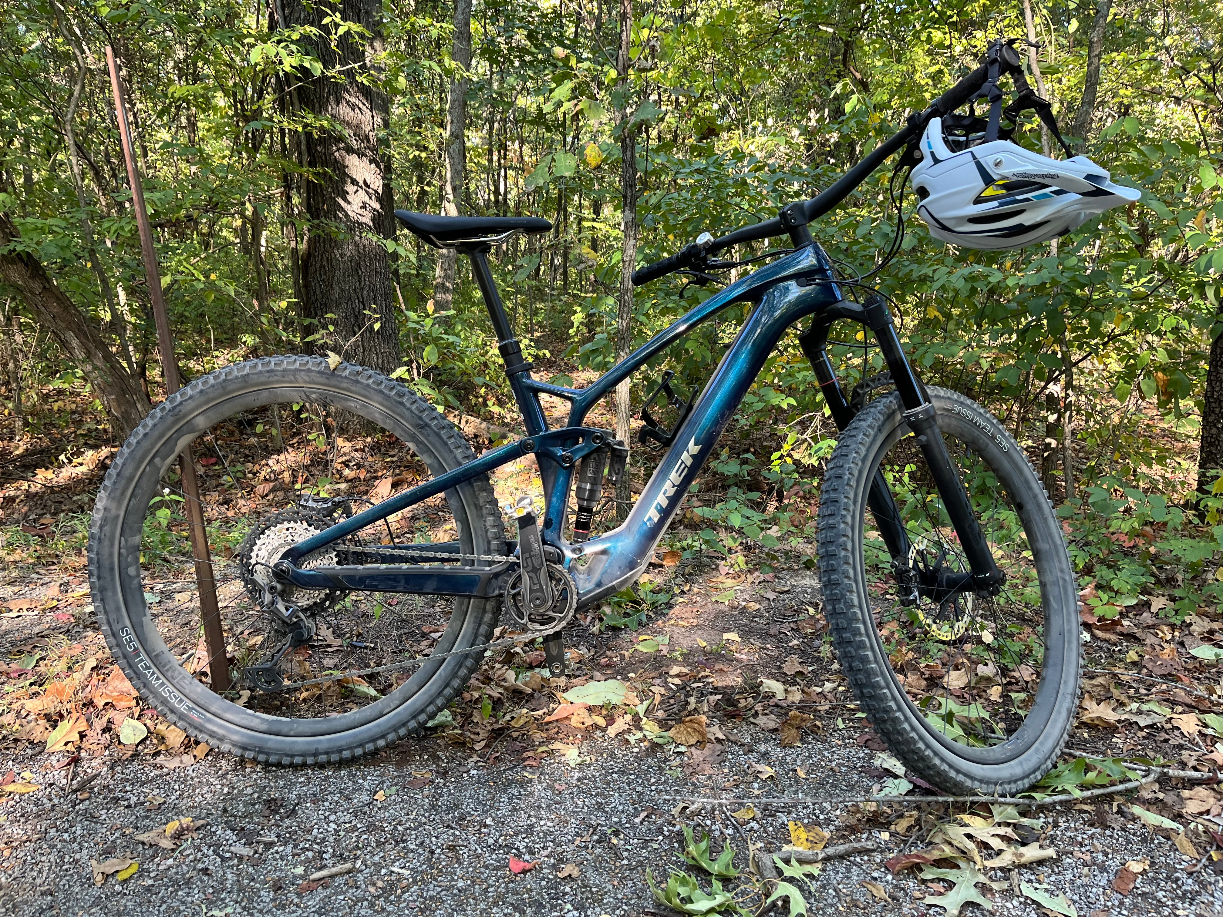

Originally I had a test ride on a stock M and it felt too small (I’m 175cm) and too XC for my tastes, but my hunch that sizing up to a L with the smaller rear wheel and shorter stem might be perfect- and it is!
So here’s mine, a 9.8 xt, L, with the following upgrades;
NOBL TR37 wheelset, mullet, king hubs, Maxxis DHF front/DHR DD rear
OneUp carbon Bars
RaceFace Atlas 32mm stem and pedals
After these pics I put on a wolftooth remote and shrink-wrapped the cables
160mm airshaft going in Friday
First ride was 33km/1200m vert, all singletrack climbing to black and dbl-black descents. I was happy to keep it in Eco for most all of the climbing and was so impressed on the descents. I’m used to a 170mm Fox 38 with a DHX coil rear (160) - the stock 2023 Rockshox spec didn’t give up anything. Trek and Rockshow nailed the suspension.
As we all know, the motor is amazing.
Getting a magnet on the Centerlock King hubs has been a challenge. Work in progress.
