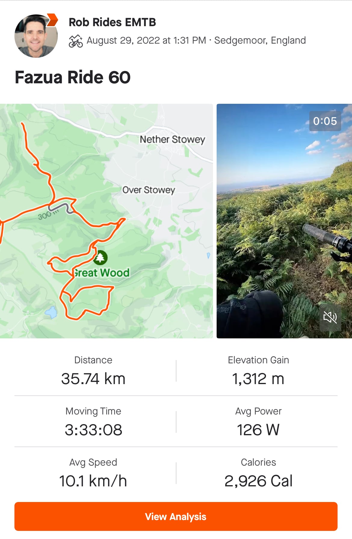

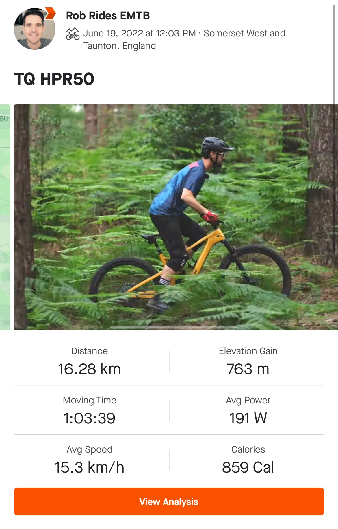

The efficiency of the TQ isn't impressive. 750 meters of elevation vs 1200-1300 meters on the Fazua. Adjustering for the bigger battery, the Fazua is 40% more efficient in your test. Almost unbelievable.
Here’s the Strava data. The TQ was with original tyres too.

View attachment 100361 View attachment 100362
Those Numbers are crazy. TQ and Trek really dropped the ball on the range. The TQ motor is really inefficient. My Rise with the EP8 RS had noticeably more power and range than my EXe. It sounds like the Fazua Ride 60 has better range and power as well. I am ok with the power delivery of the EXe, I didn’t expect the 50 nm motor to be as powerful as a 60 nm motor. The range performance really bothers me. There is no way the EXe should get less range than the Rise, given less power and same size battery. The range is my only complaint about the EXe. Everything else is incredible.
You really went 1,300 meters elevation, all in full power (boost, turbo or whatever they call it)? If so, that is truly incredible and Has me questioning my Trek purchase.
The average speed of the tq ride is 50% faster than the fazua ride, that would drain the battery on the tq quicker for every meter of height gained,wouldn't it?
And knuts test of the tq motor on the front page of the site gave it similar height gain figures to the ep8 rs in the rise.

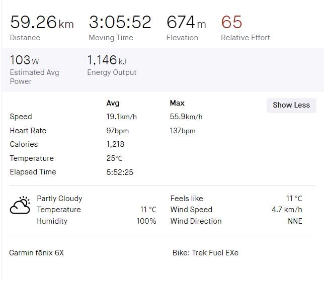

Although I have no doubts about Rob's testing in relation to meters climbed compared to the Fazua, to be fair, they were completely different rides. A real comparison would be the same climb back to back with the two bike systems. As a third comparison, below is my ride from yesterday on my exe. There was a lot of flat bitumen on this ride hence the decent average speed but I didn't need to work particularly hard (as seen by my heart rate) to achieve close to 60km and 674 metres of elevation. Again a completely different type of ride (80% paved, 20% dirt)
Looking at the efficiency specs of both motors, the TQ is rated at greater then 90% and the Ride 60 at approx 80%. based on this the TQ is rated at 324Whr to crank and the Ride 60 360 Whr to the crank. This gives the Ride 60 a 10% advantage.
I think bottom line, no one should be disappointed with either one of these systems. No doubt we are in a golden age of ebikes.
