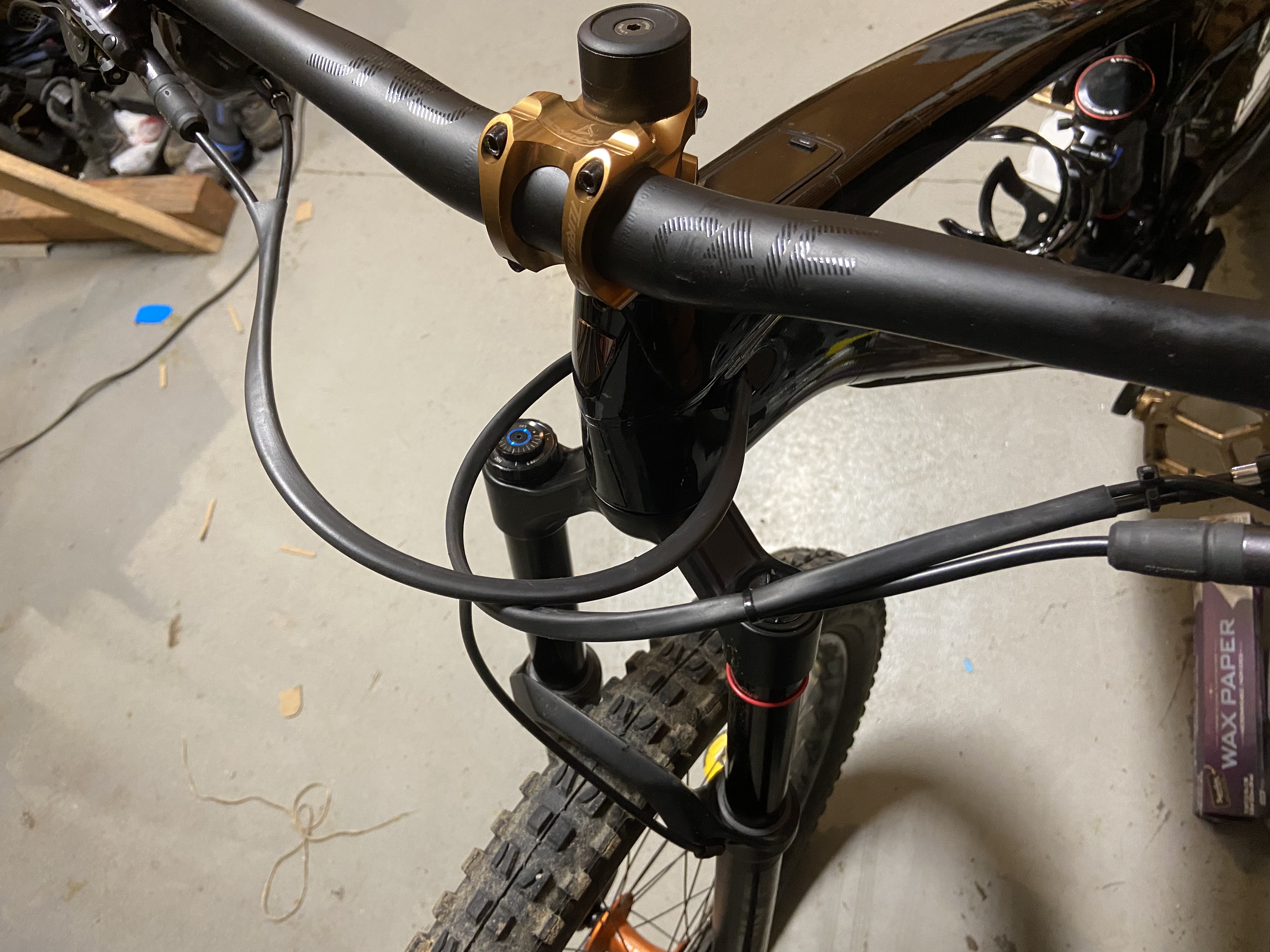

BB is at 338mm (13.3”) with the 150mm lyrik, 27.5x2.4dhr (r) and 29x2.6dhf (f).
Check out my heat-shrinked cables!
That looks great! 338mm with 27.5 in the rear is perfectly acceptable. Granted, the Lyrik Axle to crown is 4-5mm higher than the Fox, so you are basically running a 155mm Fox 36 (splitting hairs!).
I have tried a reversed offset bushing in the lower mount, and it lifts the BB by 5mm, so that is always an option, if you can keep it from rotating!
