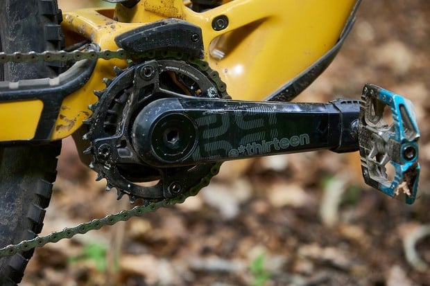

Get your chainring torque checked owners. After two rides this weekend I had major creaking from the BB. After my ride yesterday I felt the chainring was a bit loose by moving it with my hand.
When the cranks were removed the chainring was hardly hand tight.
My bike has the 30nm stamp on it but the serial (still speculation) suggests it's one of the newer models that got torqued properly from the factory.
Torqued it to 50nm this morning and all good now!
Same here. Pull, loctite, and torque out of the box, regardless of time of purchase. And if you do this kind of thIng yourself, be aware that you'll likely need some new (but inexpensive) tools if you haven't dealt with ISIS before.

My left side (non drive) crank came loose on the trails this weekend. Right after a jumpy descent. Very lucky nothing bad happened. I noticed a weird grind on my next climb and when I looked down the crank was almost off. Luckily the bolt never fell out.
So get yours checked. The torque spec on the cranks is 40nm (yes it's a lot).
I added some blue loctite to mine for peace of mind. Was a scary situation.
