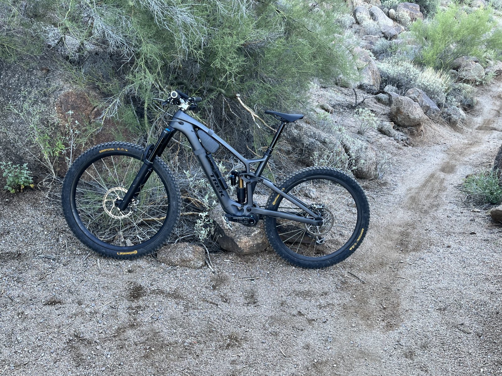

Love this bike more every time I ride it. Such smooth power delivery and the motor is still silent.

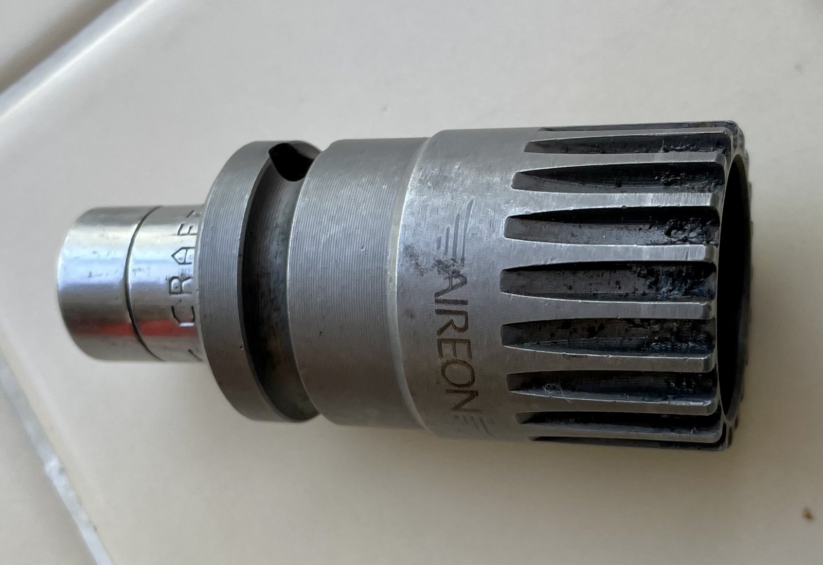

What tool tightens the lock ring?
any 20-spline bottom bracket type tool will work
Park Tool BBT-22 is a good one
I use the same old tool I used for Race Face cinch lock rings -
Be sure to check yours!!!
the locking on my 9.7 was coming loose, estimate ~10Nm
mrs levity's was very loose, less than I'd tighten stem bolts :eek:
and be sure to snug up the crank retainer bolt, 30+ Nm
all good now

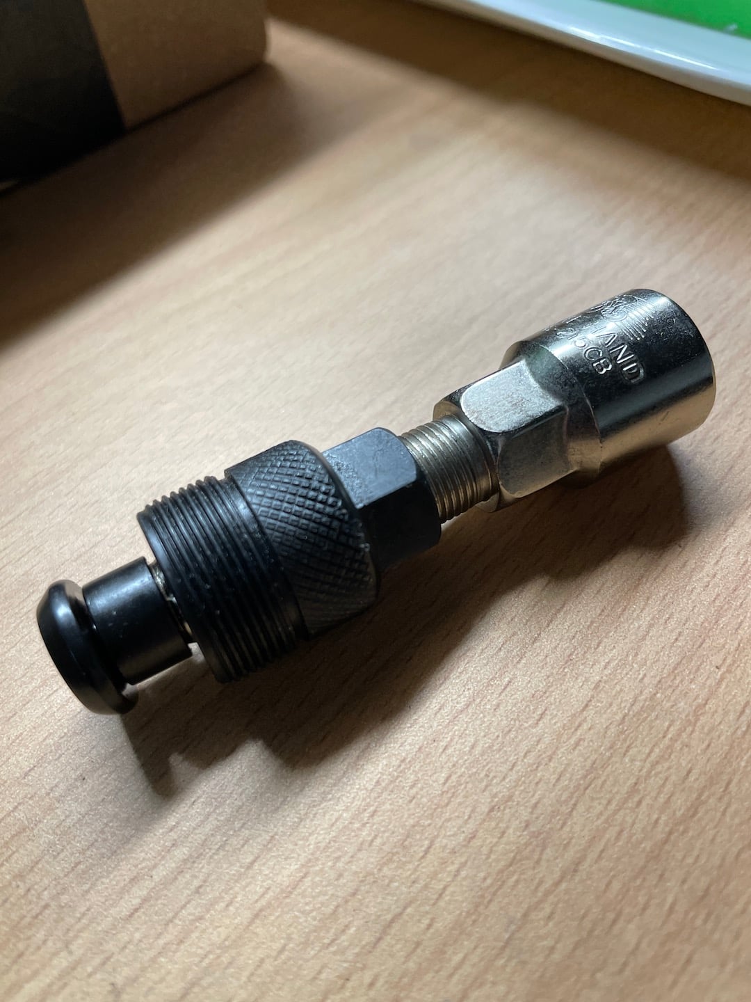

Don't forget that you will need a crank extractor to get to the lockring. Park CCP-44 (or the one without the handle). Then you can tighten with a BBT-22.
I believe all the EXe-ISIS cranks have extractors built in. So you should only need a big hex key and a torque wrench. (be sure its a torque wrench that also works in LEFT HAND threads)
Nope. At least the 9.7 doesn’t.
You’ll need a crank extractor like the one @DancingWithMyself mentioned above.
Still, it’s an easy 10 min job.

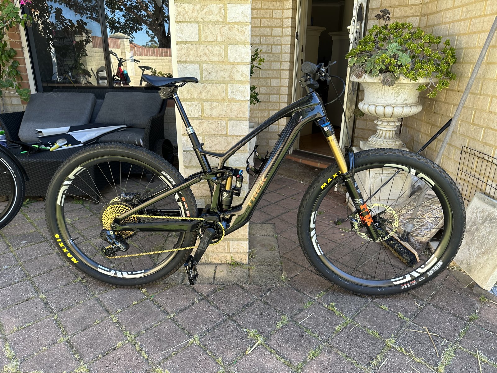

So I have a 9.5 in black turning up next week, and the intention is to swap out some of the lower end components with better stuff that I have lying around/fitted to other bikes.
The bike comes with a rockshox gold 35rl fork that has an axle to crown length of 567mm for the 150mm travel fork.
I have the option of fitting either a fox 36 ebike factory 160mm fork that has a 567mm axle to crown, or a fox 38 factory 170mm fork that has a 577mm axle to crown length. I'm tempted to just go with the 170mm 38, but I wonder whether its overkill and I should just put the 36 160mm fork on it and save a bit of weight.
I think at 170 it’s a bit out of balance unless you increase the rear travel, here is mine with 170 we fitted a 160 air shaft yesterday which is much better.

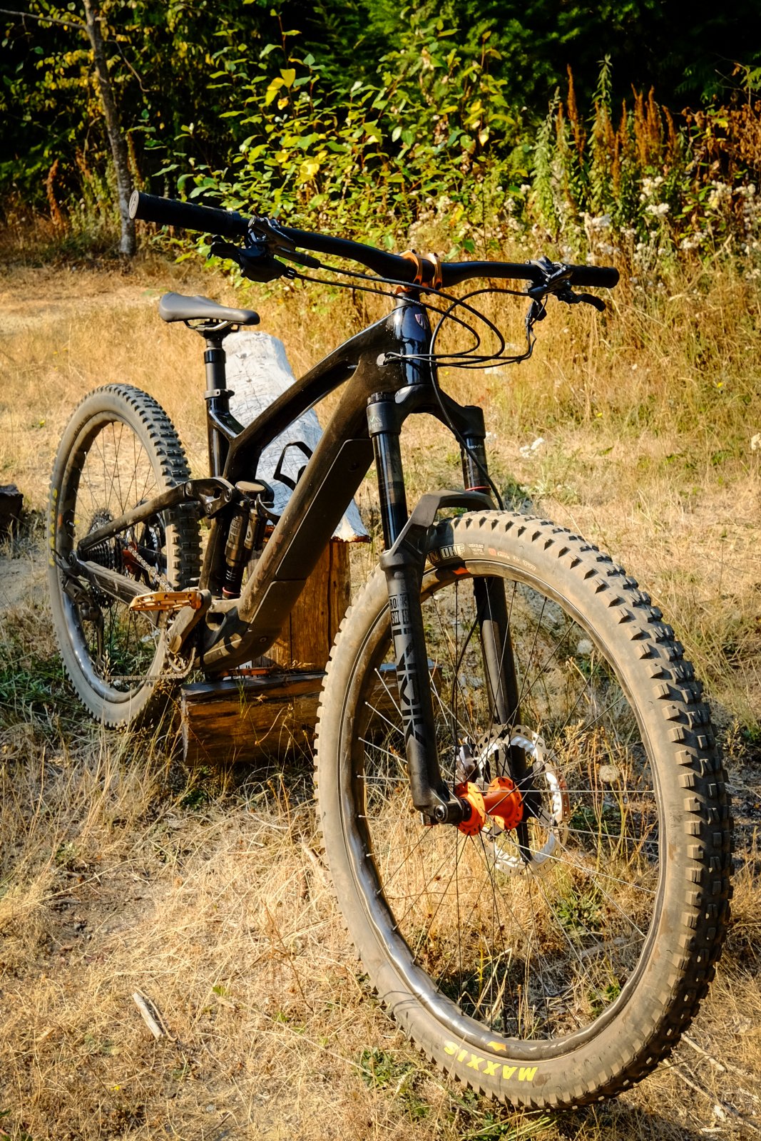

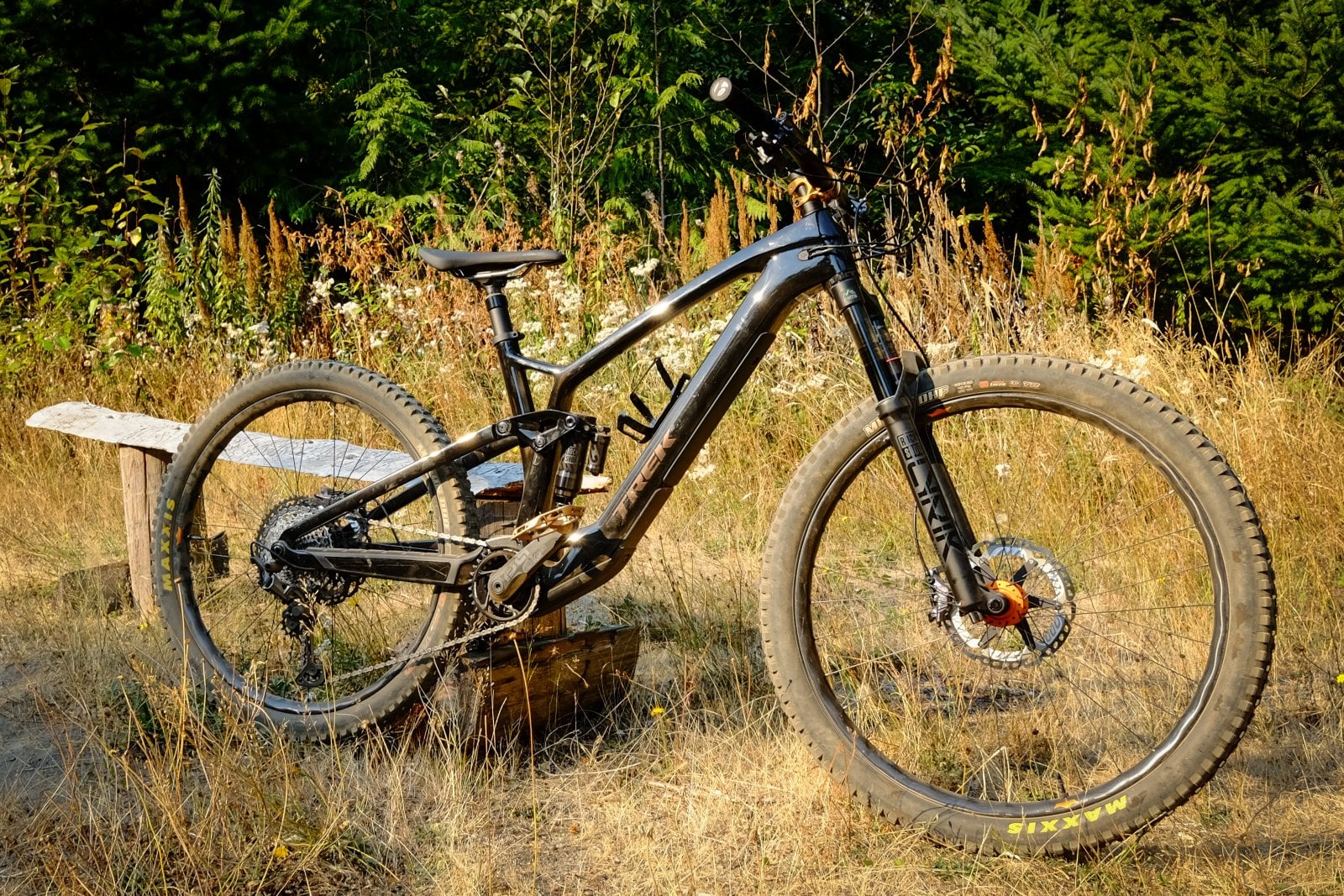

Originally I had a test ride on a stock M and it felt too small (I’m 175cm) and too XC for my tastes, but my hunch that sizing up to a L with the smaller rear wheel and shorter stem might be perfect- and it is!
So here’s mine, a 9.8 xt, L, with the following upgrades;
NOBL TR37 wheelset, mullet, king hubs, Maxxis DHF front/DHR DD rear
OneUp carbon Bars
RaceFace Atlas 32mm stem and pedals
After these pics I put on a wolftooth remote and shrink-wrapped the cables
160mm airshaft going in Friday
First ride was 33km/1200m vert, all singletrack climbing to black and dbl-black descents. I was happy to keep it in Eco for most all of the climbing and was so impressed on the descents. I’m used to a 170mm Fox 38 with a DHX coil rear (160) - the stock 2023 Rockshox spec didn’t give up anything. Trek and Rockshow nailed the suspension.
As we all know, the motor is amazing.

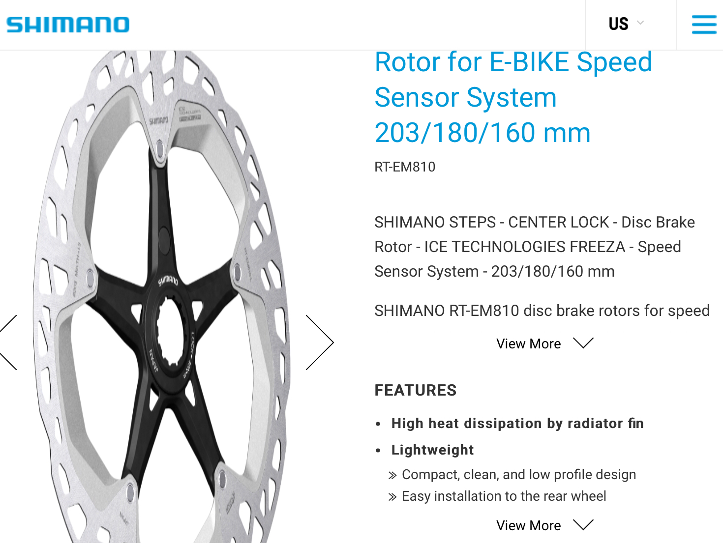

Getting a magnet on the Centerlock King hubs has been a challenge. Work in progress.
15EF79AE-6D58-4A1E-A620-591D3DDB4CD3.jpeg 15341700-8776-4A0C-BD7E-06F7FE3EB0AB.jpeg 9FB8FB68-D35A-44F4-AC94-95A03DD8D41E.jpeg

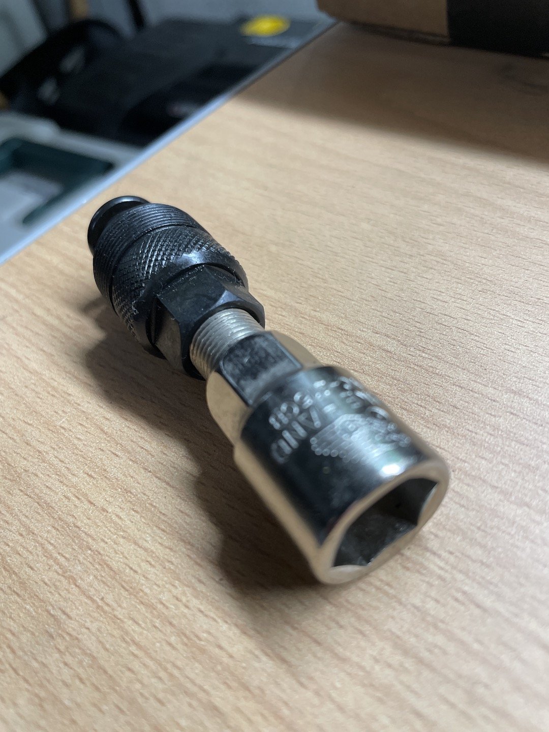

Is the CCP-44 Crank Extractor similar to these attached photos just without the handle?
View attachment 99585 View attachment 99586
I'm not the best person to answer since the EXe is the first time I've ever owned a crankset that needed an extractor, but there is an extractor that is the same size just without the handle. However, there are other extractors with different ODs that fit different cranks. Just make sure you have or get one with the right OD that will fit the cranks on the EXe.

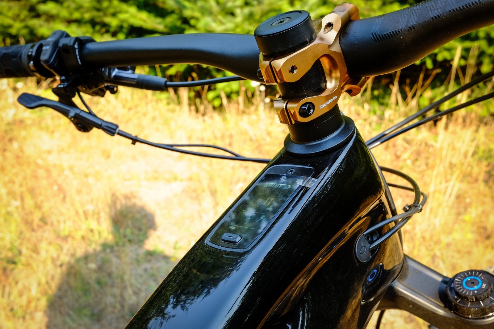

Who ditched the integrated bar and stem that comes with the 9.8 and higher and why?
Thinking of getting one for my 9.7.
I ditched mine, I needed the reach a bit shorter and the bar a bit higher. For now I’m using cheap 35mm stem an 40mm rise, will get something nice later when I’m sure on the rise I want.
Rides a lot better with that setup for me, much more manoeuvrable and comfortable getting into the air. I was too stretched out before…
I pulled mine, being in between sizes I wanted a shorter stem to make the L work for me.
The stock RSL bars came with a 45mm stem, I went to a 32mm Raceface.
Bars/Stem and carbon wheels are for sale on Pinkbike if you’re interested.
