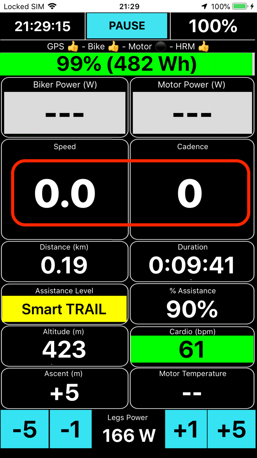

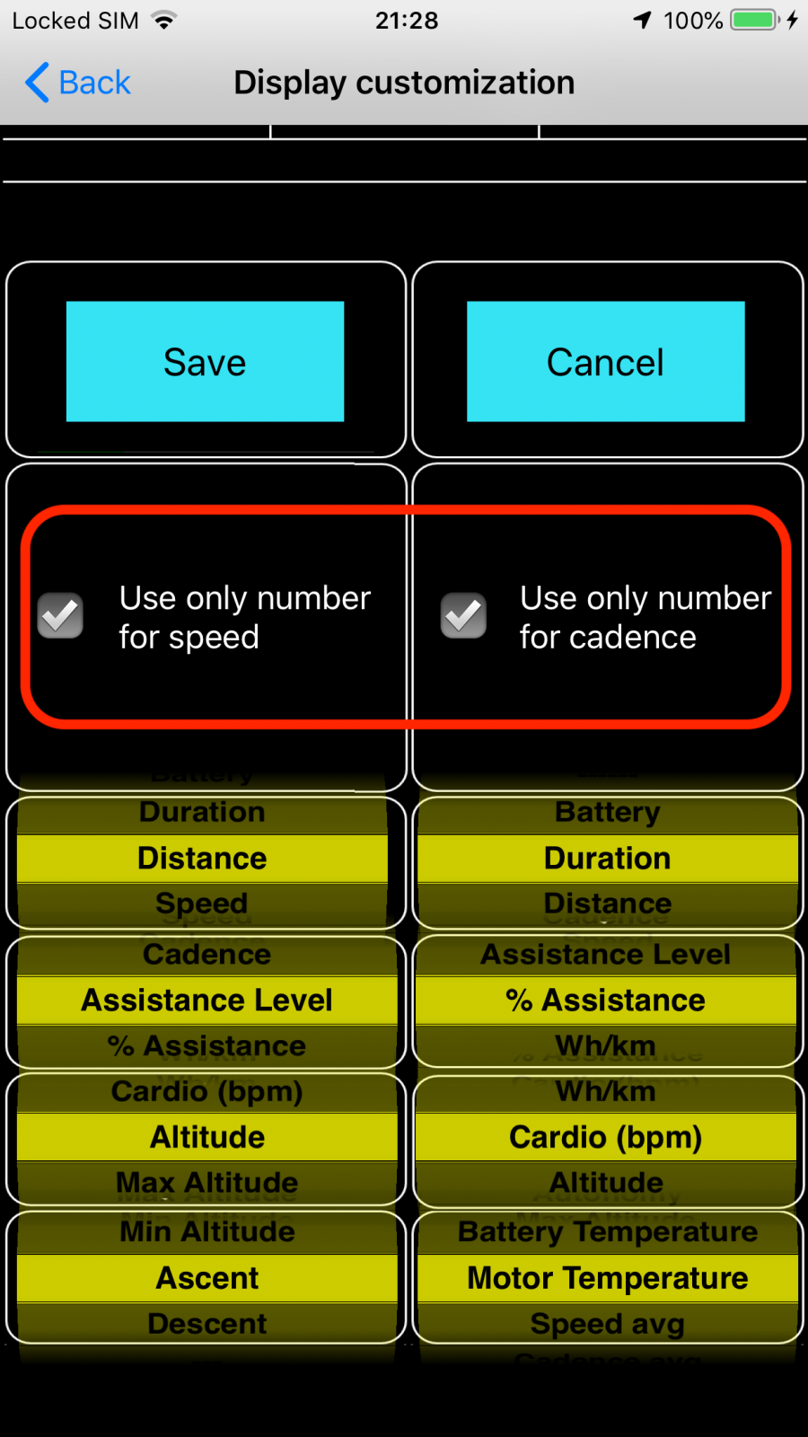

- Now the statistics of the Levo 2019 take into account the biker power and cadence even when the bike is OFF
- Now you can only view the speed and cadence numbers in the Bike Monitor

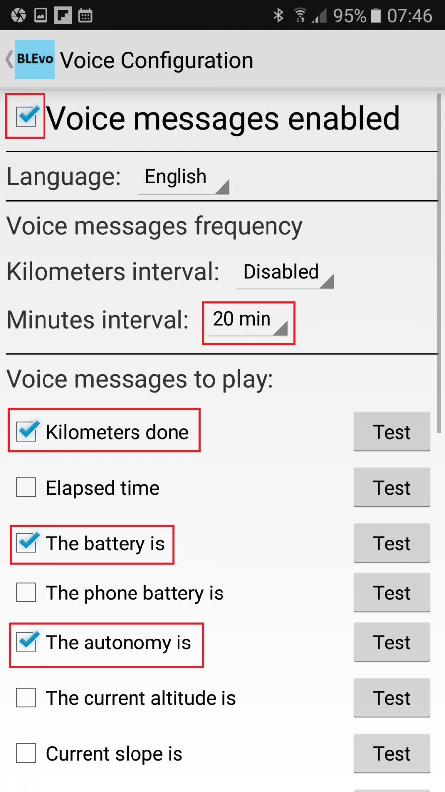

Sorry what you mean with "what range is left"?
Hi Paolo
For example my friend has a cube with Bosch system and on his display he has the ability to view how much range he has left into terms of miles/kilometres rather than what was percentage of battery remaining.

I understood.. you mean the autonomy.. it is present.. BLEvo shows to you the autonomy in function of the actual level of assistance.

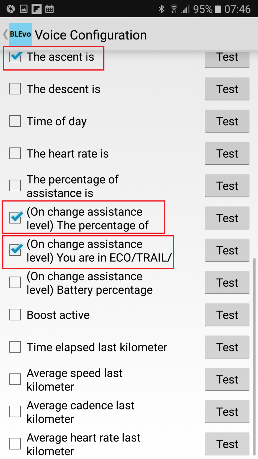

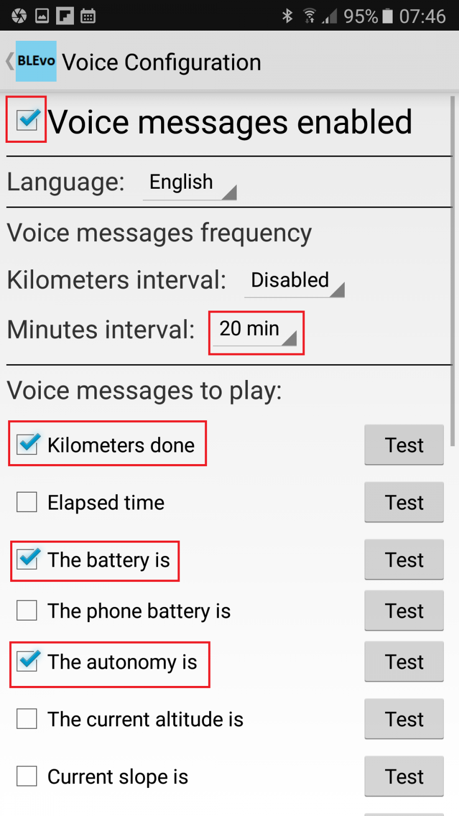

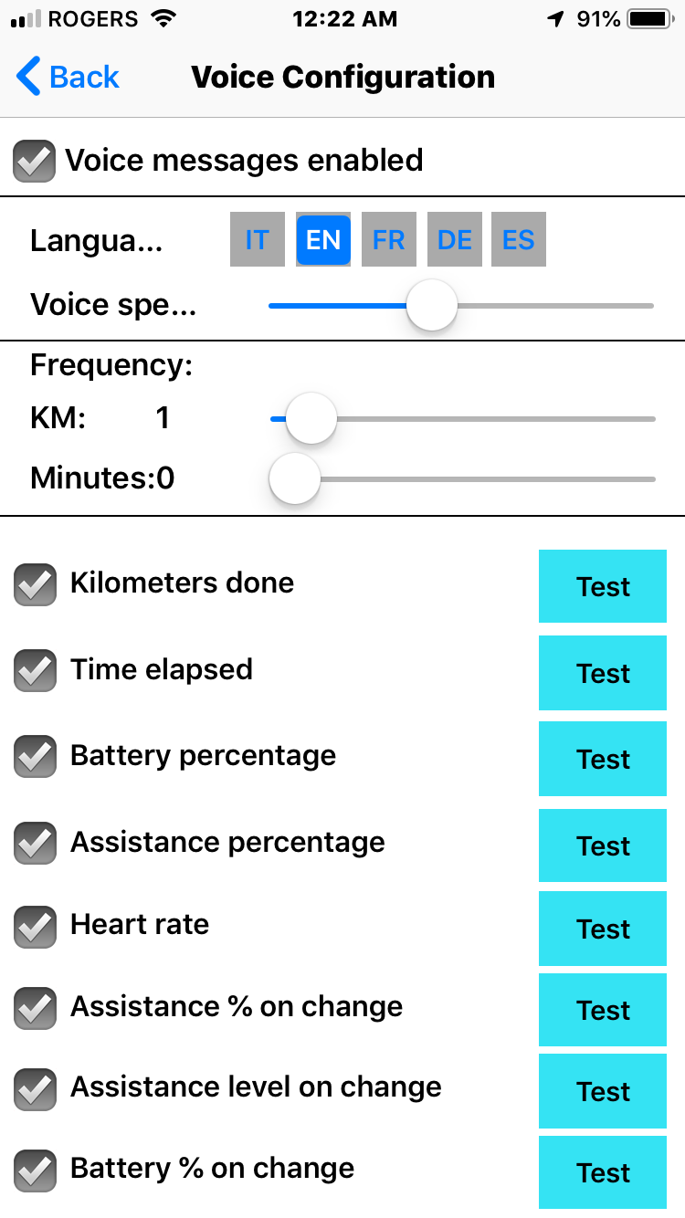

Hi, This is why I love Blevo ?
You don’t need to get your phone out of your pocket.
With Blevo if you have your phone in your pocket with the volume on your phone adjusted high enough so you can hear it.... You can set Blevo to talk to you. Blevo can give you soooooo much info regarding your ride while you are actually riding using the ‘Voice Configuration’
Have a look at the screen shots below and you will see how to configure it and what it can give you info wise. Believe me, there is a lot of info :eek:.
All you do is tick the ‘Voice messages enabled’ box and a huge list will appear.
You can have Blevo talk to you every kilometre if you so wish or adjust it anywhere between 1km or 20km
You can also have Blevo talk to you every minute if you so wish or adjust it anywhere between 1 or 20 minutes or.....
both of the above ?
What you see below is what I have set mine to but you can set it to however you like and flood yourself with info if you wish too ?
If you press the ‘Test’ button that is next to each line it gives you you a voice activated example of what info you will hear ?
You are a ⭐️ Star ⭐@PaoloBLEvo for creating this great App ?????

I will add the autonomy message also in iOS...

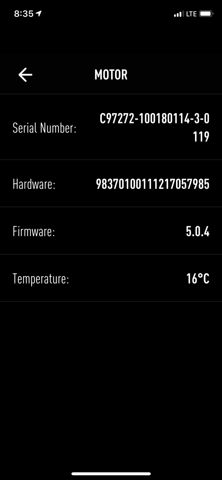

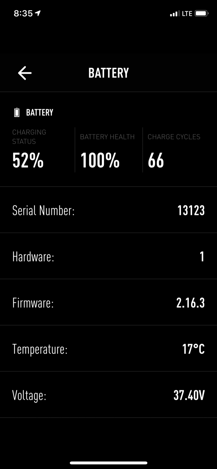

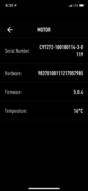

Newbie here with my first post! Great forum by the way!
I’ve recently picked up a clean used ‘18 Levo Carbon Comp and have been using the awesome BLEvo app. Question is...should I have the dealer upgrade my battery or motor firmware? Dealer offered to do it for free and said it will be more efficient, but I don’t want to lose any power or get stuck with a speed restriction. Here are my current versions...
Thanks in advance for any newbie help you can provide!!
7C259B8A-0DDF-405A-A28F-5857C2175B13.png ED749CD9-99F8-4C84-8CF6-AA54C5E73820.png
Jack Z
Aug 23, 2018
Summerland, BC, Canada
View attachment 7973 View attachment 7972
I have the same bike - motor firmware is the same (5.0.4) and the battery 2.17.1 and everything works perfect!!!
Thanks Jack Z.
Anyone else keeping up with firmware versions? Am I safe to upgrade firmware and will I see any benefits or is it not worth the hassle? Thanks again!

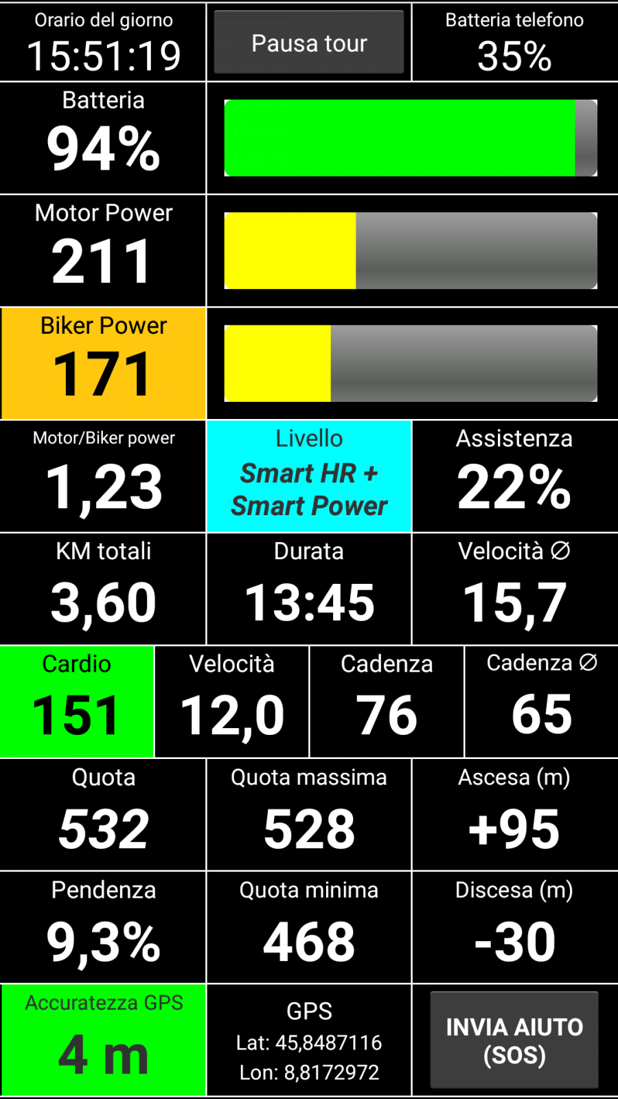

I just released version 3.2.0 of BLEvo for Android.
Here are the news:
- Added tour map with data analysis
- Bugfix: Inserted filter on invalid values of cadence
Attached a link where I quickly explain how to use the analysis of the tour data on the map.
Enjoy your ride.
