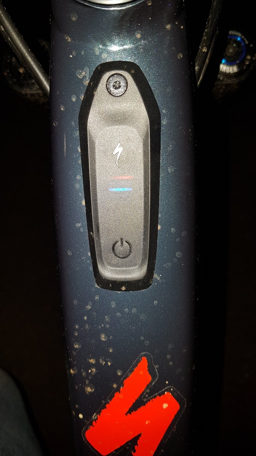

Hi team i have a 2019 Kenevo running BLEvo, when I went to go for a ride the other night I flipped the bike upside down to lube the chain and the battery switched on on it’s own, it was beeping with 3 red led’s flashing, I couldn’t switch it off or stop it so I disconnected the battery and took a good look at it on the bench, assuming it could be water because I had washed it a few days earlier (just with a running hose not pressure) I pulled the switch cover off to reveal the led’s and micro switches and yes the was water in there, there was also some dirt sitting in the bottom of the switch so I guess it had a faulty seal for a while, it was still beeping and couldn’t be switched off so I got a hair drier and started warming the switch area up to dry it out, when it started to dry the battery had a mind of its own switching on and off, figuring I was in for a trip to the LBS I wanted to remove the wheel hack, I could connect to it with BLEvo but couldn’t change the wheel size because I couldn’t cycle the battery to make it stick.
Anyway it took it to the LBS they said there had been a batch of batteries with faulty switch seals but they would download the file from the battery and send it to specialized - specialized come back and say that it has a faulty cell as well as water ingress through the switch, there is no warranty because it’s been running a 3rd party program, My point is that the 3rd party program had nothing to do with a faulty seal or a dead cell and that it is a warranty issue still.
I’m left with having to buy a new battery now which is frustrating, has anyone had issues like this with Specialized

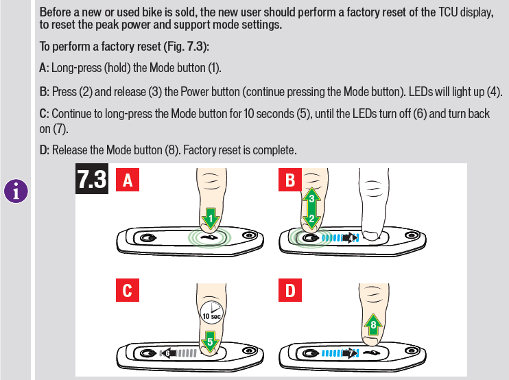

A factory reset before any warranty work should take away any issues. However, I wouldn't be using Mission Control App v2.x (MC) to restore to factory settings, because Specialized collects technical data from your bike whilst connected to the app.
Instead of using MC, I recommend owners of 2019 Levo use this procedure from owners manual to perform a factory reset:
For older Levo (with power button on side of the battery), I have checked owners manual and
Levo Retailer Technical Guide and could not find any similar procedure. So your only option is to use the old MC v1.x App (if you still have it).

For older Levo, there was nothing to prevent someone else modifying your motor settings because no access code was required, so you can't be accused of doing something that voided your warranty.
Maybe get a friend who will never own a Specialized bike to install MC App and register.
And then perform factory reset (without an internet connection (for extra precaution)).

I’m pretty sure it is a standard value in Mission Control, when you run it, it should set all the values to their original settings ?
Just tried...it doesn’t! The wheel size is wrong on MC! Need to re-set in BLEvo ? I’m worried now that the warranty is voided on my 2 week old bike! ☹️ Hope I don’t have any issues with it ?
Hannes_3000
Sep 14, 2018
49
26
Stuttgart
Wheelsize can't be reset in the MC App. You need to use a 3rd party App to do that. If Blevo doesn't work you can also try the LightBlue App (free App) to re-set the wheel size to the original number (2300). The HEX code for 2300 is "0200fc08". You have to overwrite the current value with that HEX code in LightBlue.
