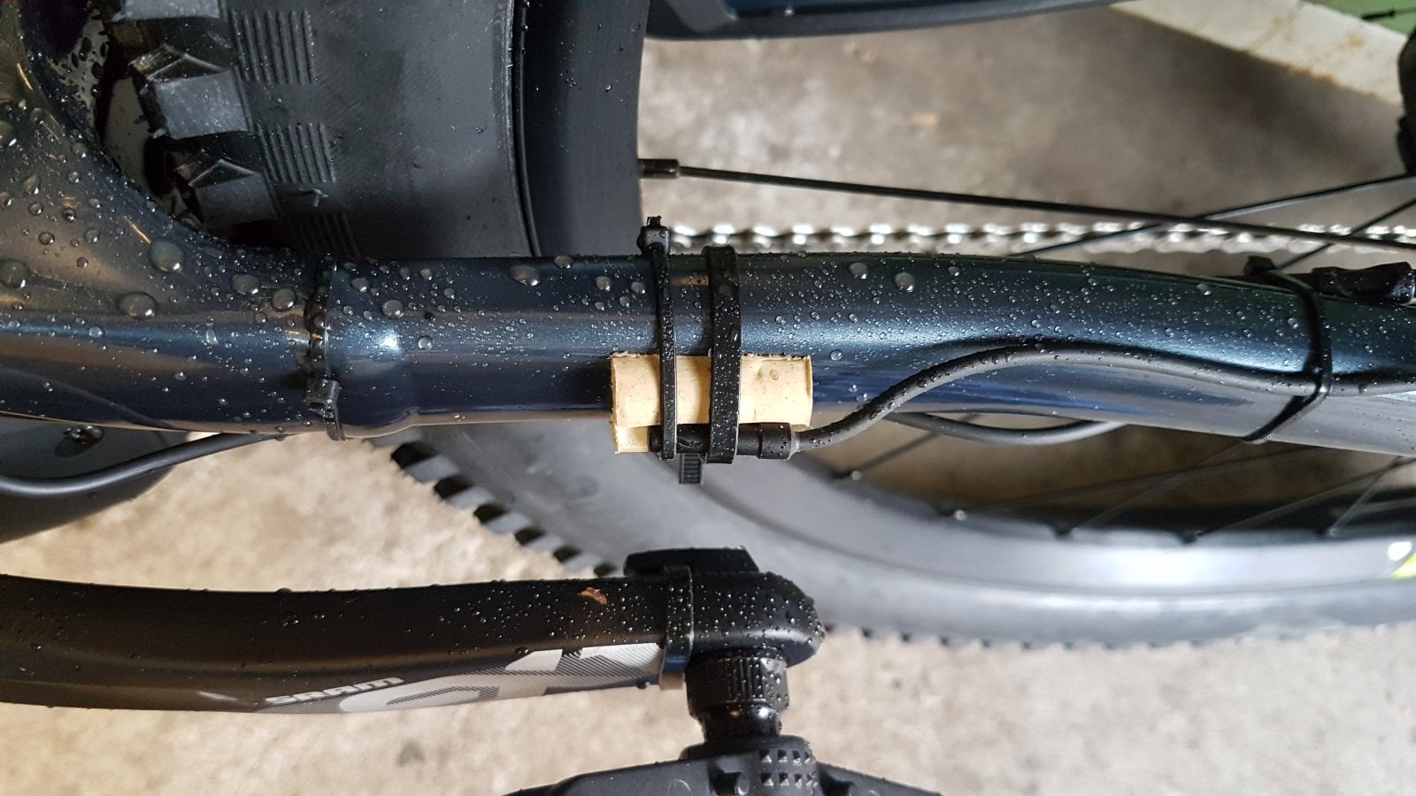

any luck?
Very long story...after the last ride my girl friend said there is something wrong, was before using Blevo....i searched like hell what can be wrong after trying Blevo...I found that the reed contact of the speed sensor does not work. I tested with an old sigma sport sensor, and the problem is solved.Now I'm waiting for a new sensor.So long I ride wit the old sigma sport speedometer soldered on the Specialized Speed sensor plug.......crazy....but my bike is running....with original values....have to try Blevo again when my new sensor is in the bike:giggle::giggle::giggle::poop:shit happens....not a blevo problem

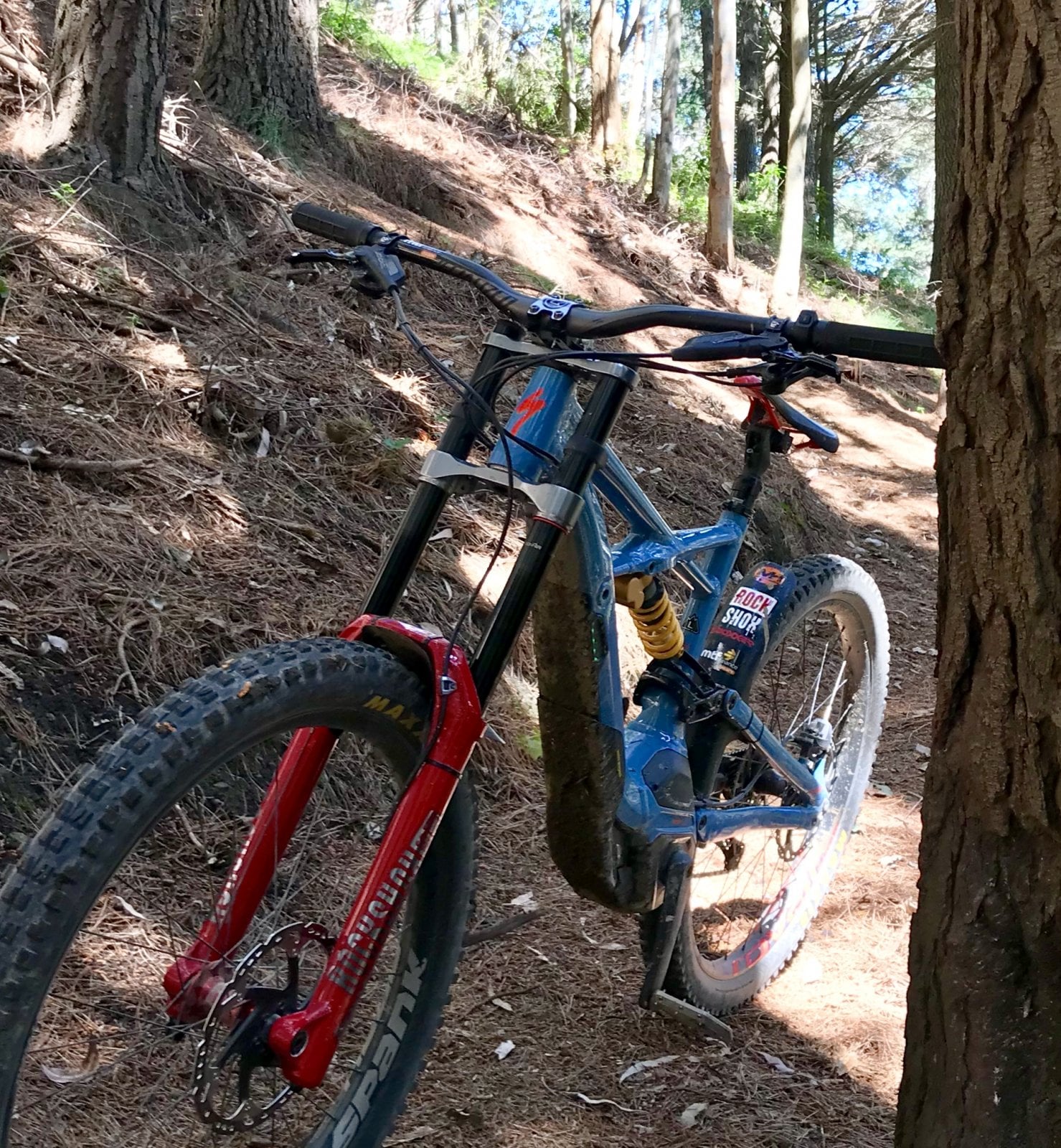

Hi team i have a 2019 Kenevo running BLEvo, when I went to go for a ride the other night I flipped the bike upside down to lube the chain and the battery switched on on it’s own, it was beeping with 3 red led’s flashing, I couldn’t switch it off or stop it so I disconnected the battery and took a good look at it on the bench, assuming it could be water because I had washed it a few days earlier (just with a running hose not pressure) I pulled the switch cover off to reveal the led’s and micro switches and yes the was water in there, there was also some dirt sitting in the bottom of the switch so I guess it had a faulty seal for a while, it was still beeping and couldn’t be switched off so I got a hair drier and started warming the switch area up to dry it out, when it started to dry the battery had a mind of its own switching on and off, figuring I was in for a trip to the LBS I wanted to remove the wheel hack, I could connect to it with BLEvo but couldn’t change the wheel size because I couldn’t cycle the battery to make it stick.
Anyway it took it to the LBS they said there had been a batch of batteries with faulty switch seals but they would download the file from the battery and send it to specialized - specialized come back and say that it has a faulty cell as well as water ingress through the switch, there is no warranty because it’s been running a 3rd party program, My point is that the 3rd party program had nothing to do with a faulty seal or a dead cell and that it is a warranty issue still.
I’m left with having to buy a new battery now which is frustrating, has anyone had issues like this with Specialized
Pleased to say I just got a call from my local shop Village Cycles to say Specialized were replacing the battery for me - awesome result thanks, I can never speak highly enough about the Kenevo, for where we ride it’s the ultimate machine, good of the guys to replace the battery for me that’s restored my faith in the brand big time :)
