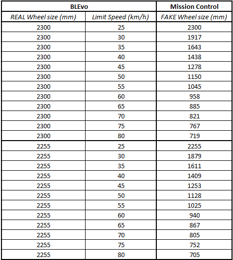

I have a 2019 Turbo Levo Carbon Expert, and I can change the wheel size and speed limit. My TCU is 2.019. MC app had the wheel size at 2300. In BLEvo that showed as 24.5 km/h and wheel circumference of 2300. I tested the wheel size and speed sliders in BLEvo, but returned them to 2300 and 25km/h, and now MC shows wheel circ 2255. I can’t get the speed back to 24.5 in BLEvo to equal 2300 in MC. If I set BLEvo to 25 kph, my wheel size shows 2255 in MC app. Is there anyway to get my MC app to show wheel size 2300?
edit:
BLEvo wheel circ:2300
speed lock 25 km/h
MC wheel circ: 2255
This is contrary to what the BLEvo formula states
If I make BLEvo wheel circ:2345
Speed lock 25 km/h
Then MC wheel circ:2300
Does that make any sense?
**2nd edit**
My actual tire circumference is 2345mm! So, does MC have it set to 2300 to limit the speed to 25km/h?
hbakken
Nov 27, 2018
68
48
Norway
In BLEvo MUST be configured the REAL wheel size because BLEvo need this parameter to calculate the right speed and distance done.
Please, I repeat again. In BLEvo you MUST enter the real wheel size.
Thanks.
Paolo.

I read that 2300 are the standard value I MC. So is this correct understood:
2300mm = 29"
2255mm = 27,5+

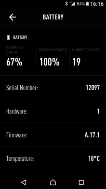

BLEvo shows 93% battery health.
Specialized Mission Control 2.0.5 shows 100% battery health.
What is true?!
PaoloBLEvo
Trader
Jun 13, 2018
1,457
1,191
Varese
Thank you very much Paolo I believe more in BLEvo than the MC. Only after 19 recharges and 1200km battery health has fallen by 7%. I'd be grateful for your opinion if this is a problem.
My Kenevo is at 95% after 200km.. I think it is not a problem..

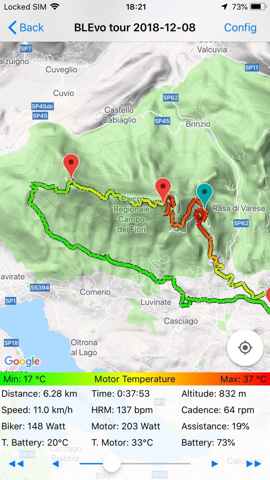

On the Apple Store there is the 3.2.0 version of BLEvo for iOS. Now you can analyze the data of your laps on the map as well.
Here are all the news
- Added the view of the data recorded on the map
- Now you can keep the statistics of all the tours stored and reviewed
- Now, after pronouncing the messages, the audio resource is released to allow you to continue to listen to other audio sources.
- Optimized the Smart HR connected to Smart Power
- Removed animation when going in bike setup and / or bike monitor
- Bugfix: Cadence was not stored in the CSV
- Bugfix: Configuration of Speed and Wheel Size values
Download the update from iTunes

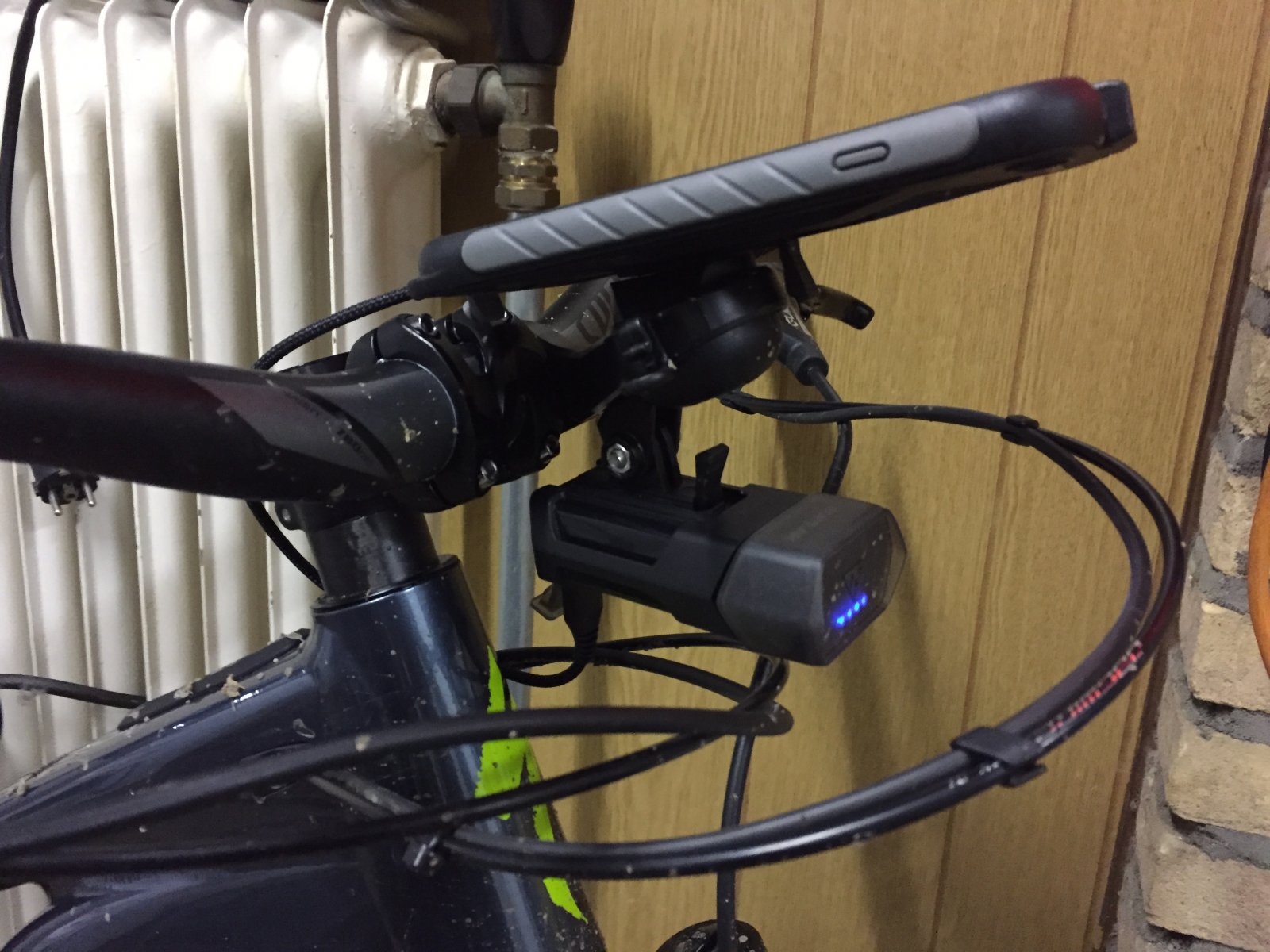

Paolo, is it normal that Blevo consumes 100% battery in 4 hours? Shall I optimize something? I have Android and Samsung S8

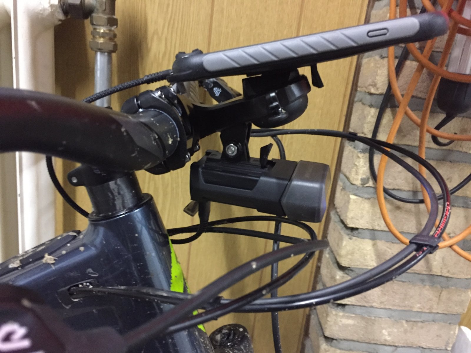

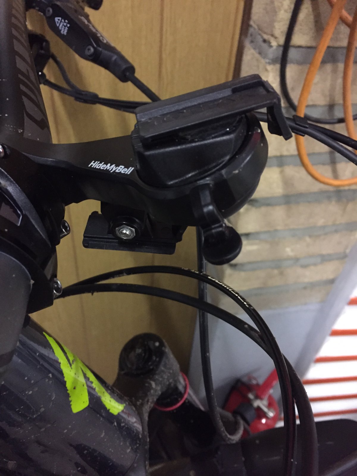

Dear Eagerly,
Hereby some pictures with my solution...

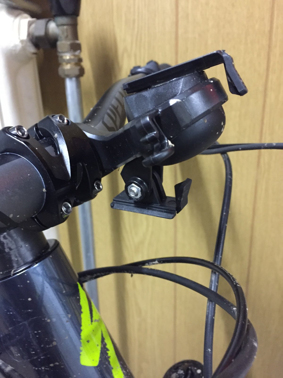

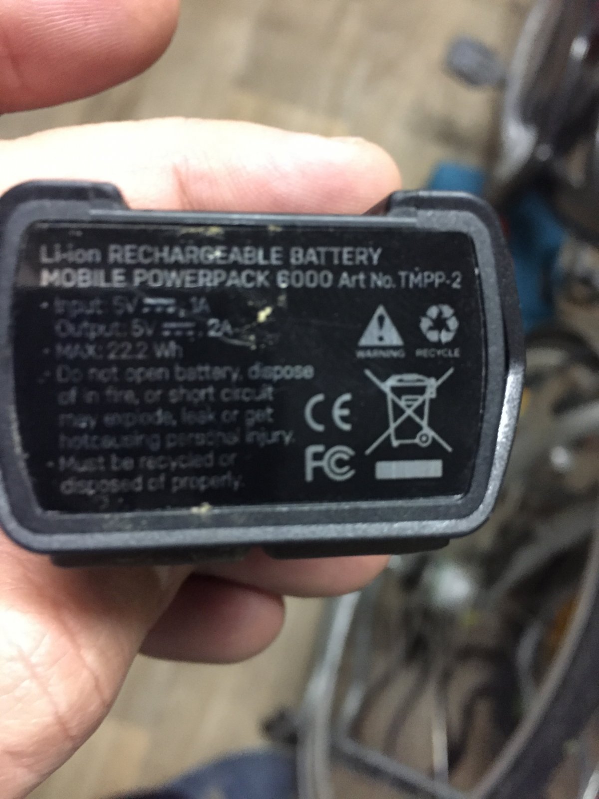

I use a Hidemybell (which like the name says contains my bell) but next to it you can add all kind of mounting brackets as an option like for example Gopro, lights, bike computer and Topeak. In my case I have bought a Topeak Weatherproof Ride case and a 6000mAh powerbank with a very short USB cable. Maybe this solution will help you as well.

Is the map feature for iOS only to analyze the data after the ride, or can you access the map during the ride?
Also, I noticed the hr monitor kept cutting out during the ride, but when I paused the bike monitor it picked it up again. I was using an Apple Watch for the hr monitor.
