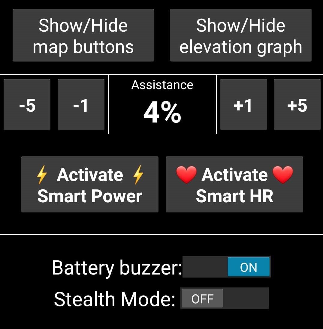

Anyone else seeing blevo stop recording heart rate from the Apple Watch after switching between stats and map whilst riding?

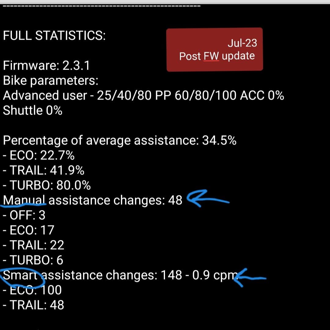

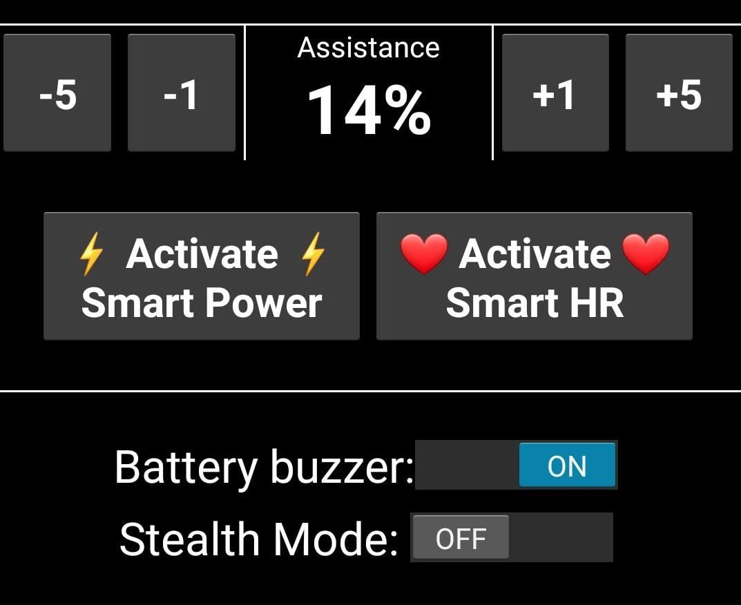

ridehard
Aug 20, 2019
90
63
Israel
Thanks for the reply.
The motor does not lose power completely, just changes the assist level.
It is clear to see in the field "smart assist changes" in BLEvo.
So, a smart feature changes assist even though all smart features are turned off (unchecked).
I saw another user report the same thing - smart being on when supposed to be off.
Could you please have a look at this issue?
Otherwise - great app, i love it!
To follow this up, i can confirm from my last ride, that BLEvo spontaneously engages SMART POWER or SMART HR, thus making unwanted changes to my support settings.
i could see support values as - ECO: 4%, 12%... TRAIL:14%, 20%...TURBO: 60%
My (FIX) settings are : ECO: 25%, TRAIL:40%, TURBO: 80%.
Making a manual support change resets to the normal preset, but BLEvo changes it again very quickly.
Anyone else? or am I that special? :)
@PaoloBLEvo - Any thoughts?

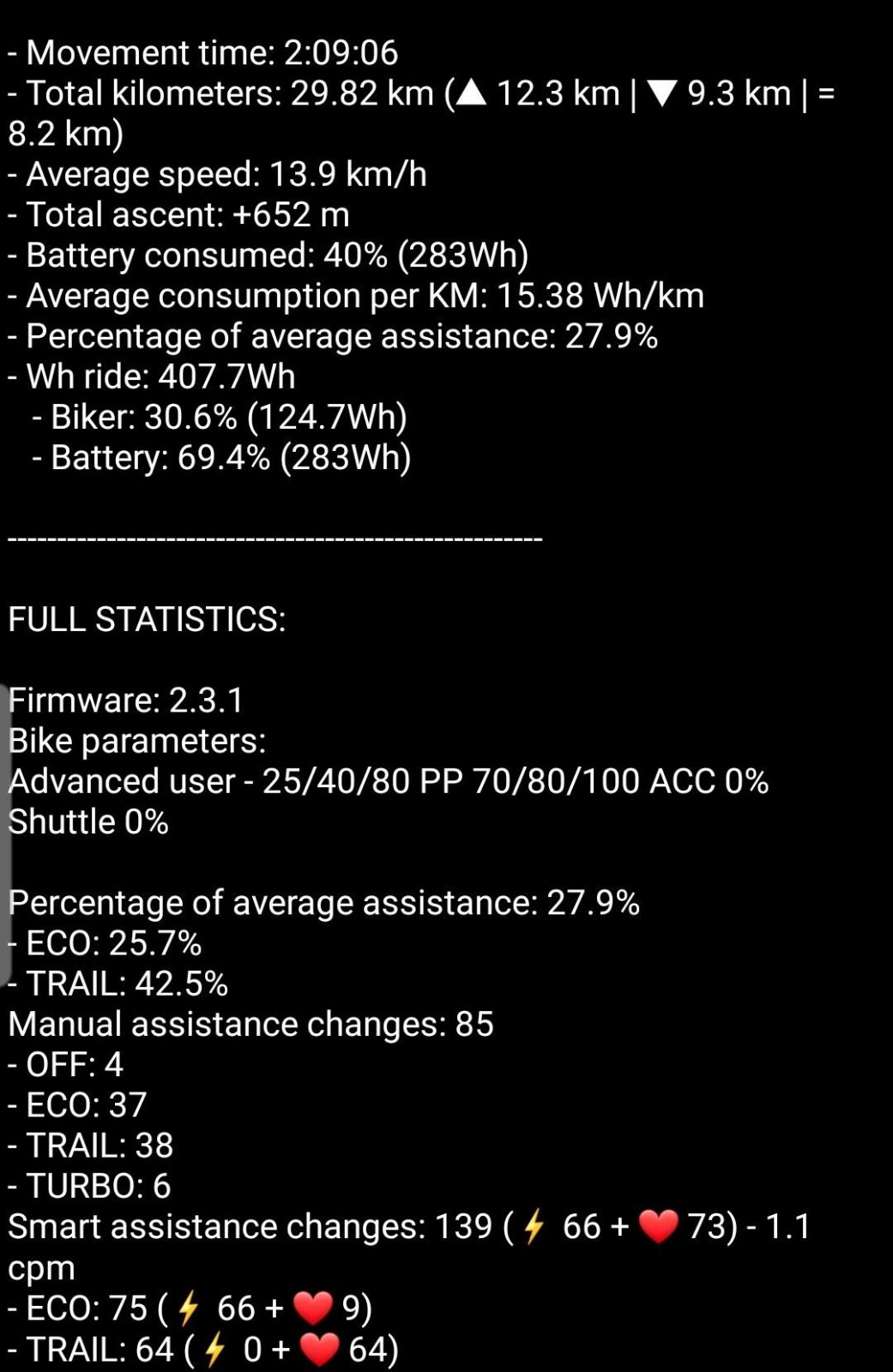

I think BLEvo change the assistance percentage only if it is configured to do so..
Please go in the Smart power configuration and disable it..
ridehard
Aug 20, 2019
90
63
Israel

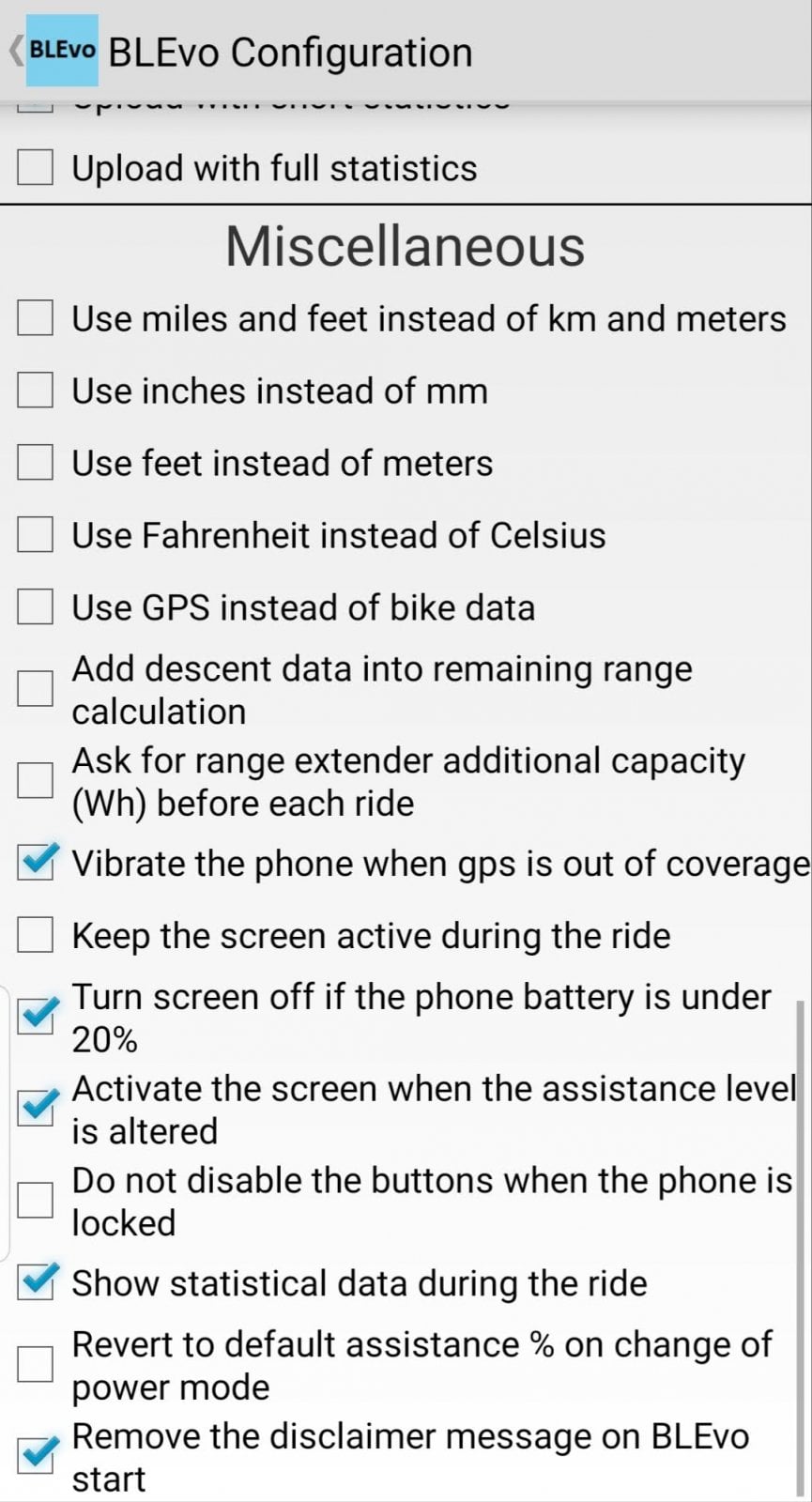

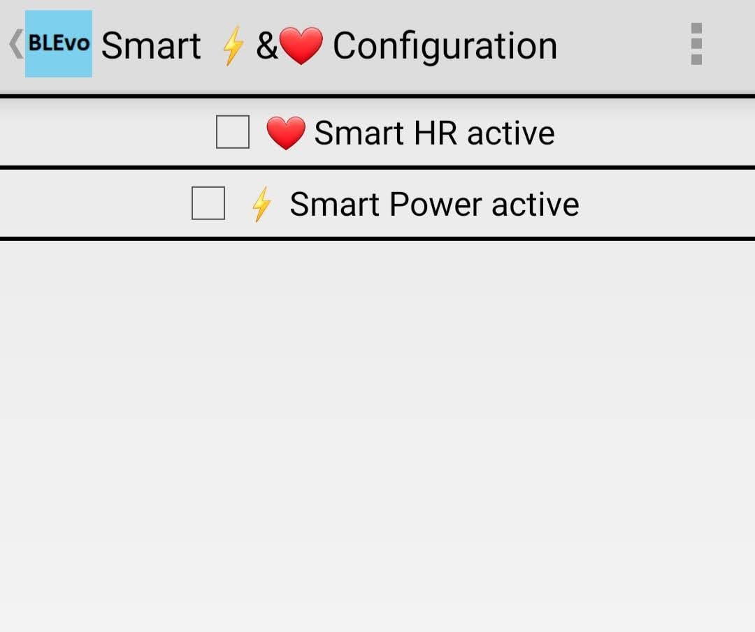

Both SMART POWER and SMART HR are disabled. That's exactly my problem.
Is there a way to permanently shut these off, other than the screen below?
Also see that "Revert to default assistance% on change of power mode" is off, and still it does it.
Kind of lost here... I love the app but I can't ride with it when it keeps cutting down my power.
PaoloBLEvo
Trader
Jun 13, 2018
1,456
1,188
Varese
Very strange... please try to deactivate every single Smart Power in each assistance level.. let me know..
