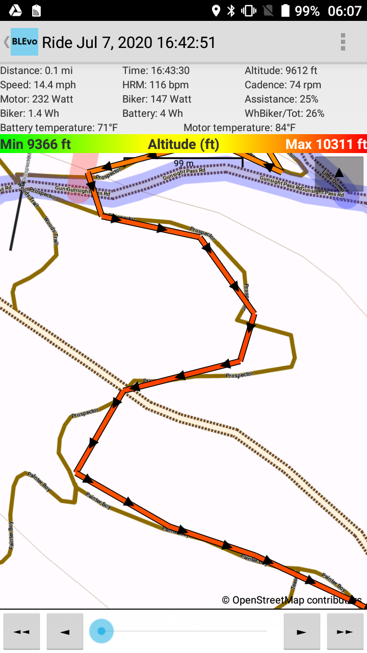

Is there a way to configure how often BLEvo records location points? The default setting is nice on storage space but seems to be chopping off parts of quickly turning trails. (see attached) I have the configuration set to use bike data instead of GPS so I'm guessing the computed distance wouldn't be affected. However, if that weren't the case then using GPS data might result in a different distance measurement, too short in this example.
What you see in the map view is not all the point store in the TCX/GPX or CSV file.. Only the rendering is affected.. You can select the granularity in the map view.. this is just for accelerate the rendering of the map...

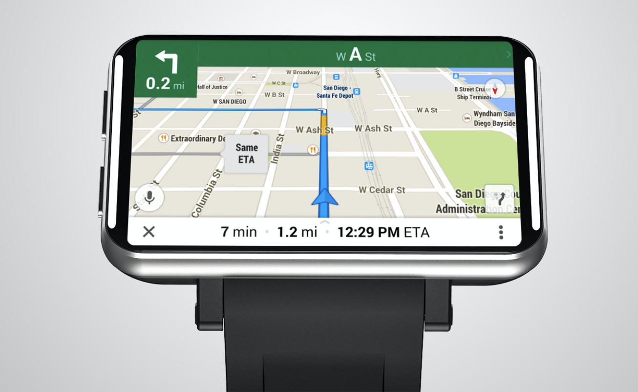

This one is even less expensive. As far as I can see it has an OLED screen which should make it more energy efficient and viewable from wider angles. No Face ID on this one either - that's a big plus.
LEMFO LEM T 3G+32G 2.86 Inch HD Screen 4G-LTE Watch Phone Play Store 2700MAH GPS Wifi Smart Watch Smart Wearable Device from Consumer Electronics on banggood.com
Thanks.. the concept is more or less the same.. I ordered one of this and I'm waiting for it to test..
