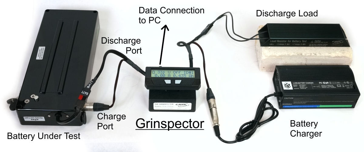

Of course there's also Grinspector
This provides you with the pack's available capacity in amp-hours and watt-hours, internal resistance, and a graph of the discharge curve profile. For ebike shops it can serve as a means of doing quality control on inbound batteries and for troubleshooting and warranty testing customer packs. As an added plus, you can set the station to automatically recharge the batteries to 30% capacity at the end of the test so that they are in the ideal state for shipping or storage.
