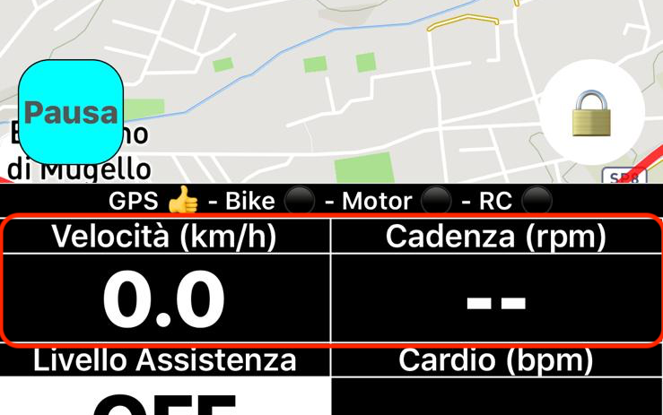

I have just released version 3.5.10 of BLEvo for iOS.
These are the news:
- Now in the map view, you can view cadence and speed without dedicating 2 specific fields
- Now the background color of the assistance percentage changes according to the level of assistance set, in order to have an extra field available
- Now the background of the engine and battery temperature are colored according to the value
- Added remote control commands to increase and decrease the Smart HR reference BPM
- Added voice message for high heart rate (10% above the threshold set in the Smart HR)
- Bugfix time display on map

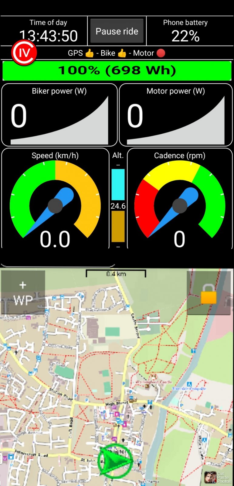

The limit is due to the bike. You cannot have ECO greater than TRAIL and TRAIL greater than TURBO. So you have to think the configuration with this "limitation"
OK, thanks
What you mean with assistance limit? Remove the assistance if you go over 25km/h? I think you are the first that want to add a speed limitation. :p
Yes, I'd quite like to be able to set a speed limit on my eco mode. I ride trails all the time in Trail, occasionally hopping out to turbo. It would be good to have a "road" mode.
These are specified in the user manual
I add in the wish list
Ok, thanks
Could you share a screen shot?
See attached. It would be good if the map control could be resized to fit in the lower half of the acreen.
Btw, I love the app, I never use mission control now :p
Thanks

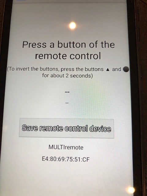

Hello Paolo,
I have problems with the installation of the remote control .
scanning of the remote it worked but the command "save remote control device" fails.
I get stuck in this screen
how can I solve this
My phone is a rugged rg 655
Remote control OSY-12

Hello Paolo,
When you are in this screen, if you press a button on remote control, nothing happens?
