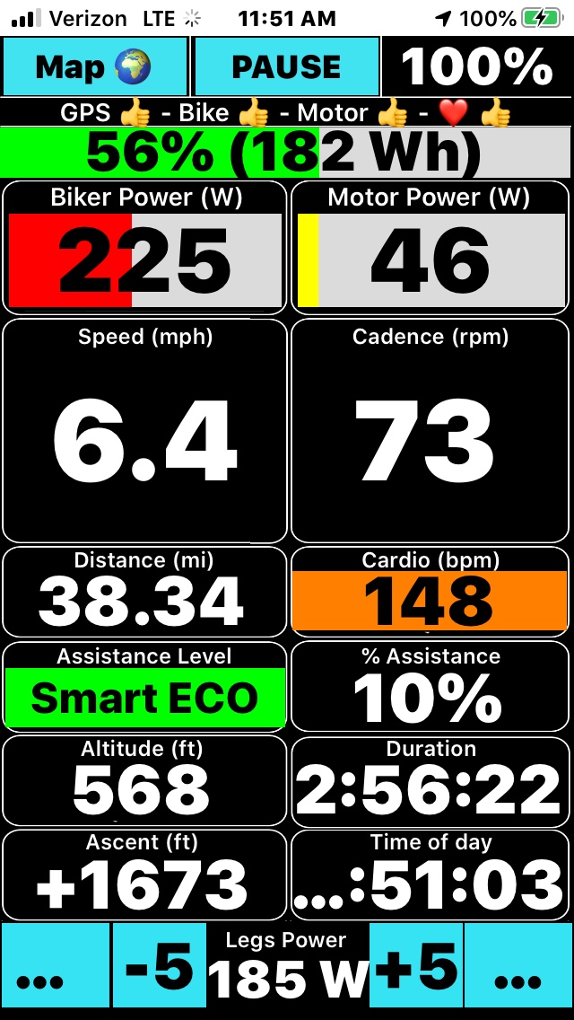

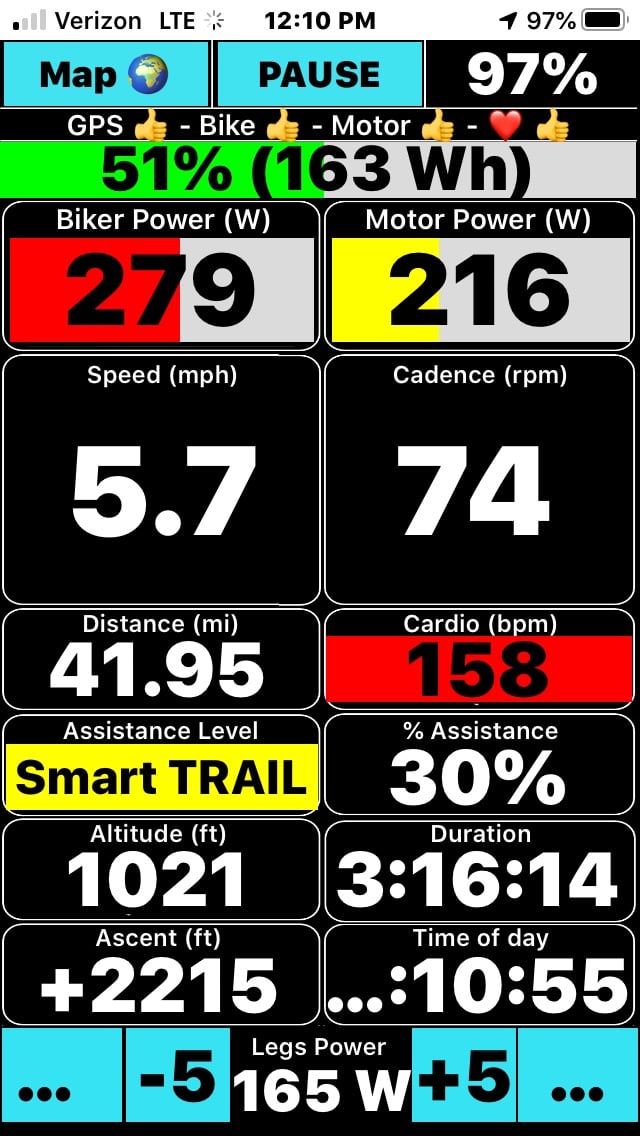

Sorry but I don't understand what you mean with "double"..
OK... I'm in ECO mode. Leg Power is 225w and % of assistance is 10%... I should get 22.5w of battery boost but I'm actually getting 46w! (Double)... Earlier in the ride I would always get within the range of assistance 1 to 10% but as soon as I switch modes ECO to TRAIL and then back to ECO weird things start to happen and I get twice as much boost as requested.... I hope this helps... I'm sure I'm the only one that has this problem!
Jeff H
May 19, 2019
207
200
San Jose, CA, USA
Unfortunately the math isn't that simple. Per Specialized, 100% support doesn't mean motor output is equal to your output. Depending on the motor it's about 3-4 times you. Read all about it:
And to make it even harder to compare biker vs motor, note the ending caveat regarding the displayed motor power is electrical consumption, not actual power output. Most likely Blevo is showing the same. Bottom line, Specialized is going for how it "feels" when they calibrated the support percentages. You can put away the calculator now :).
