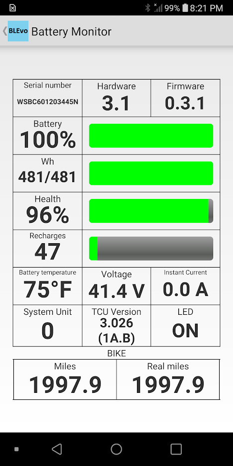

I wonder the same. The new error logging in Mission Control shows discrepancies and I think it’s due to my 15.5 km/h setting in Blevo (I think it’s the install default). I’ve ignored adjusting it since I know it doesn’t actually change anything on my stock ‘19 Levo but now that MC logs the attempt I’m a bit concerned.
@PaoloBLEvo, you said set it to 25 km/h but as @gmurad pointed out, it should be 32 km/h for him in Canada or 20 mph here in the US.
Could you send the battery monitor for the US bike?

Paolo, here's a screenshot. Also, I said the speed was set to 15.5 km/h but it's actually 15.5 mph. If I try adjusting the speed to our US 20 mph it changes back to 15.5 mph.
Ok, thanks.. the system unit is always 0.. I thought that in US was different.. I need to find a new parameter to detect if the bike is in US...

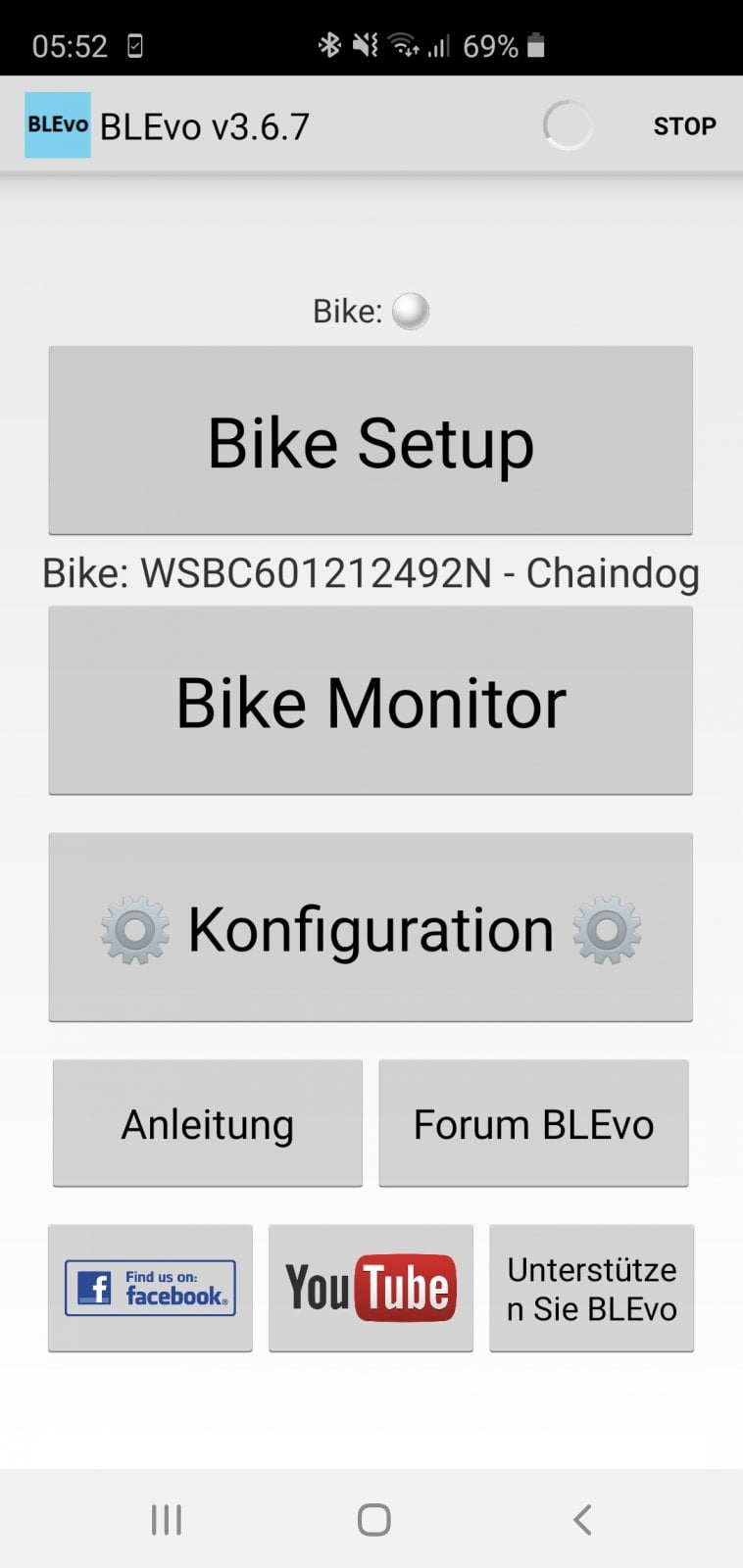

Now I've got connection issues: tried the steps Paolo posted, inclusive removing the pairing from the Bluetooth konfiguration. But Blevo does not remove my bike from the app, I can not try a new connection. Can I reset the blevo App sp that it loses my pairing?
You need to remove the paring from Android/iOS system, not from BLEvo..
Which TCU version you have?

Ok.. It is correct that BLEvo finds the bike.. When BLEvo try to connect, the paring code should appear..
Yes, that doesn't Happen. IT's like Blevo remembers my bike and tries to connect, doesnt ask for the pairing Code of the TCU. I should add that I switched Phones, from a Galaxy S8 to a S10+ and transferred all my Settings and apps via Smart Switch. I already tried de and reinstalling blevo, but even in offline mode (bike turned off) it still reads my bike Name. When the bike is turned on the Little bulb goes blue shortly as if it found a Connection and then starts blinking Grey.
-Update- just tried connecting to Mission Control, same thing, connection lost after a few seconds. Seems like my phone's bluetooth is the Problem, or the TCU.

I just stumbled over @Maastricht s thread About TCU connectivity issues. I'm pretty sure I'm experiencing the same phenomenon. I recently waterproofed the TCU with electrical tape, I'm going to take that off again and switch off the wlan repeater in my cellar. No giving up yet :)

Ok, took the tape off, turned my WLAN off and tried to connect Blevo, nada. Turned bike off, started Mission Control, turned bike on and FINALLY got a pairing request. Paired Phone, connected MC, turned on Blevo, bam connected :) sorry for the fuss, but I never thought the TCU connection would be so sensitive. Thanks @PaoloBLEvo love the App!
Happy to understand your connection is working again. As you have seen I have been suffering more or less with the same issue. In the end my TCU was replaced and since then I have less issues. However still during rides I have 2-3 times BLEvo looses connection. You will receive an audio message and then BLEvo reconnects automatically again. Connection only gets lost for a few seconds.
