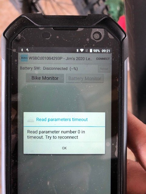

I just picked up a new 2020 Comp (Firmware 25.B.0 Hardware A.1.2) and a BV6000 and am having trouble connecting. MC finds and connects immediately. BLEvo (v3.6.7) finds the bike immediately but then gets a "Read parameter timeout - Read parameter number 0 in timeout. Try to reconnect". The lights on the TCO blink continuously while BLEvo is attempting to talk to it.
I've tried restarting everything but always get the same behavior. Any suggestions for other things to try?
Try to remove the paring with Android and the bike and retry the connection...
That did the trick, but only after I also unpaired it from my iPhone where it was paired for running MC. It seems that the bike really doesn't like to be paired with both the iPhone and Android at the same time since once it was paired with android it would then not pair with the iPhone. Not a big deal really since I just installed Mission Control on android and will now only pair the bike with it.
Thanks much for your help and creating such a great app :)
Yes.. this is a known issue about the TCU...
Read here for more information..
Connection issue with Levo 2019/2020

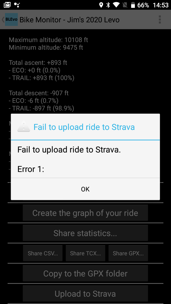

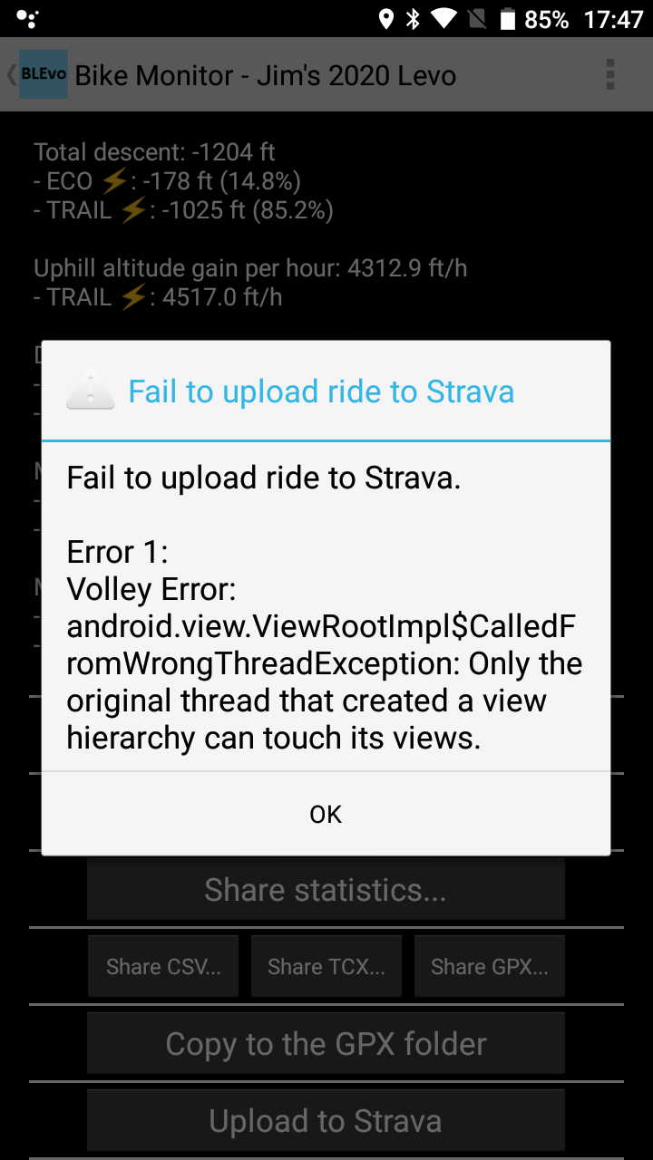

Trying to upload to strava I now get the error message: "Failed to upload tour to strava. Error: 1. I removed the strava permission and put it on again - without effort. What else can I do?

Hi Paolo,
today I ended my winter break and did a first short ride. Before, I updateted to the latest android version.
Let me know the error.. Error 1 is not enough..
Do you have a screen shot?
I have the same issue as WoZei. (See attached screenshot). Blevo is v3.6.7 running on a BV6000 This was my very first ride using BLEvo on my new 2020 Comp :) so I hadn't attempted or succeeded in uploading to Strava before. It might be some kind of new setup mistake on my part. I did try removing the Strava Authorization and then re-adding it a couple of times. That part seems to work just fine. But the upload still fails the same way. Sharing the ride info via gmail to myself worked fine so the network seemed to be OK. Is there a debug or log file that I can collect and send?
p.s. I'm totally blown away by how easy and powerful the app is. Definitely take riding to a whole new level :)!!!
I was to slow - I just wanted to upload my screenshot, that would have shown exactly the same. Thank you.
