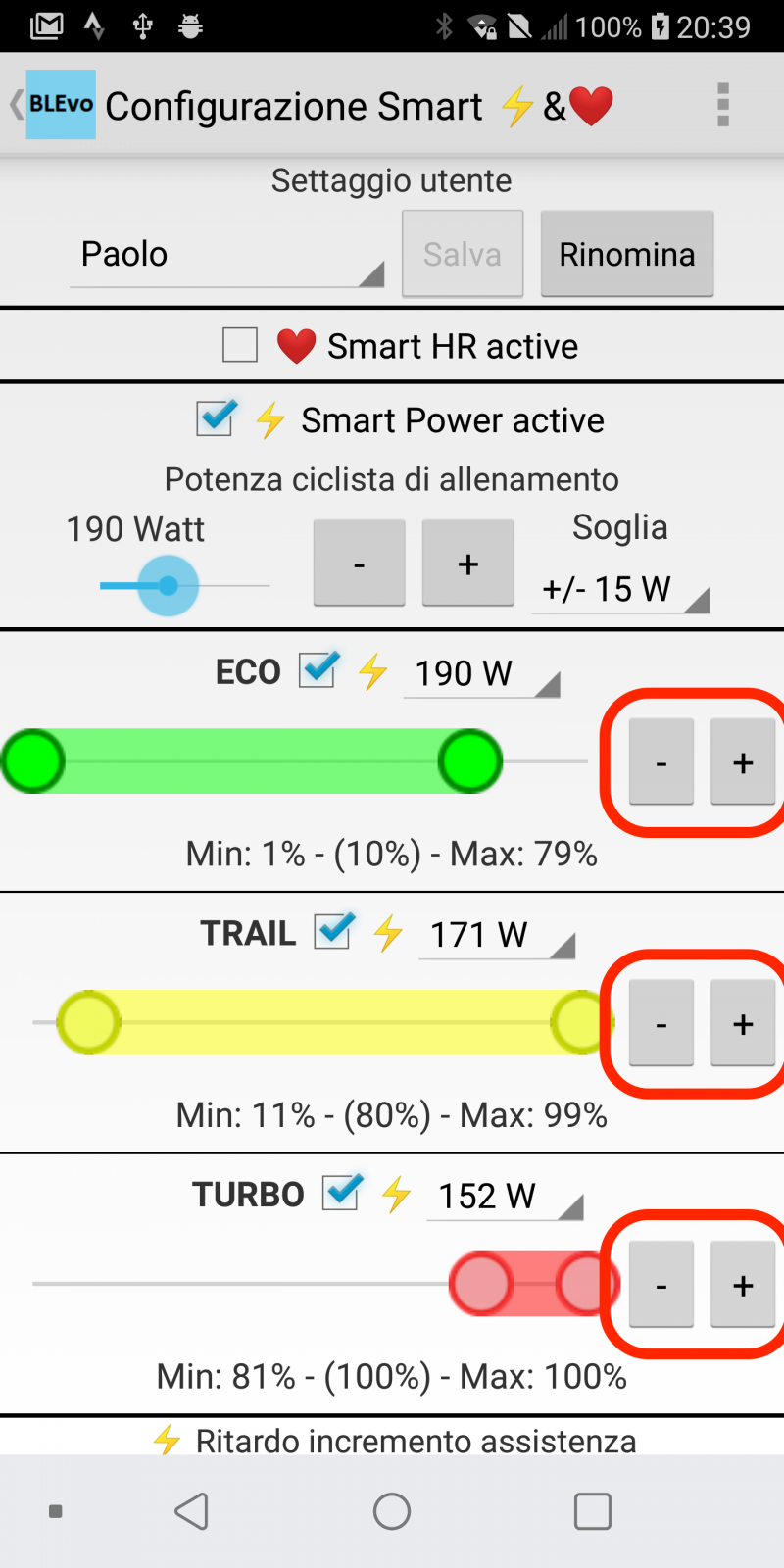

I have just released version 3.6.7 of BLEvo for Android.
I have reviewed the Smart Power setup menu again. The +/- keys have been added to allow you to select the chosen value more finely and I increased the size of the dots of the sliders. In addition, static assistance will now be calculated automatically according to the Smart Power settings.
I also added the bike disconnected audio message because sometimes the bike disconnects. When you hear this message, without touching BLEvo, just turn the bike off and on and the reconnection will take place automatically.
Here are all the news:
- Added audio message to know when GPS is out of coverage and Bike disconnected
- Added +/- buttons in the Smart Power configuration
- Revised the constraints in the configuration of the Smart Power
- Now the Smart Power configuration must be saved otherwise the changes will be lost
- Added up to 6 possible smart Power configurations
- Now in the Smart Power configuration, if SP or SHR is not selected, the static configurations can be saved
- Added the ability to upload all statistics to Strava
- The barometer can now also be calibrated in feet (if the unit of measure in feet is configured)
- Bugfix: Revised authentication in Strava
- Bugfix: Calculation of Wh/km when there is the second battery
- Bugfix: Fixed track width on the tour map display
- Bugfix: storage status display/hide elevation graph
- Bugfix: ride removal (remained displayed in bike monitor but not in the list)
- Bugfix: remote control feedback tone (if the bell was configured it did not make the tone if it was on the map)

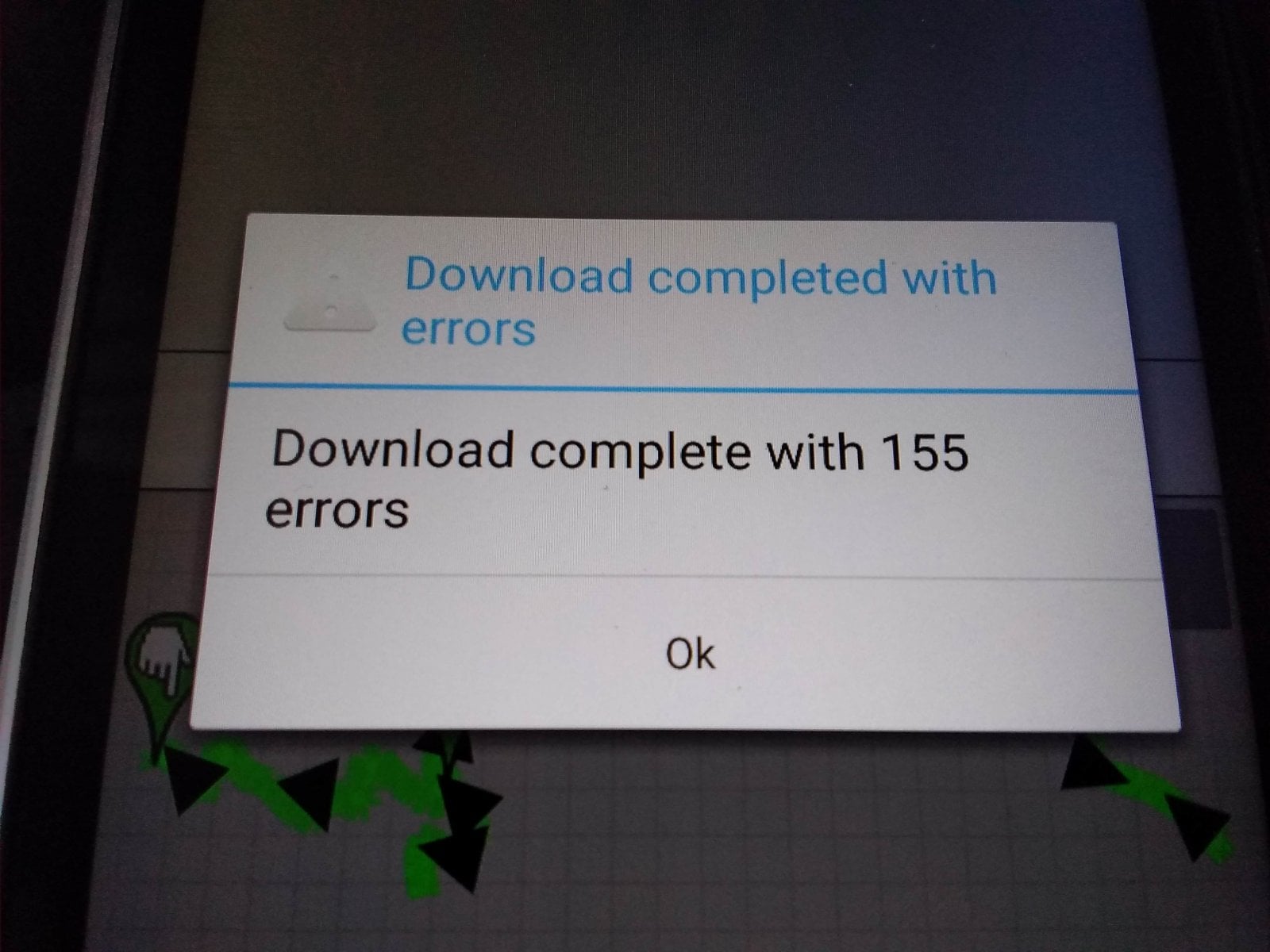

Whenever I try to download map tiles it progresses through and then fails with errors equal to the number of tiles. I found an old post with the same problem, but couldn't find an answer.
PaoloBLEvo
Trader
Jun 13, 2018
1,457
1,191
Varese
Are you able to understand if the tiles are downloaded or not?
Which type of map are you using?
wackerb
Feb 5, 2020
Kailua Kona, Hawaii
I've tried OSM 4uMaps.eu and OSM Hike Bike. The gpx of interest is in Hawaii. I'll attach it and the error dialog from another attempt. The BLEvo/MAPS folder is empty.

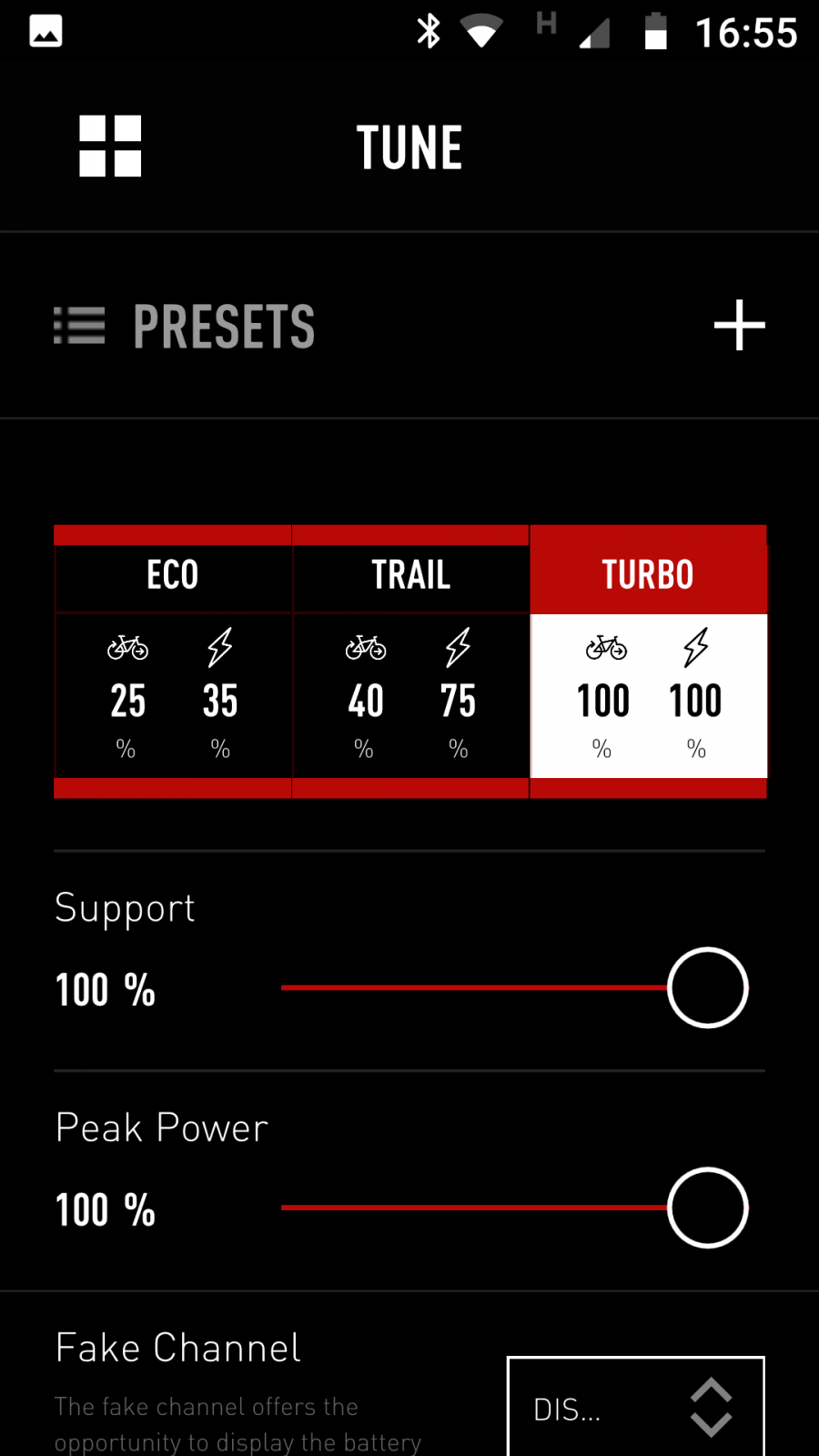

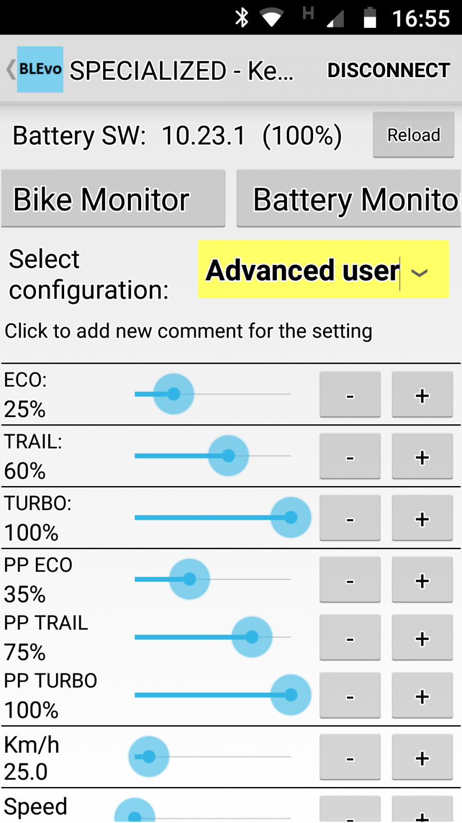

@PaoloBLEvo Not sure if this is a blevo bug or something else...
I reset back to factory default in mission control today and lowered the PP for ECO and Trail .. which gave me this :
Then reset the bike twice, stopped MC running (forced stop) and ran blevo .. which gave me this :
Then did the same the other way with a double reset. Forced stopped Blevo . Ran MC and the settings were the same still. And so on another two times to confirm.
Each time MC shows Trail as 40% and Blevo Shows it as 60% ???
Kenevo 1.3... with 5.0.4
What you mean with "reset"?
14,195
21,127
In Mission Control in tune ? (I think it's in tune) you have the option to select the "Presets" - which in theory sets everything back to the factory default settings for the bike.
Though as I used "reset" in different ways in my post :) the other "reset" was turn the bike off and on again.
Did you already tried the Andromap where you can download all the map and put it in the folder /BLEvo/MAPS ?
In anycase I will check you error
I checked now, and the Map4u doesn't cover this area.. You have to select another type of map..
Preset are different from reset..
