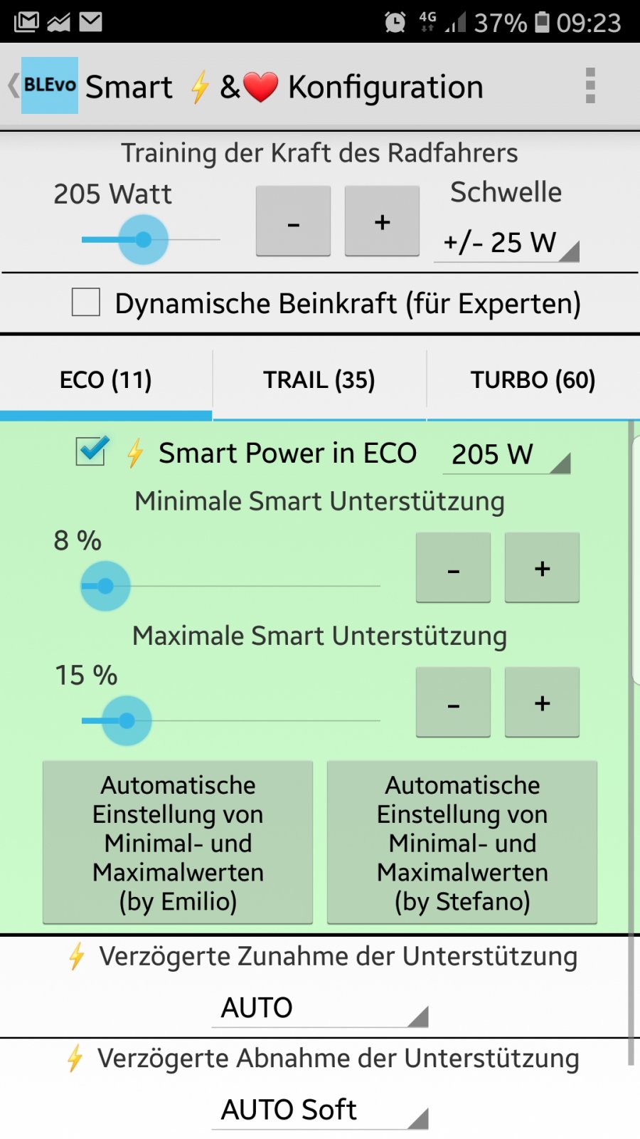

@PaoloBLEvo , tested Smart Power again yesterday. Still great performance. One Issue I recognized was that when Smart Power is increasing the assistance this is done very quickly and by a big move, e.g. from 9% straight to 15%. Decreasing is done in steps. Can I make this more smoothly? And where can I activate the Smart Boost function? I can read about this in the help section of Smart Power.
Second question: Can I combine Smart Power with Smart HR? When I'm riding uphill trails, Rider power is usually above the threshold. HR above 140 or 150. When having a small piece with less watt input needed Smart Power is decreasing assistance. HR is still above 140 or 150. As I want to have that piece of ride to use for recovery, can I use Smart HR with 140 or 150?
Thanks.
Thanks.
Could you share a screenshot of your Smart Power setup?

In order to have a down decresing smoothly you can select "Auto very soft".
For Boost functionality, it is automatically implemented when you select step up Auto.
I think you need to increase the max value of eco.. put 34%..
You can combine Smart Power and Smart HR.. but you need a heart monitor.. then there will be the option for smart HR..

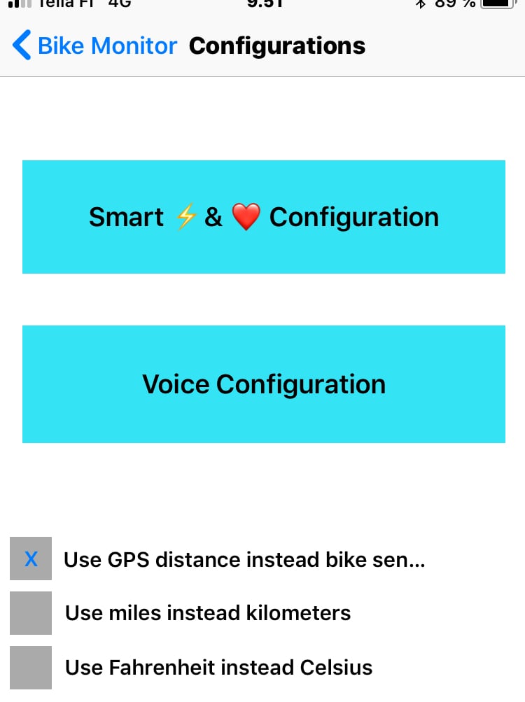

Paolo, I am having problems finding this menu page on the iOS app version which allows you to set the Auto Fast setting and Auto Soft setting. On the Android version I finally found it using the android menu button, but having trouble finding it on iOS. My wife and I love the functionality of the app but getting around the settings still a little challenging. Have you done an English manual update since the one you released in June? I know you stay busy with the code, we appreciate it! Thanks
The Auto soft and Auto fast are hidden in the "reactivity" selection...
For the user manual for ios, I will do before the end of the month... I hope...

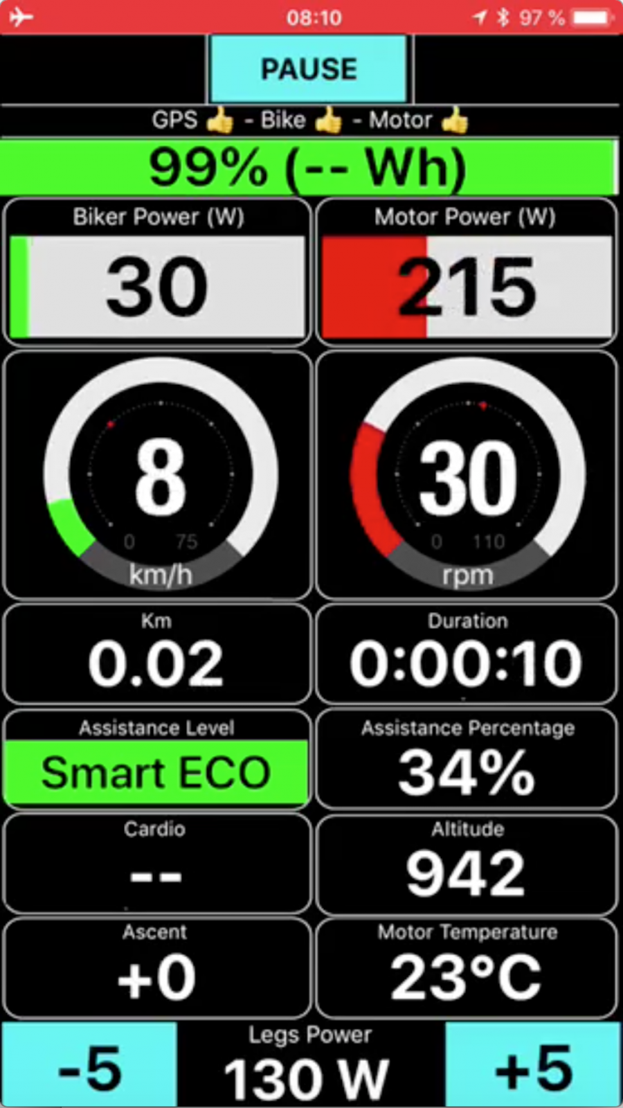

Paolo, two more questions and I will wait for the iOS manual update.
I prefer the older display on the iOS BLevo app before the update (maybe I'm just used to it), please tell me where the display page is on the iOS app so I can change from the new display to the default one, the one I had used before the update.
Also, a new dialog box pops up at the start urging me to set the GPS on Always, instead of while the App is active. Not sure why I would want my GPS running on my phone always when I'm not using the app, or riding, most of the day. Seems this would adversely effect my phone's battery.
Thanks again!
Thanks again!
Why you like previous display?
The GPS is required to be set to Always, otherwise the app will not record the complete GPS route if you lock the screen.
The GPS is active only if the bike monitor is active. If not, the GPS is not used so the battery is safe.

For what it's worth - I prefer the new display, big improvement in my view.

I will admit that I may have not given the new display enough time riding, but in my opinion, the original display showed me more fields that I was exploring while learning to use the BLEvo app without the initial and future manual updates. Is it possible that the iOS version does not allow the display customization like the Android version does? Just looking at possibly customizing the data fields.like I can on the Android version, but unable to find the display option on iOS. Still love the app and functionality, will put more time in today on the new display. Thanks!
After riding with the new iOS version of the BLEvo app for a couple hours, I agree that I do like the new display better than the previous one. Easy to read and has nice active overlays on several fields to make it more intuitive. Thanks, Paolo!

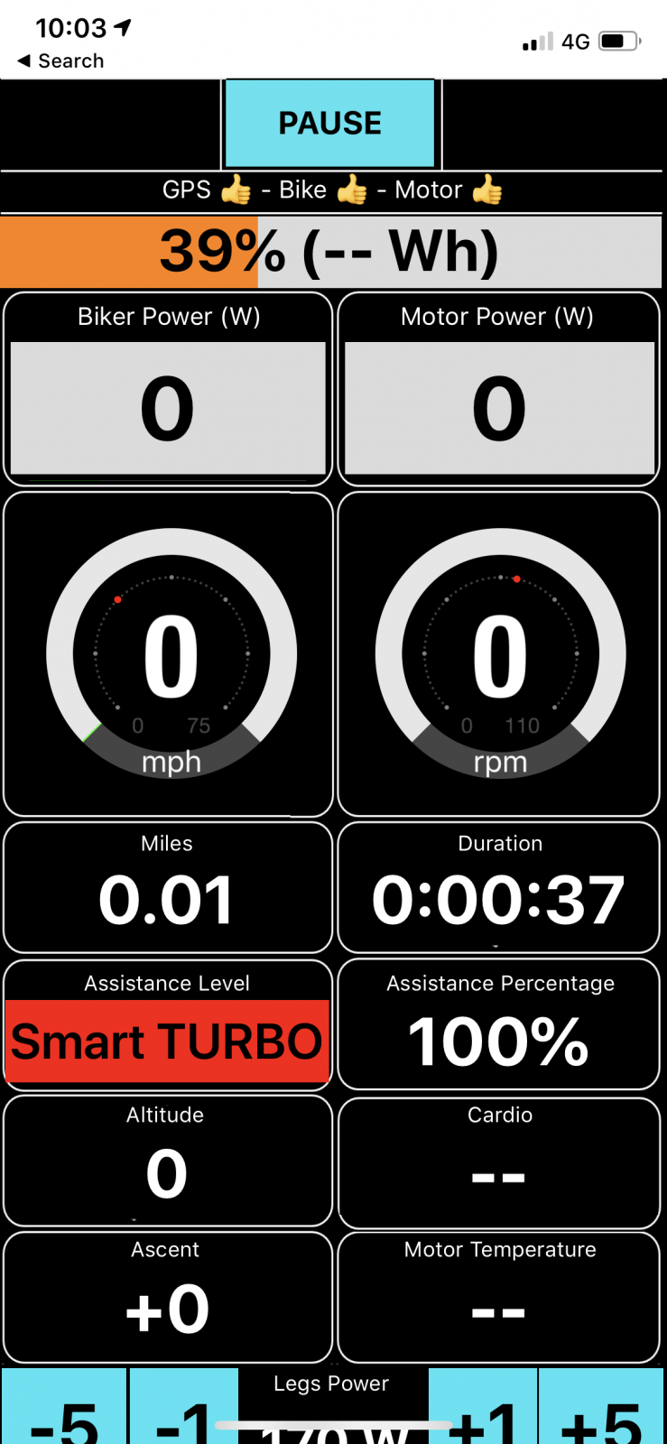

@PaoloBLEvo - I hoping it's of help but as below, the screen is not formatted correctly on iPhone X - not sure if it's related/relevant but I'm running iOS 12 Beta 10
Also, a nice to have would be Ascent in Feet (on the display) when using Miles (noting the data output is in Feet - which is good)
Thanks for the report...
I will check and update as soon as possible..
