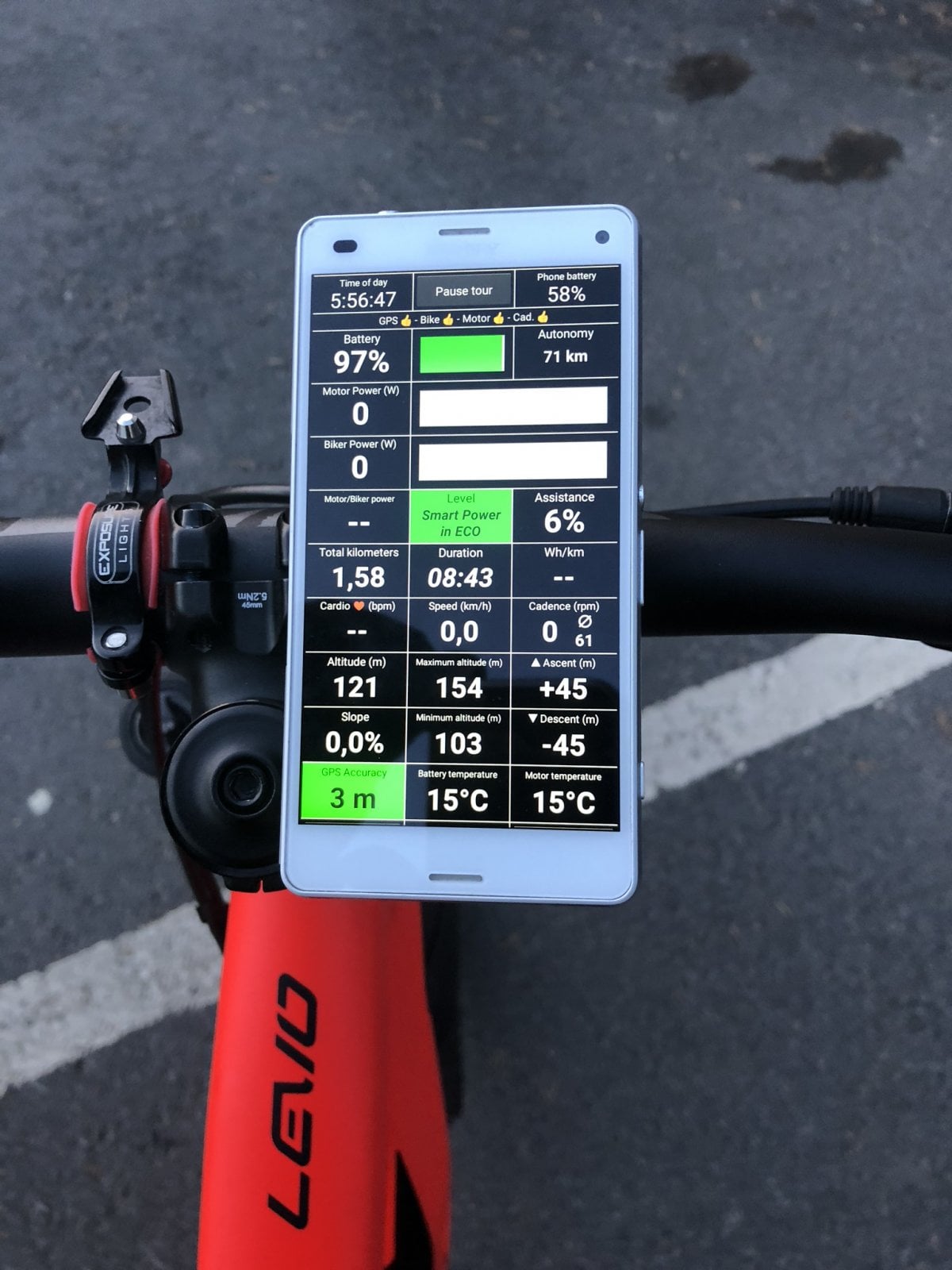

First test of Android this morning. Works very well. Haven't yet familiarized settings very deeply but i felt that bike was behaving much better way than with IOS-app.:rolleyes:
Better reactivity tough.
And Sony has IP68. And it works with your gloves on!
