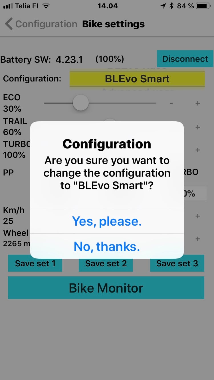

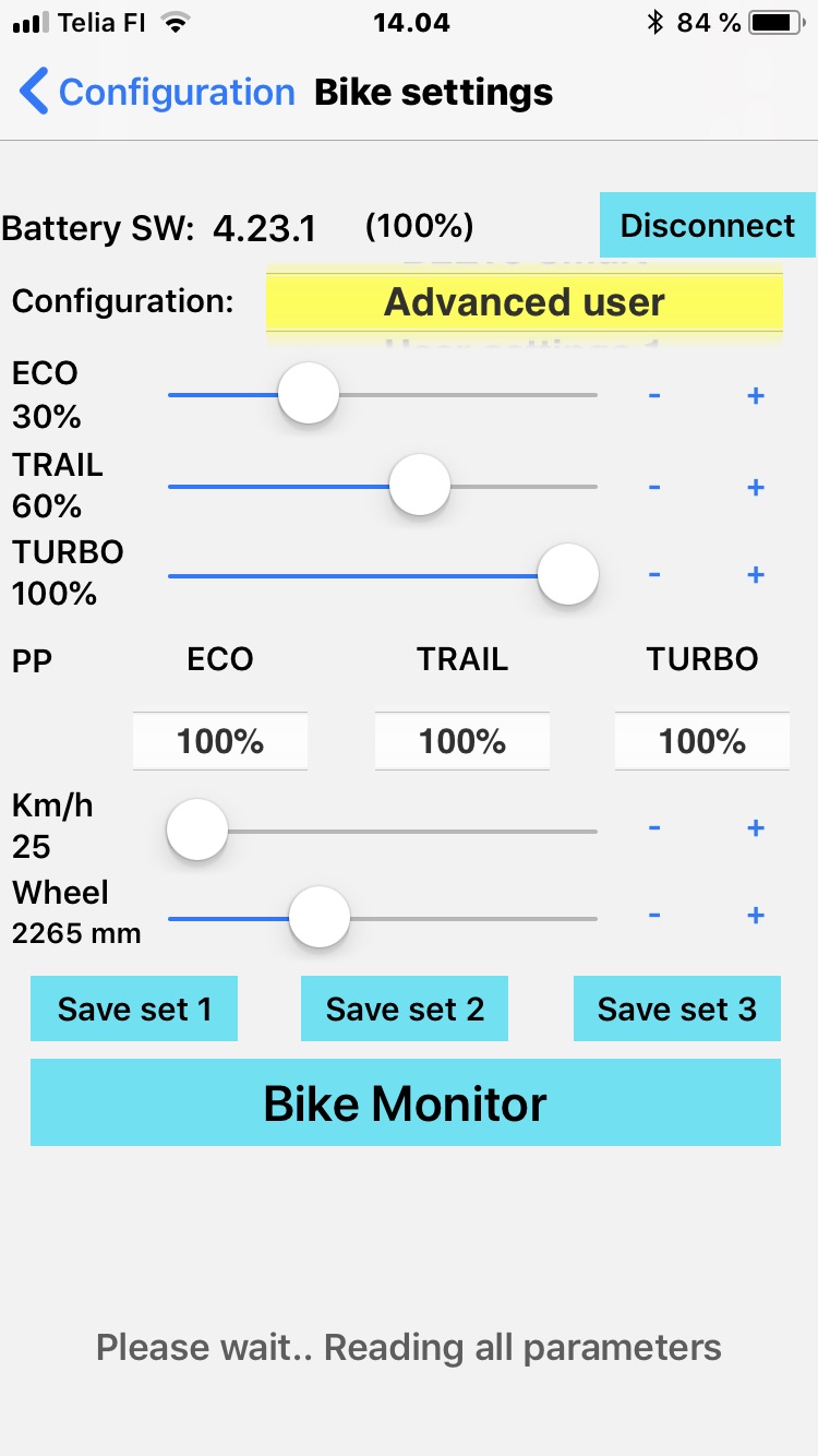

I dont understand. When i select BLevo Smart:
I choose yes and:
Says reading all parameters and slider goes to ”anvanced user” automatically.
Am i doing something wrong here?

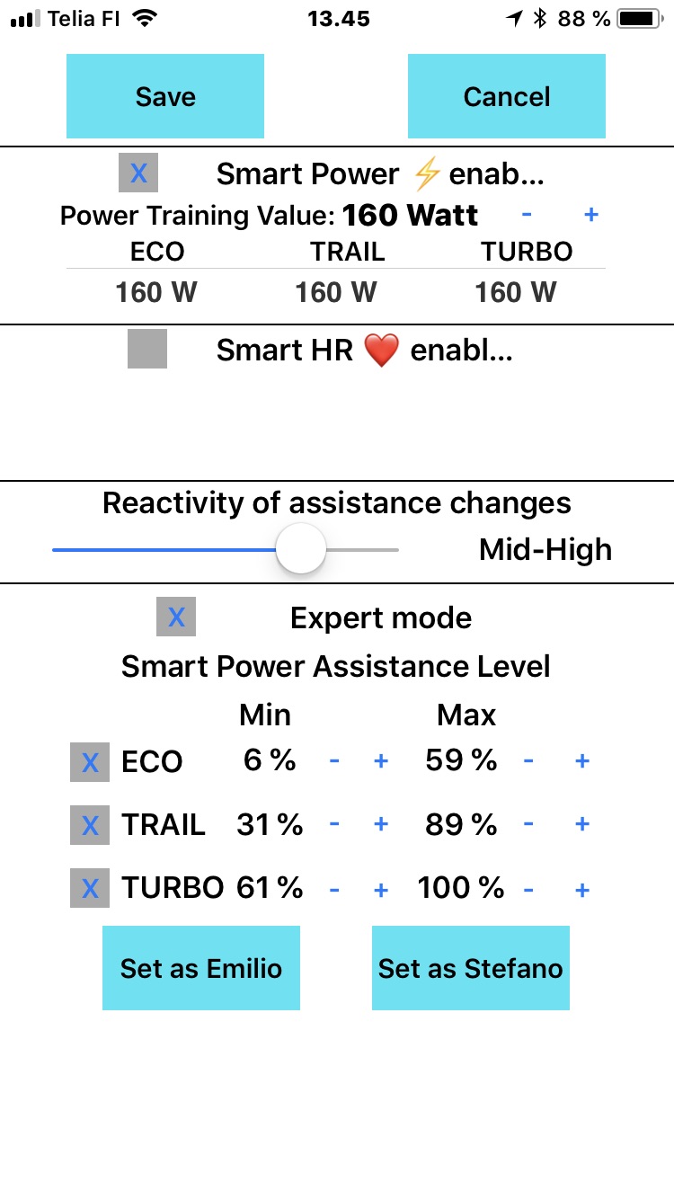

Hi, Smart Power is also present is ios version.
Try to use preset "BLEvo Smart"
10/80/100 pp 100/100/100
Enter in Smart Power settings and set the range as follow (as Stefano, or "not expert")
Eco 6-79
Trail 11-99
Turbo 100

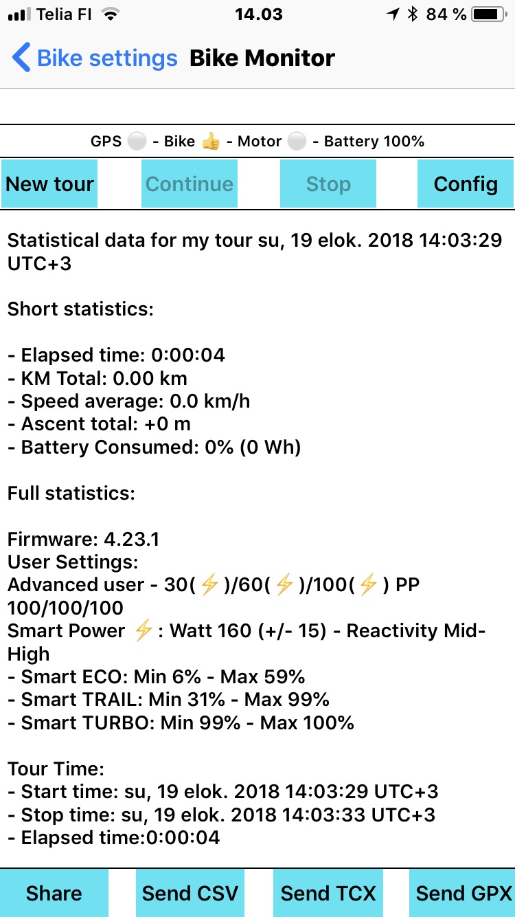

For legs power start with 160 watt and increase it if the assistance is too high.. otherwise decrease it..
As Stefano i can set eco only as high as 59% and Trail min i cant set lower than 31%. Turbo is 99/100. Min is not possibly set at 100.
PaoloBLEvo
Trader
Jun 13, 2018
1,457
1,191
Varese
The "Stefano" settings, depend from "static" setting.. the static settings in my example are eco 10/trail 80/ turbo 100..
If you can set max value of Eco as 59%, this means that you set trail as 60%..

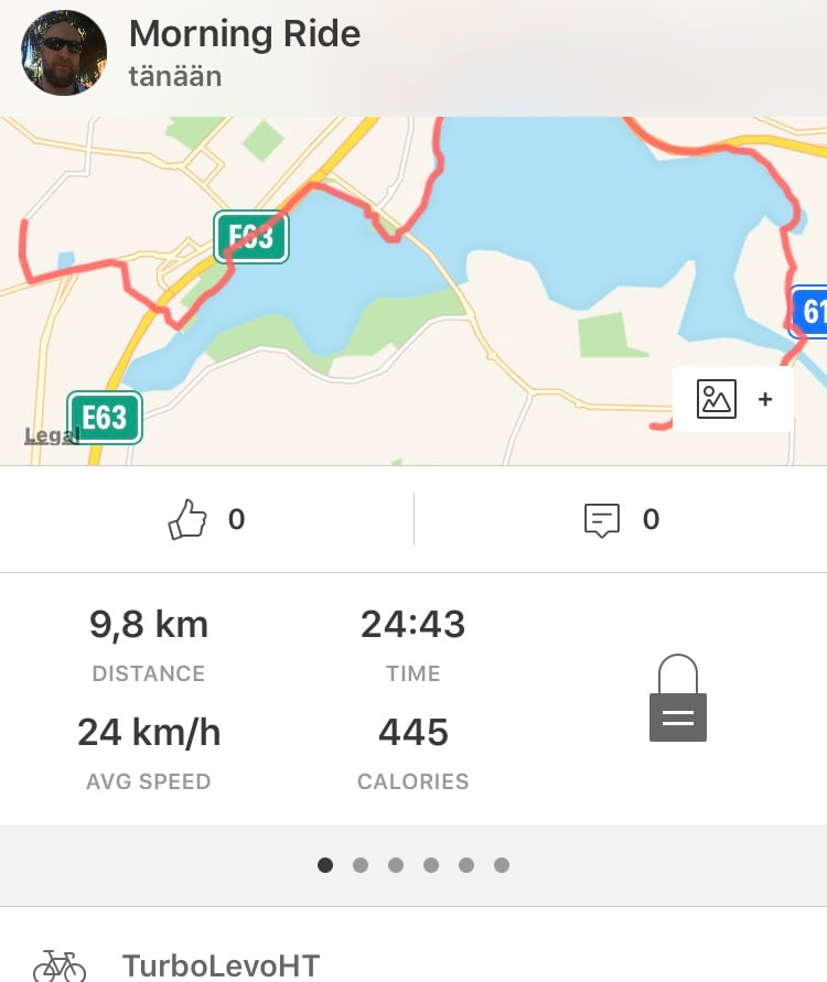

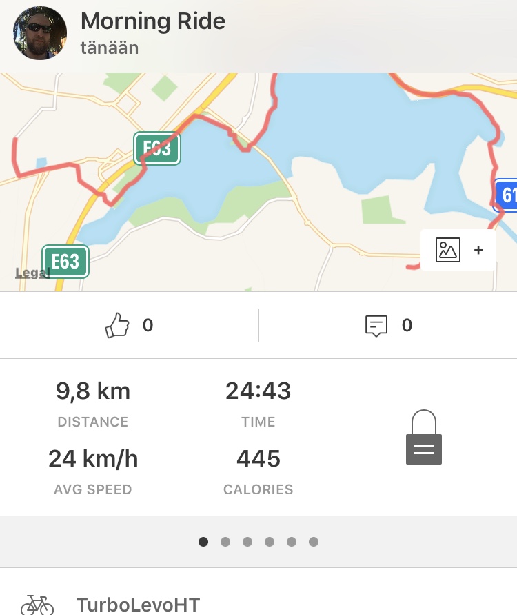

This mornings commute.
From Blevo:
From Apple Watch(Strava):
BLevo turns gps on and off all the time...
Kimmoi
Jul 6, 2018
391
386
Finland
Phone is always on the bar, with Quadlock. Km is calculated with gps. Gps does this always with BLevo, dropping of constantly.
Phone is iPhone8. There's no this problem with Mission Control.

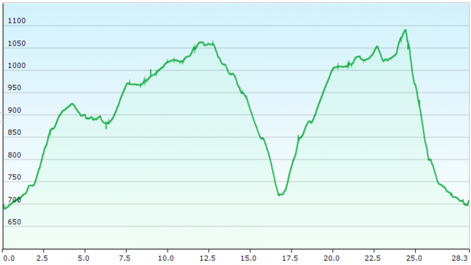

I tested Smart Power yesterday on a tour: around 30km, 1000m in altitude, good portion of uphill and downhill trails.
Smart Power for Eco (11%) ranging from 9% to 15%:
Started with 180 watt and 15+/-. Change mode auto. Already great improvement compared to standard 11% setting. During my ride I changed that to 200 watt and +/- 20. Additionally I changed the mode for increasing the adjustment to Auto Fast, and the decreasing mode to Auto very soft. This combination gives me enough comfort during trail riding of really fast increase of assistance when I need it, but controls the reduction of assistance in a smooth way.
I did 99% of the ride in Eco with Smart Power, used around 39% of battery power, and Eco was in average at 12.1%. I had 244 changes during my ride - is this OK for a 2 hour ride?
Thanks @PaoloBLEvo , great job!!
Good result... you can ride around 60km with 2000m in ascend..
If you use Auto very soft, it is good for comfort, but the battery consumption should be higher..
I think you can reduce the min of eco, from 9 to 5.. this is good for battery..
Thanks again for your report
