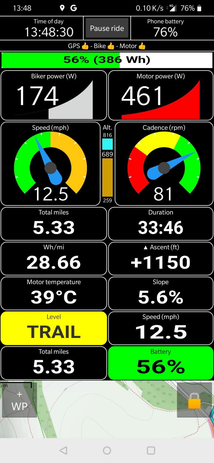

Hi Paulo, I'm loving the app!
I'm using the Vertical BM 2+2+2+2. Sometimes the Motor Power graph shows in red. Sometimes yellow and sometimes green. Can you tell me what causes the colour changes? Many thanks.

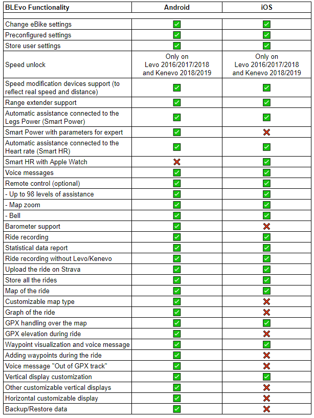

Hi Paolo,
I'm your app looks great and I'm really interested in using the heart rate function, getting fitter was one of the main reasons for getting my Levo.
I have a couple of questions if you don't mind, I've looked at the FAQ's and in this thread, but can't find anything, so hope you'll forgive me if they have been answered before.
Firstly, I want to use the app on a iPhone 6s running iOS 13.2.3, IN the app store it says 'iOS version doesn't have yet all the functionalities implemented' can you advise what is not available in the iOS version?
Second, what type of HR monitor is compatible? will something like this work?
Thanks, and hope you can help
PaoloBLEvo
Trader
Jun 13, 2018
1,457
1,191
Varese
Hi Paolo,
The HRM is good.
For the functionalities, please check this

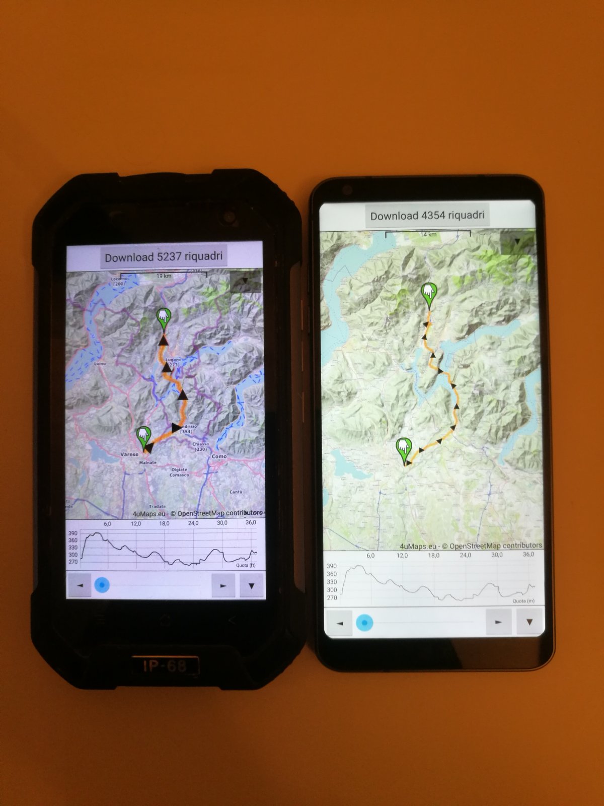

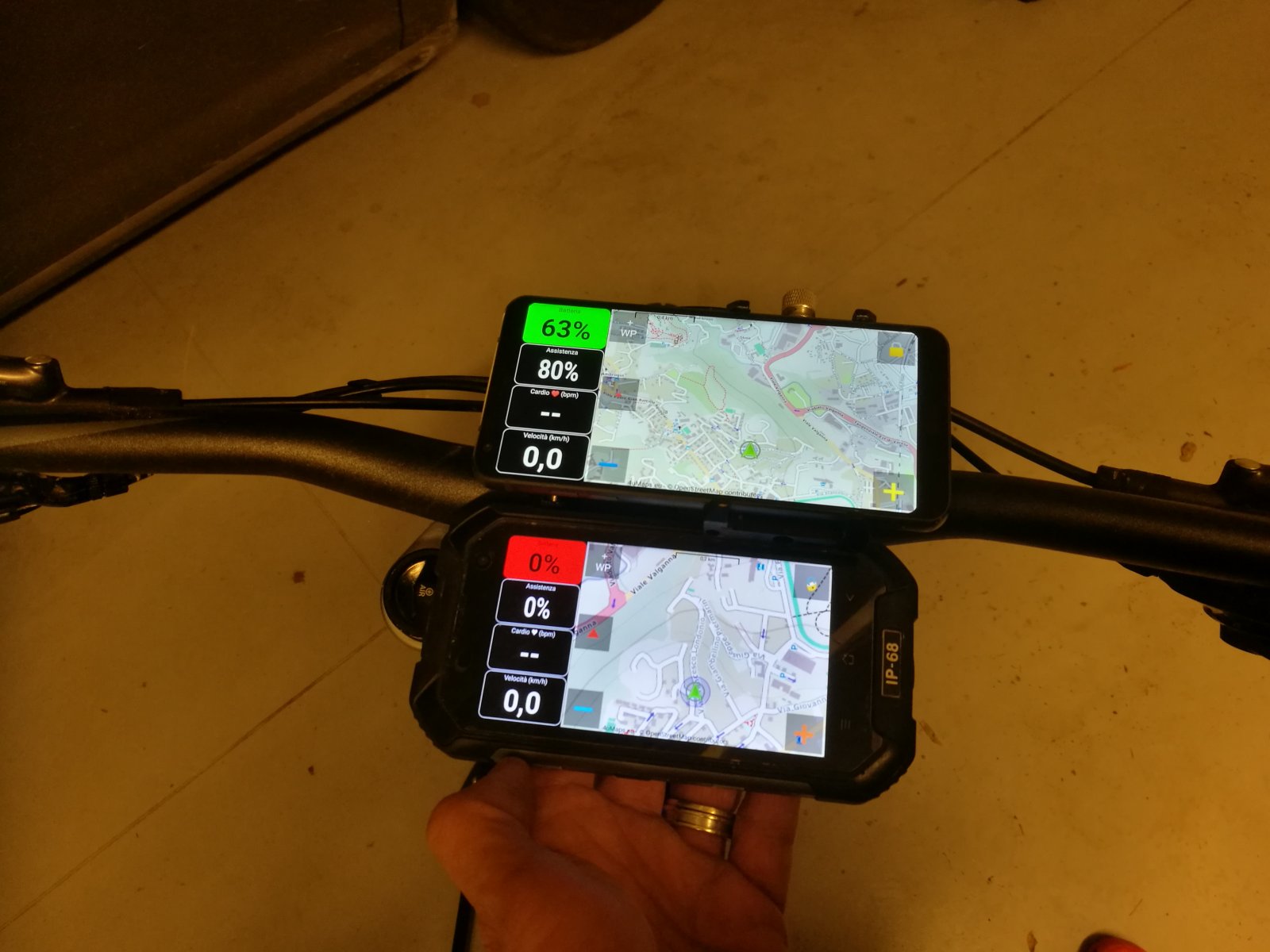

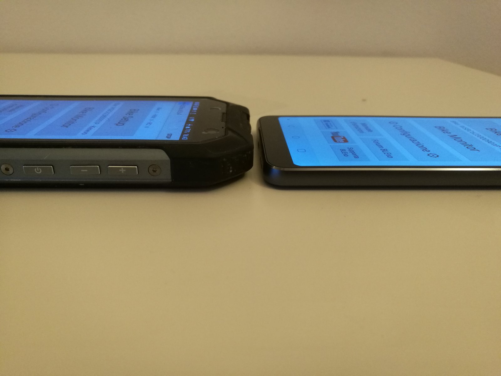

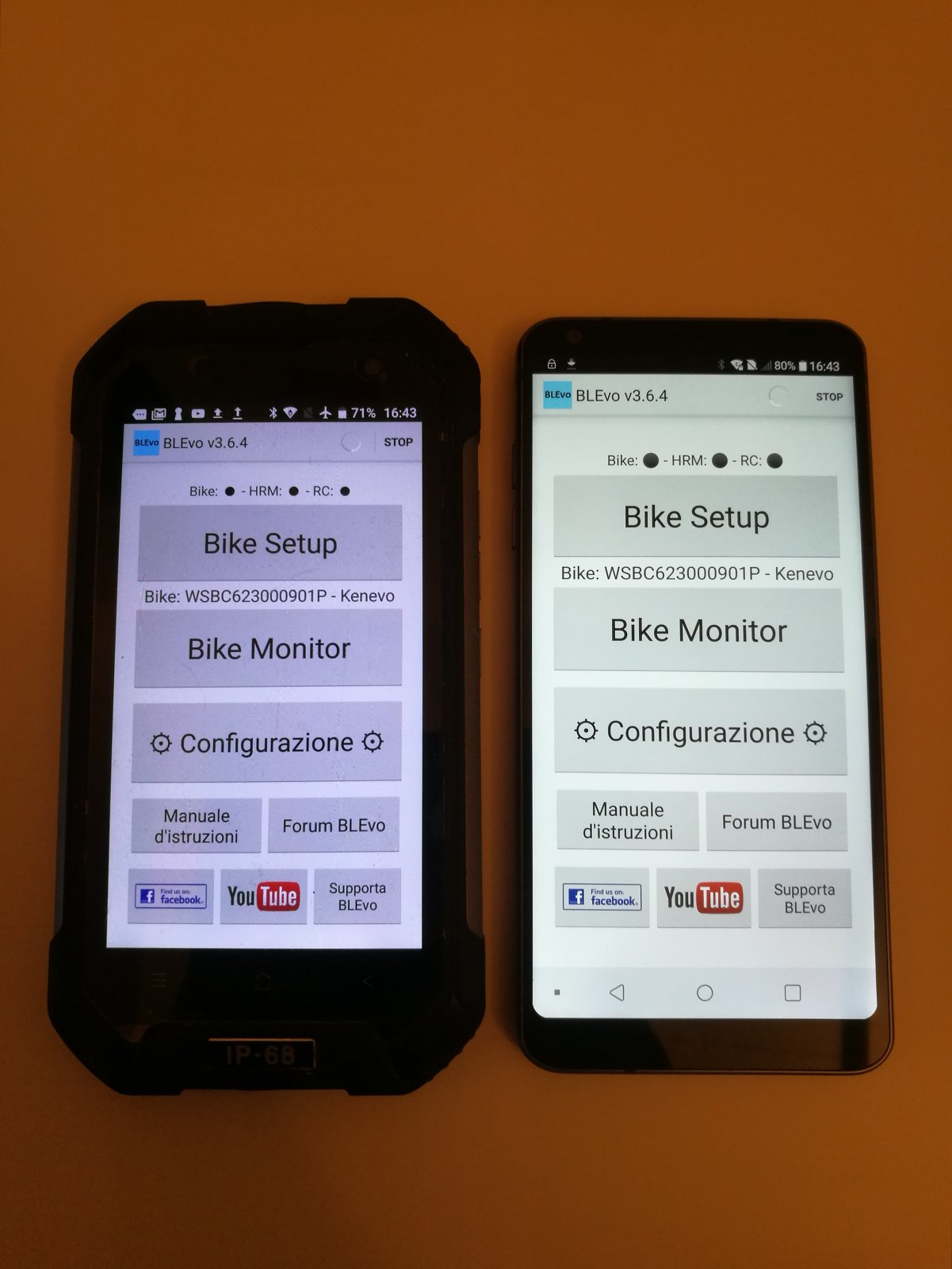

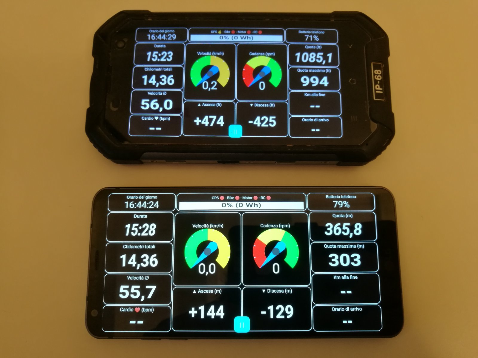

Today I did my first ride with the new phone LG G6..
The phone with the silicon cover stays very well in the GUB hokder, without any additional elastics.
The screen has very good characteristics for ride with BLEvo. My only doubt is the battery. It has "only" 3300mAh. The problem is the brightness of the bigger screen (5.5" instead 4.7" of the BV6000).
My ride was about for 2 hours and half and the phone has been with the screen on for all the time .. the battery left has been 30%.. but at the begin the brightness was at 100% and the first 30 minutes the battery went quickly down.. then I set the brightness to 50%. I will repeat the test starting with 50%.
Maybe this phone is not very good for a long ride, or for a ride with always the screen on.
You can switch off the screen and with BLEvo the screen can be switched on with the remote control, or changing the assistance level or when a waypoint is reached. This trick can be used for save some battery during long ride.
I attach some comparison pictures between LG G6 and BV6000
