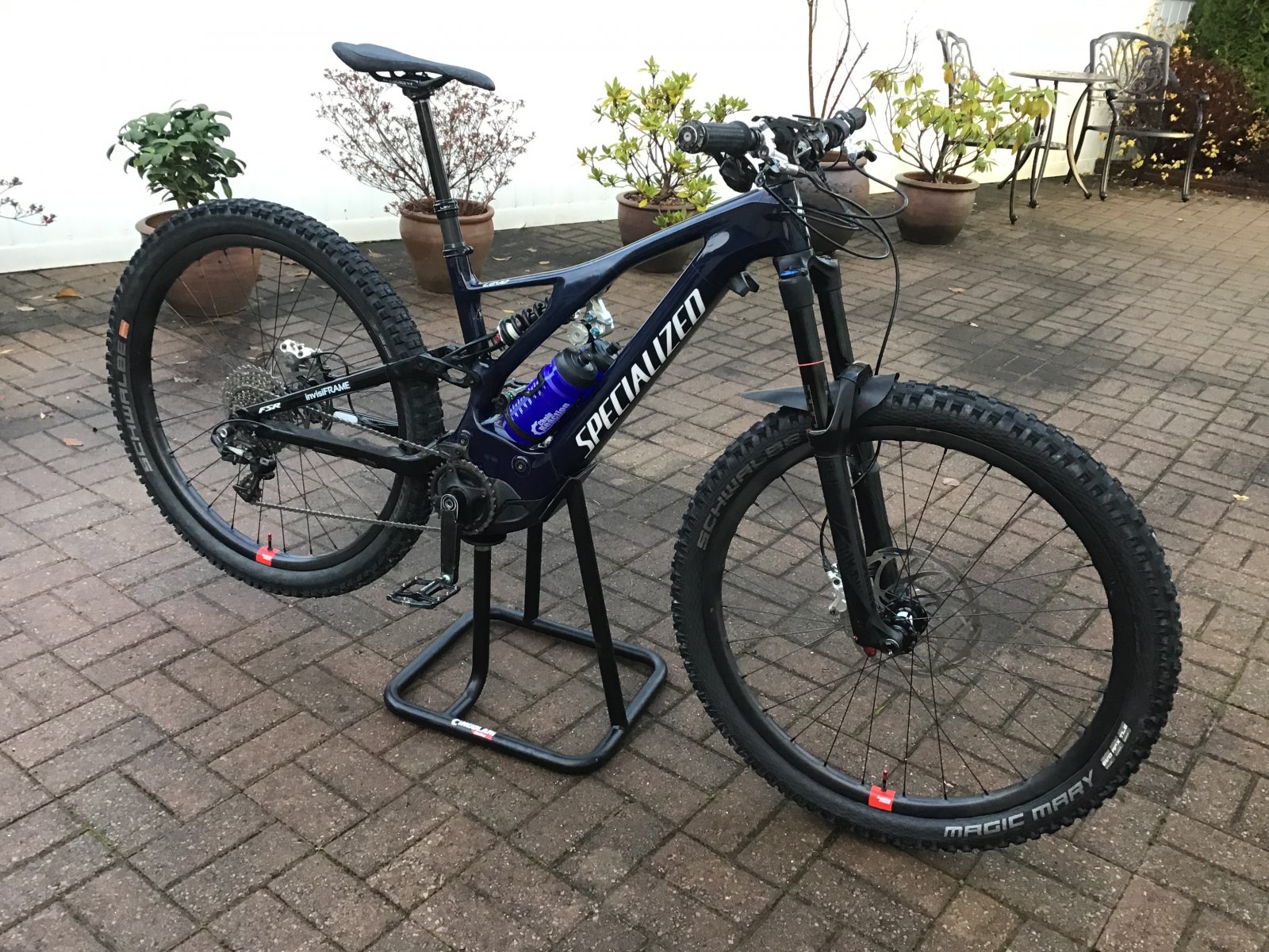

Hi BigFoot,
It’s a 2019.
I have 3 batteries. 2 x 500Wh and 1 x 700Wh
27 charges on 1 x 500Wh, 30 charges on the other 500Wh and 54 charges on the 700Wh.
Health percentage on both the 500 Wh battteries is 100% and 99% on the 700Wh.

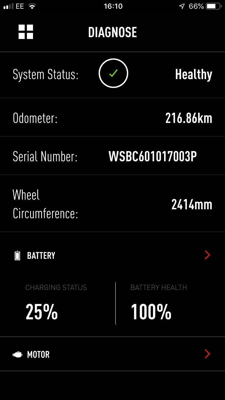

Hi all,
I have started to use BLEvo on my 2017 Levo first on IOS but changed to Android as it gives more functionalities. It really is a great app!
I do have some issues/questions that maybe somebody can help me with:
- In both apps (IOS and Android) the cadence and biker power are not showing anything above 0. I did switch on the fake channel in MC and put it on cadence. When I switch between MC and BLEvo (and do not switch off the bike in between) it does work. But when I disconnect both apps and the bike and restart the bike and only BLEvo (not MC) the dashboard doesn't show anything above 0. The control signs at the top of the screen all report a thumps up by the way. TCU version as shown in BLEvo is V1.7.0.
- Is there a similar functionality like 'smart control' in MC? I am a bit worried that I use all my battery capacity during trail riding and then there is no juice left to drive home :)

For the cadence issue, I think you need to disable the fake channel in MC, because BLEvo doesn't handle this value.
In order to save battery, try the Smart Power.. You have to set your legs power and BLEvo will adjust the assistance percentage to keep the same legs power for all the ride..
Thanks for your quick reply Paolo. I just tested it with a disabled fake channel but the same result. No power readings or cadence. And when I switch the 'use always GPS instead bike data' off I also do not get any speed readings. It looks like it doesn't communicate with the engine..
The only reading that I get in my dashboard is motor power.
So as long as I do not have any power readings I can't use the smart power with legs power functionality either.. Let me know if you have any suggestions to fix this
Which is the firmware version of the battery?
It seams that the speed sensor and cadence sensor doesn't work correctly..
Could you test with Mission Control?
If you have problem also with MC you can contact your dealer..
Firmware version of battery is 4.17.1.
In MC only first 100m all the sensors work. In MC motor information serial number, hardware and firmware are reporting a dash, no info only temperature.
Tommorow I’ll go to the dealer to reinstall the software and check the sensors. I’ll let you know when I have an update.

With MC you can start the ride and select what you see on the dash board..
Please select cadence and speed and check if the value are correct..

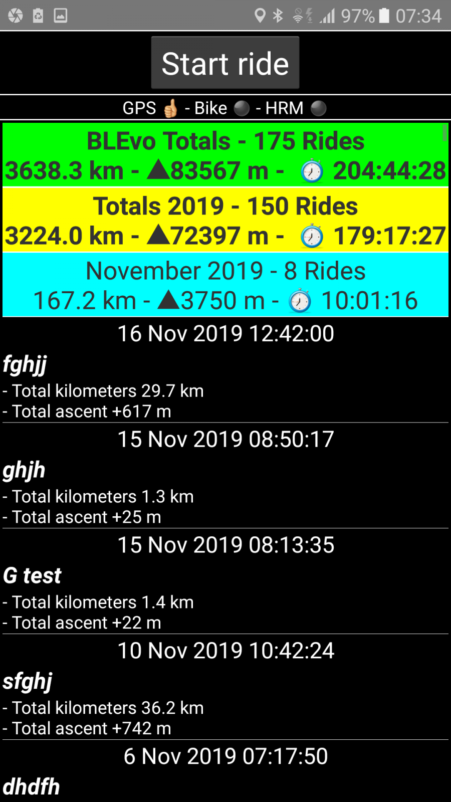

Hello
Been using Blevo for a year now. Been using golden cheetah software to analyze the tcx files. Anybody know of a software that can analyze the .csv file exports ? There is way more information in those files.

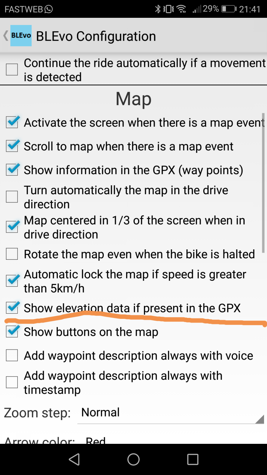

@PaoloBLEvo
I went on a known ride of about 16 miles today and the BLEvo details are correct. However, the map of the ride stops at 9 mi and the Strava upload also shows 9, not 16. I did stop for a while at 9 mi and the bike auto turned off but I restated and continued no problem. Again, the ride details are correct but only the map stopped when the bike turned off.
This was in previous v3.6.0. Maybe fixed in 3.6.2?

@PaoloBLEvo
This is because the GPS is not under coverage.. the distance is calculated with the bike sensor.. Please check the CSV file and see if the GPS accuracy is not good..
