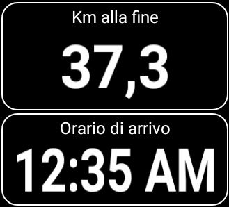

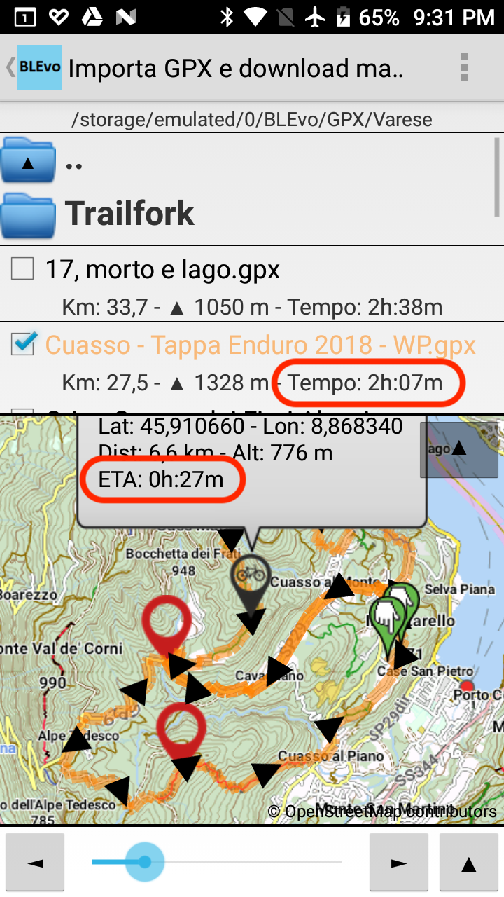

Version 3.6.3 of BLEvo for Android is available on Google Play.
I have introduced the visualization of the kilometers to the destination (if a GPX is selected to follow) and the ETA (Estimate Time Arrival) that is the arrival time foreseen in the bike monitor. This value is approximate but gives a good idea of the end time. Probably in the next versions I will optimize the calculation based on the cyclist's statistical data. For the moment it is a fairly good estimate.
In the GPX management, it is now also possible to view the estimated travel time. This is also an estimate. The value may depend on many factors that BLEvo does not consider.
Here are all the news.
- Now the language configuration of the vocal messages, also configures the language of BLEvo
- Added the ETA field (Estimate time arrival) and the field to know how many KMs are missing
- Added average speed calculation for up / down
- Now the Smart Power in non Expert has the leg power decreased in TRAIL and TURBO
- Bug fix: GPX import with particular name
- Bug fix: The bike monitor always restored the preset settings
