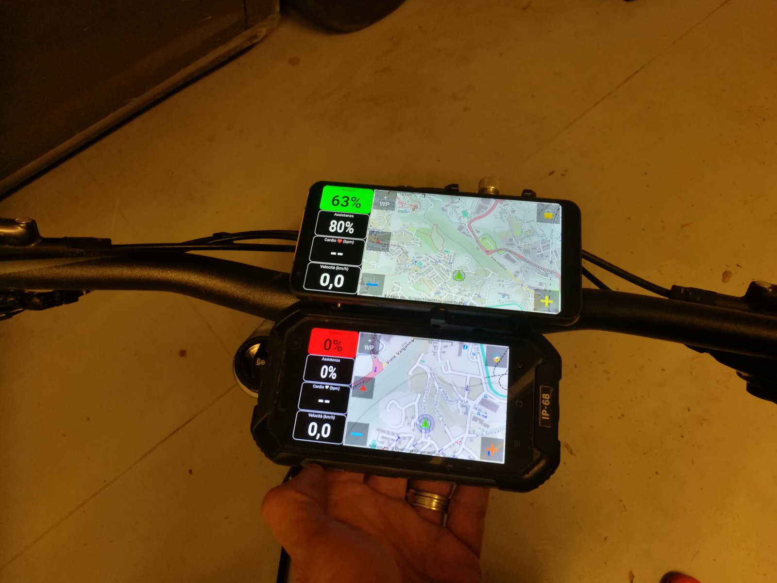

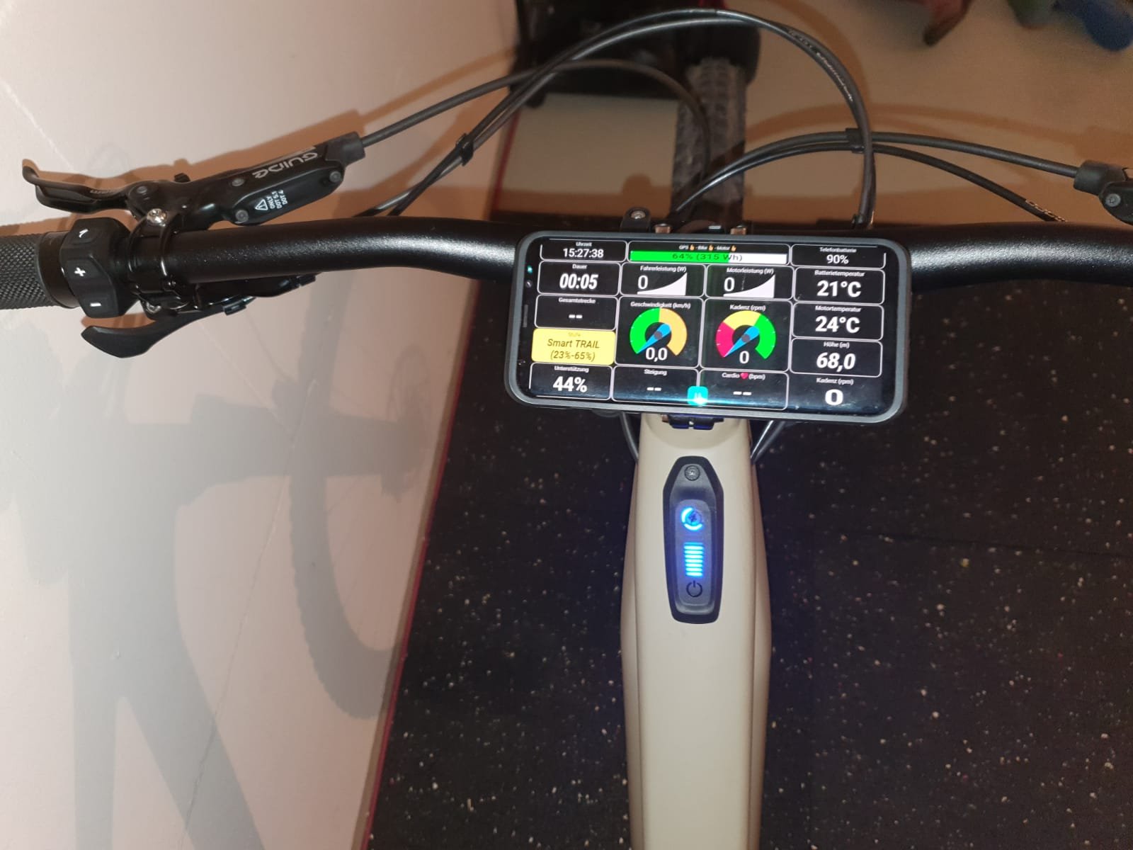

Today I did my first ride with the new phone LG G6..
The phone with the silicon cover stays very well in the GUB hokder, without any additional elastics.
The screen has very good characteristics for ride with BLEvo. My only doubt is the battery. It has "only" 3300mAh. The problem is the brightness of the bigger screen (5.5" instead 4.7" of the BV6000).
My ride was about for 2 hours and half and the phone has been with the screen on for all the time .. the battery left has been 30%.. but at the begin the brightness was at 100% and the first 30 minutes the battery went quickly down.. then I set the brightness to 50%. I will repeat the test starting with 50%.
Maybe this phone is not very good for a long ride, or for a ride with always the screen on.
You can switch off the screen and with BLEvo the screen can be switched on with the remote control, or changing the assistance level or when a waypoint is reached. This trick can be used for save some battery during long ride.

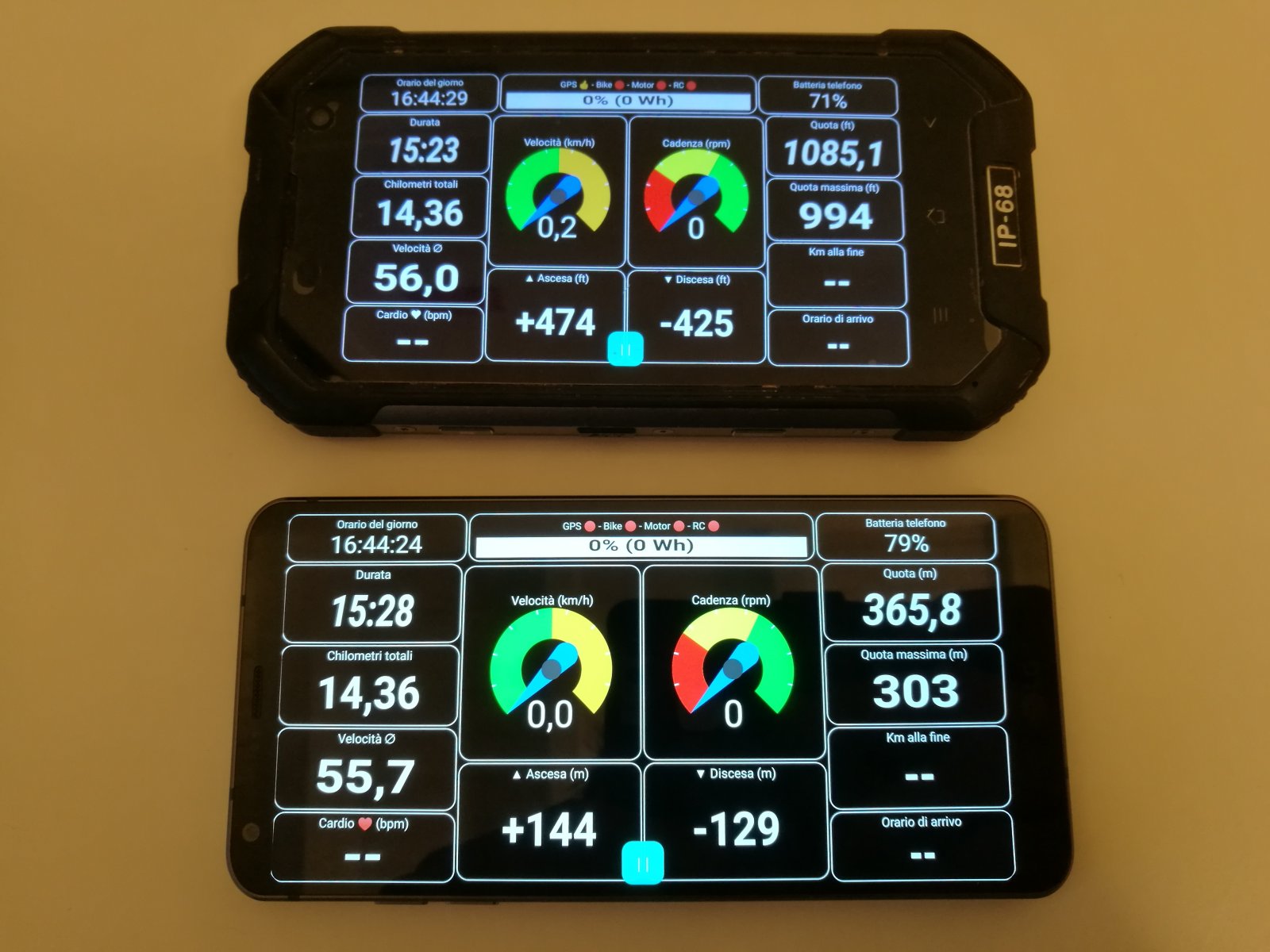

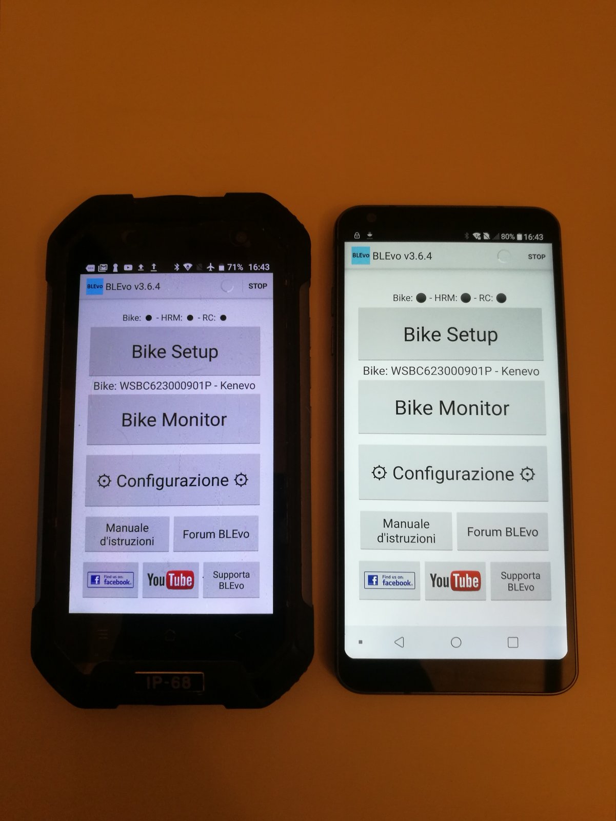

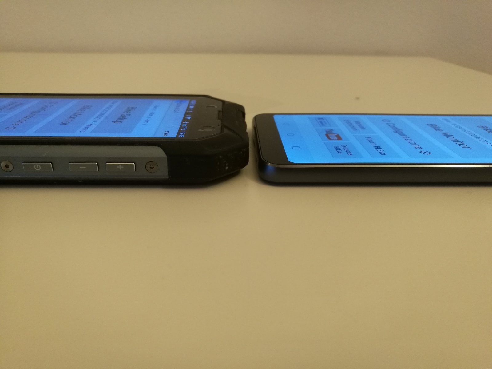

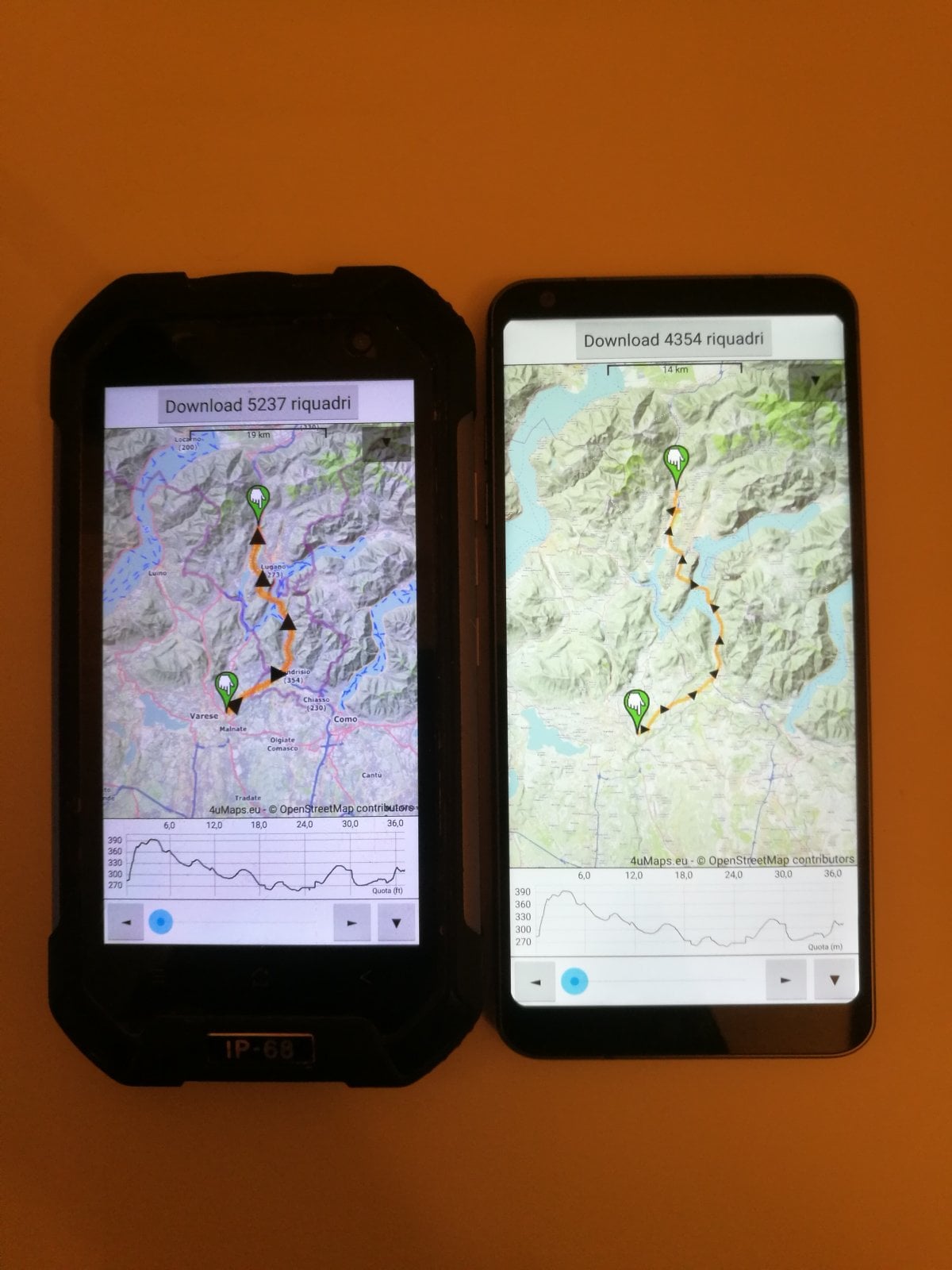

I attach some comparison pictures between LG G6 and BV6000
View attachment 22847 View attachment 22848 View attachment 22849 View attachment 22850

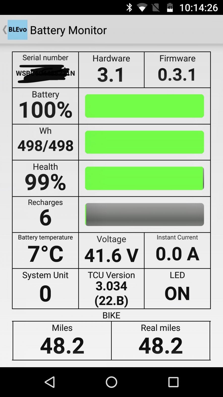

can someone please tell me how the real mile function works? My bike is delimited and I have adjusted the speed toggle to compensate so I was expecting the app to us this speed adjustment to produce the real miles figure, but both miles and real miles are showing the same figure being what the bike thinks it’s done which is 50% less than the actual.
thanks
PaoloBLEvo
Trader
Jun 13, 2018
1,456
1,188
Varese
Hi all
thanks
The real miles are calculated based on the fake will size.. but if you have some unlock system like Levociraptor, BLEvo will not adjust the value..
Maybe I will remove this field because can be misunderstood..

My first ride with LG G3 mod with big battery pack. Used about 20% of battery with screen always on (auto brightness). Seems ok.
For LG G6 and its battery there is an solution ive got. A headlight with powerbank function. My Garicon:
Buy Products Online from China Wholesalers at Aliexpress.com
It has a powerbank function and can light when charging...
rb40oChm2E2WxU1ScL-WgM6i2aqXevJvdLlNc_P9vk-9RSwCqtnJTU2fpk_1JbXObcWQFihA8q87Fg4vJFGkwpNsPmWkTgjS8j6GC5tY-MXr8o3AboqknFe9DTp_G1wXC8ocqZIuhnnUKSuUZo475bYDK4W_sb4B16lVbg6tuJcVEqjE0W6B4S1cGISZavv3boMaG9Bp7lEc0Od3kRppa-YwVa47FEoB7sQ2DMgCo9HbupaU49rmWWh6Og0P9thPsj04efitBW8hW4IEeoOI6e89WAUCYprDk8MOvQy6jNM3mlObAaendcAIUYD-Ie4TJbkbCYWAKlZ94qWYRDkZOOAV3Tzw0E-IWNJ9UXEi1duPFu-1uJR_W1q1_uJ3KB_Ph7hv3sbN5b4346I3UP1kL8ZgPmSTHvYD9PDEONEocP1Q8uNdZDH1jY5agiwNprph2CA7fLUjkizW2hUsI0upaJGDVIKxOPVKLx90FCGvwlt3f4F0HxlFao3zK0Ke0PHC6oTl9o6NLN37OxfYGxmv7v42cgXlCvBCmMcVrt1EbzLWdLejlKvSt9WjlwheZ3sny__8RvOigJmEirsXxczRub3xpcFA_dLrMnTdZTgWHiBlJunG9cei9Hxhwbm1vXuhE6s_XVP3OGSKppJ7yPWuN7BJpL8KNR1a5_4a3CaVe_ZoxO8TM_iSWdIewsc95BRG2WW7gruOk5DiY2I0uYRgR_gr5LF-rsMBbJO1gybSy90-wmtDAA=w1263-h947-no
ms3tfbcmpMjXiGGHkZfZZiBtO_TosETkuLXbS0FcDle2gKTDRPFv5-YcpyY5l88vLmfQ6iizXPAJRdktFRUxo2OC0a8sglEAYp1VZYpxfy6U7yB9ZUDHQD-TkUMHrcZGU1uteLGl_e67b4A_Dp391LXzW19v8faB3wlh2UCKFwCvncjJ0NEPWwVCFi2pJXjd6ClluX_mWEk23owx6p-tS7Ir7dfWcohhXVOlNDBrJ9Go93ct0MOlrVsao2M4LXkXzVdt68nlwC2IQ4VgNUfWm4LP6HiuQG8CYCGK8gyhZOEAiZasXidmQKafWcYp8_nEuH6TbAM92yDiFkVu68jEWnAA4NCaO3Pg6EYvWAgaICgGRJ1uzkN49_rKF7mhmaTL_4I1p63kbIql7FbUFab_EqPS04szu7D-toOF0Ni8MrEBnukclzlgfHQXqrzl6fBuOSbZqF3dAZe0SBOYaA4sl1WHTlOBQv5NJ0UqbtN39avdIY5c5W8VVzFict0pddNwS6vjzHRi6Tgfv0dqAluuTnSMPQ3ZbXvmsQkwWqfYXiFAEZ-ftRoSYY5IZxnXX7vhn4-gAlWhBFchjnumSLVey3cr8uefL3NLjpS76vVeaxIVhqPg4CUXALWIUNfwgAkh1hOQMpQhhEdZnsFsCJa065me2o_oKEy6XzIQqM9zDRXNLwfu9T8gZxAsH-a5yot8q_E2pTtfmlEOsde-7LXHzqOxVh1KA-dFLPNcBsDNV3iz4TwcJQ=w474-h947-no
I made this photo with my LG G6 thats normally rides with me in GUB10.
