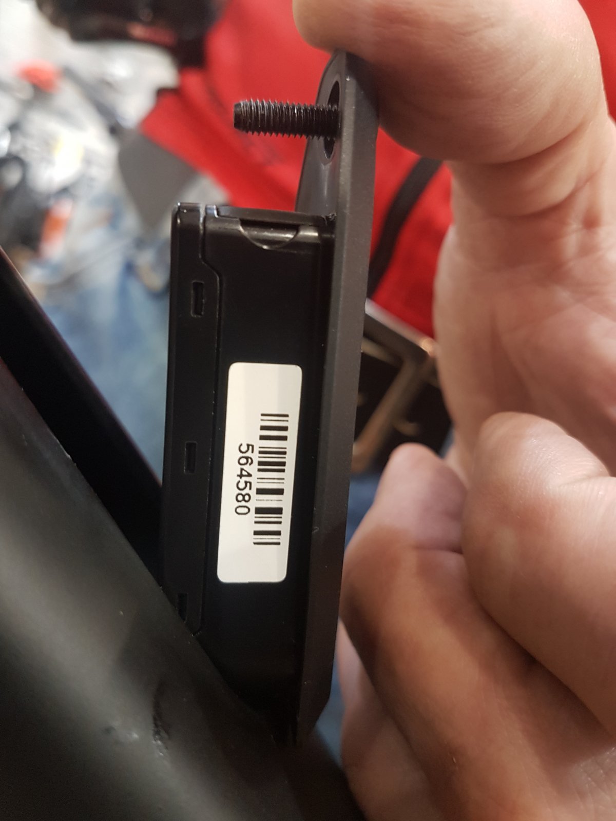

Sorry if this is answered elsewhere, i am trying to connect Blevo to my just bought 2020 Levo Comp, with android and am getting asked for a pairing code, tried 0000, 1234 as suggested but cant pair
The answer is in the user manual.
"You may be presented to enter a passcode on first connection to the bike. This can be found on a yellow sticker in your manual or written on the back of the TCU module. For older bikes it may be 0000."
The TCU code is under the TCU and it is 6 digits code.. The proposal from Android or iOS about 0000 code is wrong. The older bikes should not be paired with the phone.. only with BLEvo and/or Mission Control..

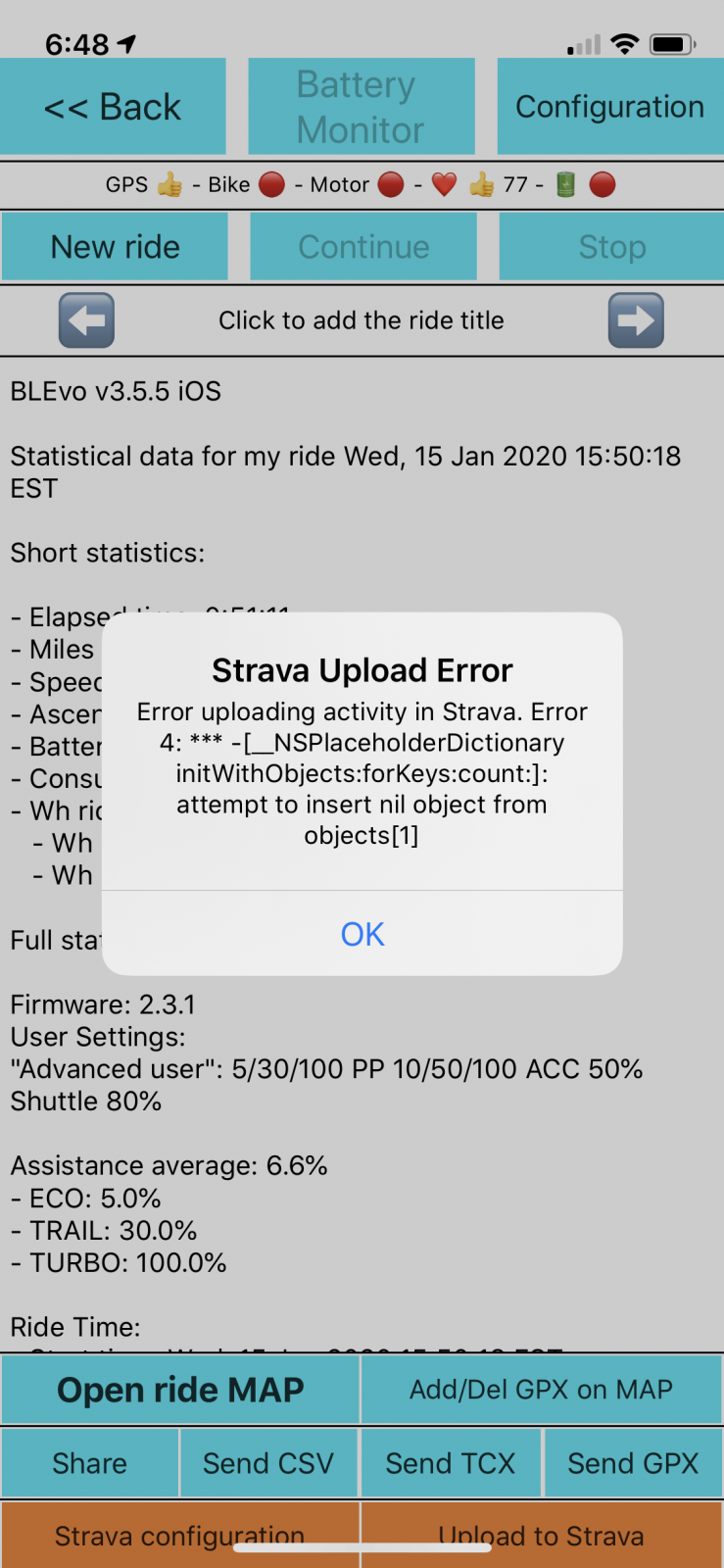

Having trouble uploading to Strava. This is the first time this has happened. I’ve attached the error message I’m getting.

Same for me....
Also I have the problem that Blevo crashes a lot (and stops to track my ride) and uses much more Battery on my iPhone compared to Mission Control

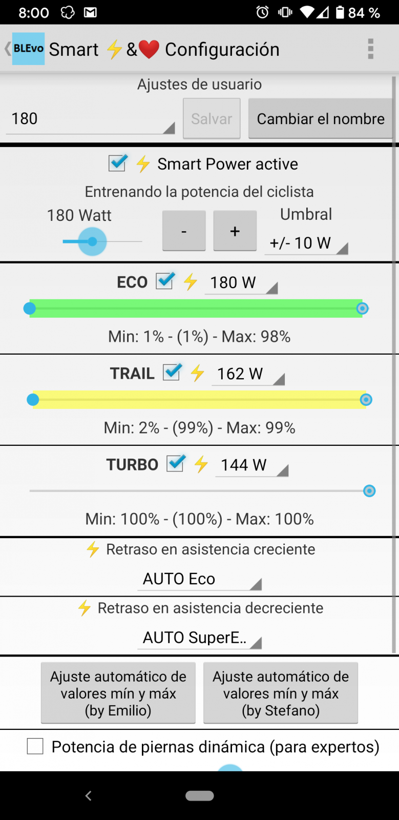

beutelfuchs
Aug 11, 2019
191
110
Barcelona
Hi @PaoloBLEvo
I can´t seem to get the smart power feature to work correctly.
What I want is to use e.g. 180 watts of my own all the time, the motor shall do the rest.
For that I use the settings shown below.
But what happens all the time is that the motor works way too much. Often I end up doing e.g. only 120 watts for a long time without the motor power tuning down.
BT connection to the phone is good, at least I can see my power and other status updates all the time.
Bike is a Kenevo 2020.
Do you have any idea what I could do wrong?

Hi @PaoloBLEvo
Which tcu version you have?
