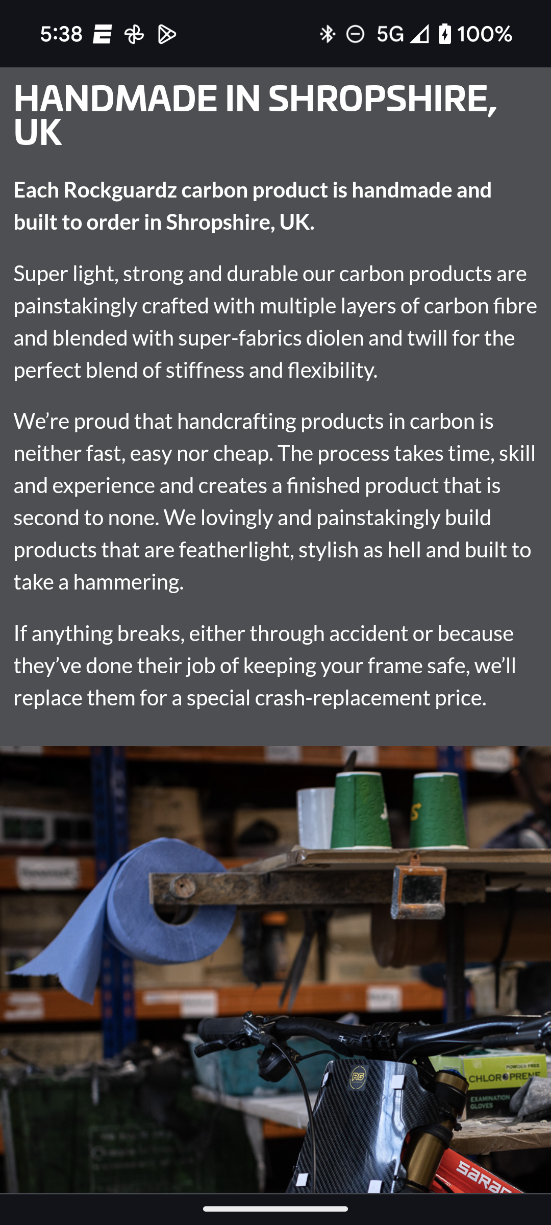

Yes, I imagine some challenges are in order. I detailed several CF motor guards in UK and one in the US in August of last year and then later in November/December.
I think a CF layup is the way to go. They're all handmade. A working prototype from one of these two bike shops (especially the UK one) seems most probable as to they fabricate Levos aftermarket. I shouldn't be crazy money requiring capital investors 😁💸
Too bad SZZS won't make in-house, it would be sooo cheap! They argue that a carbon guard will vibrate stress up to the carbon downtube. Technically, they could just reinforce the motor mount/downtube joint. I had them do that exactly for my warranty replacement frame when it came cracked at the mounting/motor guard tab during Initial shipment. (The additional layer added only another 50 g.)
But honestly, I doubt that it would be an issue. The carbon fiber layup is less strong than the CF HD moulded frame. So, the CF guard would fracture first and could easily be patched at home with a kit purchased online at eBay or Amazon.
I have absolutely no sign of my frame cracking with plastic/CF overlay. Maybe, it's the plastic buffering it, but I doubt it. The plastic just served as a contour mould to add extra weight. A stand-alone CF layup guard would be thin and super light.

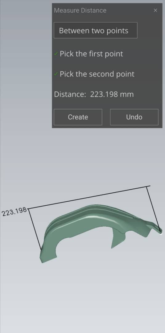

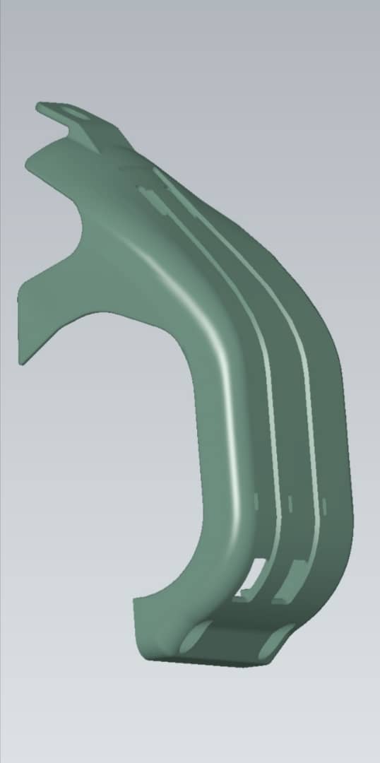

No need to 3d-Scan, I think there is a CAD-File of the guard somewhere...
Maybe trying to 3d-print it and then layer it up with carbon could work?!?
The CAD-file could be helpful. 👍
But probably easier/cheaper to just buy another SZZS plastic guard instead of 3-D printing it up.

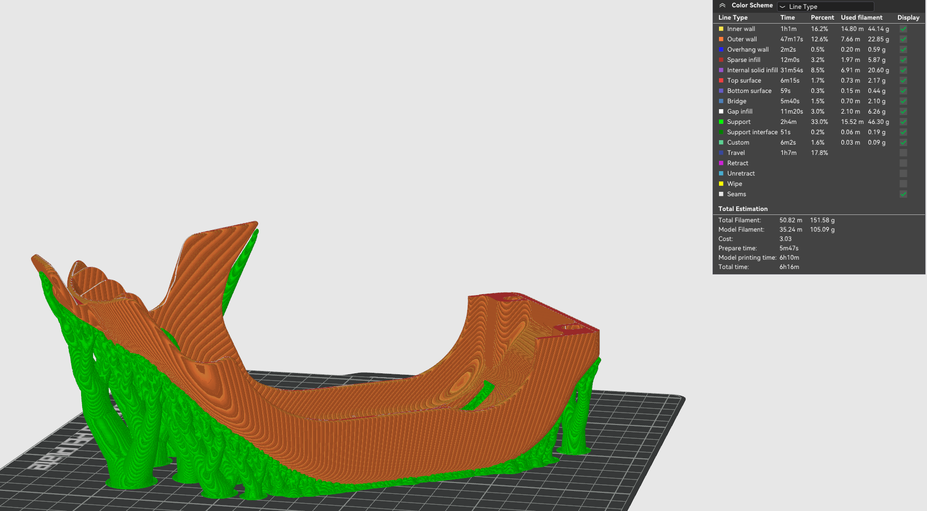

un..inc
Jun 13, 2023
127
111
About 7 hours Print-time and 150g of Filament...
Not to bad. Did absolutely NO optimization.
Maybe even orientating it differently might be better.
With additional carbon on top and bottom, it might be sturdy enough...
I'll try it this week with some PETG-CF or something similar. ;)

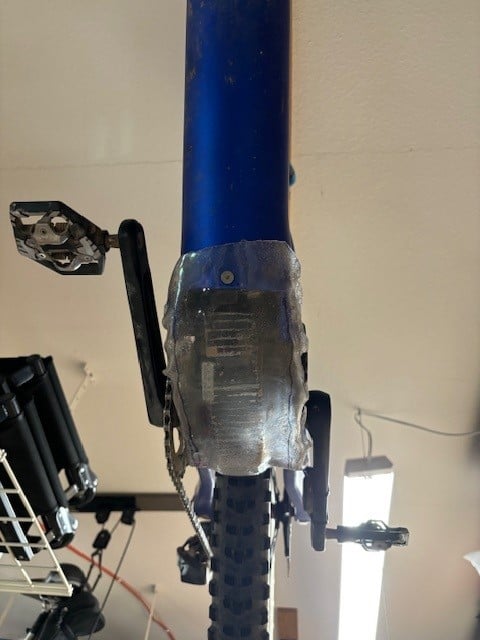

Here is the Lexan polycarbonate motor guard I made.
I just used a heat gun to soften it enough to bend, as you can tell I over heated it in a lot of places.
The right way to do it would have been to make a form out of plaster or something and heat the Lexan carefully in a oven and drape it over the mold.
I tested it by hitting it with a hammer and it absorbs the impacts nicely.
Bottom line: it protects.👊

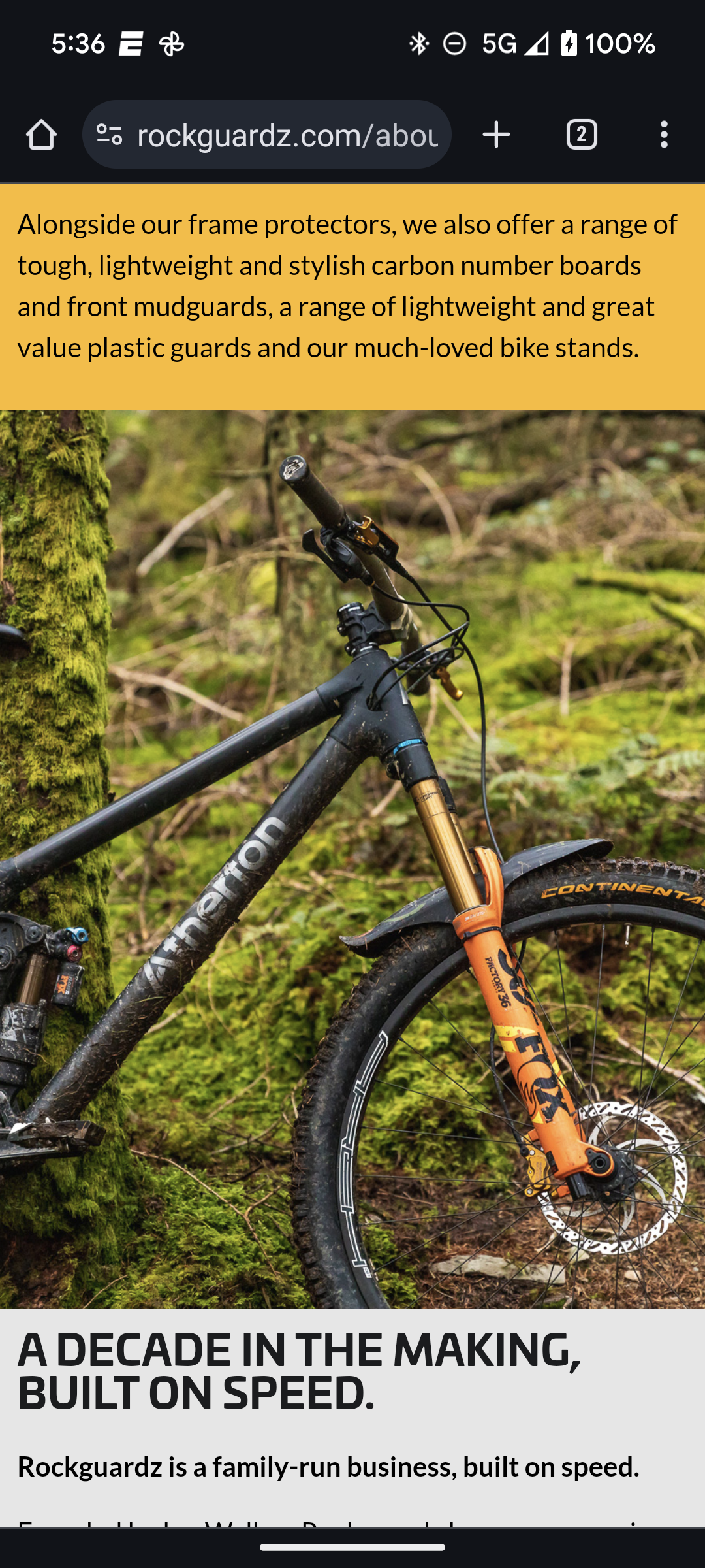

We'll see what happens. I'll post any and all responses. But my bet would be Rockguardz.com. I'll repost some highlights of the basic process from their website:

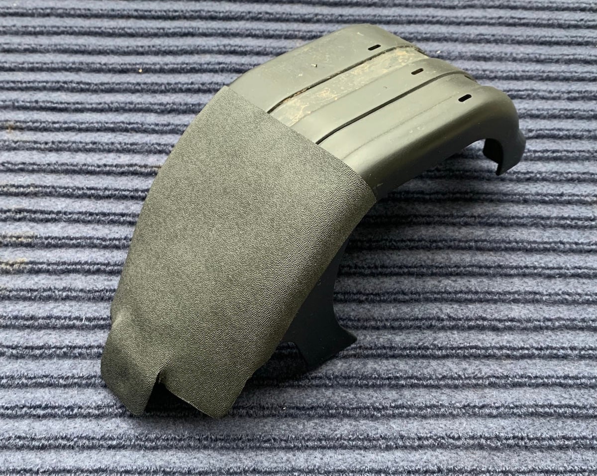

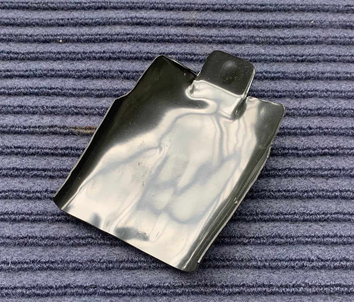

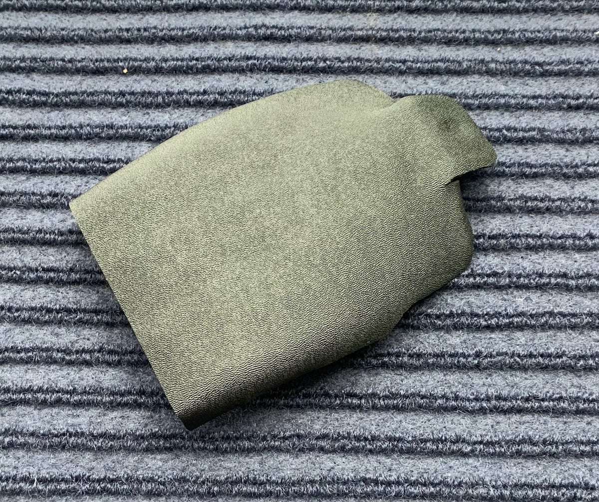

Good morning everyone. My engine cover cracked so I made a protector out of Kydex.
If it was 2mm thick it would be difficult to mold, or rather the base material (motor cover) would be distorted by the heat, so I made it 1mm thick and it came out beautifully.Kydex is easy to obtain and form, so I recommend it.
I'll try this for a while to see if it breaks.
View attachment 142758 View attachment 142759 View attachment 142760
Good idea💪....but i'd consider covering ALL the underside and side fairings. A few of us had the motor guard completely shatter into ten pieces plus just on soft branches/wood step-ups.
Check out last July and August of last year on this thread.🍻
