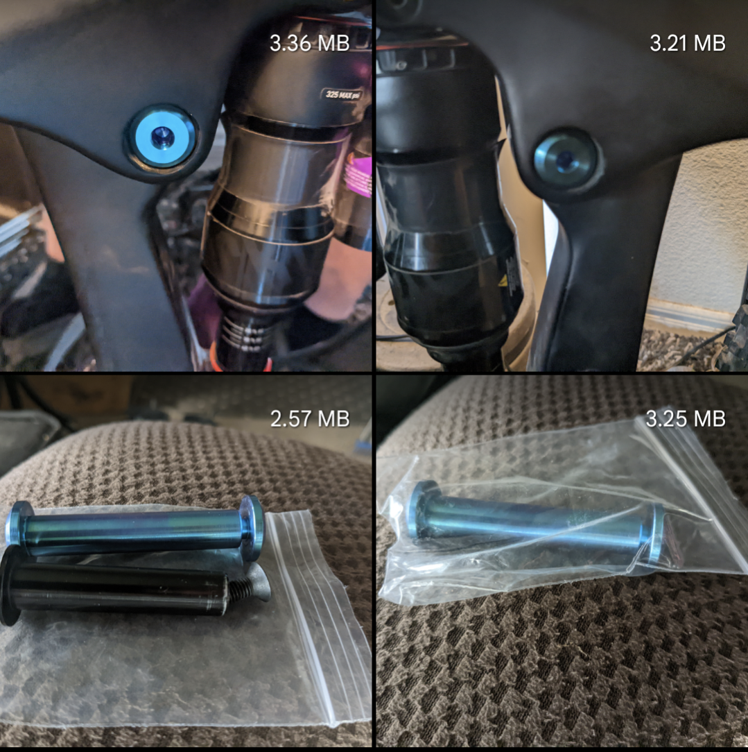

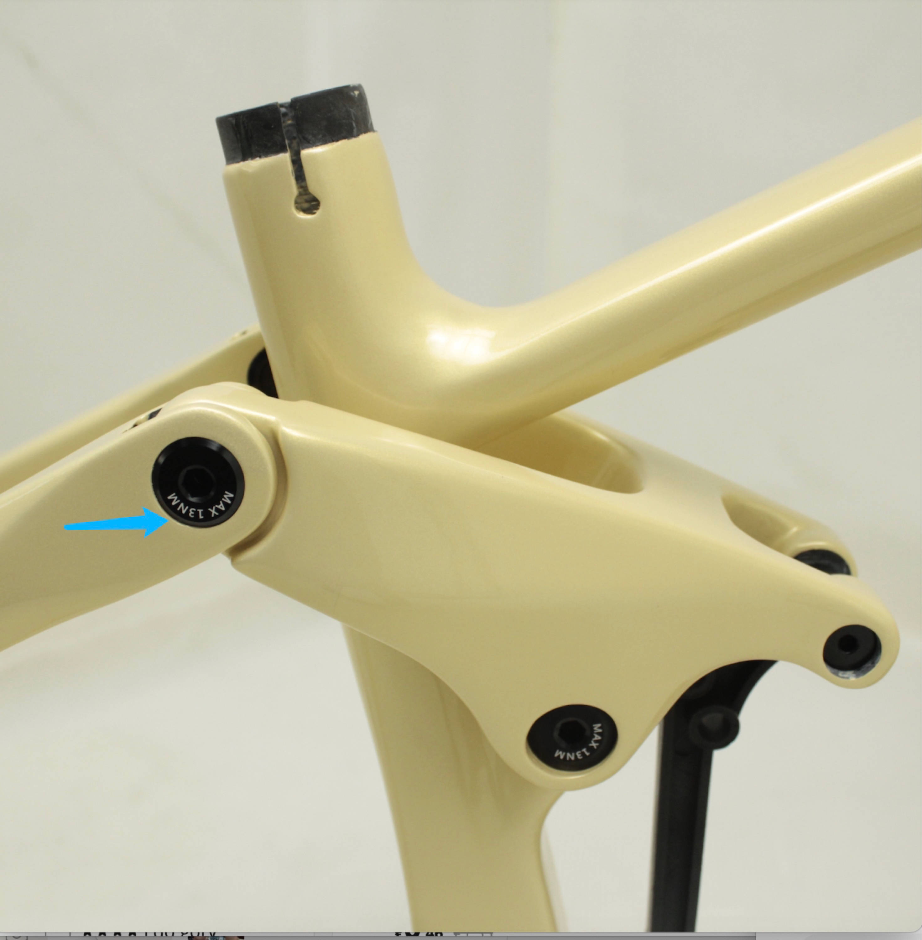

Alright, alright! Good news for me...a perfect fit. One bling-bling, blue Ti main pivot bolt.👑💎💰🎰. Costs $80, but only 4 days to get to my door.🤛
I figure the shorter black alloy OEM one somehow caught enough of the inside bushing edge to bridge the gap when tightened down.🤯
Now just waiting on my warranty front triangle replacement (days away now), and then I can finally finish the originally intended painted build.
Glad no one else had this type of bad luck with the frame.🍻

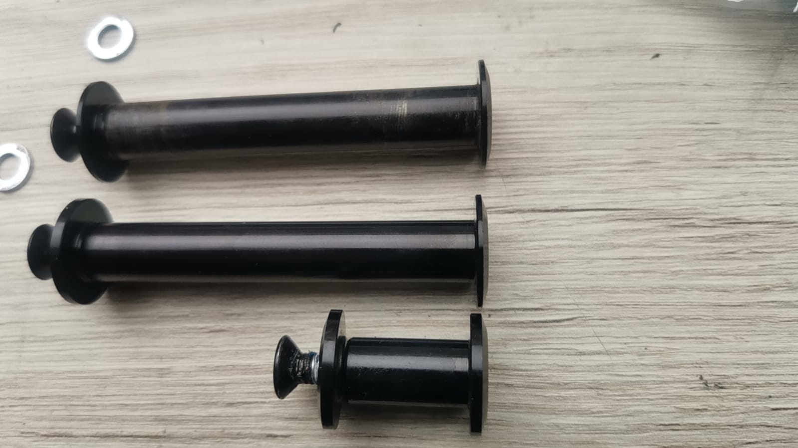

frame and engine arrived.
first i went to check the pivot bolts. both screws are short 4.5 millimeters. they barely pass 1mm to the other side. I think I will make new ones from the thruaxle.

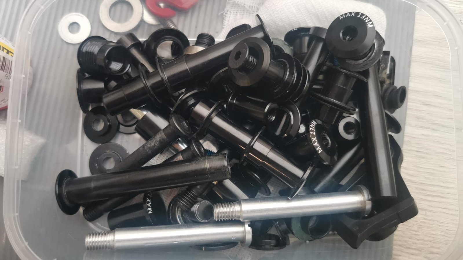

exemple (it's the same on all axles). it's broken when i have tried to tighten the swing arm axel to recommended torque (12 nM)
It's unpleasant when such little things happen. But they are easy to fix. Well, I bought bolts with a stock for CEF49 and CEF50. There are two versions of bolts with a thin edge and a thick one. Write to Jean, she will send you the bolts.
