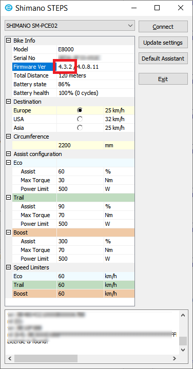

I downgraded FW to 4.3.2 and tested a Speed Limit. It's possible to set it up to 60km/h! Unfortunately, my 7000 display doesn't work with 4.3.2 FW
Also, it's possible to rise the Power Limit up to 600W, but I didn't test the bike yet, and don't know how it will affect on motor assistant.

I can't see how you would do this within STunlocker? Unless you set the diameter of the rear wheel to something very small?
I did exactly that with my E7000. along with changing reigion it was derestricted to 51kmh/32mph
Same as my E8000
Wouldn't really want it derestricted to 60kmh - gearing wouldn't be ideal and holding 51km on the flat for sustained periods even with assistance isn't exactly an easy pedal. anything above 20mph and your effort is mainly against wind resistance.

4.8.0 is 100% supported. You can derestrict a bike with 4.8.0 via Bluetooth

Is there any option with ST to totally de-restrict the motor? Or to go back to being able to set max speeds for each mode as with 4.3.2.
Thanks for the App ;)
No. It requires a custom firmware, but nobody wants to use a custom firmware...
