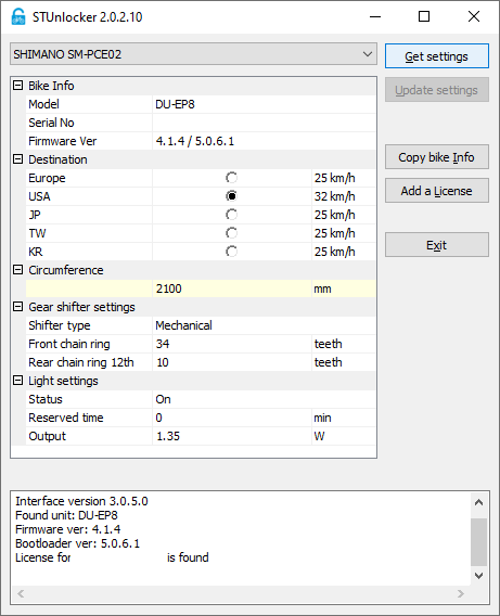

The new Windows version of STUnlocker was made to support all latest FWs. It's not require to downgrade the FW for derestriction. The new version has only features which are not available in Android/iOS App without FW downgrading.
The Premium licence is compatible with Android/iOS licence and costs the same.
What are the requirements?
1. Windows running laptop with Bluetooth to connect to the bike?
2. PCE Cable?

This software works with Shimano PCE interface only.
Downgrade your 4.9 FW to 4.8 via Bluetooth and use the Android/iOS App for derestriction

Ok, once again: all latest FWs doesn't support any "derestriction" features via Bluetooth.

Why not to downgrade? It takes 5 minutes and 100% safe (if you carefully read the disclaimer and understand what you doing)
and @Vadll: I assume this based on a design change in the shimano Software/Firmware and not an issue of finding a solution for this.
No. It's because the derestriction via Bluetooth is too easy for bike owners and they decided to make this process not so easy.
