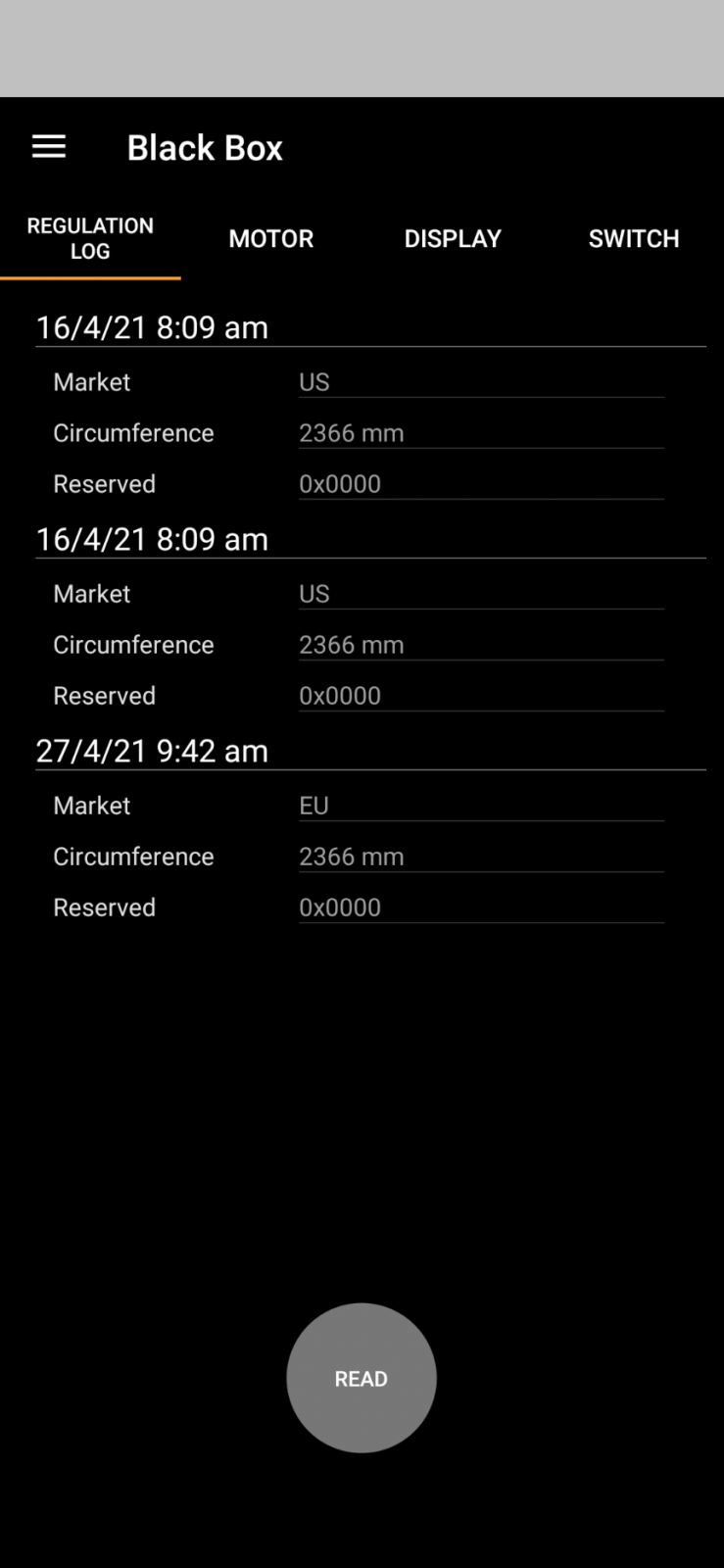

So, has anyone worked out how to reset the shimano EP8 inbuilt regulation check?
What do you mean? On most bikes the regulation log has only one record, this is what dealers/importer/manufacturer set into the motor.
WogsRus
Sep 13, 2021
43
21
Tasmania, Hobart
Sh
Shimano keeps a log of the changes done to the software/region/tyre cicumfernce Iman area of the etube professional app called 'regulation checker' so it can be seen what changes are made.
Unbelievable. First of all, it's possible to change settings via bluetooth only on 4.0.2 version, this version doesn't add any records into regulation log. It's 100% proven by hundreds of owners
So, I would like to see any proofs from you!
That might be the case, but if you then upgrade to 4.1.5 or the bike shops upgrades to the newer software on your behalf, the log exist

Hi
According to other screenshots that you posted via PM to me, this bike does not have STUnlocker Premium licence. It means that those records was added by other App or by a dealer's shop.

SO I'm simply trying to see if anyone has seen this and or heard of it before as to what the "Regulation checker" is, how is it stored, etc. As it seams to be a new thing since the 4.1.5 software has been added to the EP8 motor.
As I said before, it's not because of firmware. It's because of a tool (App or Windows software) which was used for changing the region/circumference. This tool has added recrords into the regulation log.
STUnlocker does not add records into the regulation log

HANG on, i think i just worked it out....It happened in the factory.
I didn't receive my bike till the 24th of June, and didn't start riding till the 27th due to an issue with the bike. So it looks like the first lot of changes for the 16th June happened in factory....
SO it looks like the factory changed it from US to EU spec. Weird
