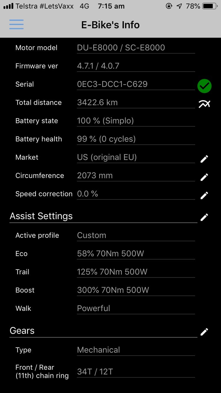

Thanks! View attachment 78188
What app is this ?

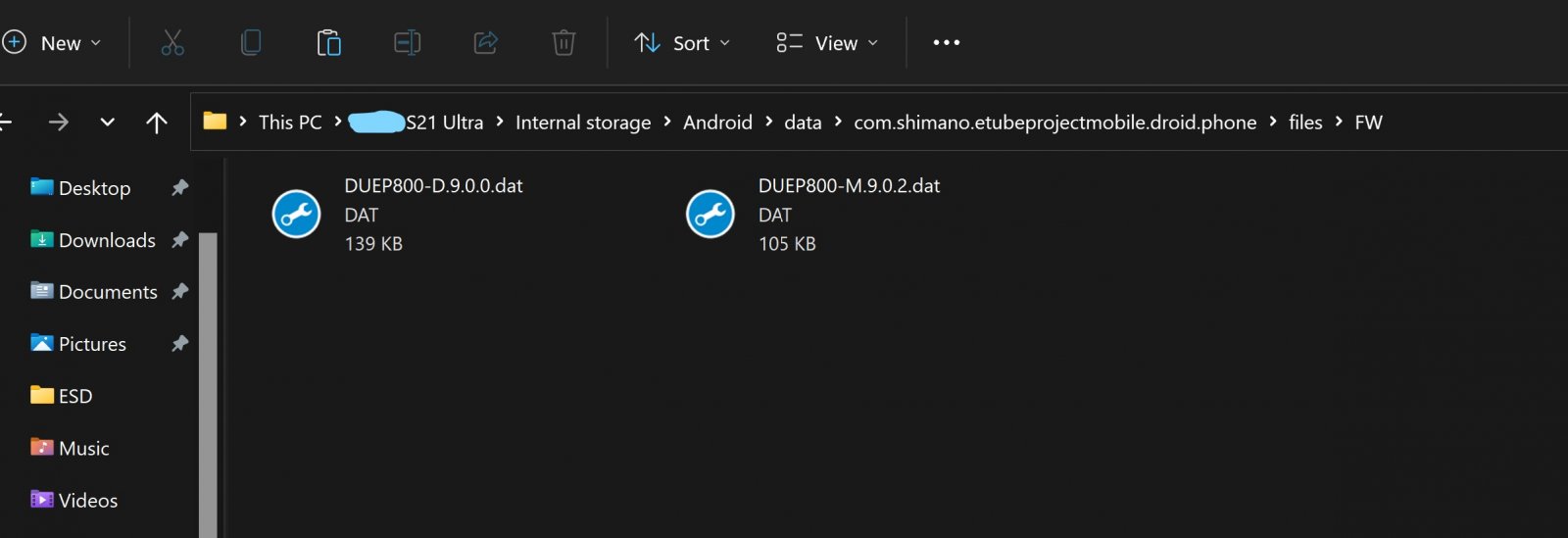

So I just got an Orbea Rise H10 but i upgraded fw to latest 4.1.8 by accident. I have copied the 2 files to the android fw folder, I tried to remove all files and just keep these 2 files and also just copied them with all other files, but it will not give me option to downgrade the software FW, it just stays on update page with no option to downgrade. Suggestions?
The downgrade firmware normally have a file name larger than existing firmware. It is typically 5.0.2 on the file name but is actually 4.0.2 firmware and hence the system things it is upgrading not downgrading. You should typically delete all the files from the FW folder and replace only with the 2 files that you need to downgrade.
I tried that. It is not prompting to update firmware.

Did you update the ETUBE application to version 5.0.3. `There is a comment in the update that says "Improved the modification detection function for unauthorised tuning" I wondered when i saw that how they could do it in ETUBE instead of the motor firmware but it is possible they are now preventing downgrades of the firmware somehow.
This is only a guess.

I am not sure about downgrading but that could mean that it will detect if the motor output (in W) or torque has not the default values also...
Edited: Yes, it has been confirmed that you cannot downgrade (yet) with the latest e-tube app. You have to install an old version.
Where can I get older version?

No you dont need additional files there. I have only those two and it is working. Just be sure you have etube 5.0.2 or older.
however mine were 5.0.0 and 5.0.2 not 9.x.x
