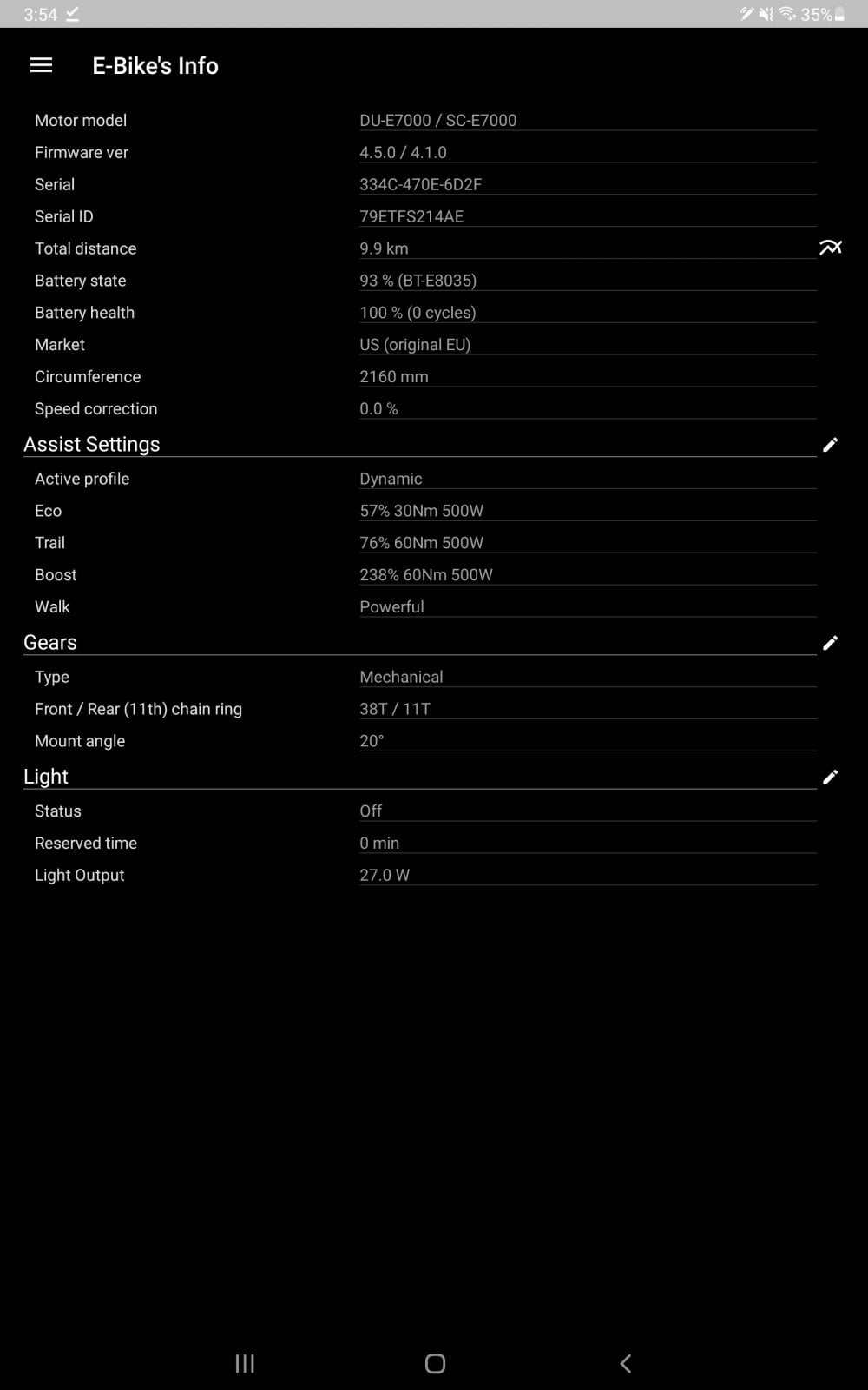

Does the license only worth for 1 bike at a time? Or do I have to buy a new one every time I get a new bike? Cause it doesn't work with my new bike for some reason, downgrade to 4.5, e7000 but the circumference can't be changed or the country unlike my previous bike

This is what Shimano can see, even if all settings are returned to original ... in case you need to use your warranty.
I see the same messages when settings of my bike is not default. With default settings I don't have any messages.
Could you send me a screenshot from STUnlocker with the bike's info and regulation settings (if it's EP8) and I'll tell you what is not changed to default/factory.
OK ... apologies, I reset also the assist settings, and the warning has gone. I'll just delete the post, thought it was a new feature in etube professional.
