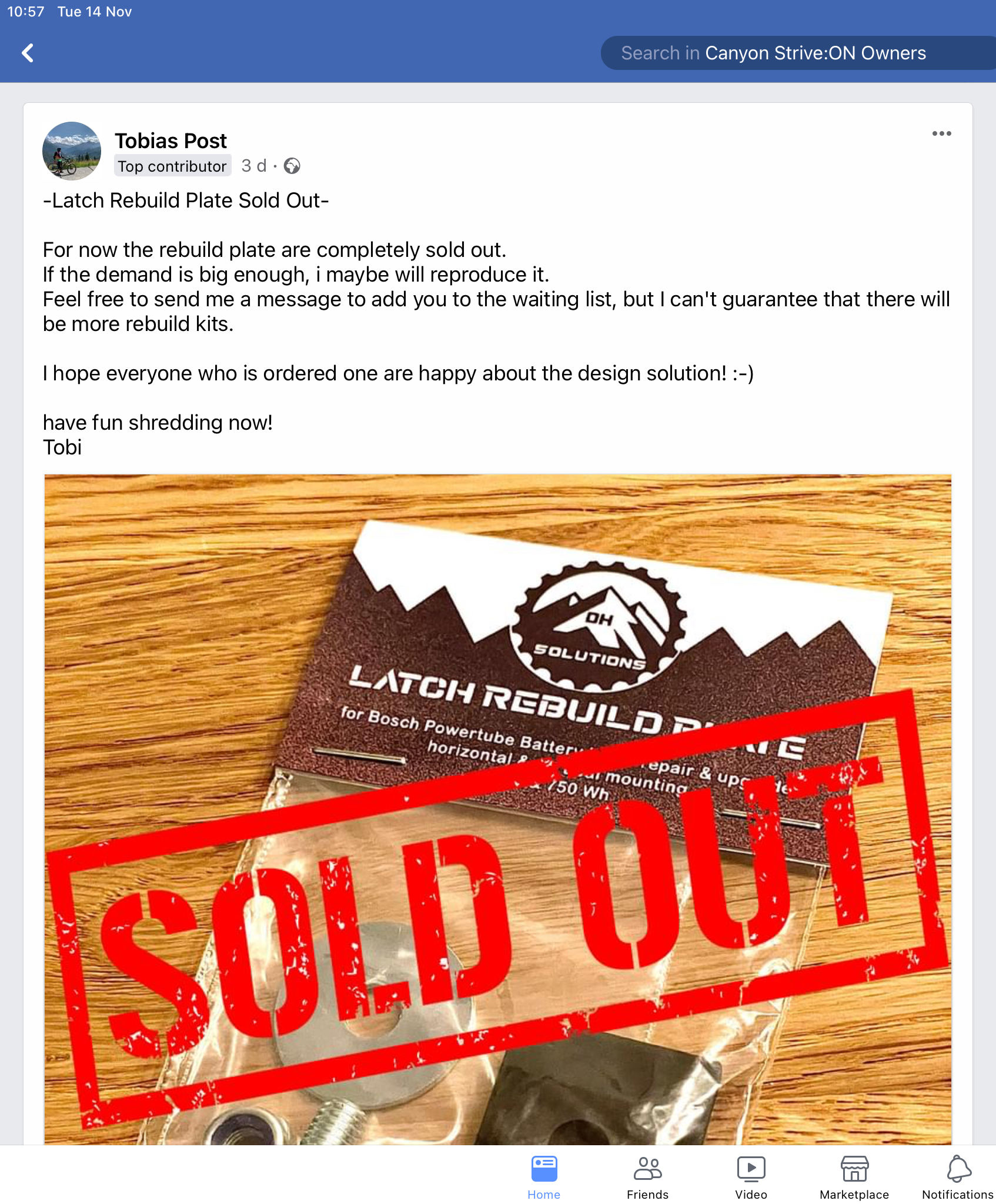

@jonas, sorry for my post, but this part you received, with the plastic bit, came from Canyon, meaning official Canyon?
Because there is a guy, that has all Canyon images in FB, and is selling "Canyon's solution"...
