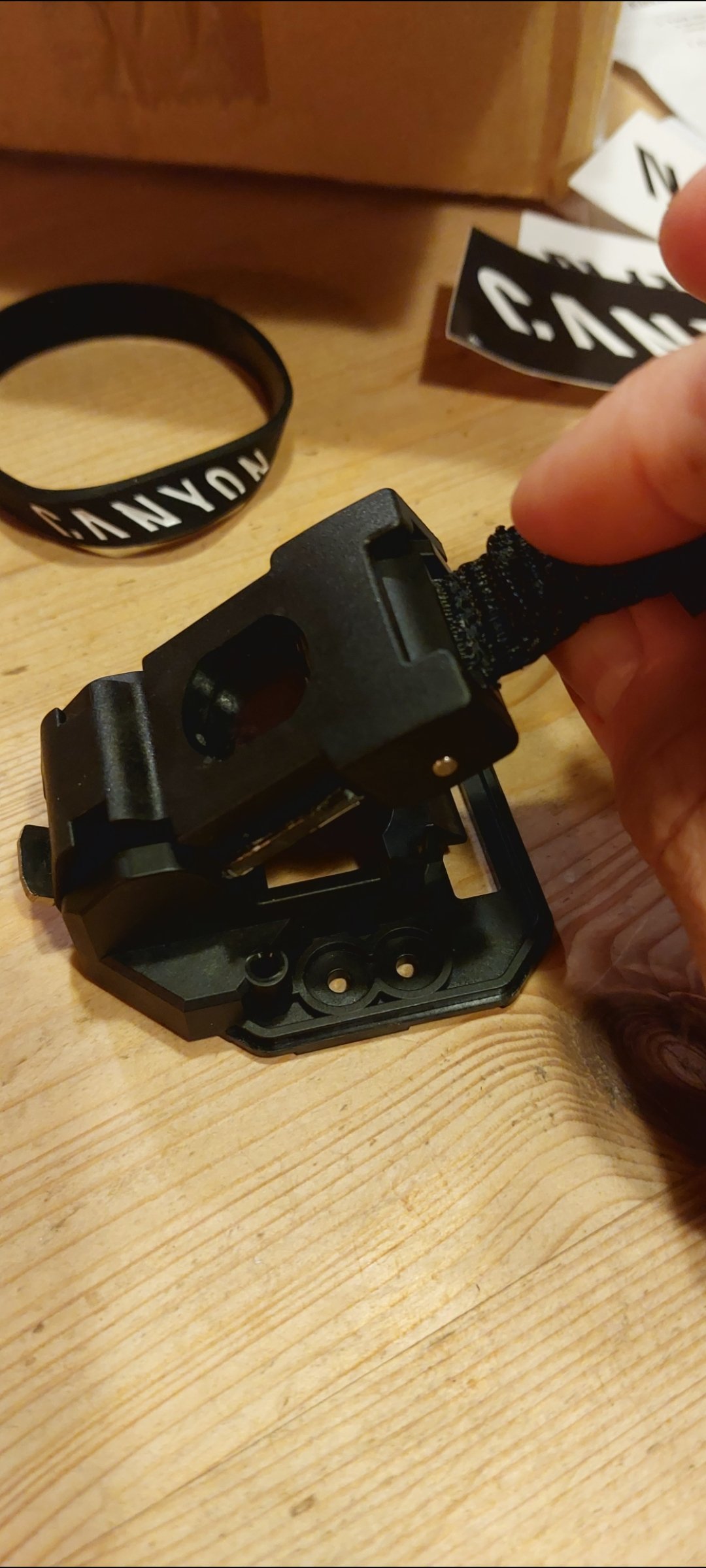

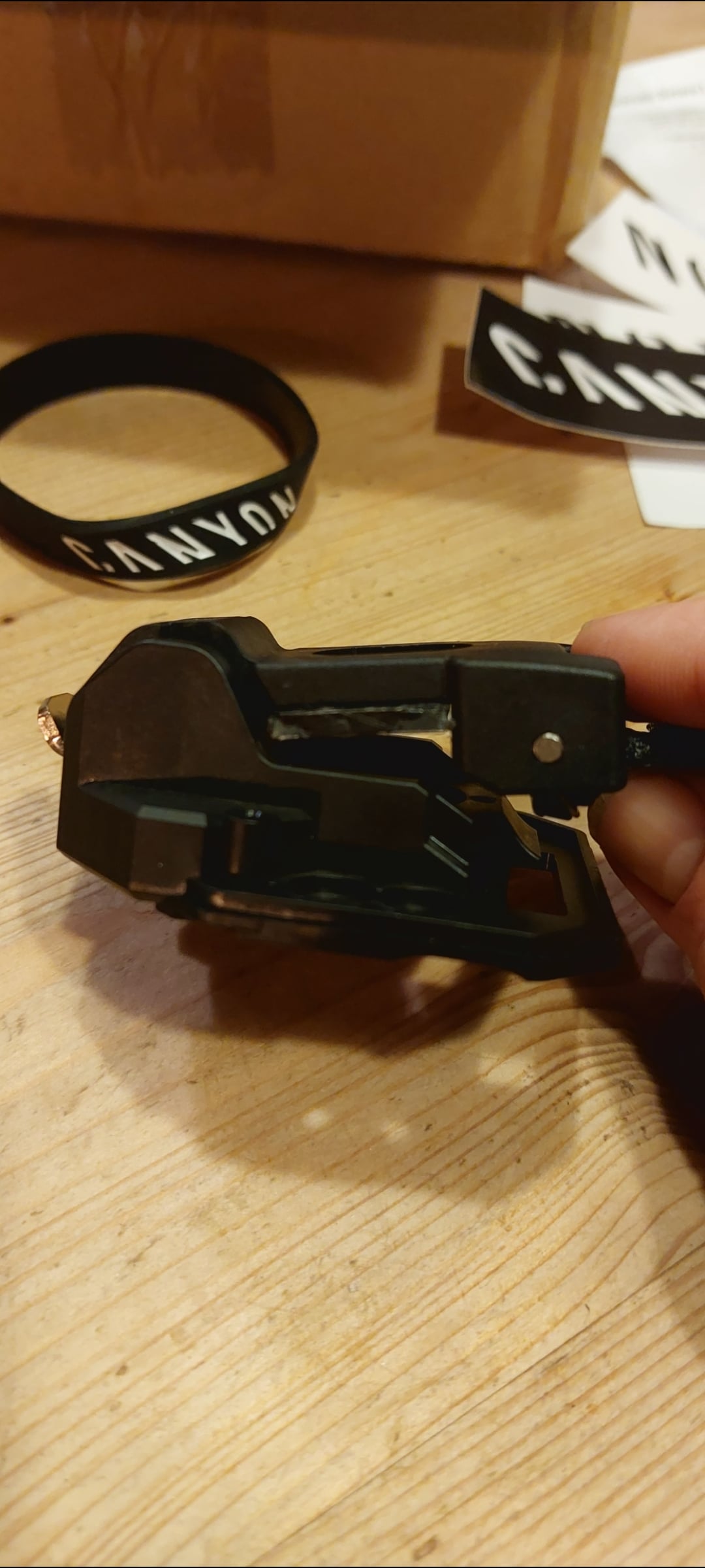

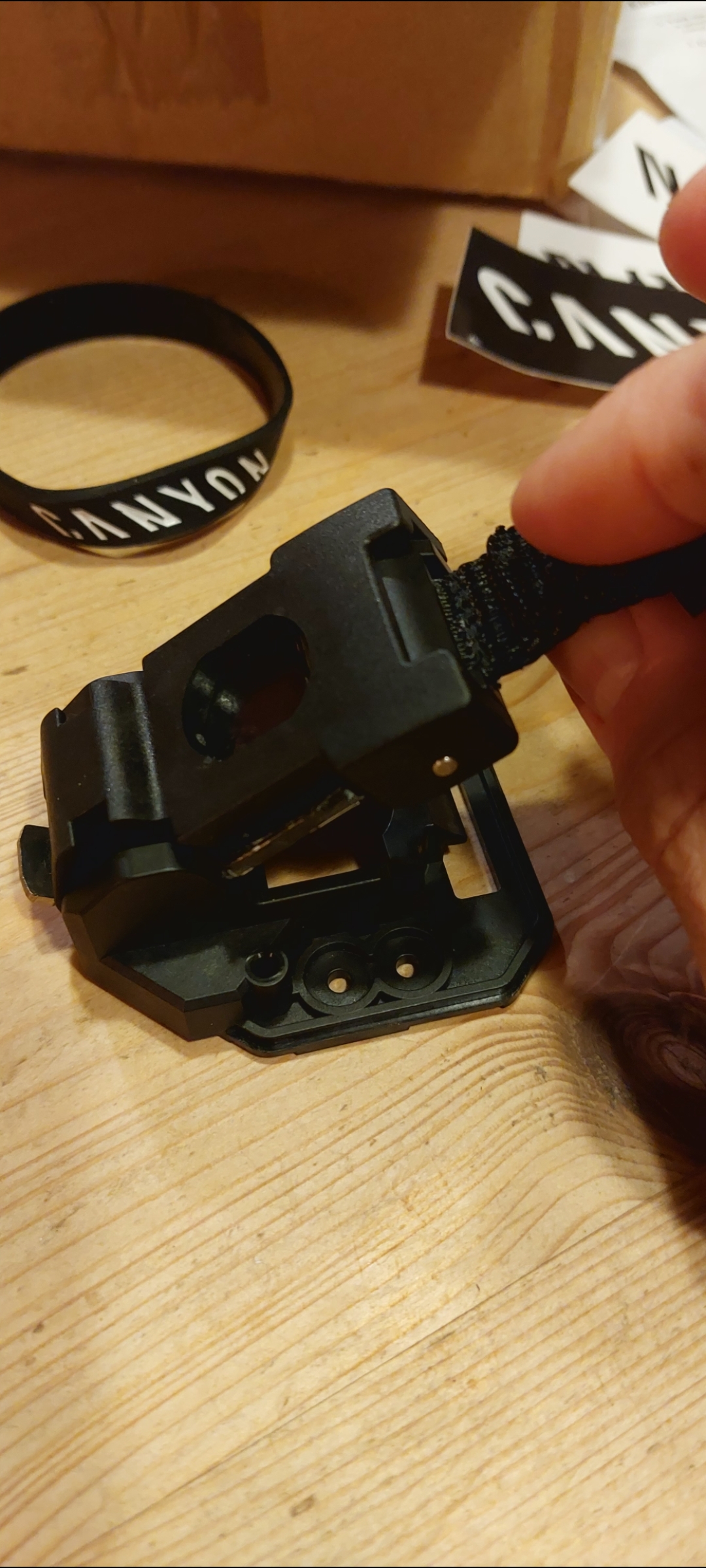

this is what i recieved, only the cover, not the latch itself:
My expirience with Canyon service Belgium has been exellent up to now. I assume that above shipping went wrong in Germany, where it was shipped from. Anyway quit annoying. luckely my temp solution still works.
Glad your service support works properly, I've sent a service request almost 2 weeks ago, still nothing back from canyon, I did get a feedback request survey email for such service ticket, of course I've valued as 0 stars....I'm never buying a canyon again
Jonas, the cover won't do anything. Canyon messed up on the delivery...
PS: the package, should contain:
1 Latch + 2 Torkx bolts
1 Cover + 2 Torkx bolts
Use all solutions you can, otherwise, bike will be stopped due to this latch design flop!
I'm sorry i was not clear. i'm aware that what I received is not what i need. this cover is the only part i did not need to replace . What i wanted to say is that i don't think the error of this wrong shipping is caused by Belgian service center but at Canyon shipping/warehouse at gemany.
FYI, to fix it temporary, I did these updates:
  1. add plastic under the pastic latch (repair the issue if broken lips)
  2. add a thin plastic part under the metal hook (avoiding play, in general)

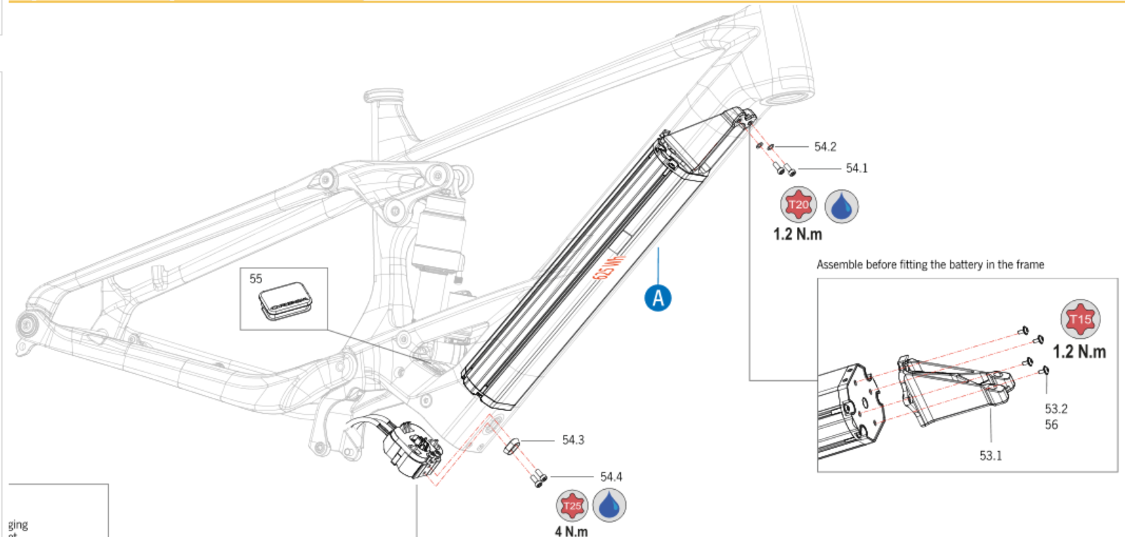

Have you checked the battery socket in the down tube at the opposite end?
Mine was quite loose so I removed all the bolts, loc-tited and reinstalled, it's been fine since.

Wow how would you even access that? You’d need a tool there what 60-80cm long?? Or am I missing something obvious like another access point?
el.guillyt
Jul 26, 2023
46
16
Spain
Don't worry, just remove the bracket where the battery latches, and your arm can fit inside de downtube, I've got fairly big arms/hands and no problem, you just need to undo the 2 bolts from the outside and it will come out of the downtoube, just remember to remove the cover for the cables channel, because the cable comes back down to the motor

Could you remove the screws one sta time and loctite them, so save the connector detaching completely?
S1mmo
Aug 30, 2023
87
68
Yorkshire
There are two more bolts inside the connector that may need loctite and tightening.
The connector / socket is easy to remove and inspect.
The cable covers slide out out freely but be careful not to bend them as they're very thin.
When reinstalling the connector and replacing the cable covers just be careful not to trap or knick any of the cables.
