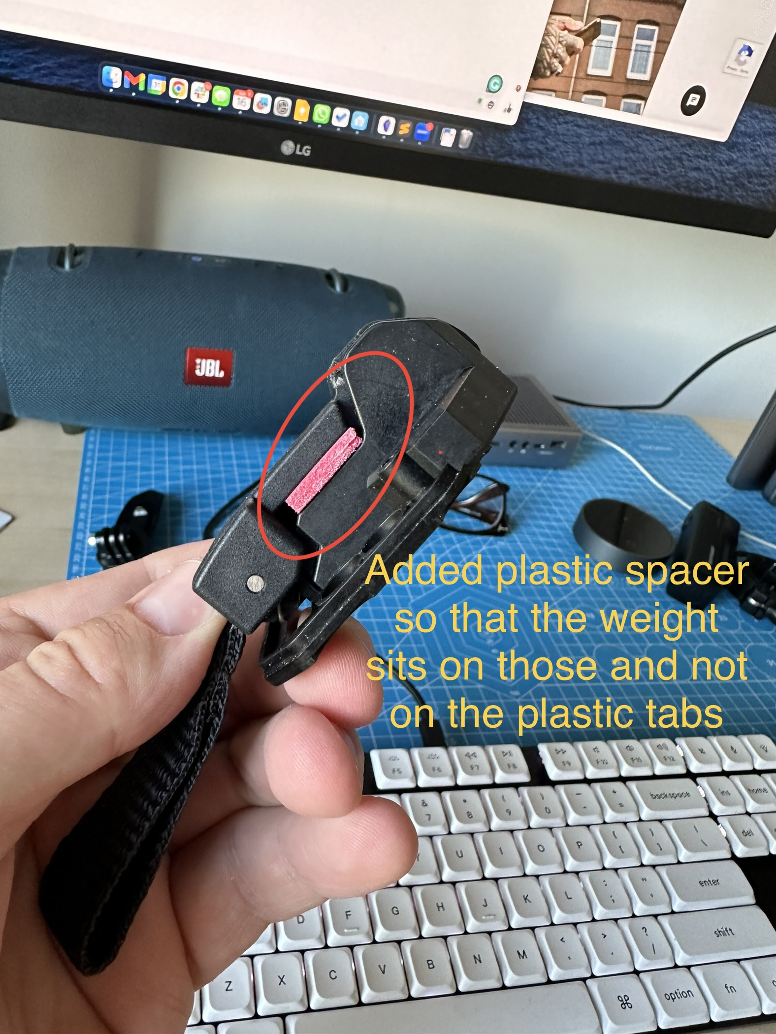

Has anyone else seen this fix for the battery latch (it's on the EMTB Facebook page): Log into Facebook
I've ordered one. Should be sent out on Saturday. For the relatively small cost it'd be a worthwhile option to try in the interim
my problem is my bike is on 700 miles and is all fine. Mine has zero movement, very tight and there is no way I could get a spacer in there and still be able to close. So assume this will work for bikes where the battery has movement but will not fit bikes where everything is snug and tight?

This will take care of the play...
But will accelarate the plastic "tabs" degradation - the real problem.
Best solution is really the plastic Zips
I'm presuming so. He says it can be fitted even if there has been no failure of the latch.
I have no problems with my bike at all but want to have something that might prolong the functionality of the latch until Canyon and Bosch have a solution they can roll out to all existing riders of the Strive.
Maybe so but I'd say for the relatively small cost it's worth a go. Better to be pro-active about the situation you're in. I'll be using the spacer and the zip ties together for peace of mind
