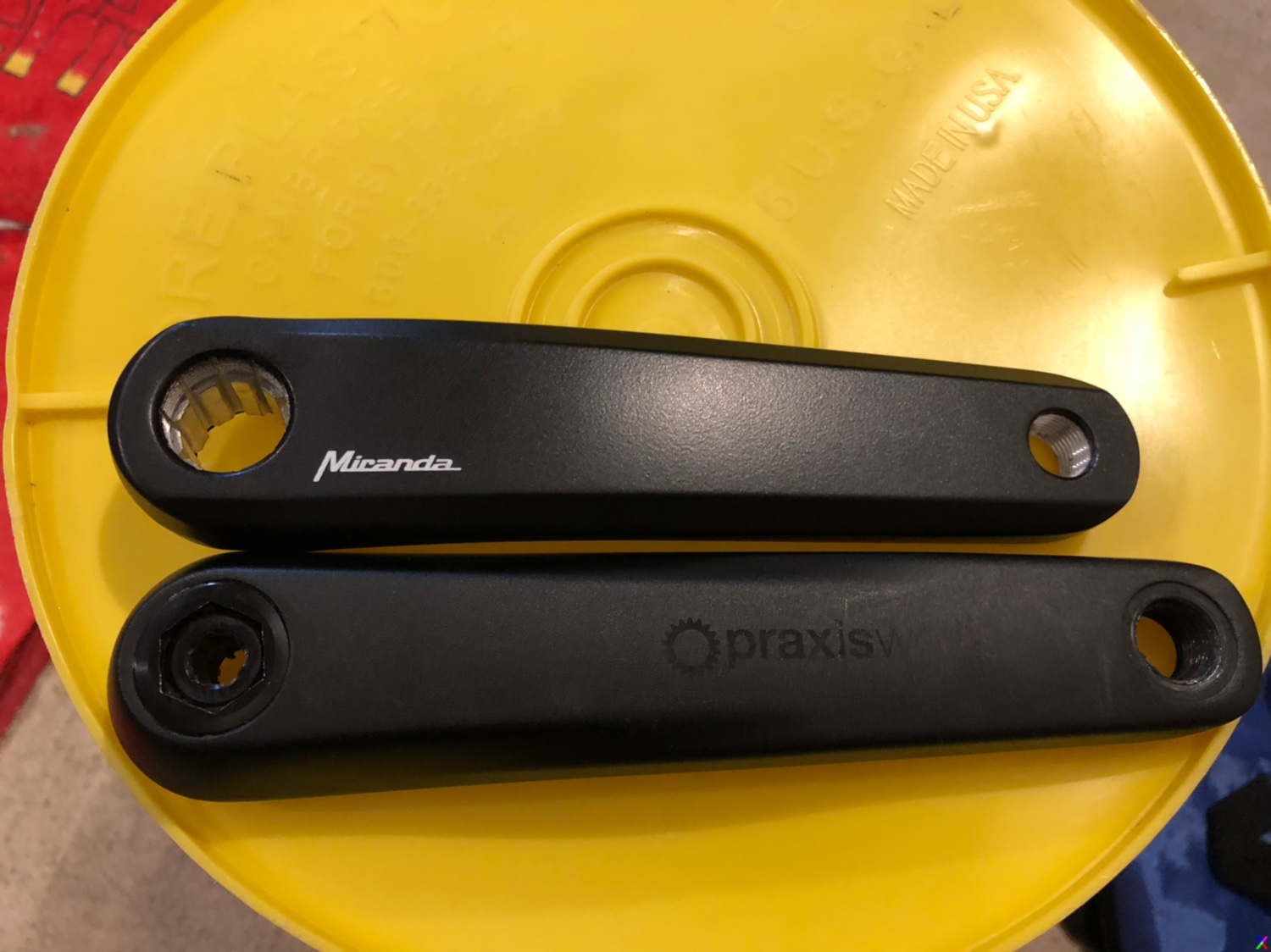

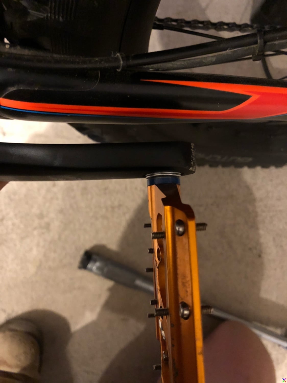

So after riding since I was well, 5, two weeks ago I had a pedal strike that landed me in the ER to check for internal bleeding. Hardest hit I've ever had. Bent the RF Chester pedal and stripped out the stock crank arm threads. I ordered the Miranda cranks listed here and was not impressed. They are significantly wider q-factor and much less substantial in construction. I decided to give them a try and about 15 min into my ride I had another bad pedal strike that bent the crank arm enough to strike and bend the chainstay. Didn't bend the pedal this time. Rashed up the right side (luckily the opposite side of last crash) and had CSF (spinal fluid) leak out my nose. Thankfully wife is a doc dealing in brain injuries and checked me out. Anyways...beware, the Miranda cranks are wider and flimsier than stock.

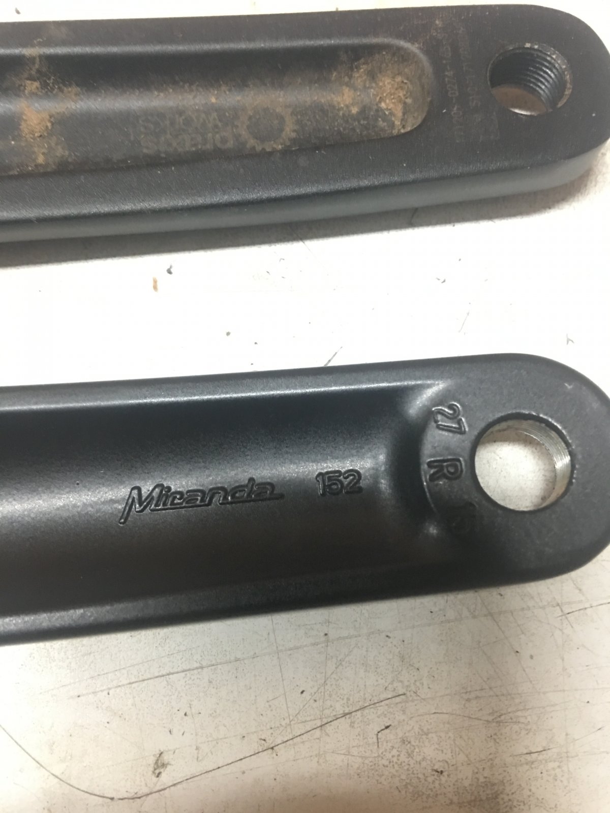

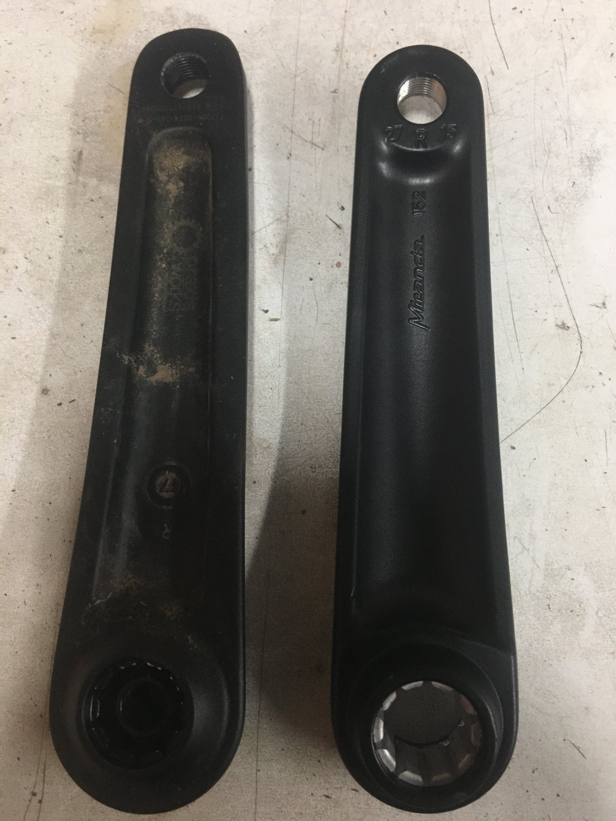

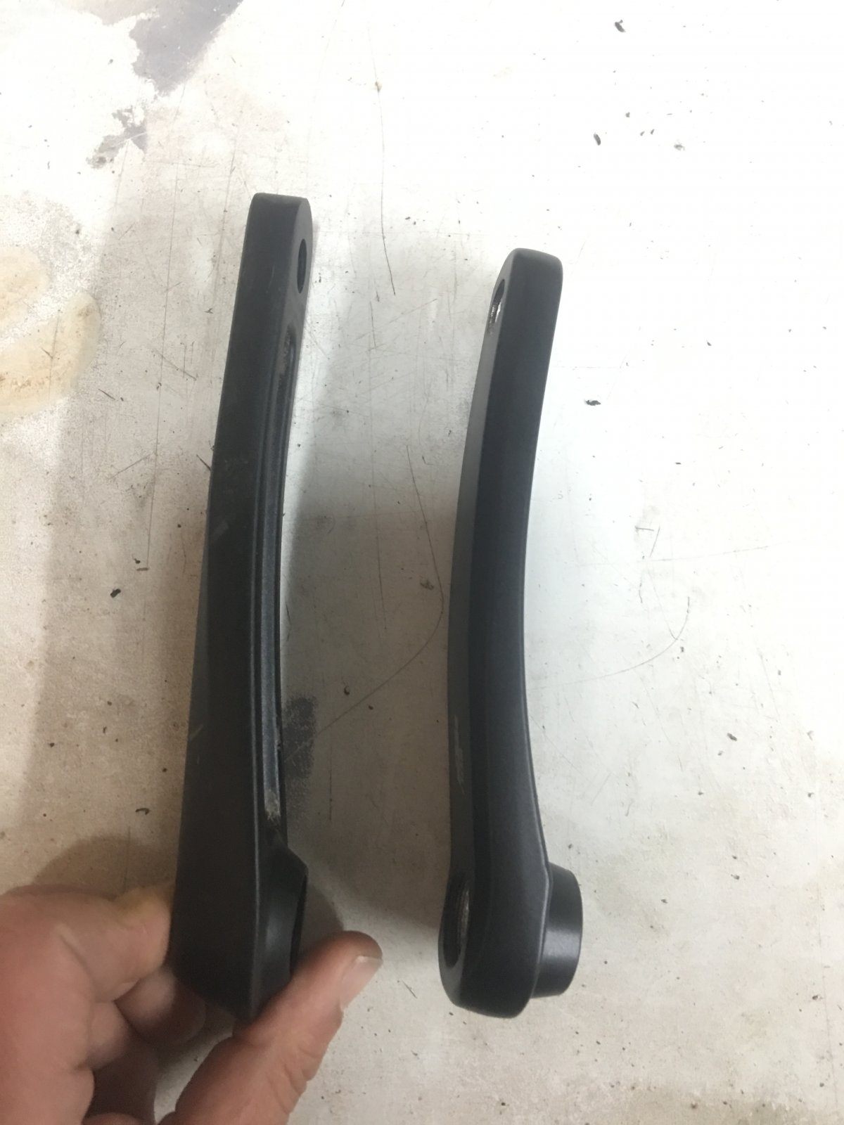

So I fitted the KTM Miranda crank arm to my Kenevo and yes they do fit. To mention they also come with new bolts.
Miranda Replacement E-Bike Crank Arms
I still to ride the bike and test them but at first look the Q factor seems fine to me. Even if there is wider q factor it suits me as I was running extended pedal shafts on my road bikes for years due to hip issues.
Here's some pictures.
Standard Crank arm
KTM crank arm
Standard crank arm

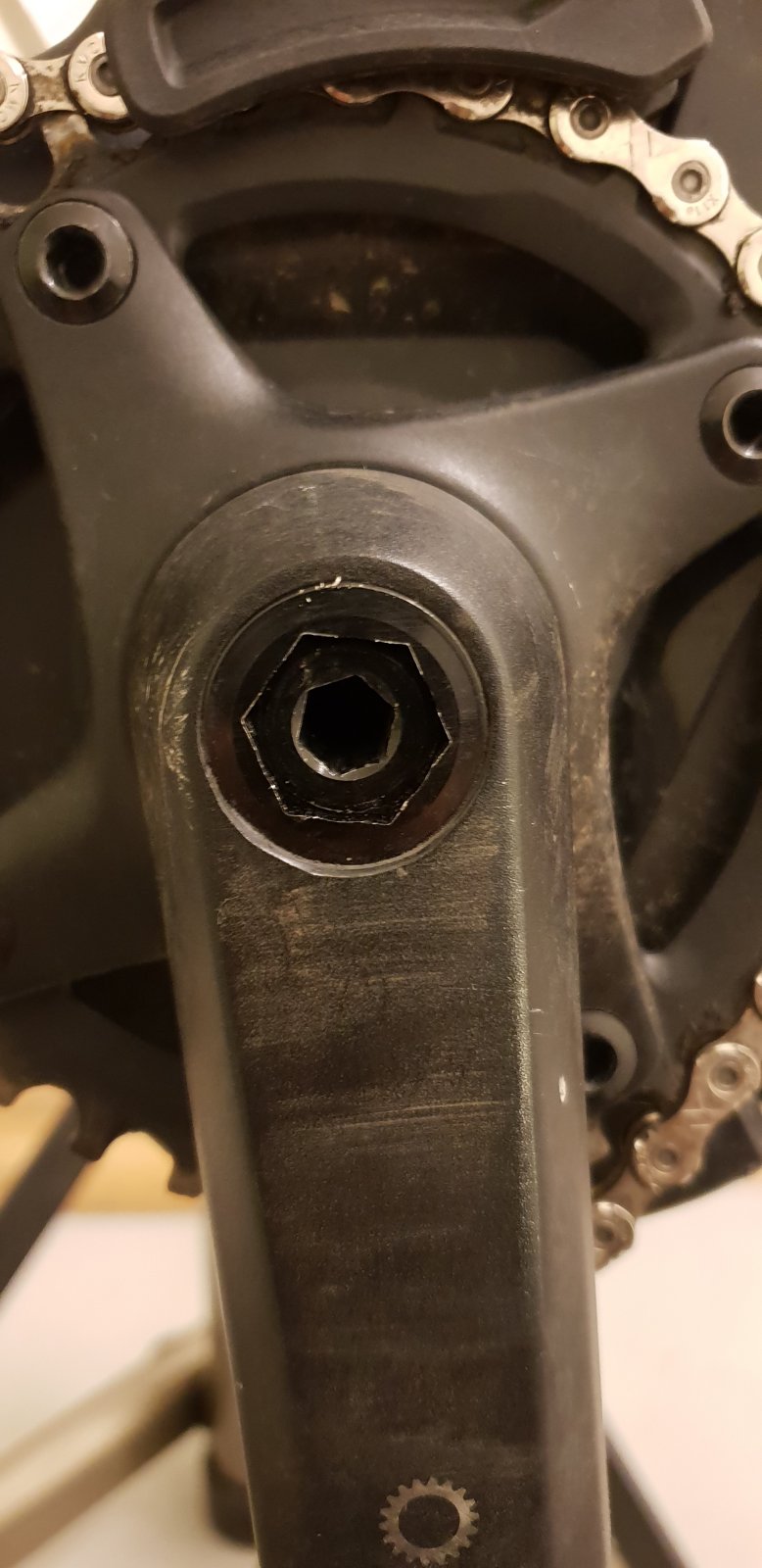

Ok, stupid question coming up.
Which one of these do I turn to remove the arm? Outer or inner? I've tried to turn the inner one, and it loosens, but only for half a turn, and it's completely tight again?
