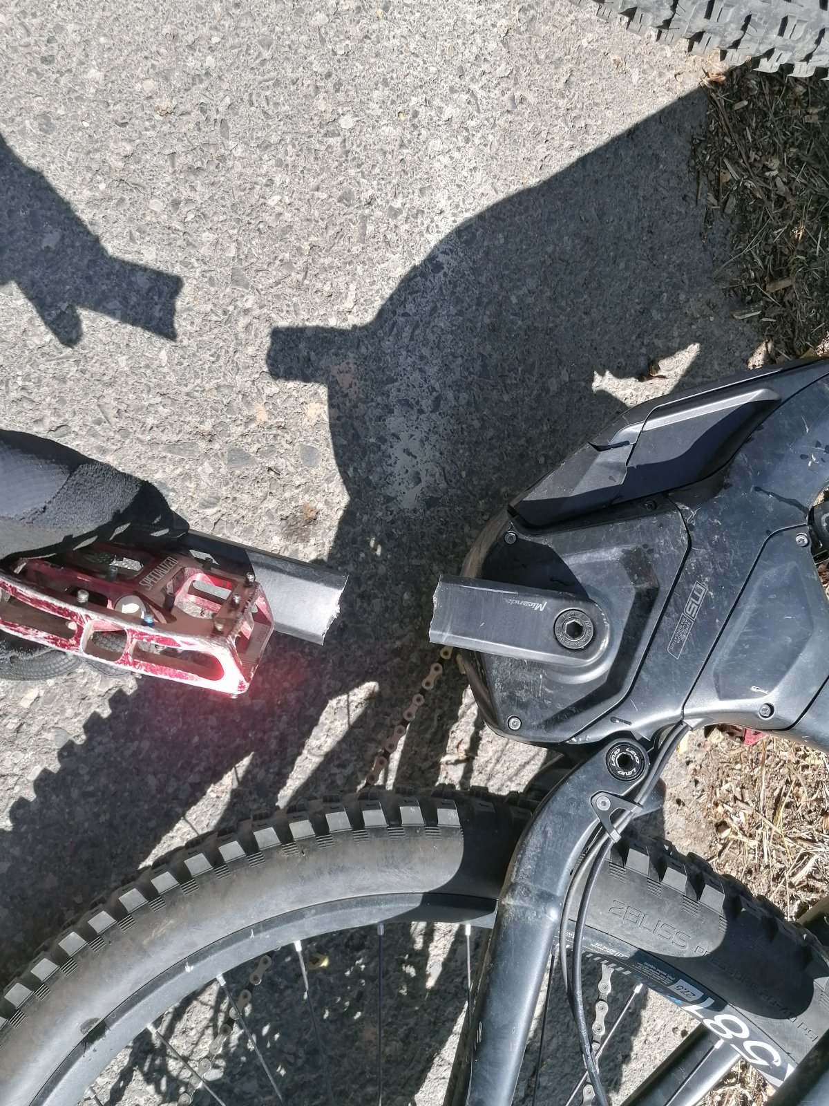

Here a short scary update to the Miranda cranks.
After some manuals i had a weird feeling while pedalling. My first thought was the pedal itself, but then the crank broke suddenly. Don't want to imagine, if this happens anybody on a downhill trail... ?

Now I have two good right and two bad left 155mm cranks of the Miranda's.
The first was heavily bent as I touched a log with my foot on the pedal, because I had a bad crank position. For real... only my foot... Neither the pedal, nor the the crank touched it. It hurts a little, but it did not even bleed.
And the second one broke today. Material fatigue?
Who buys cheap, will buy twice. Does anyone need one or two right 155mm cranks? ?
The first was heavily bended as I touched a log with my foot on the pedal, because I had a bad crank position. For real... only my foot... Neither the pedal, nor the the crank touched it. It hurts a bit, but it did not even bleed.

BTW, Did you check your motor shaft? A good friend bent his cranks on a bad landing, and later found his motor shaft bent too! And it ruined his motor.. lucky it was under warranty.
Thanks for the tip.
Motorshafts are fine, no problems with them.
Before the crank broke, I've heard some clicks coming from the crank. I could also feel something while pedalling.
So please be careful, if you can hear some weird noise around there.
