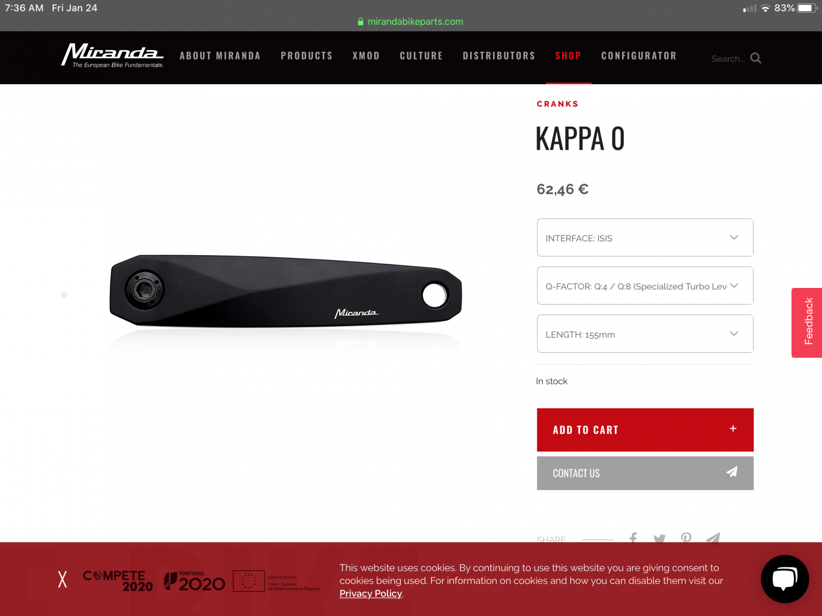

Miranda's Delta SH (shimano) came back in stock overnight, just ordered 155mm. I'll wait to see how they feel but if my current SDG dropper (150mm) has to come out to compensate I'll probably order a Oneup in 170mm.

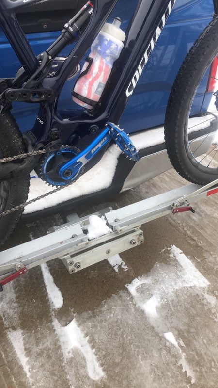

hope!
ccrdave
Jan 16, 2018
1,437
1,128
uk
Dont the hope cranks have a too big offset?

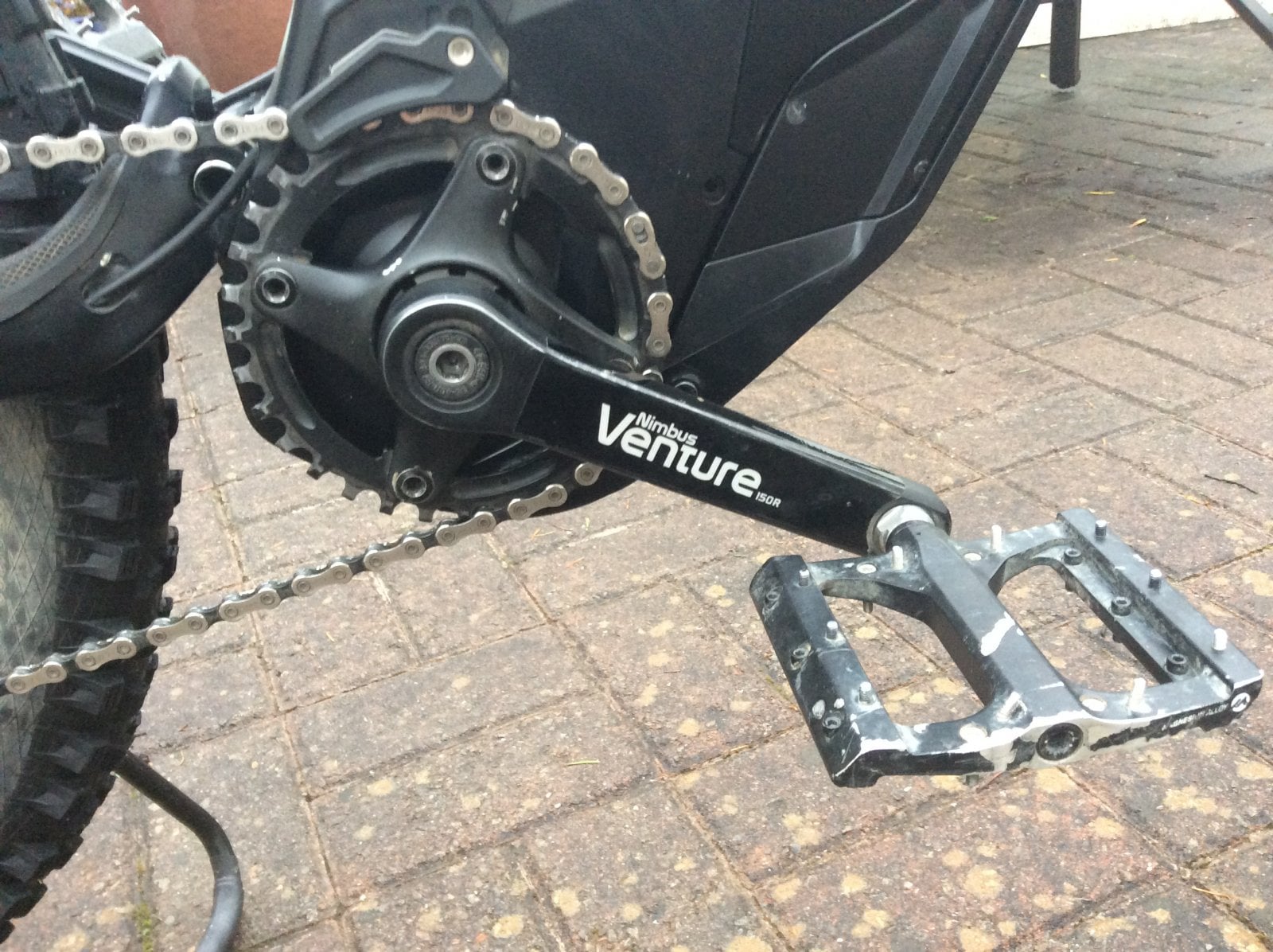

I run Nimbus Venture 150mm cranks on my ebike. Please see the picture below.
To balance up the length of the cranks I run a 170mm OneUp dropper. I also have 180mm to 150mm Lyrik dual position forks. My head angle is 65 degrees.Please note, Before I had my ebike, I always ran all of my analogue bikes with 165mm cranks so when I changed down to 150mm I did not notice any difference apart from a drastic reduction in pedal strikes.
The cranks are the Venture2 models. I got these from unicycle.com. There is an updated version called the Nimbus VCX which are stronger but they will not fit unless you modify them by filing or grinding them down a bit where they connect to the motor as they will scrape the motor covers on the Levo 2017. I weigh in at 75kgs all kitted up and have had no issues with the strength of these cranks.
Before I made the purchase I had a long conversation with the uni cycle.com man to check out his view on shorter cranks and pedal strikes. It was a very interesting conversation and he suggested 150mm would be fine to start with but said I could go shorter if I was still getting pedal strikes. I tried the 150’s and found them to be perfect for my style of riding.
They may not suit you but for me, they were exactly what I needed. By the way, he runs 100mm cranks (yes 100mm) on his off road unicycle and also 100mm on the pennyfarthing he races so this was a real eye opener to me and made me think I may try some shorter ones in the near future, possibly a set of 135mm ones?
Yes, I have read the emtb magazine article when it was first released and for me, everyone has there own opinions. I am just going by my own experience and at least half a dozen other people who have ridden my bike. Not one of those people noticed the cranks were 150mm until I told them after our ride. All of them were running 175mm cranks on their analogue bikes and we swapped over from their bike to my bike throughout the 2 to 3 hour ride a number of times. Maybe if they were all riding ebikes instead of analogues they and I might have noticed something, I honestly don’t know. All I know is I do not feel I am losing any Watts and I do not feel I need to spin a faster cadence. I got 3 KOMs on my ride this morning and all of them were uphill segments so in my opinion the cranks can’t be robbing too much power from me.
All I can suggest to everyone here is to try them, for £48 delivered they are a bargain and the fact you will reduce your pedal strikes, to me, it’s a no brainer. Ride safe and enjoy! ?

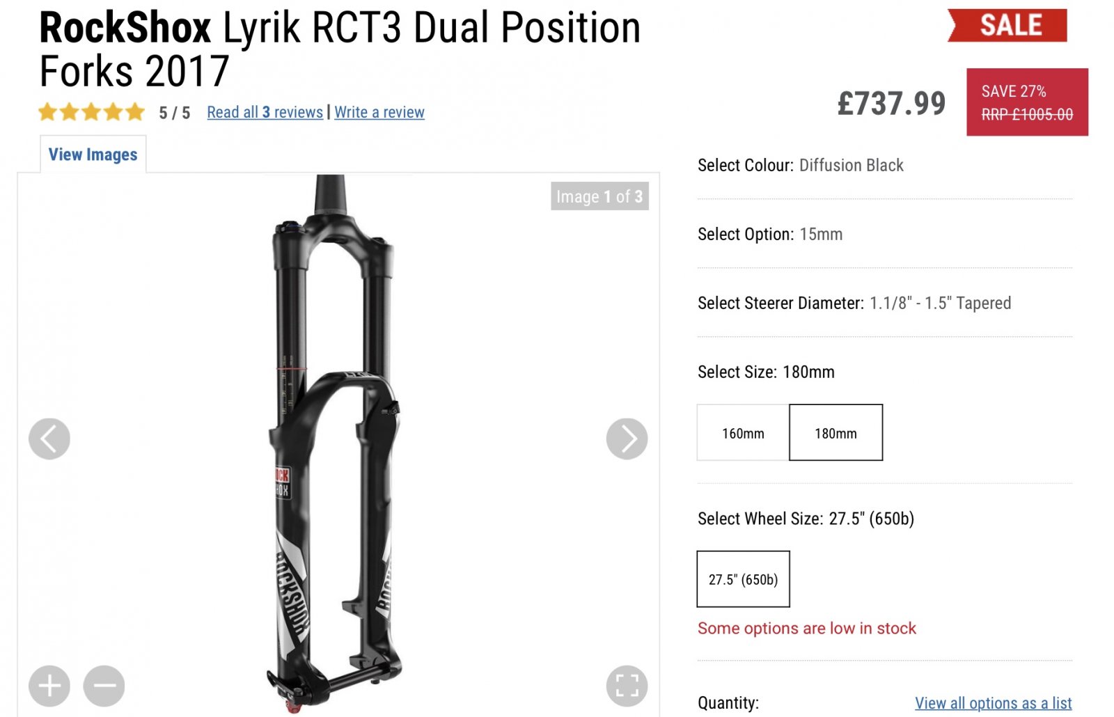

Not to hijack the thread or anything, but how do you get "two positions" out of your 180mm Lyric? Is it a different cartridge!?

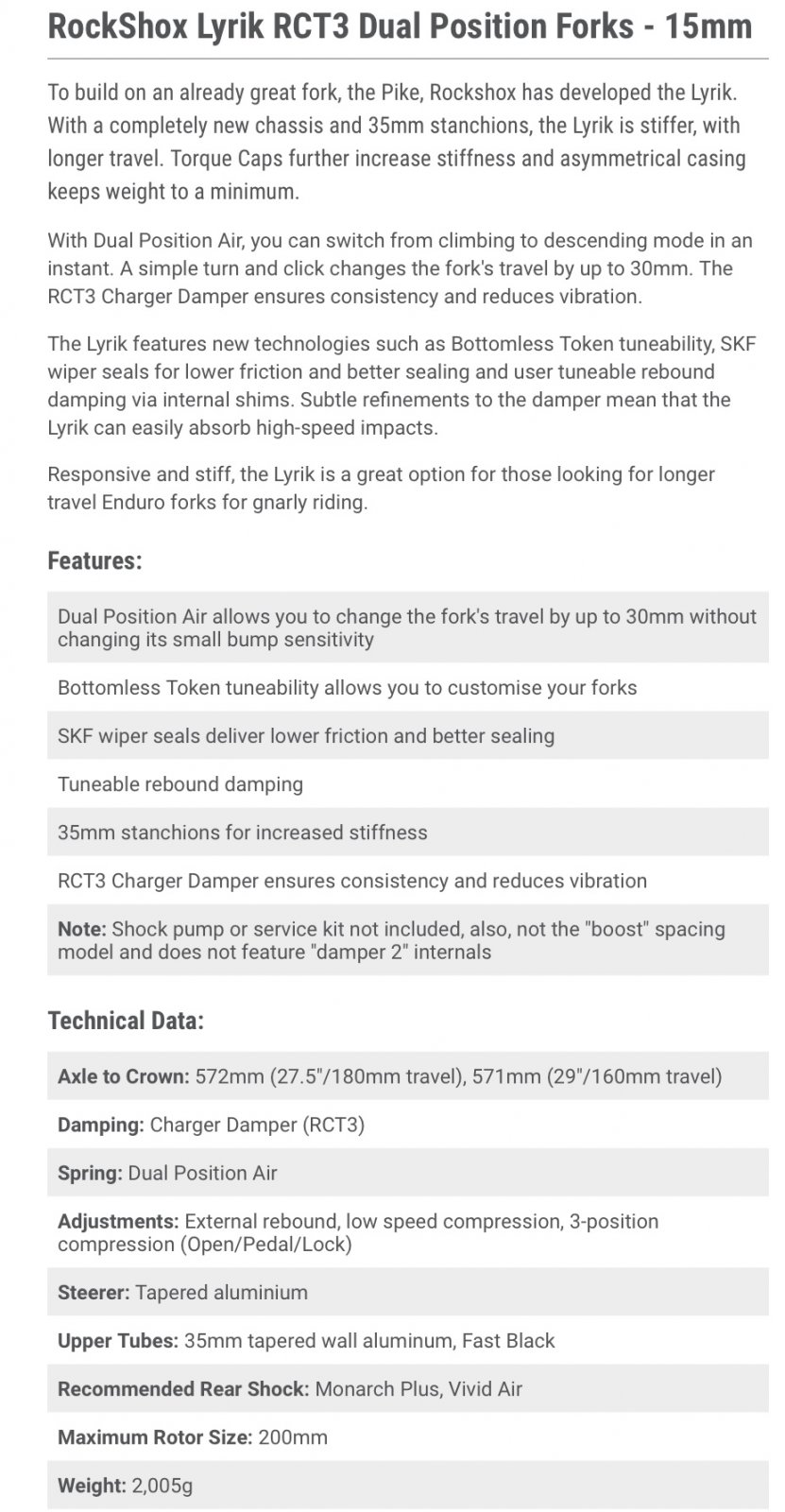

Hi Tim,
I have the older version Lyrik which has the original Charger damper. The fork has a dual position manual dial/switch on top of the left hand side fork tube. By turning the dial it instantly drops the fork down from 180mm to 150mm. Turning the dial back pops the travel back up to 180mm so I can have the best of both worlds. 180mm for the downs and 150mm for the steep climbs and inbetweens.
To be honest, I can still clear most of the steep climbs when it is set to 180mm but it is good have the ability to drop to 150mm whenever you want to. Super plush on both settings. I have not had any issues with the fork in the 4 years I have owned them but do get them serviced on a regular basis.

I just received the Miranda Kappa 150mm :)
Three things :
- Now self estracting bolts are included, with good quality threads
- Threads for the pedals are really contaminated of paint ... I recommend to clean them very well before mounting them .
- What is the torque in NM to tight them up to the crank ? 40 or 50 NM ?
Thanks

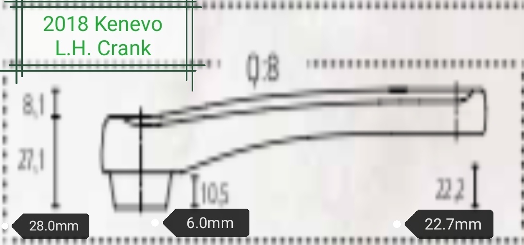

Rob, I also took "kiwi in wales" advice..in another thread, and have been looking for the right 150mm cranks.. but couldn't get definite info on what cranks my Kenevo needed. So I pulled them off the bike and measured them! Then compared them to the Q-factor chart on the Miranda site, and found them to be Q4/Q8.
And after talking by mail with "Felipe" from Miranda, he said their recommendation for the Levo/kenevo is the "Kapa O" crank with a Q-factor of Q4/Q8, made special for Specialized ebikes.
I have ordered them.. (50€) should be here in a couple of days..
Will keep you posted.
Attaching my measurements (in the black labels) on top of the Miranda specs.
Tim
View attachment 16233 View attachment 16234
