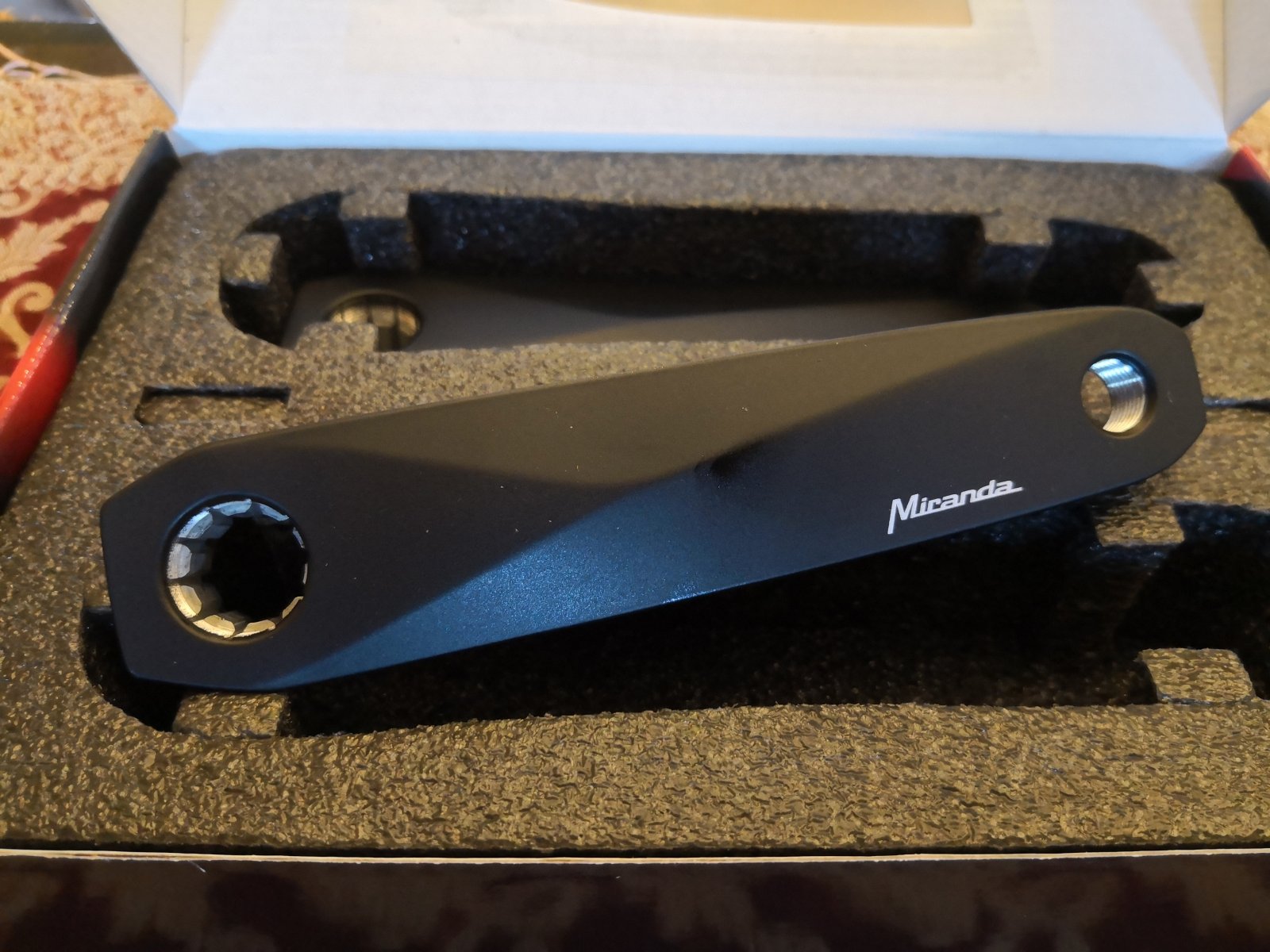

After reading this thread about shorter cranks, I have mounted the 152 mm Miranda on my Levo. Before I experienced 3-4 cranks per ride - This past week I have been riding about 80 miles with no strokes and just one or two crank-kisses.
The pedaling feels the same - but the my confidence in my riding has grown a whole lot.
Thx again to the members here :)
( I bought these - bolts were included - Miranda 152 mm )

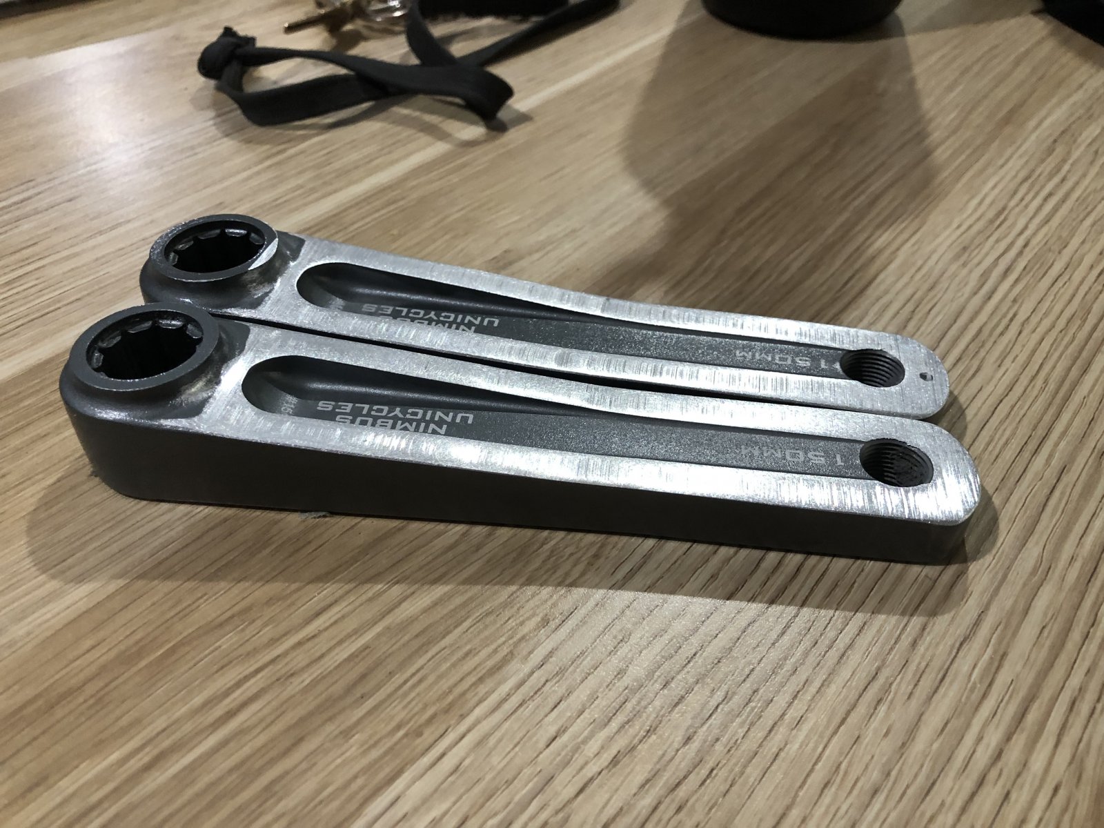

I done the 150mm uni cycle cranks. Needed to be modified to fit but they’re tough as nails and I l’ve hit them pretty hard.

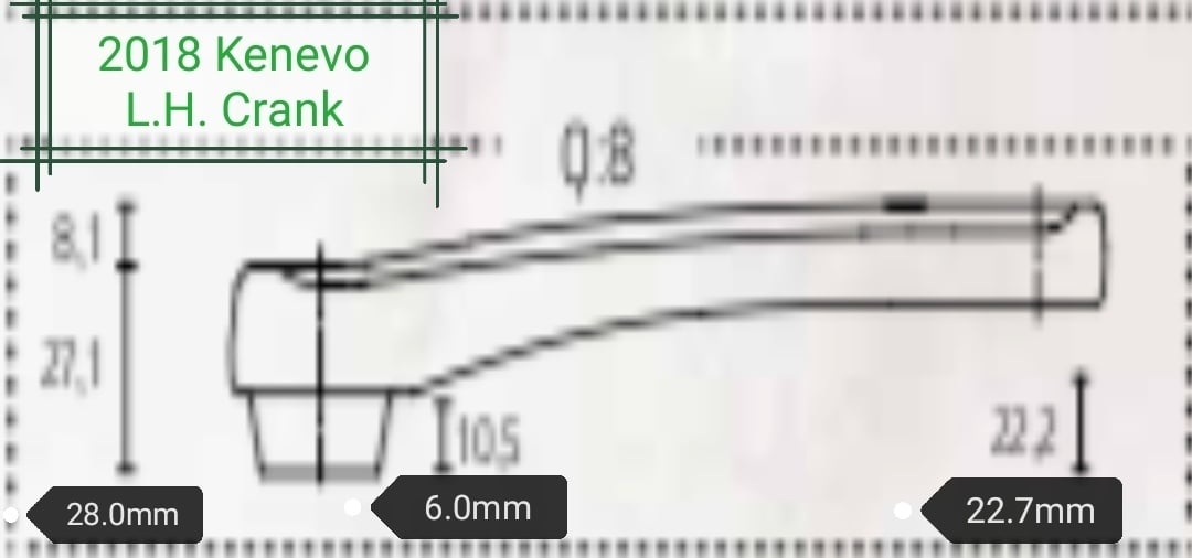

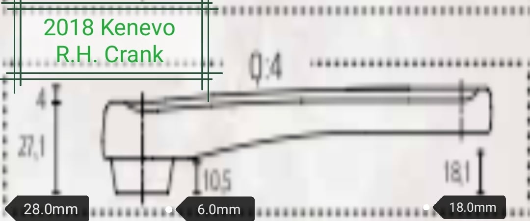

Rob, I also took "kiwi in wales" advice..in another thread, and have been looking for the right 150mm cranks.. but couldn't get definite info on what cranks my Kenevo needed. So I pulled them off the bike and measured them! Then compared them to the Q-factor chart on the Miranda site, and found them to be Q4/Q8.
And after talking by mail with "Felipe" from Miranda, he said their recommendation for the Levo/kenevo is the "Kapa O" crank with a Q-factor of Q4/Q8, made special for Specialized ebikes.
I have ordered them.. (50€) should be here in a couple of days..
Will keep you posted.
Attaching my measurements (in the black labels) on top of the Miranda specs.

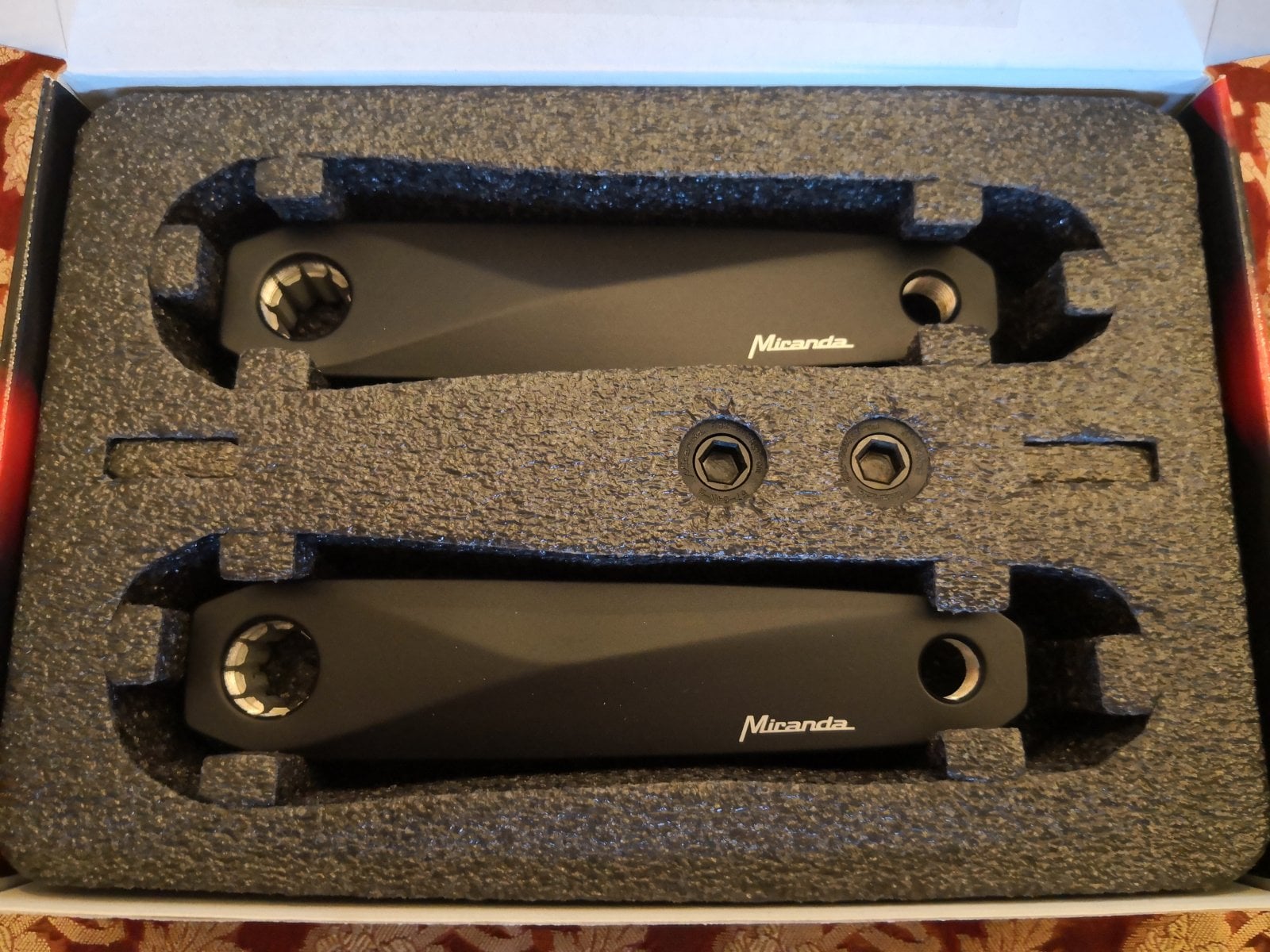

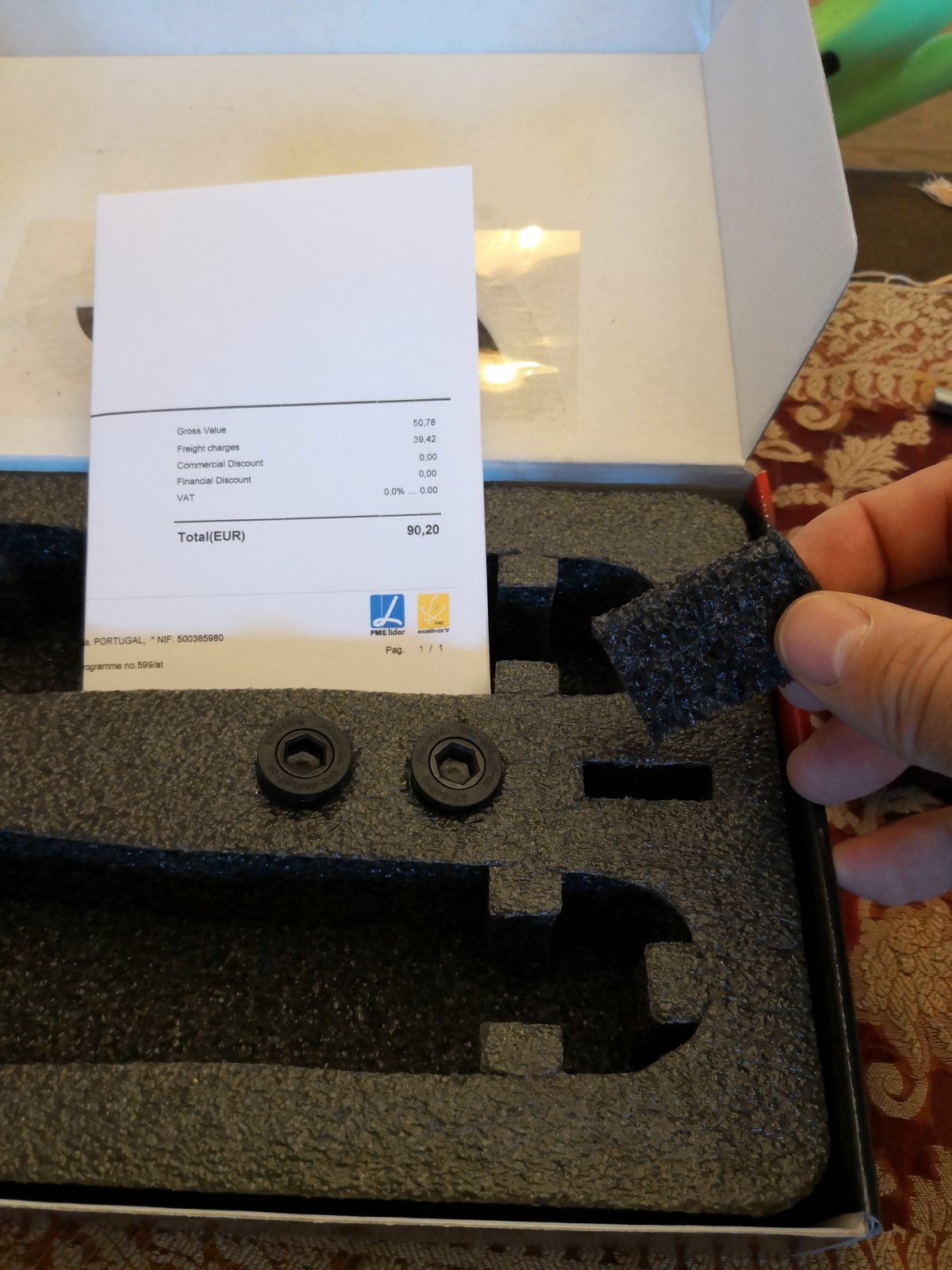

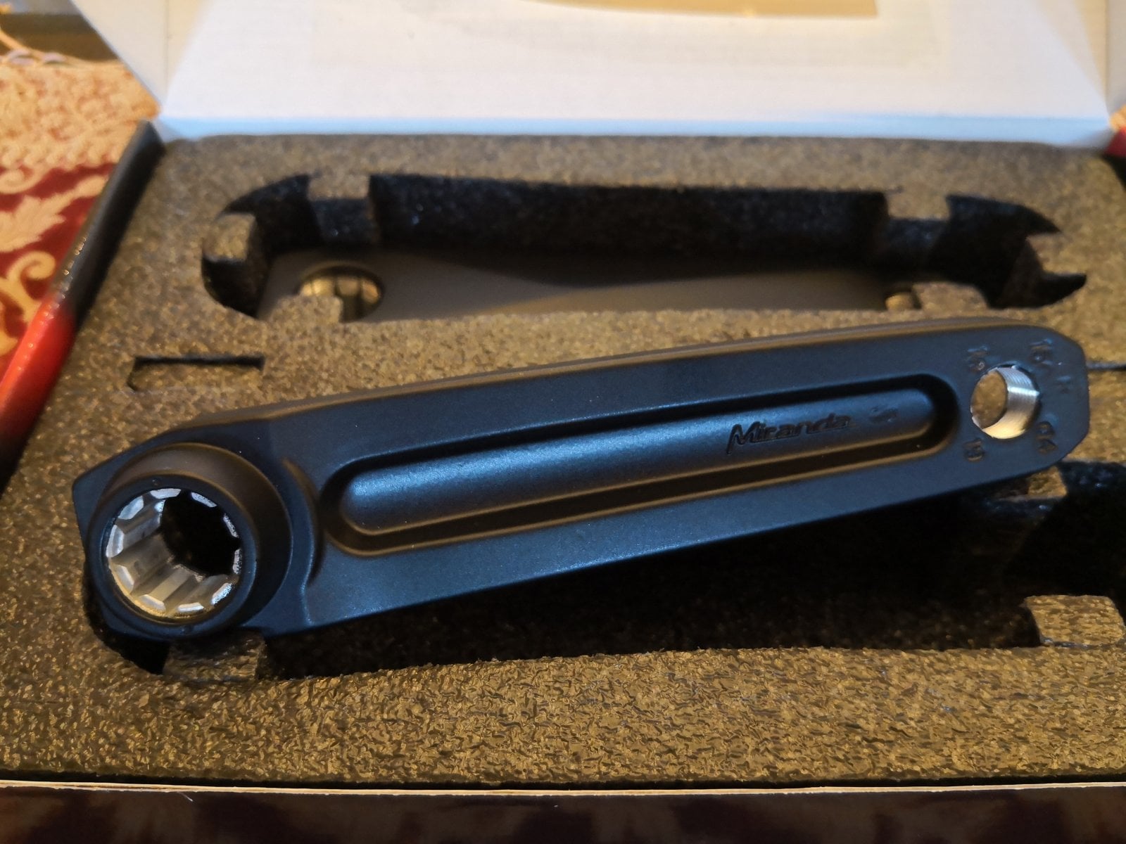

Update :
This is what you get for 50€ (plus 40€ two day shipping, in my case)
The Miranda " Kappa O" 150mm crank arms, including crank bolts
( Not self extracting, can be added later.
In Q-8 and Q-4 form factor, specialy, for the Specialized Levo/Kenevo!
The cranks have the threads for the self extracting lock ring(22mm thread, unfortunately the original praxis crank comes with a 26mm lock ring, that can't be transfered to the Miranda's) but they come with a standard non- extracting bolt- that means you will need a crank puller to remove them. Even though the nicely padded box has a spot for the self extracting lock rings...odd. another problem as mentioned before me, is the pedal threads have paint in them , that makes it verry difficult to start the pedal threads without cross threading or damaging them.. so take great care to start them straight! This should have been cleaned out Before! Shipping the product. Miranda - check your quality control!
Otherwise, an amazing looking crank, that comes in many lengths, and Q-form options.

Update :
View attachment 16314 View attachment 16313 View attachment 16312 View attachment 16311

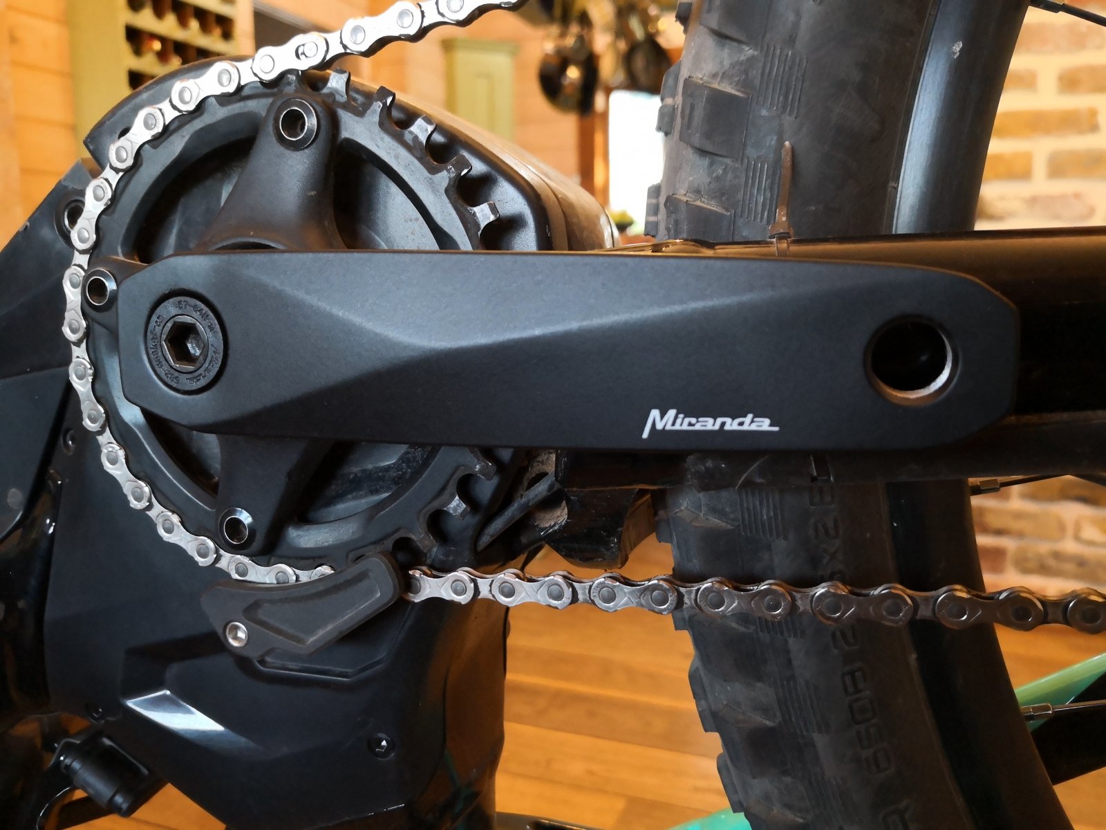

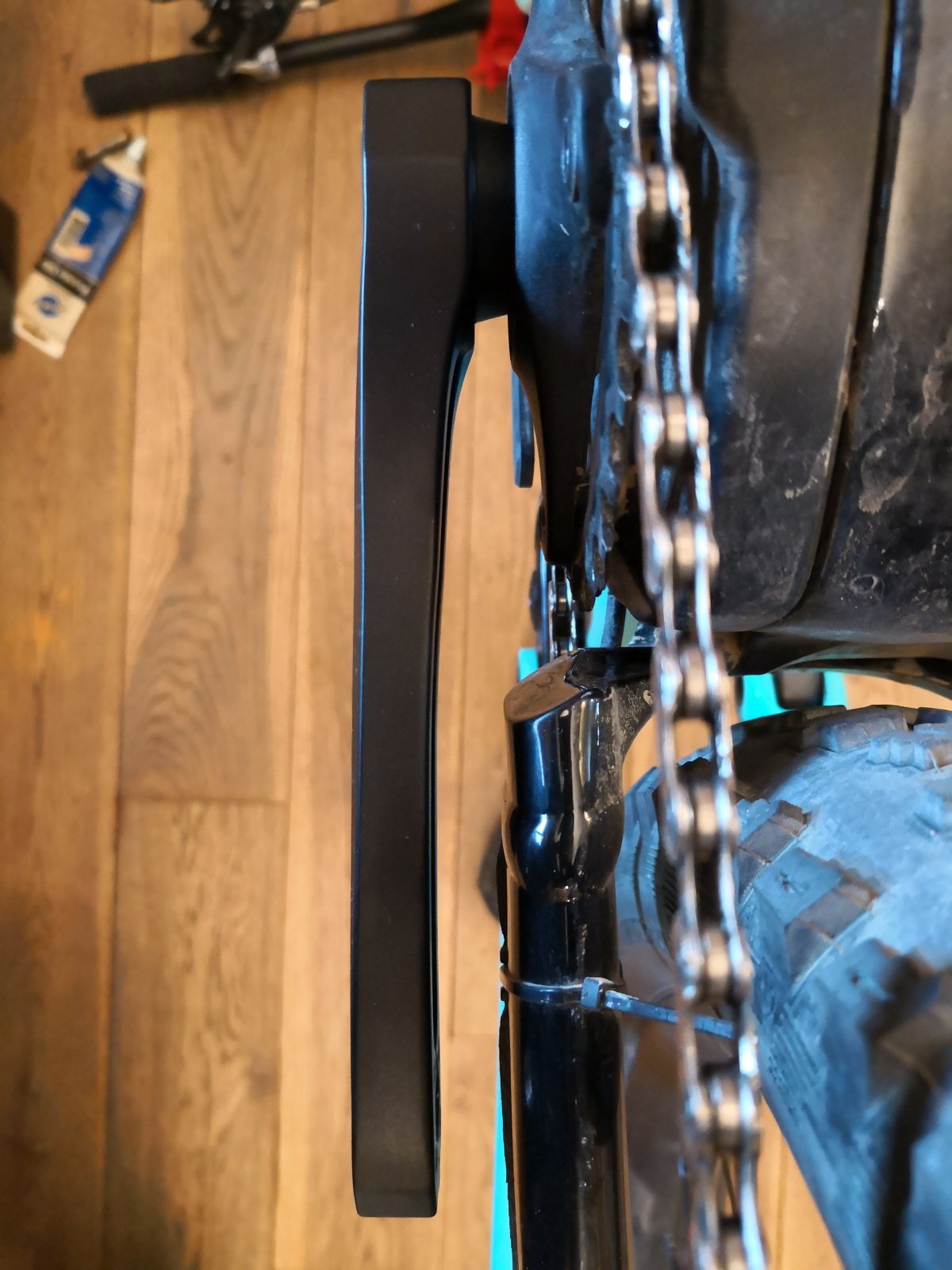

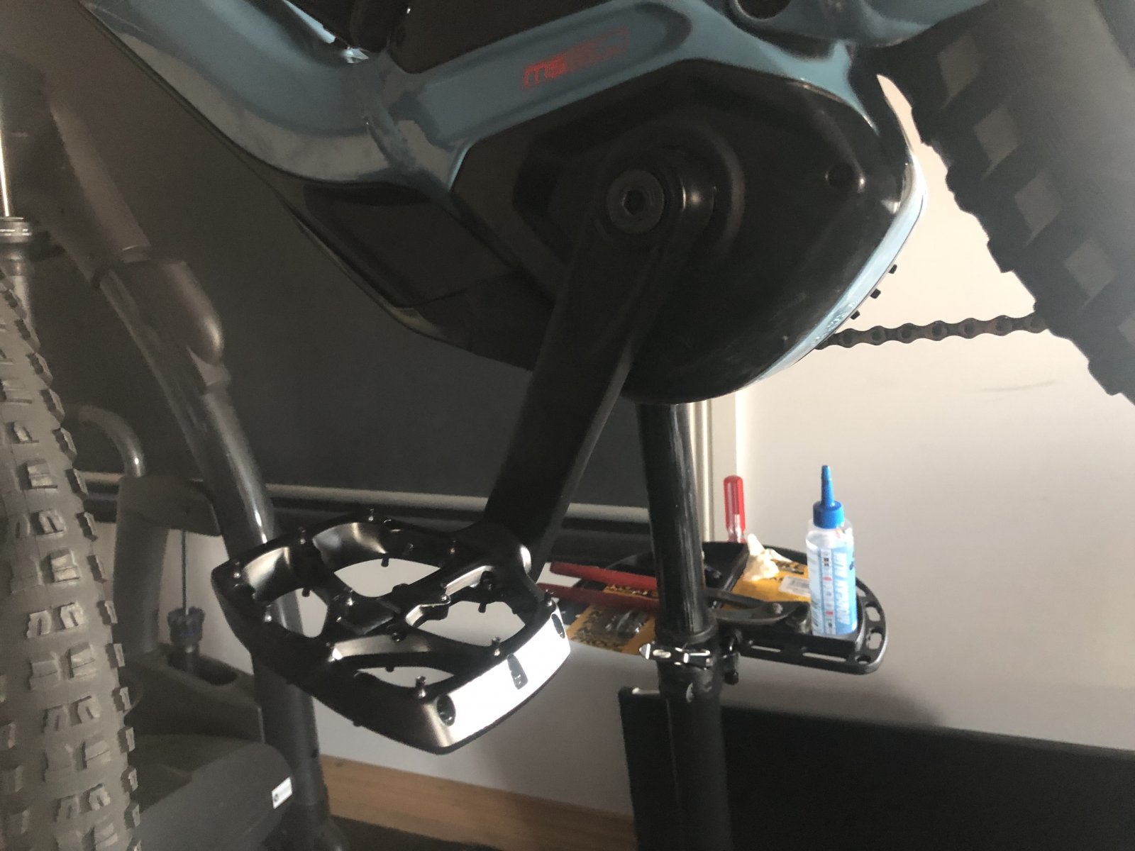

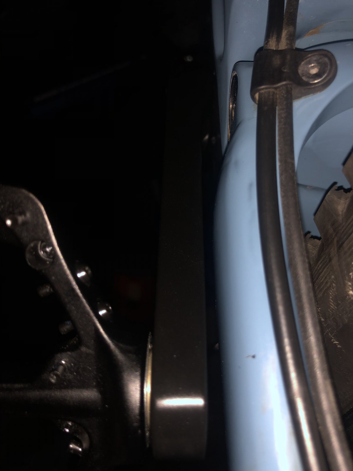

The installation:
Was straightforward, other than the pedal thread issue, that is verry touchy! I recommend sticking an Allen tool thrue the crank hole into the pedal to keep it straight as you start the threads, and watch closely it doesn't start crooked!
I was replacing the original "Praxis" 165mm cranks, so I got 150mm... Hoping to make a big difference in my " pedal strike issue's"...

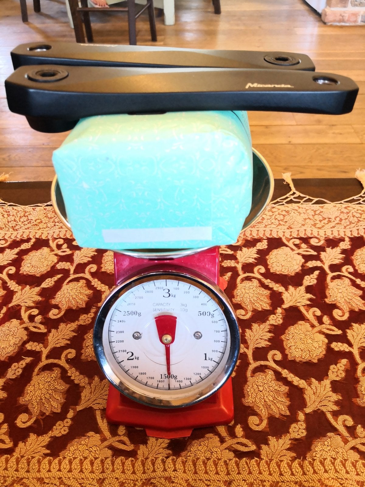

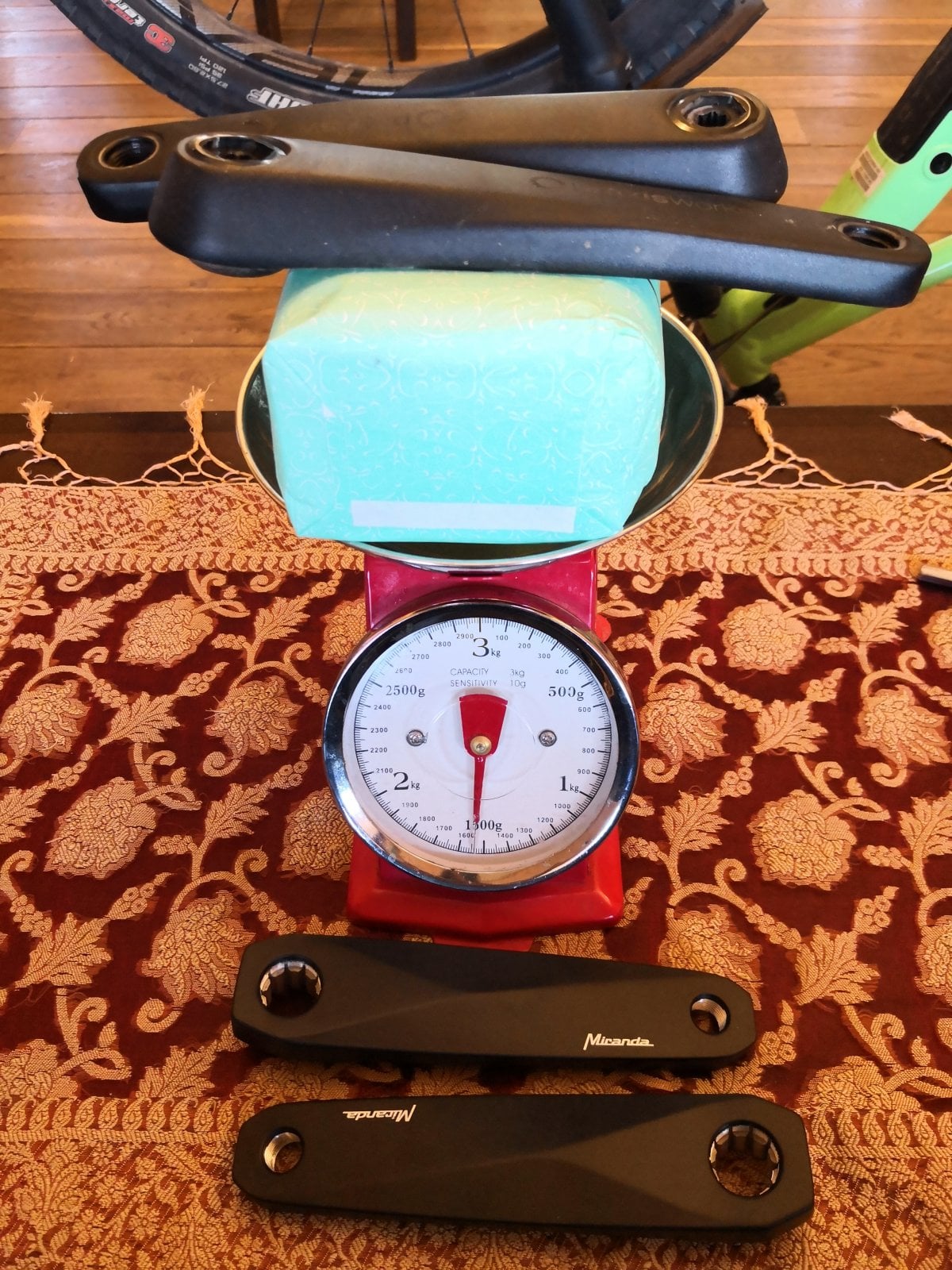

The difference in weight, as you can see from the pictures, is not great, only 40grams less for the Miranda's. ( 540gr. For the Praxis 165mm - and 500gr. For the Miranda 150mm. (Minus the 1kg. Sugar bag :) )
They look great! On the bike, and the Q-form factor looks spot on, like the original Praxis cranks.
"The proof is in the pudding"! As they say.. so tommorow morning will take them on a ride and let you know..
Tim.

The installation:

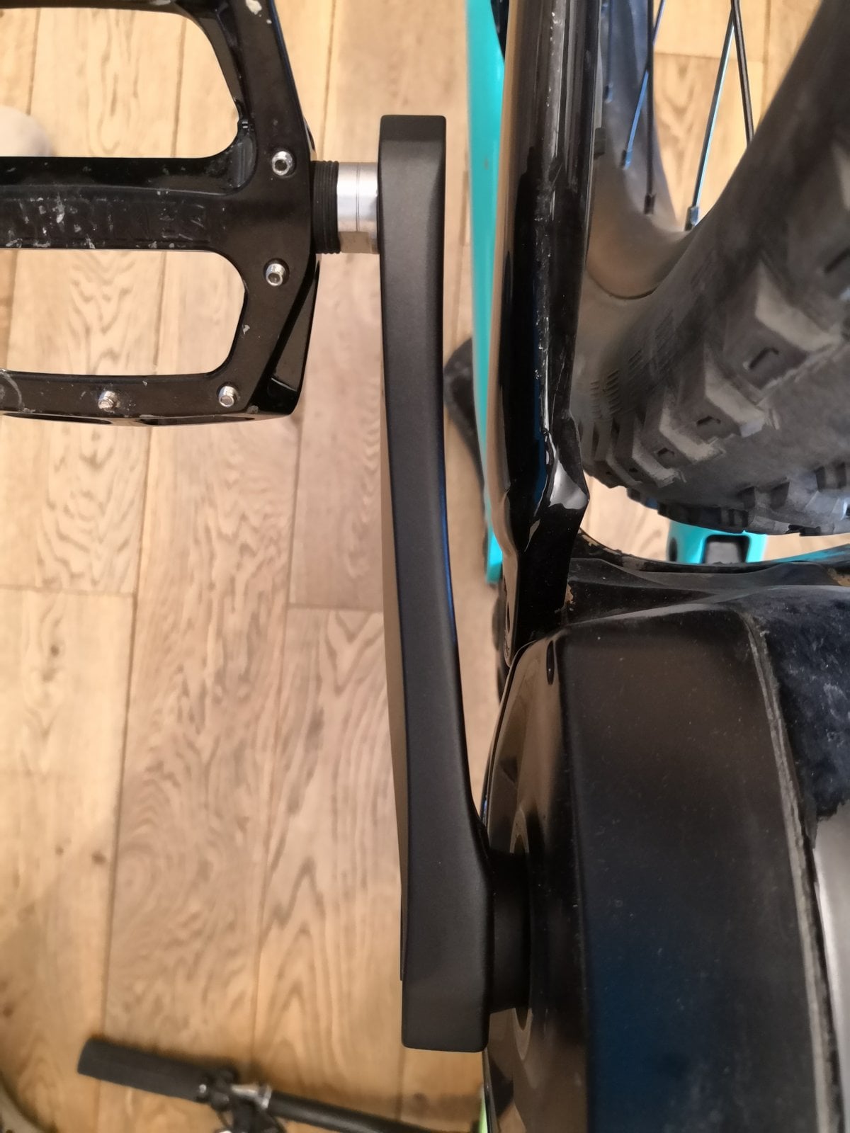

As promised, here are my thoughts on the Miranda Kapa O 150mm cranks.
After several long hard rides I can safely say, at least! 90% of my pedal strike problems are gone! I can now pedal while climbing over most obstacles I had to "race up to and coast over". And feel much safer.
I almost, disregard my pedals now, so I scrape them a bit when I get reckless, but another nice thing about the Miranda's it the squared off end on the crank, that saves you another 5mm and also when you do hit, it's the pedal scraping not the crank!
The Kapa's seem verry well built and have no flex, and look great in my opinion.

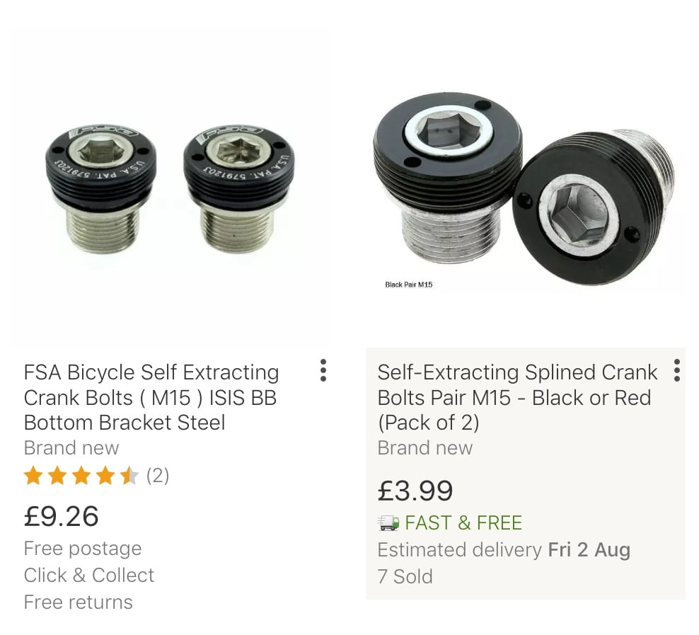

If you want to get hold of a set of self extracting bolts for your crank arms either of these should fit.
14,171
21,078
Kiwi in Wales
Short cranks rule!🏴󠁧󠁢󠁷󠁬󠁳󠁿
Jan 24, 2018
1,241
1,589
Carmarthen, Wales
Thanks for that .. Ordered ! :)
Edit :
A link to the cheaper "pair" of self extracting crank bolts suggested by Kiwi above :
Self-Extracting Splined Crank Bolts Pair M15 - Black or Red (Pack of 2) | eBay
Anyone know if these will work with the Indy ISIS Freestyle Splined Cranks – 140mm – Pair that Stumpy put the link to above ?
They will, I currently have the cranks and the bolts on my Levo.
You will need a Park tool SPA2 or something similar (thin long nose pliers) to fit and tighten the threaded inner ring.

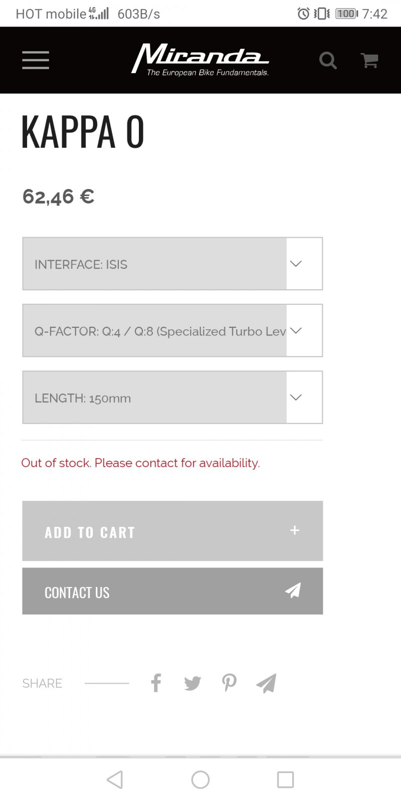

Hi Tim i can't find these listed on the miranda website?? it dosn't show 150mm?
And these will fit the 2019 levo as see ypu fitted them on the kenevo
Thanks
Tim69
Feb 25, 2019
180
210
Israel
Thanks
Yes, these are the ones I got..I see they are listed as out of stock, but ask them, how long it will take to get them.. they answered my mails.andvwere verry helpfull.
You could get the Delta model. Personally I think the Kapa is stronger and better. It's also what they recommend, and there is no difference in price so..
