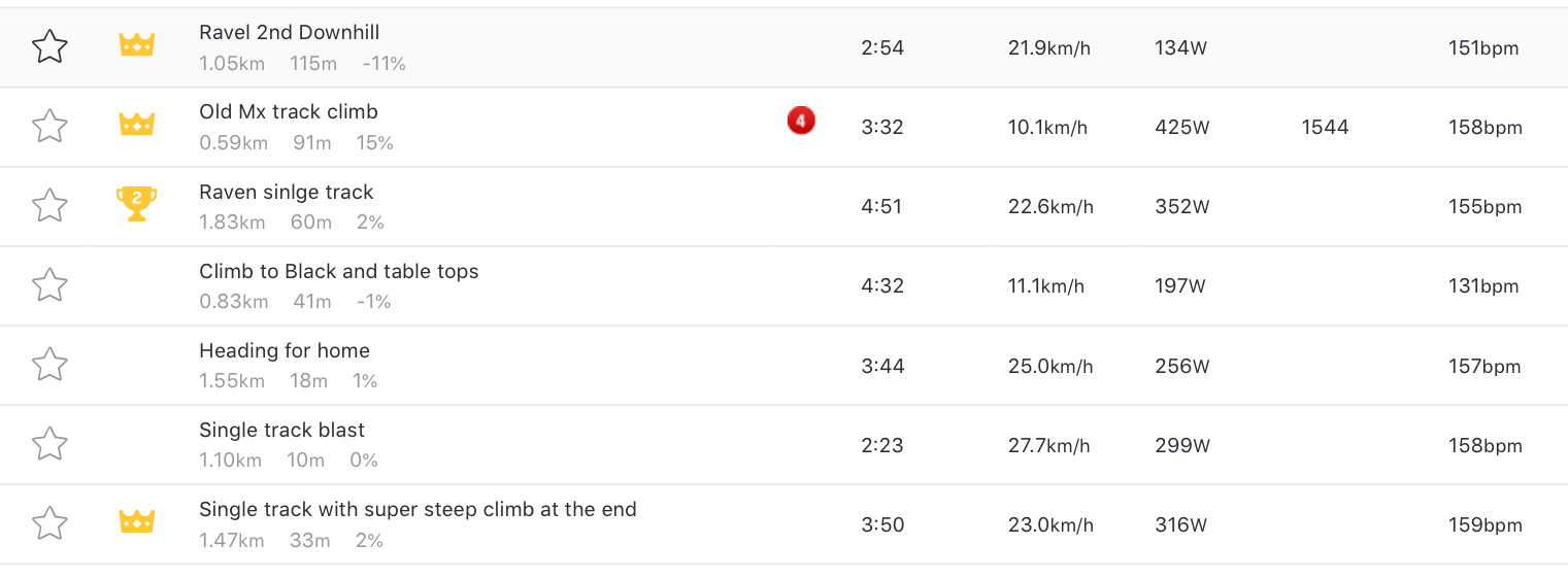

I am currently running with 137 cranks :eek: and happily doing the same trails just as quick as I was before. Including the downhill sections.
People love to poo poo things when they haven’t even tried or tested the actual item.... hmmm where have I heard that one before...... ah yes, I know when it was, it was when ebikes became a main stream item and load of haters suddenly appeared from nowhere?
This is a snapshot of the ride I completed yesterday, and yes, I know, Strava isn’t very accurate.... but at least it gives me a rough idea that my new 137 cranks are not giving me too many performance issues.

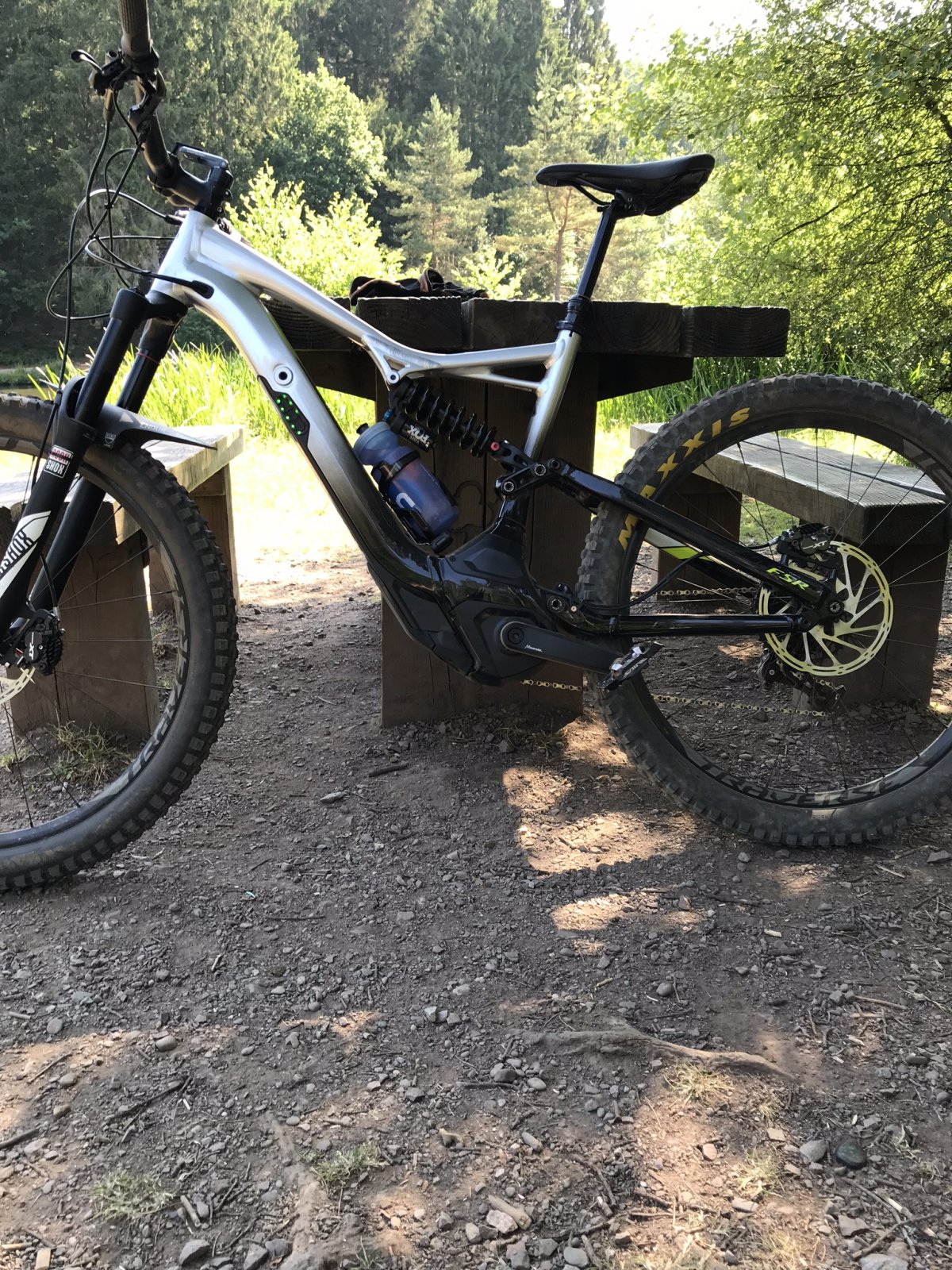

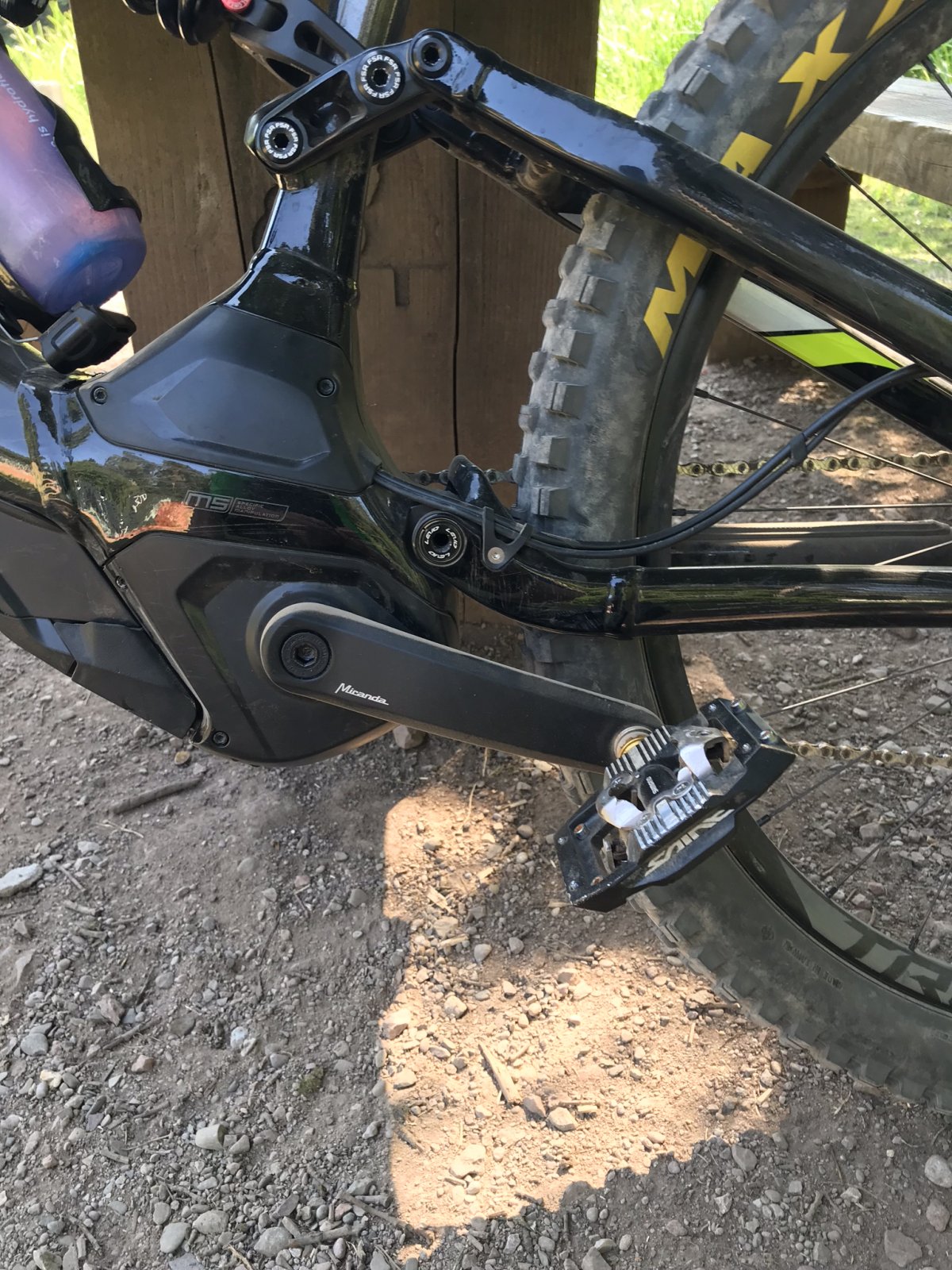

so Miranda cranks fitted this morning, one came a little bit chipped but it will get more very quickly so no drama, had to clean the threads as the anodising had overspilled a little.
I had to raise my saddle a little for perfect peddaling position and I use about one cog smaller than I would normally for a given situation but other than that there is no difference except NO PEDAL STRIKES yay!!
I had to raise my saddle a little for perfect peddaling position and I use about one cog smaller than I would normally for a given situation but other than that there is no difference except NO PEDAL STRIKES yay!! View attachment 2766 View attachment 2767
Yeah, both threads on one of my arms was horrid giving me aggro, especially fitting fiddly self-extracting cap.
Not had to move saddle myself but also fit very thin Crank Brothers Stamp large which helps.
Loving new setup ATM.
Great to hear Dave!
How are you getting on with the coil shock? I haven’t looked back since getting mine changed over.
I just noticed you have the quad piston XTs on. How are they performing in comparison to the Saints?

cranks are spot on, coil shock is fantastic there one fast peddally track i ride which is very bumpy with the old shock i had to stand all the way, with the coil I can just sit there and it feels like im riding on the road.
in my opinion, the brakes are miles better than the saints, much more modulation and zero problems

bit more info, just back from riding, picked all the biggest rooty trails this morning and pedalled over everything, got two very slight pedals "kisses" if I had done that with the standard cranks I would have been on my arse about 5 times.
so cadence is higher by about 10rpm and pedalling feels much more circular if you know what I mean and I have no hard evidence to back this but I am sure the bike is faster or at least my peddling is more efficient so I am quicker
all I can say is if you are considering this upgrade do it you will not regret it
