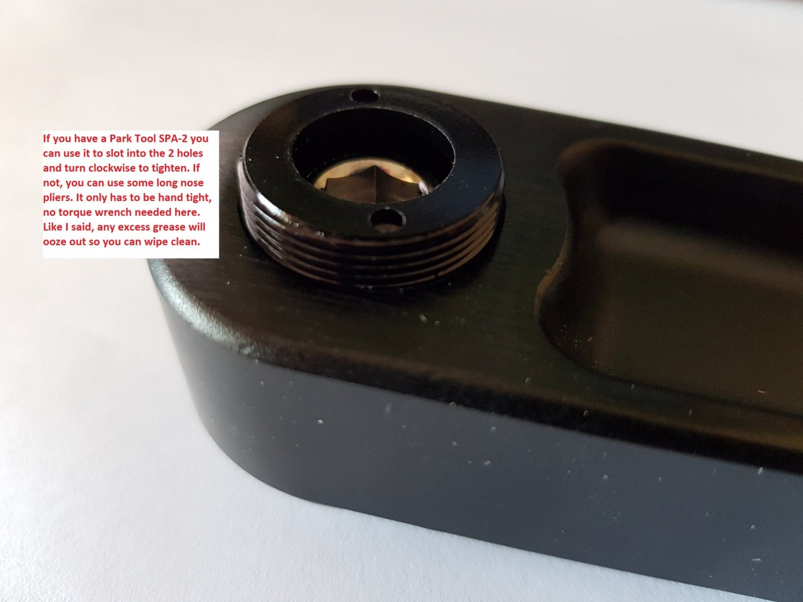

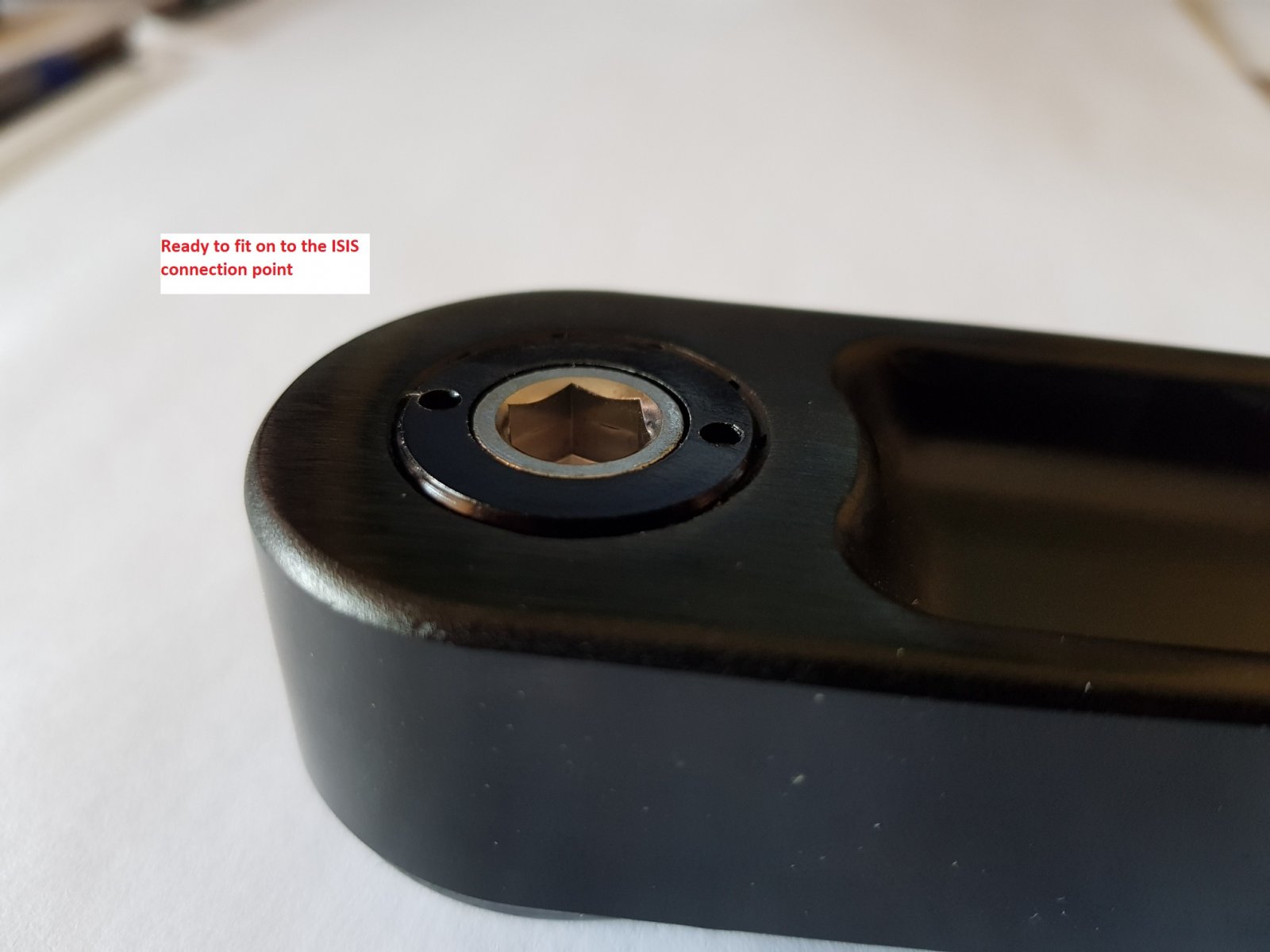

For those already changed (some multiple times ?) what grease are you using? Or copper ease?
Not ever having come across self extracting bolts before. My "normal bolts" arrived today along with everything else but guess my self extracting be here tomorrow. Can I assume the self extracting actually screw into the arm (prior to installation onto crank) as there is an outboard thread inside the new crank arms?

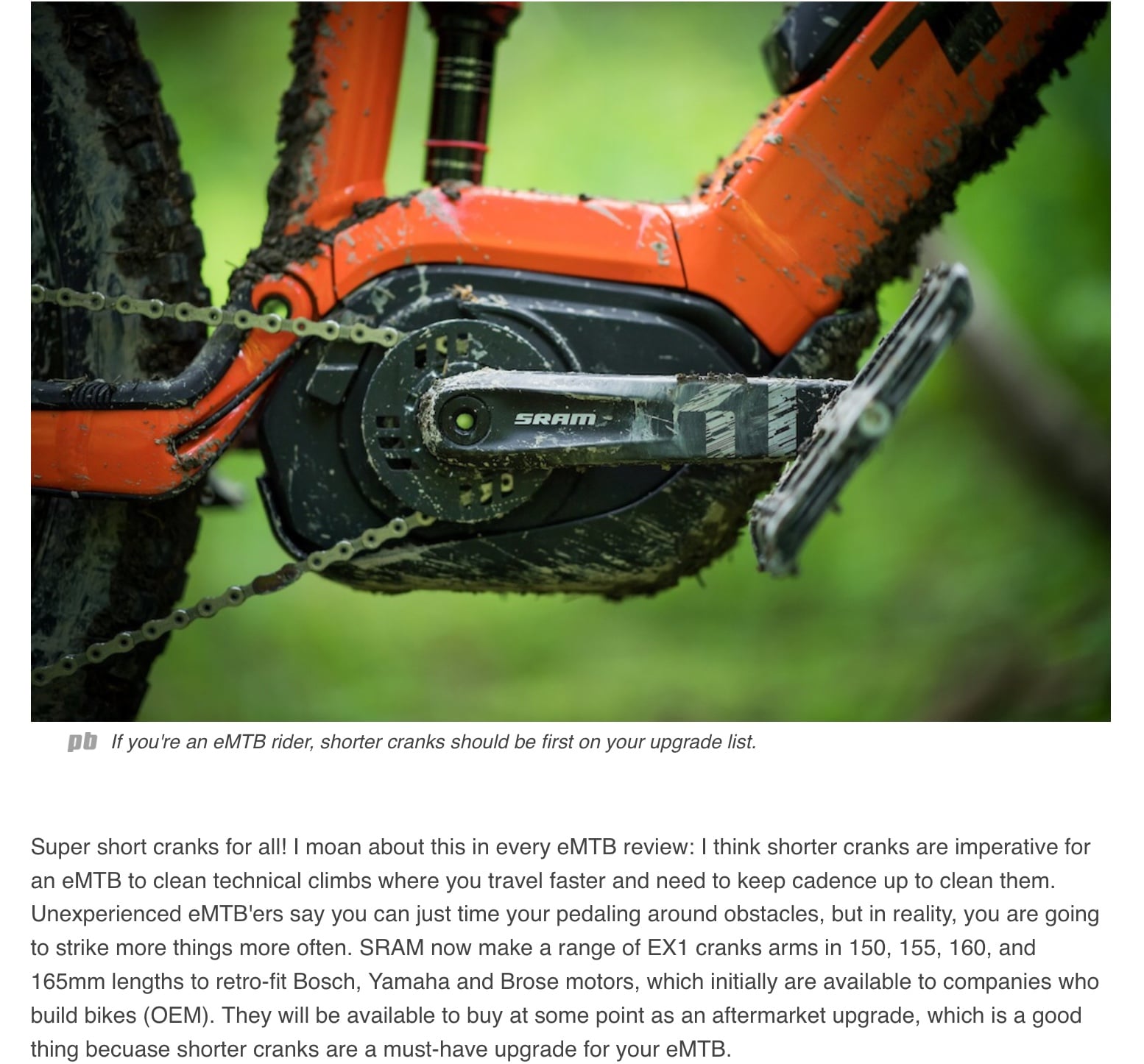

In other news, would seem SRAM is "getting it" now and will be offering a range of EX crank arm lengths;
New Products & Updates From Bell, SRAM, Formula - Bike Connection 2018 - Pinkbike
Good to see!
Here is the extract if anyone is interested

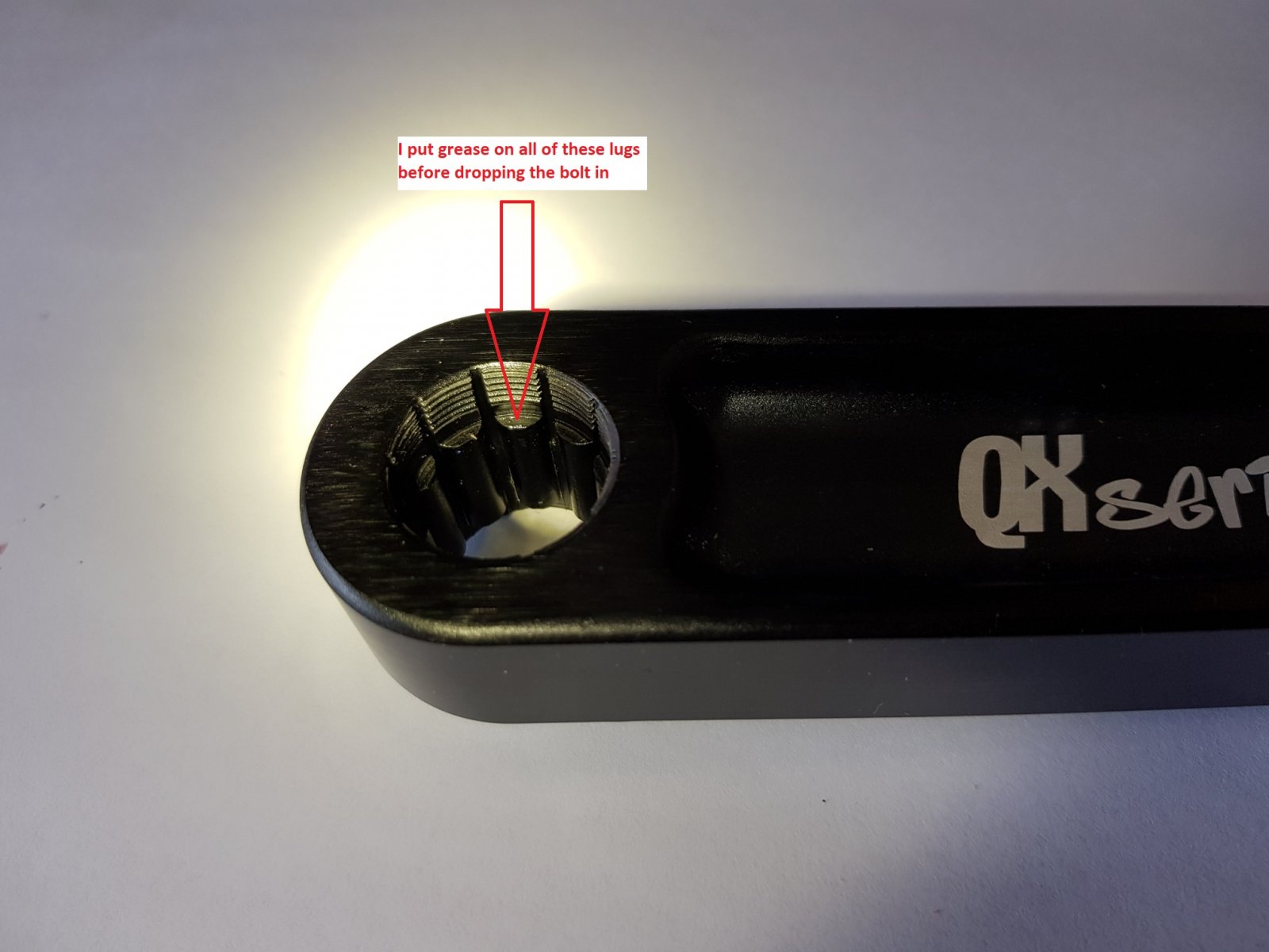

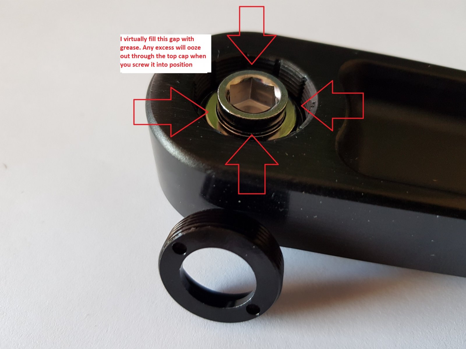

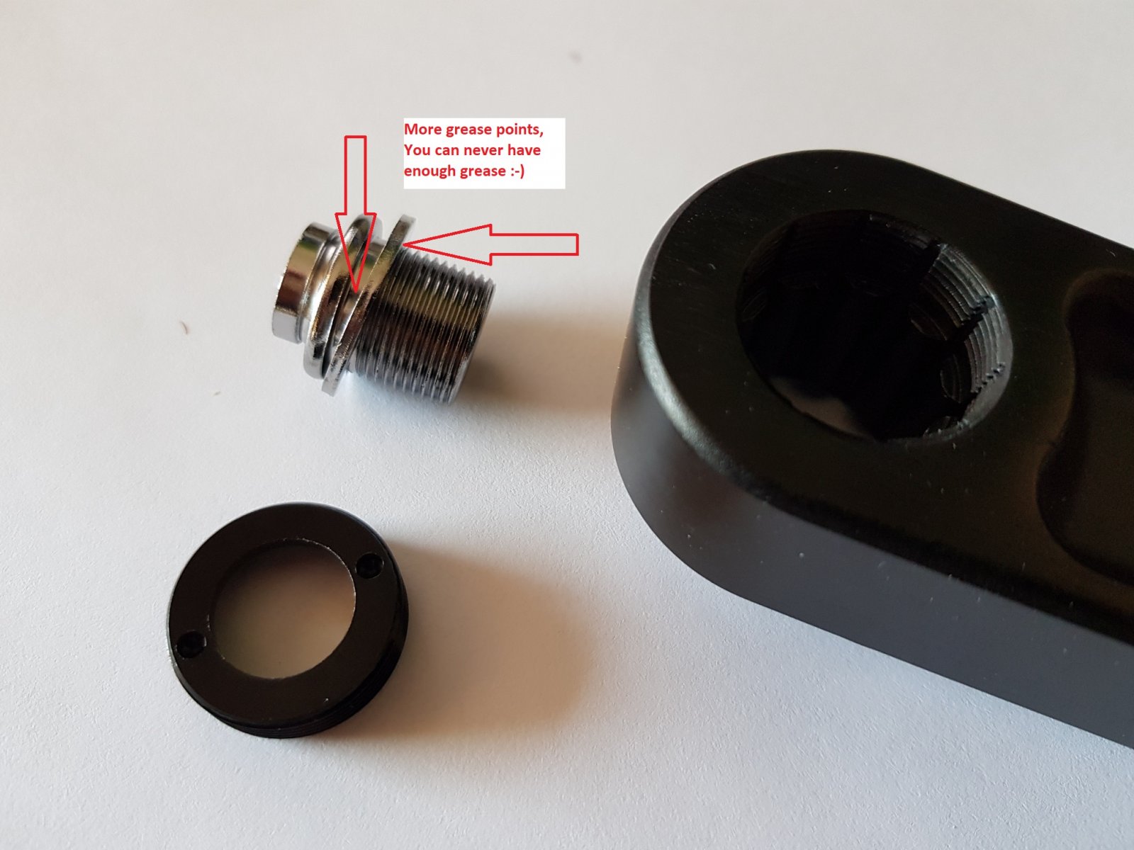

I will do some pics for you so you can see what you need to do.

Here you go

You Sir are a bloody star!
Seeing as fave country ever lived is NZ and my family are from Wales, no surprise I guess ?
I'll wait for the self extracting bolts tomorrow and leave the normal ones.
Thanks again! Surely such concise information will assist others too ?
Your most welcome ;)

Normal bolts secure the crank arm to the bottom bracket. To remove the crank arm you would need an Allen key to undo the bolt and a crank puller/extractor to remove the crank from the BB. The crank puller would need a spanner to fit it to the crank and an Allen key to drive the centre bolt.
Ice Toolz Crank Removal Tool with 8mm Hex Key - EMTB Forums
A self extracting bolt is essentially two bolts combined. A centre bolt that secures the crank to the BB and an outer bolt that secures the centre bolt to the crank arm but still allows it to rotate. When you undo the centre bolt, it pushes against the outer bolt which acts as a crank puller and removes the crank. Post #188 covers this very well.

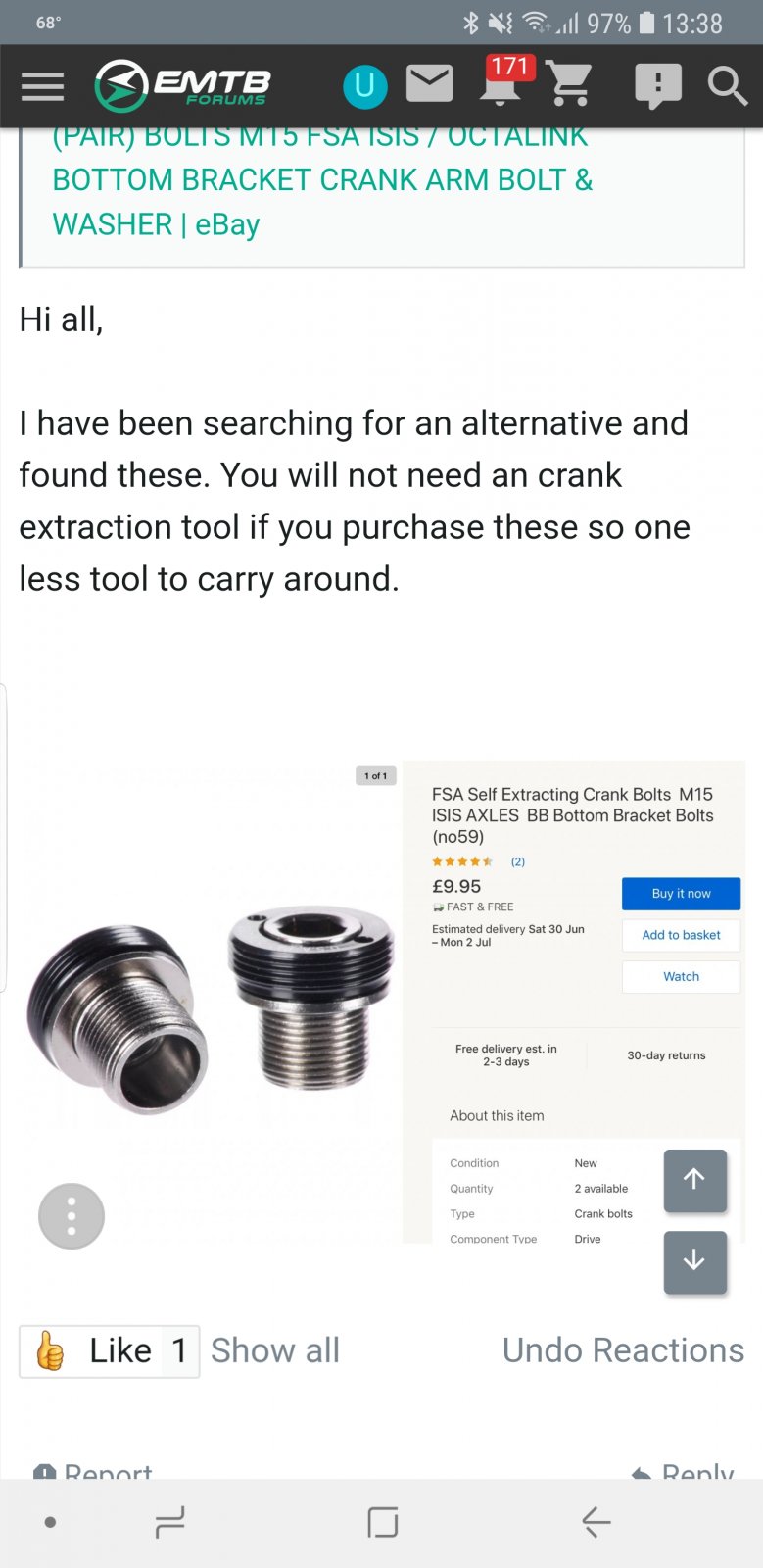

Ta. So if I want to change the crank arms on my Kenevo, will I only need an 8mm Allen key to remove existing crank arms and then just the new ISIS crank arms and M15 self extracting bolts?
UKPHOTO
May 21, 2018
64
90
United Kingdom
Basically yes. If you go back a couple pages in this thread Rob has a link to std bolts and Kiwi a link for self extracting ones.

@Kiwi in Wales In your post #98 above, you posted info for the self extracting bolts you found, but I am unable to grab a link from the photo. I may be missing it, but would you please repost a hot link that takes me to the merchant? Really appreciated the photos and info on your instructional Post #188. Thanks!
JayB
Apr 7, 2018
32
17
South Carolina, USA
Thanks UKPHOTO, this is the Post #98 on Page 4 that I referred to, but seems to be a pic instead of a hot link. I’m a new member, so I’m assuming I’m either missing something or don’t know how to grab the link. Working with Brian at Dillglove on 152mm crank arms, but would rather use self,extracting bolts.
ElectricGuv
May 30, 2018
37
8
I'm just manually typed and searched within eBay app, easy.

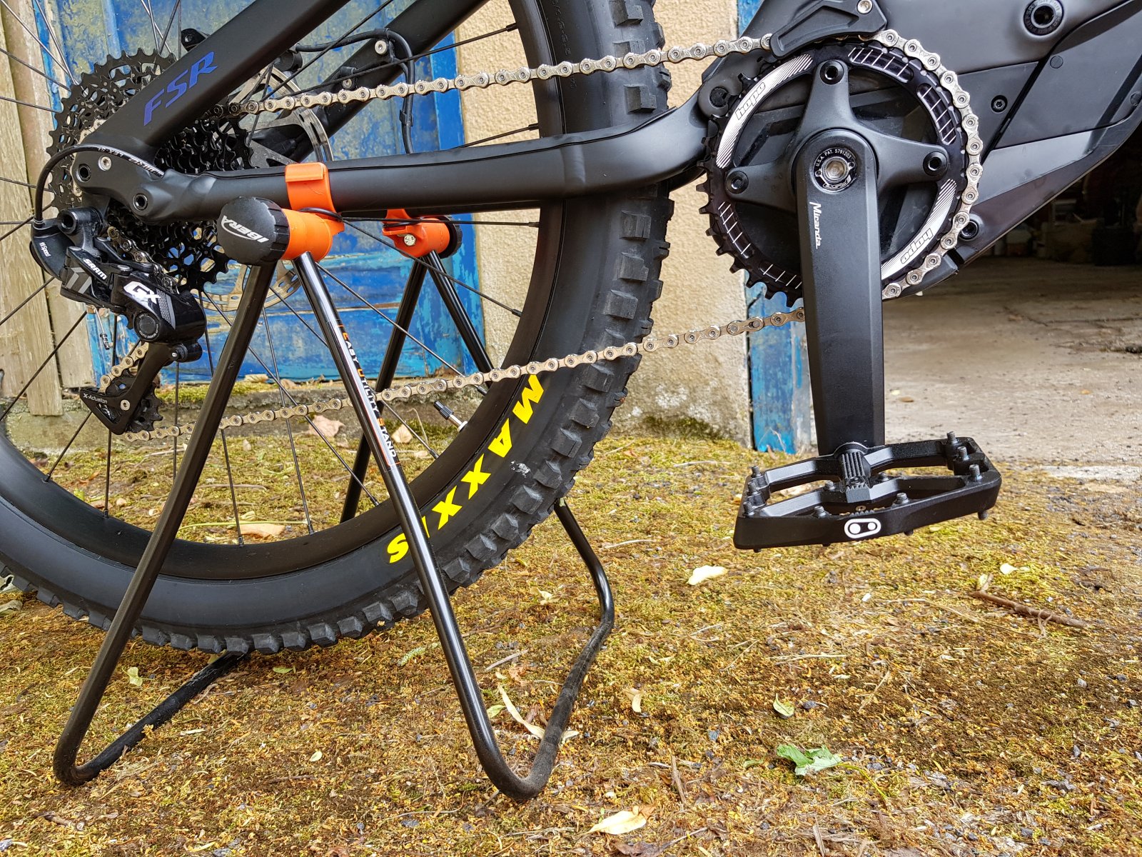

We'll, she's all done.
No fan of alloys and the one crank arm had rubbish crank and pedal threads, but I believe I won in end.
No real test as of yet but round an undulating garden all seems good.
Let me know how you get on
I like your bike stand!!!
I have one exactly the same, I find it great for doing minor work on the bike like supporting the bike while cleaning it, cleaning and oiling the chain, checking air pressure in the tyres, checking chain wear, gear adjustment, rear brake adjustment etc,
Great piece of kit and inexpensive! (y)
I like bike your stand!!!
Will do mate.
Currently re-indexing gears. My middle gears seem excessive in their changing (but I'm being finicky).
As for stand, I reckon it's THE most useful bit of kit I've bought!
On another note, I'm loving the Crank Brothers large Stamps thus far.
Was running Specialized Bennies, but seeing as changed front chainring and crank arms I treated her to new pedals too (thin as, even more clearance ?).
