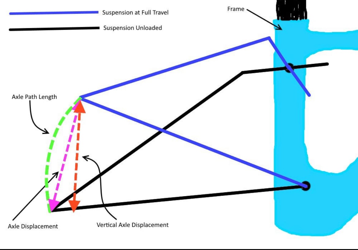

Yeah. nevermind accuracy. That simply isn't rear travel measurement at all.
you're not the first mtb journalist to make this mistake ;)
to physically plot the "actual" axle path:
Remove shock.
Remove rear wheel.
lay the frame on it's side as flat as you can on a large sheet of cardboard. (a helper would be ideal for this)
use a vernire and place shock mounts apart by exactly the shocks eye to eye length. - This is your starting point.
Now rotate the swing arm through it's travel drawing the arc with a marker through the dropout until the shock mounts are closer together by exactly shock stroke.
being an arc your measurement from dropout start to finish point will be a tiny bit less than full actual travel. if You really want it to be exact. it's a simple geometric maths equasion based on the angle and length of lever (eg. swing arm length or virtual pivot point arc and length if its a horst or VPP). but the start point to end point measurement is generally only a mm or so shorter.
frame in a proper workshop bike stand that won't move and cardboard (bike box etc.) held vertically to the side of the frame would also work quite well.
Or measure every pivot point very accurately and use linkage software.
Well, It’s vertical wheel travel I measured. So technically is a measurement of rear wheel travel 🙂
I agree, it’s not the exact measurement that manufacturers use (although their quoted travel number is likely not the exact figure either, it’s too rounded and nicely marketable a number to be always ending in a zero!)
I totally get that it’s not following the exact arc that the rear wheel travels. I wonder how much of a difference in reality this number will be, versus the variation of measuring the exact axle path. Obviously will differ from bike to bike depending on a few things.
My measurement works out Axle Displacement, not Axle Path Length 👍 for sure there will be a difference, but I’m not convinced that it’ll be more than small single digit % variations?
No Rob.
Believe it or not most bikes do actually have very close to the actual quoted travel. Designers don't just guess linkages and shock eye to eye lengths.
Your (wrong) measurement can easily be anywhere between 4-10mm out. (depending on traval and true axle curvature).
At an "educated" guess I'd say you're right around 6mm out this time 😉.
PS. Fork travel would be shorter too if measured your way.
