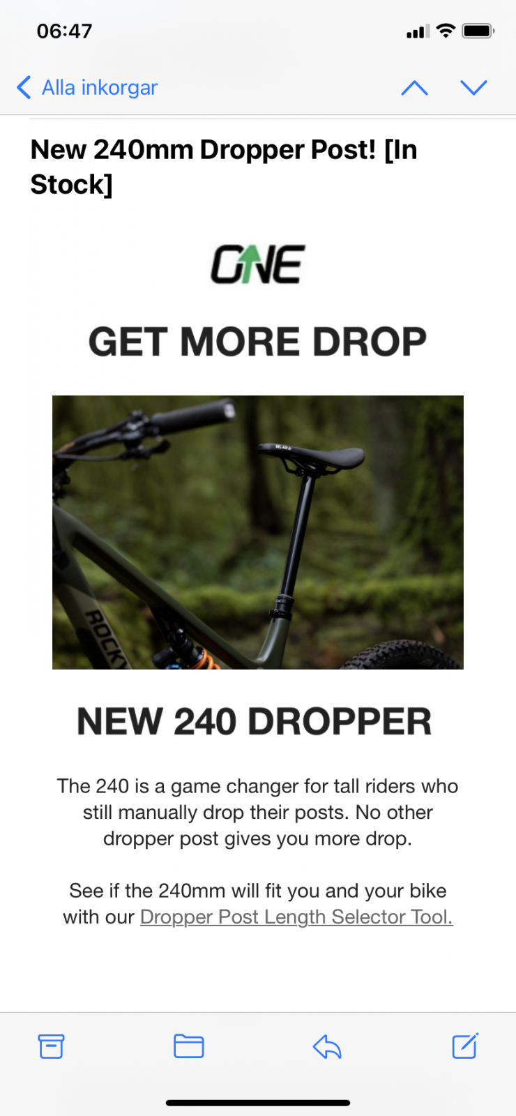

Btw if you want a longer dropper Oneup has it's 180 in stock here in EU. I got one for my E+1 medium. I got inseam 81.
Just pick the right diameter 30.9.
You can shorten it internally down to 160mm internally (10mm steps). Almost like you can take the 210mm version (can be shorten to 190).
I can drop a picture how mine will look. It's on it's way now and I will most likely get it this week.

I was also considering the oneup dropper...yeah a picture would be great, I maybe could get away with the 210...but am not sure if there is enough insertion length in the seattube...I think the 180 would be good enough though ✌

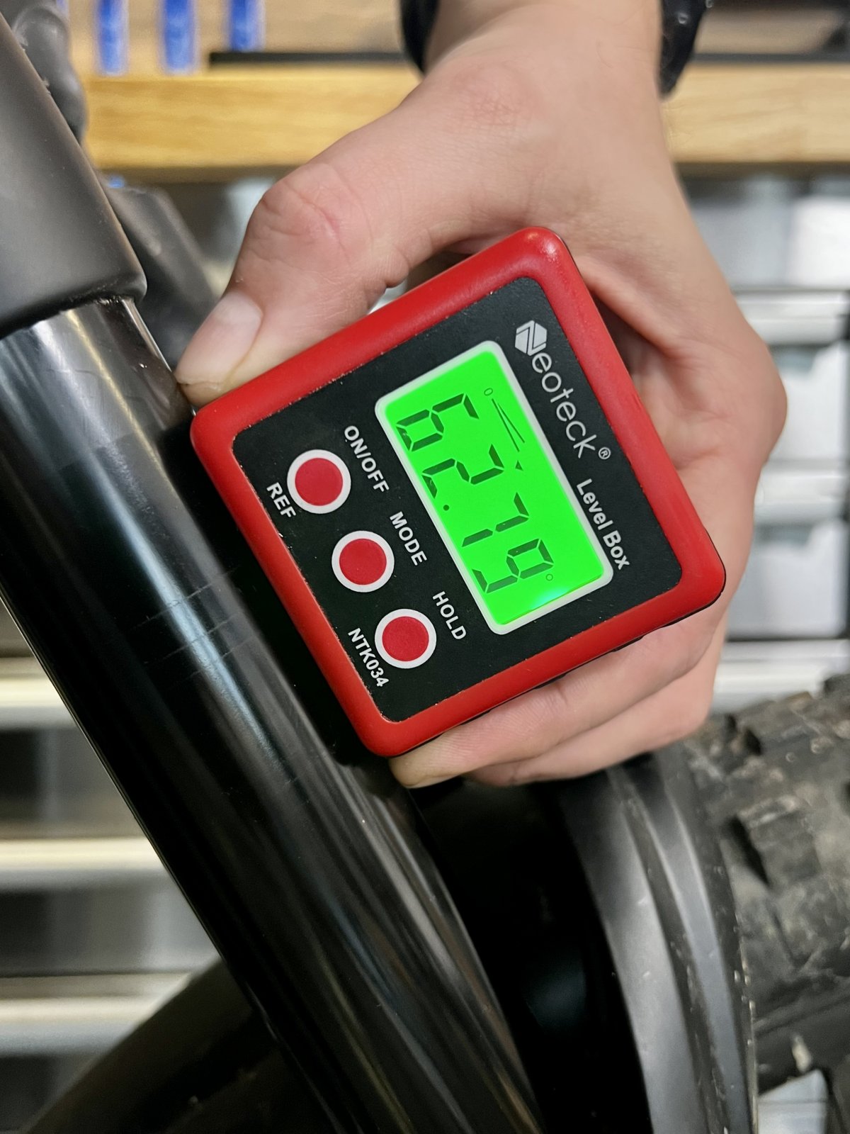

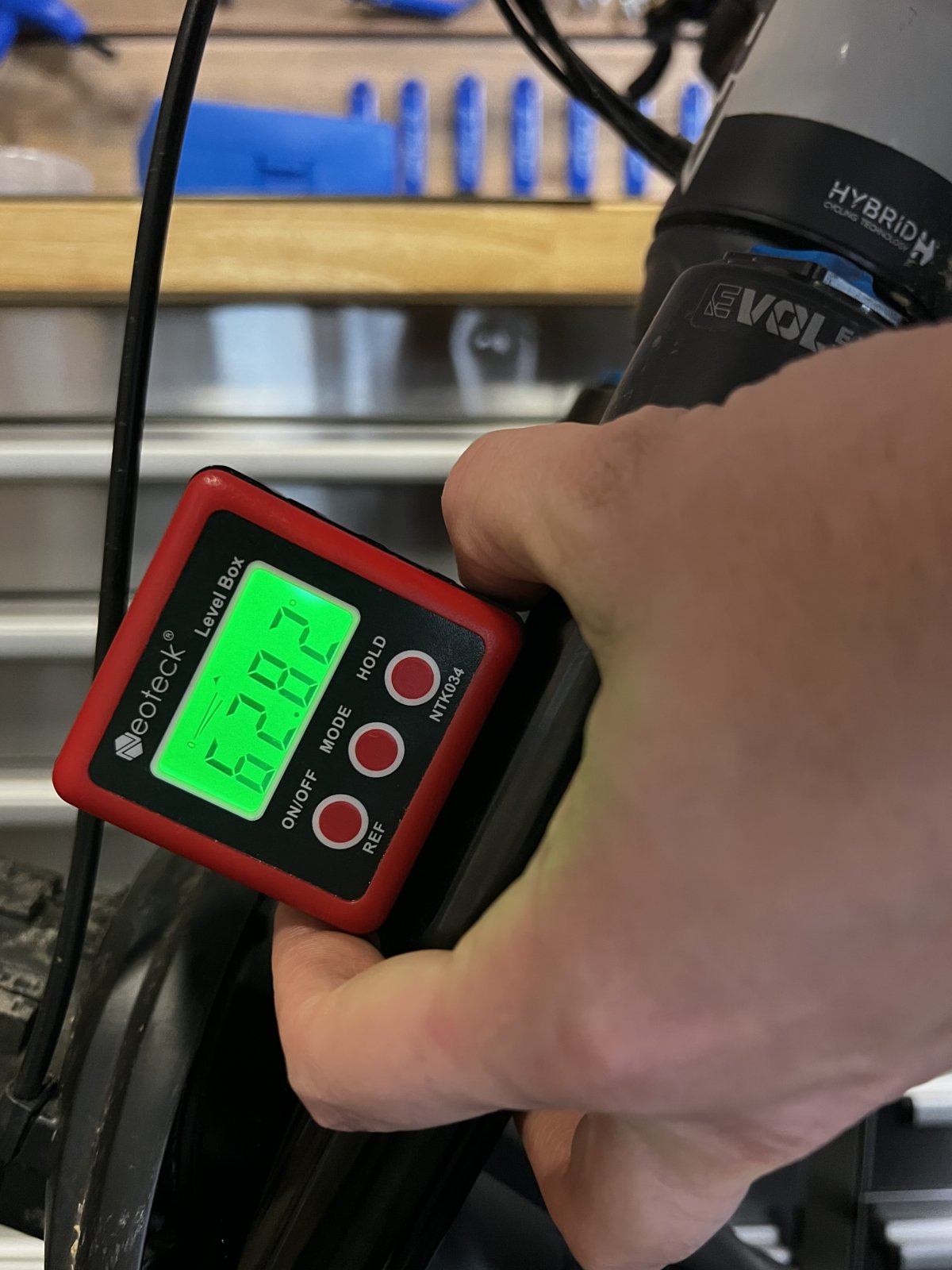

Measured head angle in HIGh position.
Slacker than BoJo’s leadership ethics….
Rotated 180 degrees to account for any variations in floor

Phew... Anything over 63 and I dread to think of the consequences descending the incredibly steep high speed Surrey Alps. ;)

How did you measure it? If you're not in some way or another plotting the actual axle curve it won't be accurate.
Yeah agree, it won’t be totally accurate due to axle path but the closest I can get.
method:
- bike upside down
- front and rear axles level
- inflate shock, so stroke is maxxed out
- measure rear axle height (measurement 1)
- deflate shock, use a ratchet strap between rear wheel / seat post to bring rear wheel through travel and max out stroke
- Make sure shock fully compressed as far as stroke will go
- Measure rear axle height (measurement 2)
- Subtract measurement 2 from measurement 1
actual ‘travel’ will be across an arc where the rear wheel flows, which as far as I can tell is not all vertical travel.
It’s not 100% accurate, but can be useful comparing actual vertical travel across bikes. Its as good as I can get at the moment 👍

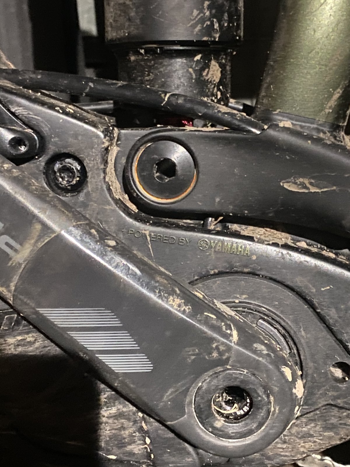

Does any have a picture of their non drive side which might show this bolt head as I can’t remember if there is a cover over it as I don’t remember seeing it set this far back. 🤷‍♂️ Thanks guys. And yes it needs a clean 🤣

not surprised at all with that head angle. feels like 63 in the high setting to me. i won't ever be using the low setting.
measured the BB height and got about 332 to center. Giant said they went as low as the possibly could and it was an important design parameter but i wouldn't mind if it were 1cm higher as these bikes sit far into sag anyways when riding, but i think Giant and their riders, know exactly what they are doing so....

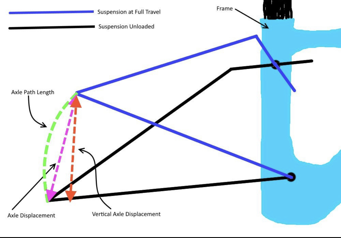

Yeah. nevermind accuracy. That simply isn't rear travel measurement at all.
you're not the first mtb journalist to make this mistake ;)
to physically plot the "actual" axle path:
Remove shock.
Remove rear wheel.
lay the frame on it's side as flat as you can on a large sheet of cardboard. (a helper would be ideal for this)
use a vernire and place shock mounts apart by exactly the shocks eye to eye length. - This is your starting point.
Now rotate the swing arm through it's travel drawing the arc with a marker through the dropout until the shock mounts are closer together by exactly shock stroke.
being an arc your measurement from dropout start to finish point will be a tiny bit less than full actual travel. if You really want it to be exact. it's a simple geometric maths equasion based on the angle and length of lever (eg. swing arm length or virtual pivot point arc and length if its a horst or VPP). but the start point to end point measurement is generally only a mm or so shorter.
frame in a proper workshop bike stand that won't move and cardboard (bike box etc.) held vertically to the side of the frame would also work quite well.
Or measure every pivot point very accurately and use linkage software.
