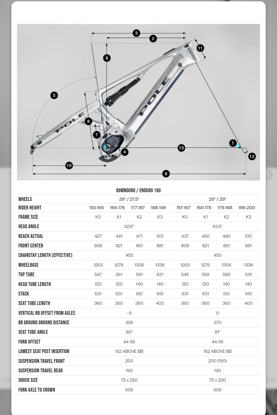

Pole Voima 190mm Travel EMTB
Durrti
Aug 22, 2021
164
164
California
Really? I was trying to find that on the website but couldn't find that information anywhere.
The geometry for the trail build shows it now.

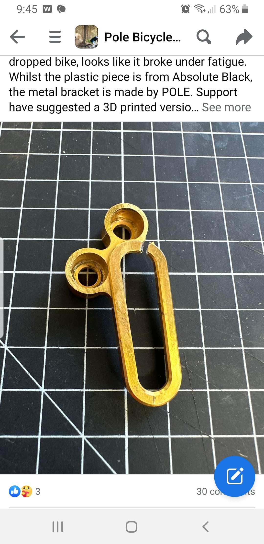

What's up with the Pole chain guide?
Multiple examples of the thin alloy bracket breaking.
Side note. I've done 500km without a chain guide (waiting for the velovision one to turn up). Chain has fallen off twice.
PS My 500km has been pretty hectic. Not many easy km in that 500.

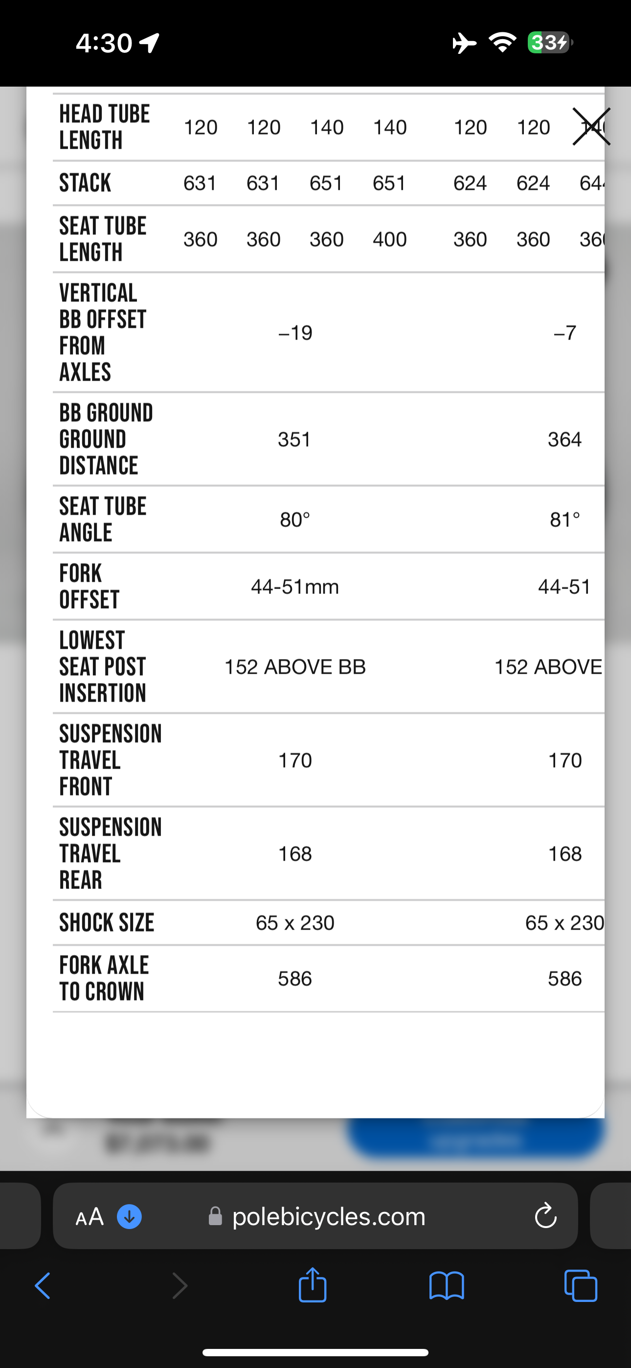

So it can officially be mulletted now according to their website.
Just wop a 27.5" wheel on and call it a day by the looks of the geo table!

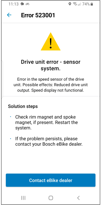

All the issues…
My XO Transmission is fully f-cked. Reinstalled and put in a new chain today, but still chain still skips all over the place in 3rd gear and even a bit in 5th. Install fully dialed with torque wrench, etc.
Going to remove Transmission and install regular ol’ eagle axs stuff off the pedal bike to see if it behaves.
Also, finding motor randomly turned off (I.e. no lights, fully off) at the bottom of chunky descents. Happened 3 times today. Motor power also cuts in and out when pedaling for a bit after I turn it back on. Super weird.
I guess I have to bring in to a Bosch dealer to have them run diagnostic to check for error codes? Wish I could do this myself. F-ck.
That's sucks re the drive train. Surely you can take it into a bike shop for a warranty claim?
The flow app does show error codes. That might help you pin point the switching off error.
Ps The switching off sounds like a loose connection. I'd check all your plugs and battery connection to see if anything is loose or not plugged in properly. Unplug and plug back in. Look for bits of debris stopping the battery locating correctly.
How many km are you at?
No kms yet, but I’m at 400 freedom units (kidding… wish we were metric actually).
My charger flap was open when I got home from my ride with electrical issues. I’m hoping some dust or water got in there to cause the issues. That would at least be easy to solve.
The drivetrain sh-t is really annoying. Not a good sign for SRAMs new system that I’m tearing it off after 400 miles. Sounds like there are some other folks on here with similar stories, so hopefully we get it sorted. We are the canaries in the coal mine testing the new T-type system on e-bikes - way more watts and distance.
Where does the Flow app show error codes? Tried to find but no luck…

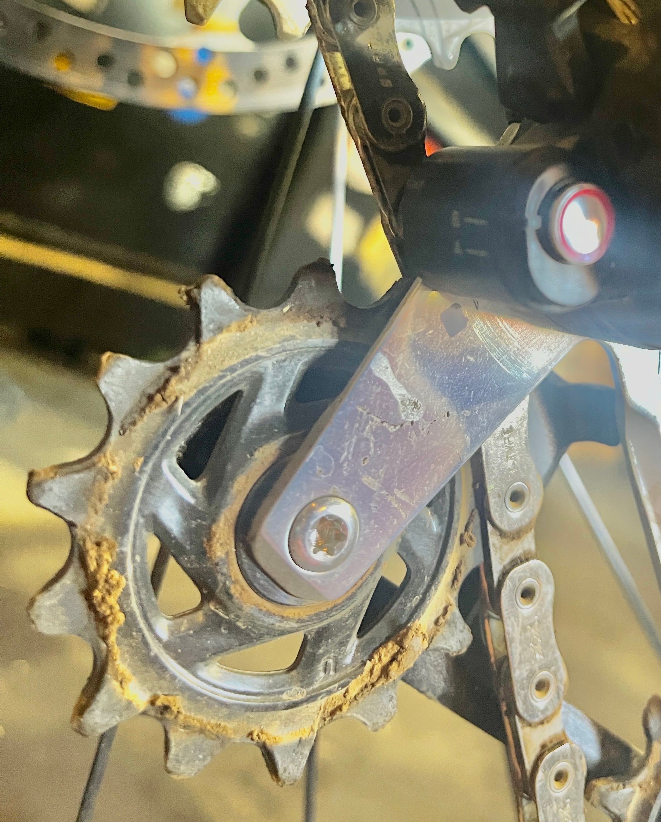

Let’s try this another way…
Is anyone using SRAM Transmission on their Voima and NOT having issues (particularly in gear 3)?
I have micro adjust on 1 (i.e. fully inboard) and it’s still clicking like it almost wants to shift up/outboard. My derailleur clearly wants to be closer to the cassette.
I literally get better shifting if I max out micro adjust to 14 in the other direction and shift the range over by 1 (but obviously I loose gear 1 and risk dumping the chain off the cassette if I shift to gear 12).
I’m looking for some kind of spacer or something I missed (?). Cassette and derailleur clearly want to be a few mm closer together.
Stumped.
Stumped.
Link to video:
I have transmission working well on my Voima after changing to the B setting. Have you tried moving the chain one link on the cassette in case it isn't syncing exactly?
Have you check the cassette for bent teeth?
Apart from that I'd loosen it all and reinstall ensuring it's per SRAM instructions then if that doesn't do it get onto SRAM and see what they say.
Thanks. Out of curiosity, how many miles do you have on the new transmission? Is it the original Voima or the Voima ID with the updated chainstays?
Reinstalled mine half a dozen times now, no luck. Like I said, mine worked like butter when new, now this. Reached out to SRAM yesterday but nothing yet.
Yanked it all off today and back to X01 AXS. If anybody was wondering, the T-Type chainring is absolutely compatible with Eagle. So much marketing BS…
Stumped.
Link to video:
Seems like maybe a bent tooth on the cassette. Do you have access to another cassette to see if that’s the issue? I would do that so I could eliminate that possibility. If that’s not it, then it’s the derailleur.
