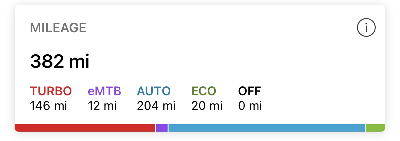

How many miles/km have you done?
Blownoutrides
Mar 22, 2021
244
182
Pull the hub down and have a look at the palls. yourl be able to tell if they are letting go. Also if theres too much factory grease in there that maybe part of the cause.
I like the grease theory. When it started creaking I pulled it apart and regreased (official DT Swiss special sauce) maybe I did too good a job.
382mi / 615km since first ride on 5/20 so about 2 months
Guessing about 95,000ft elevation so far (local lap is 4 miles and goes up 1,000ft).
