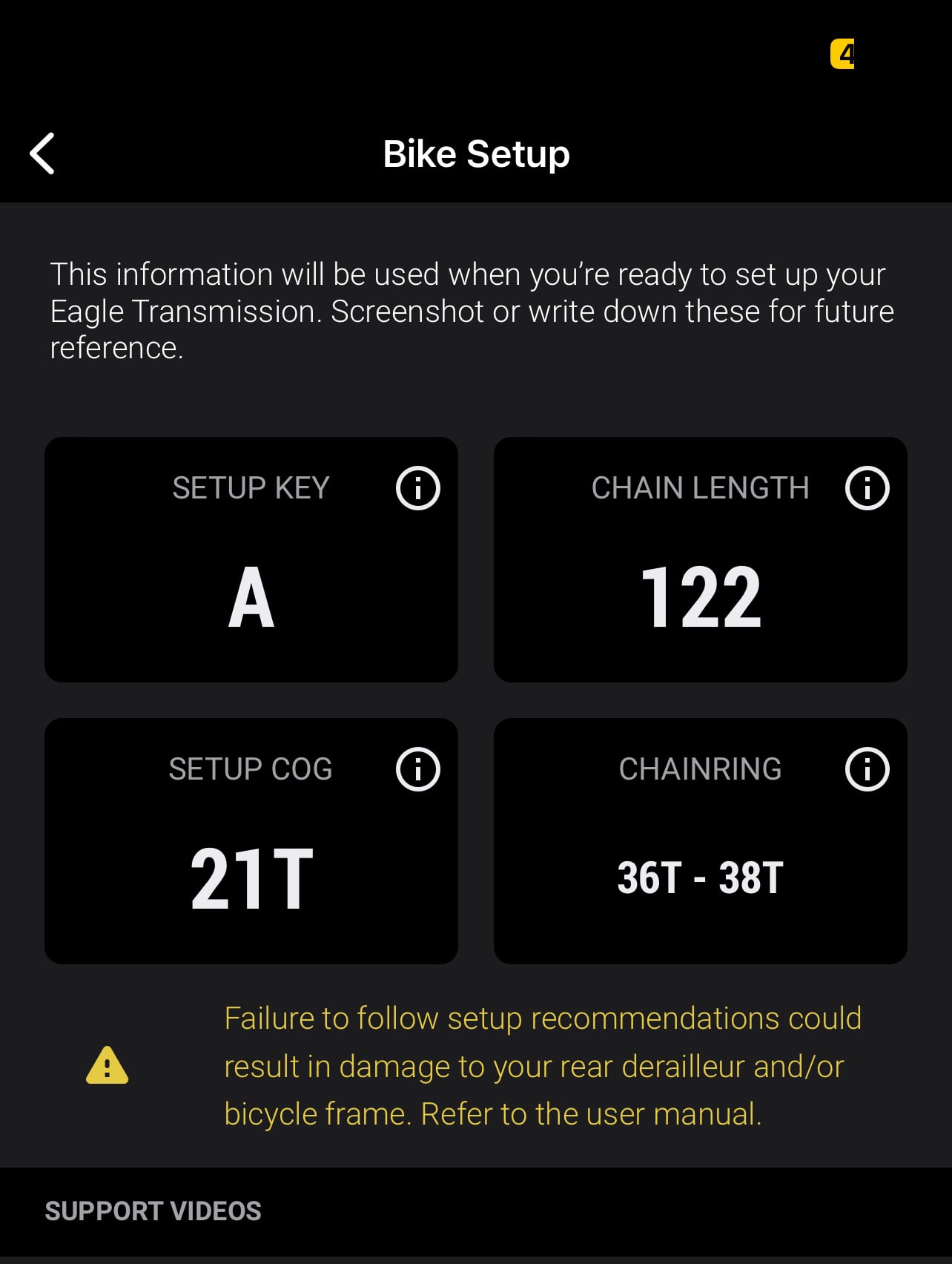

Update on this. SRAM just got back to me and said it should be in the A setup key. Also I think they have adjusted the website and app to both state A. Funny how only B works for me lol.
Would you mind posting exactly what SRAM wrote to you?
Maybe I’m just cynical, but I have a hunch they just went to the website and regurgitated their own mistake back to you.
I’ve ordered a GX cassette for $250. If that solves the problem I’ll know it was the cassette. If it doesn’t I’ll know it’s the derailleur.

Here's the reply from SRAM..
Seth (SRAM (Tickets))
Aug 1, 2023, 15:01 CDT
Hello,
Thank you for reaching out! I am sorry to hear about the confusion you are experiencing between the app and website.
It looks like all models of this bike have an effective chainstay length of 455mm, is that the value you entered? I tried entering that, with a standard 32t chainring, full-suspension, and no idler pulley as options in the app and on the website and got the same results for both.
iznWjWKYgl39ovlegsiJQlv41
Would you mind trying the app again with the same information to see if it lists A or B? Are the results in the app and website for the chain length the same as I found?
Please let me know if you have any further questions or if there's anything else I can assist you with.

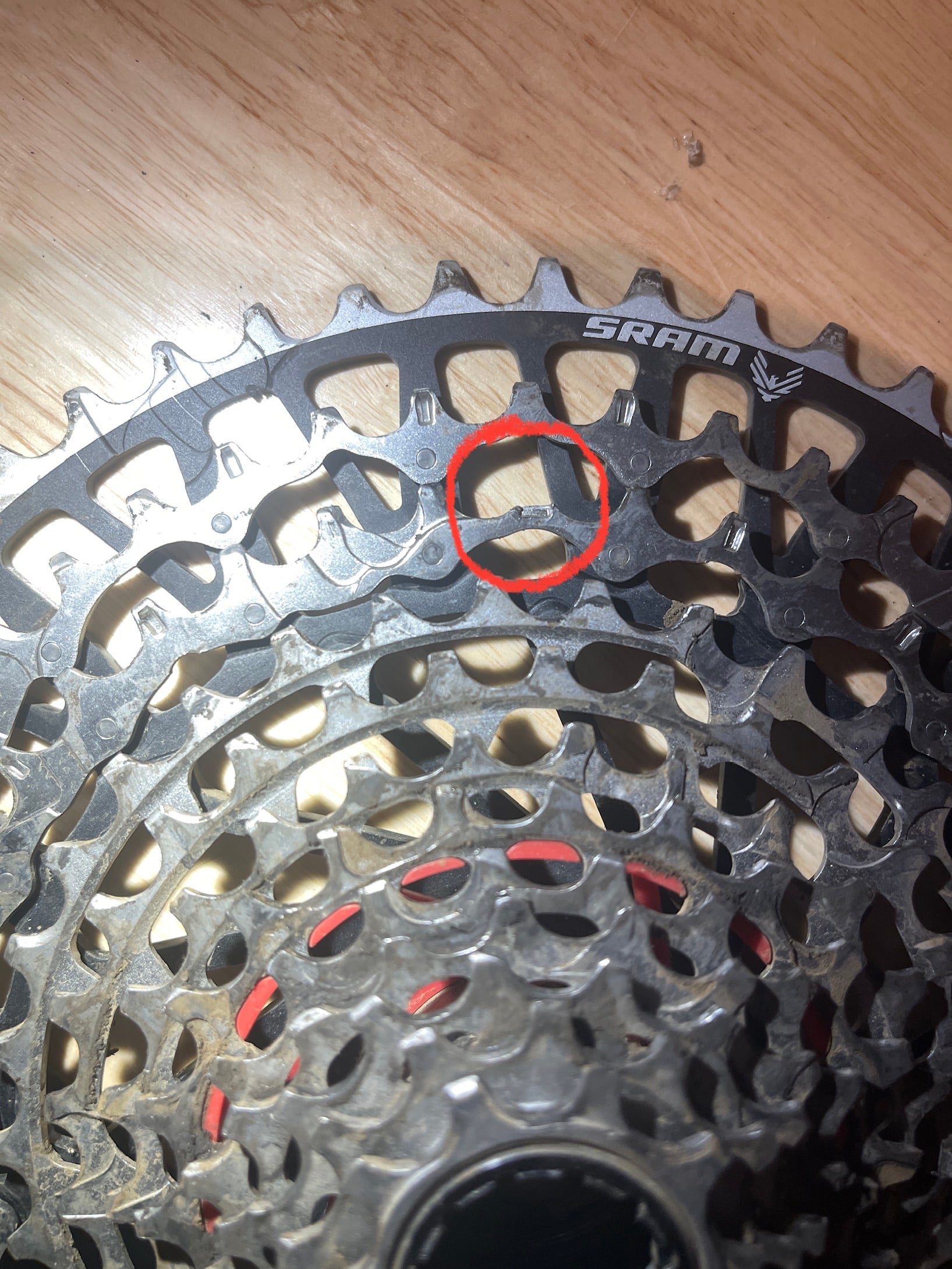

Welp, thar she blows…
This particular tooth has a groove cut across its base. If I wanted to sabotage a tooth, this is exactly what I’d do. I’ll try warranty but I’m not optimistic.
Hello,
What should I do now? I want to install my GX today.
I get setup key A both in the app and on the website but Rob has installed with Key B :unsure:
This is the new unbreakable can shift under full load robocop finger electric sram? if so theres a case for warrantee.
If the derailieur is auto adjusting and can shift under load how is a tooth broken off?
Side note. If warrantee is rejected i'd try to file the daggy bits of that tooth and see if you can ride it filed. It might work enough to get more miles out of it.
Return it and get the “old” Eagle AXS LOL.
Kidding… kinda. Was in the LBS today and owner has just had their first Transmission-equipped sale (Gorgeous Pivot Firebird) come back after a few weeks with the same gear 3 issues, crappy shifting in general, plus a broken chain.
Apparently owner is also a big guy 220lbs so I hear. Maybe if Transmission is allergic to high torque individuals.
To stop this derailment and answer your actual question I’d try it both ways in the stand and see which seems smoother.

Yes my cassette is proper tight to get on. It actually produces quite a bit of heat there is that much friction.
Hello,
Weird, I’m just setting up my GX Transmission and it’s telling me I need a 122links with my chain.
