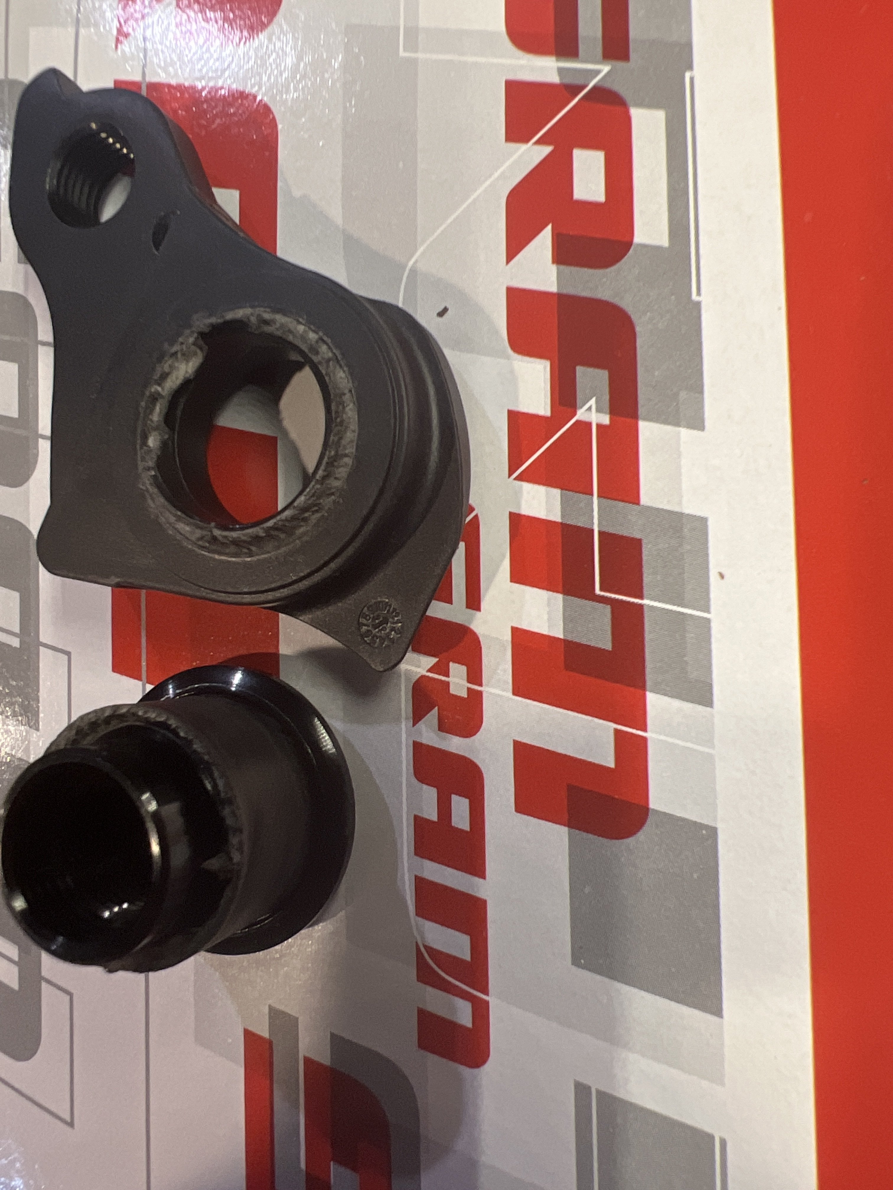

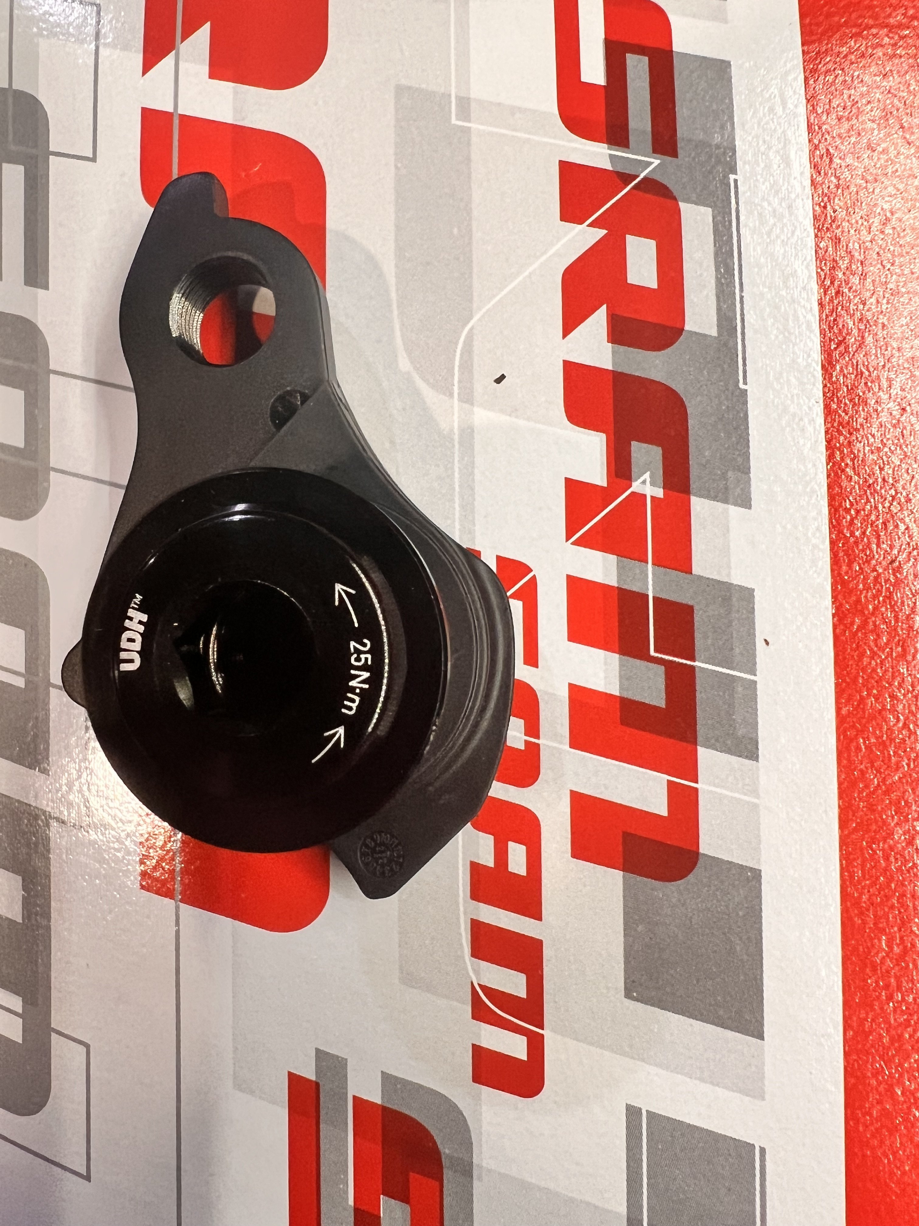

So… neglected to do a bolt check and the rear axle let go just before a gnarly feature (thankfully).
Ordered replacement parts which arrived today so started fitting them and now have a question.
Am I the only one who tried to torque up a UDH hanger to 25NM as it reads on the bolt?
