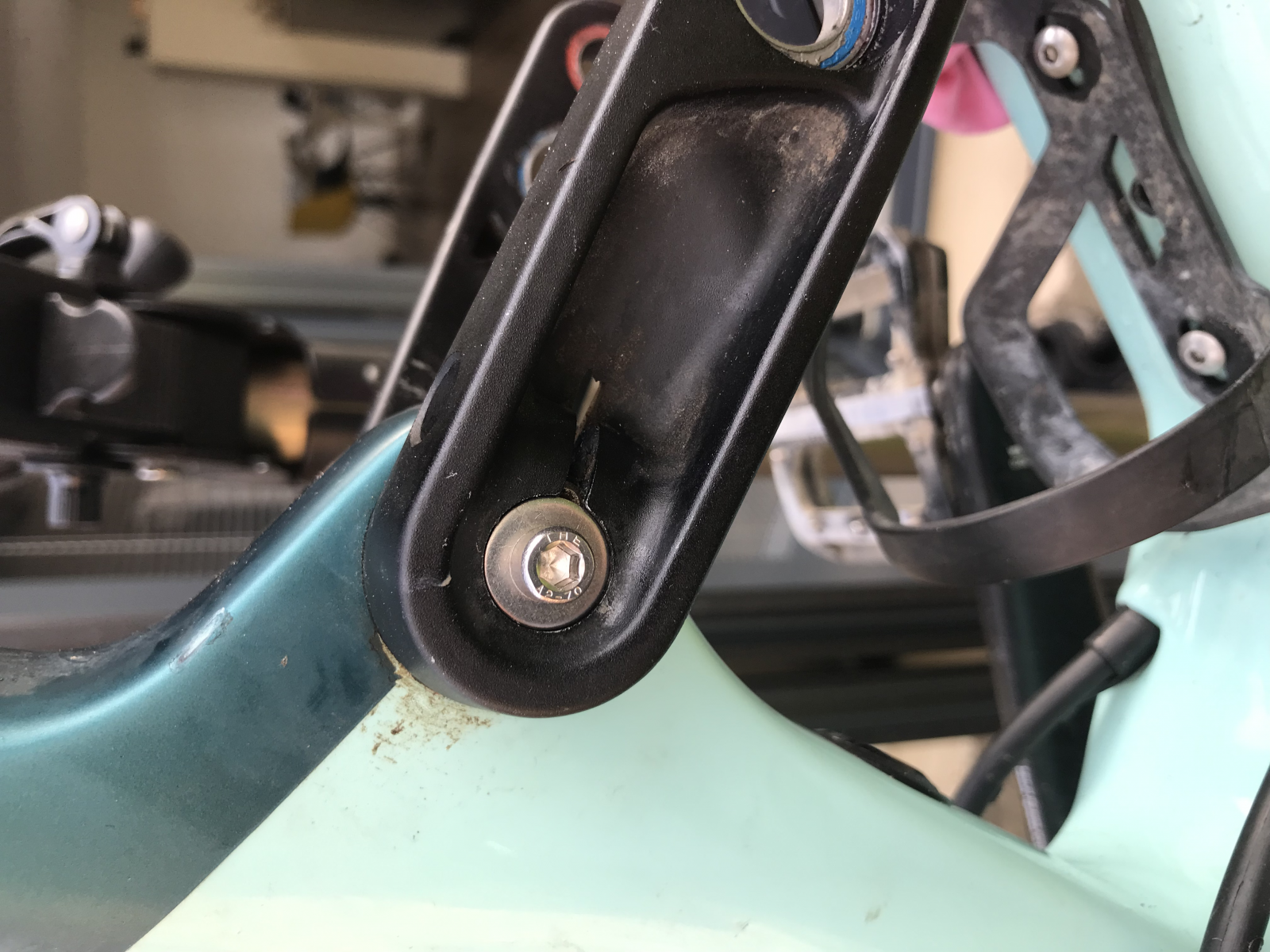

I'm starting to get worried...
While I keep tighten it got harder, not sure to go ahead because axle appears to be broken 😭😭😭

I tapped that out with a rubber mallet. I did the upper link service this weekend and @Rod B. I found this thread very helpful. It's quite rare that a how-to actually answers questions that the white papers leave out and this one does just that. Well written, easy to follow and provides great info.
Thanks.

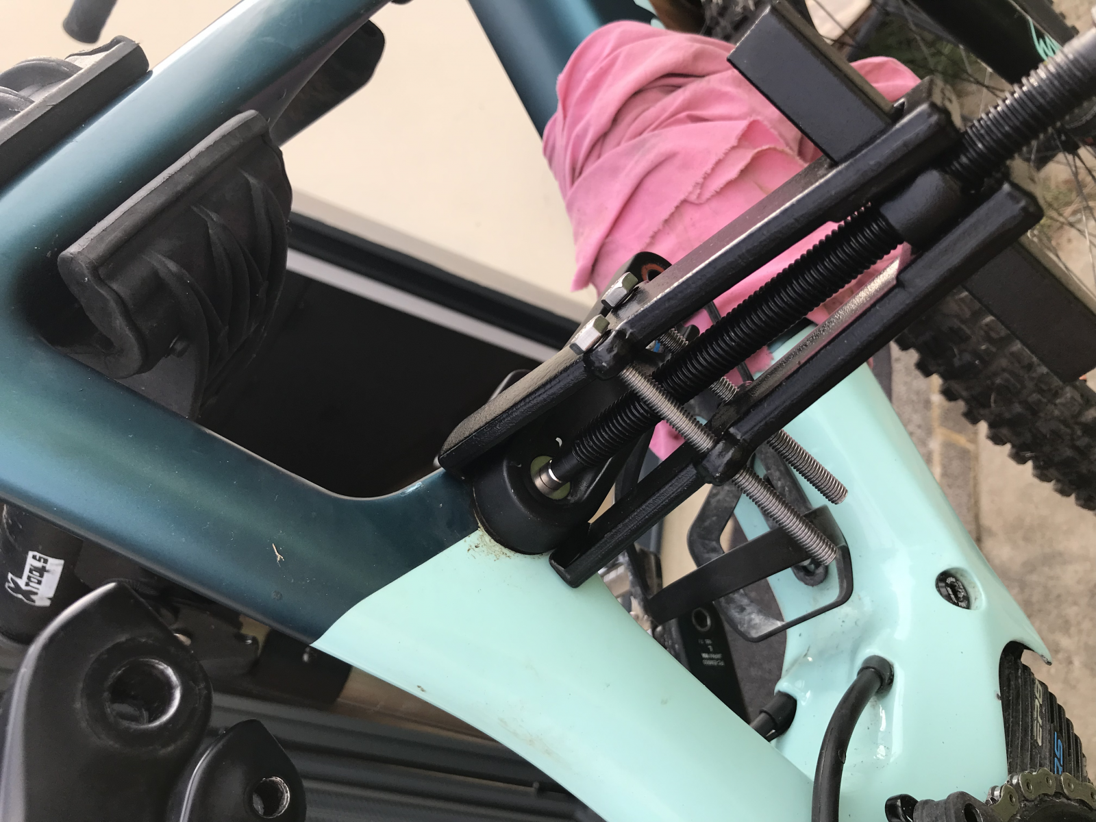

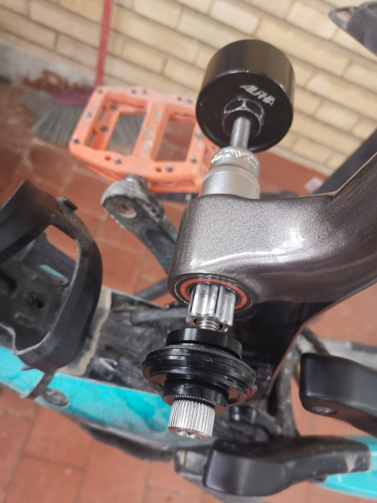

Has anybody changed the bearings?
Edit: is safe to seat the aluminum tube tool on the frame or is there a way to avoid paint or frame damage?
Edit2: I saw Hunting Cuvettes Neatt Press Fit BB 24mm from €19.99 instead of €24.99 is the right size to extract the bearing?
Bearing is 20mm inside diameter and 31mm outer diameter and the size of this tool if I don't get wrong is valid for 1" - 1"- 1/4" (25.4mm to 31.7mm) so is it valid?

Jene,
I‘m sorry for the late replay. I’m currently on a mountain biking road trip with some buddies. Rich is correct, you want to use a drift punch to drive each pivot bearing out of the frame. You insert the drift punch through the bearing hole on one side of the frame and drive the opposite side bearing out of the frame. Then repeat with the other side. Super easy to do but you‘ll need to hit the bearing with force to drive them out of the frame. Here is an example of a brass drift punch. Any punch will work, but I like to use a brass punch because it prevents the hardened steel metal bearing from shattering when struck by the punch.
When the time comes to insert the new pivot bearings into the frame, use your bearing press tool. I use a bearing press tool similar to the one pictured below. The upper frame pivot bearings are Enduro 6804 LLU Max Black Oxide bearings. You will need two. One last note of caution. Make sure the bearings are inserted and pressed straight and true when you press them into the frame. If the bearings become cocked and off angle when pressed, they may damage the carbon frame.

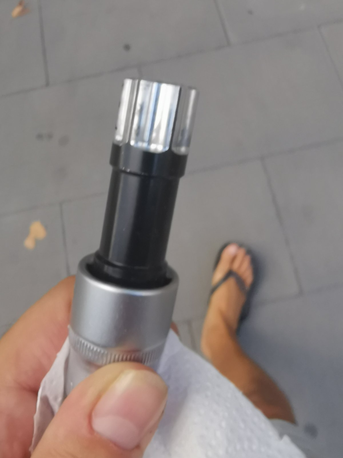

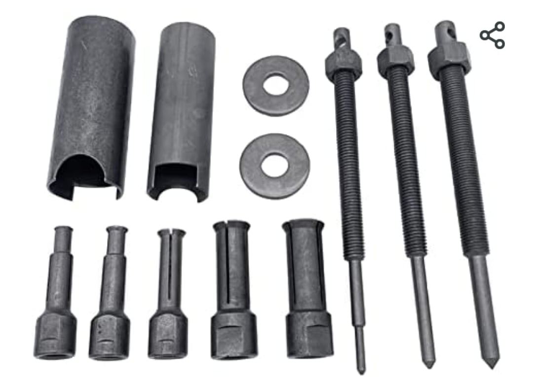

Edit: I finally extracted the bearings with a shafter.
I've bought a tool to assembly/ disassemble blind bearings. It has a cilinder to seat in the frame... I guess it's not another way to mount the bearings isn't?
By the other hand, I see that loctite 638 is the most used to retain the axle but I can't buy it here. Anybody knows another brand to buy it in Europe?
I could afford loctite 271 but it's quite difficult to disassemble

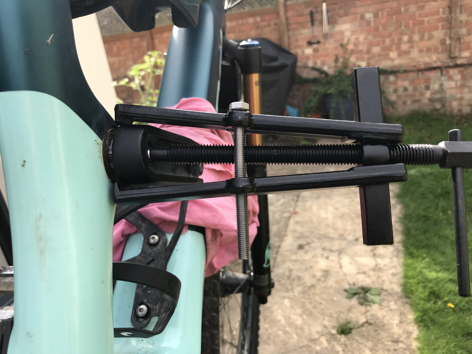

Hi
Not sure where you live, I'm from the UK, you can purchase from both eBay or Amazon with next day delivery.
Hope this helps. Alan

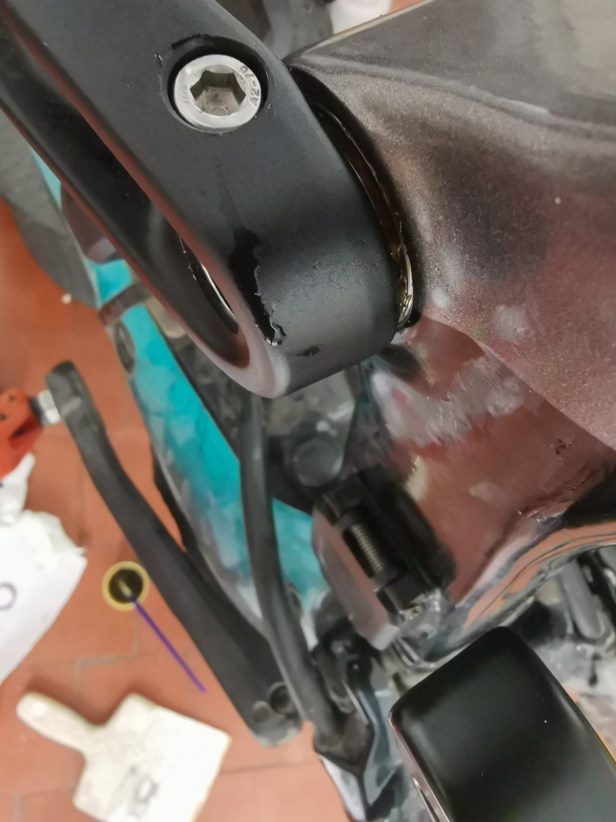

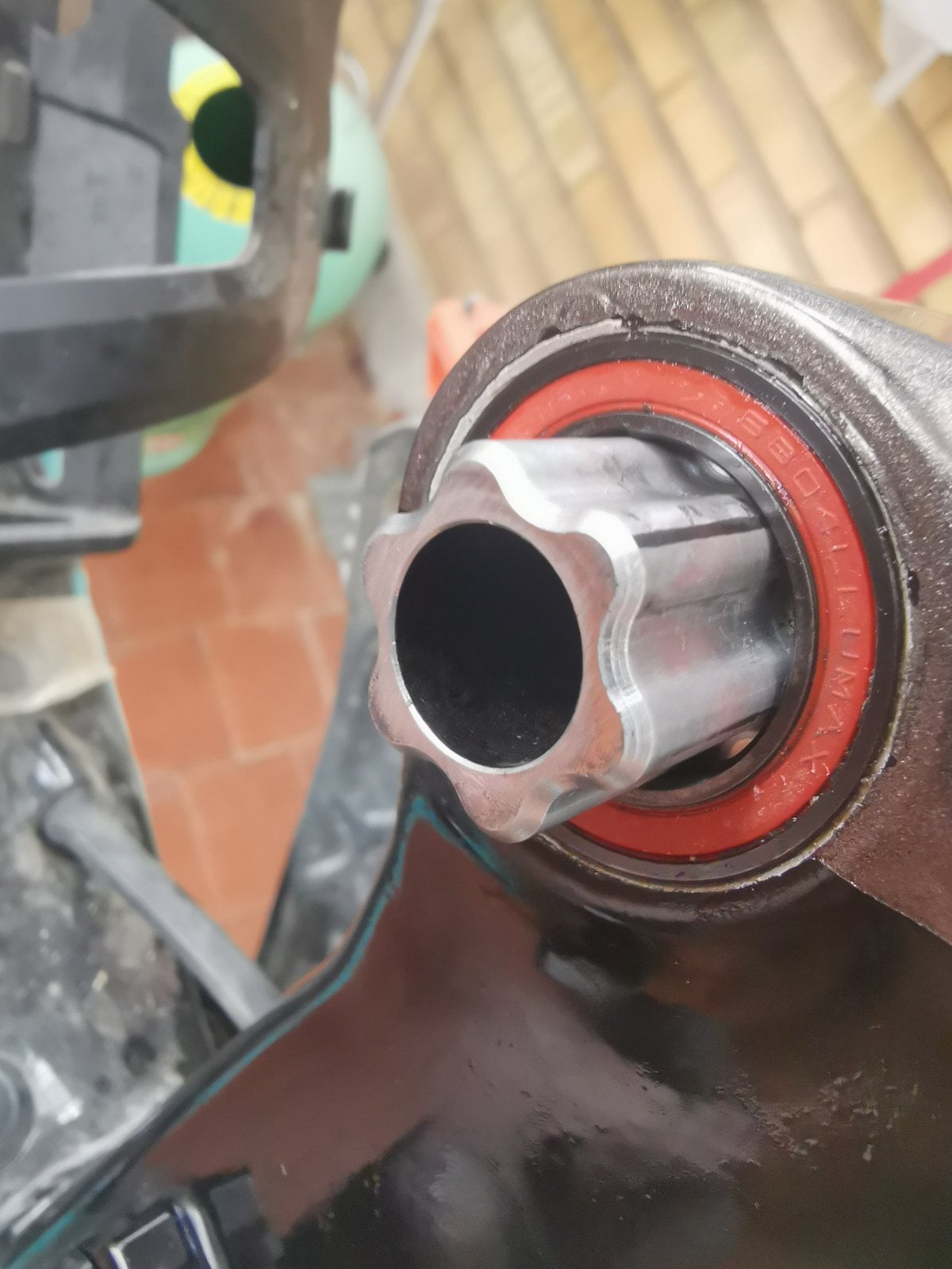

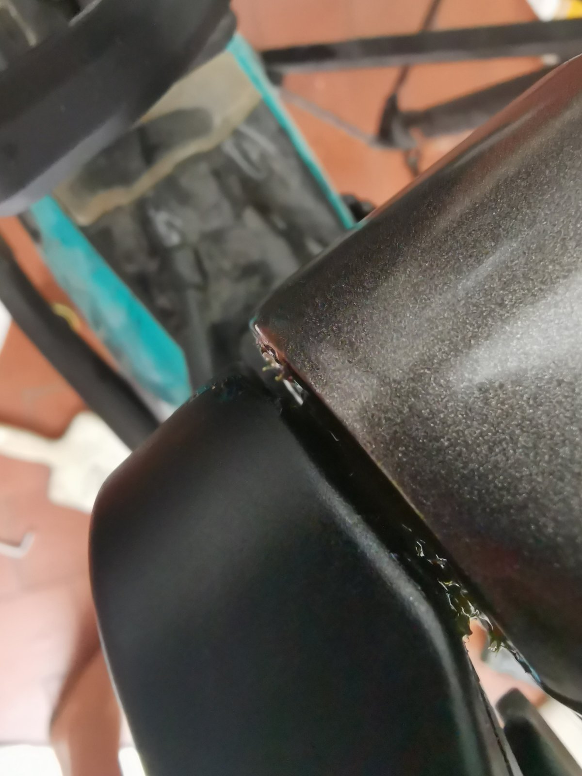

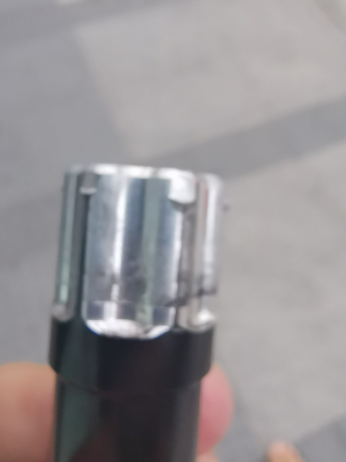

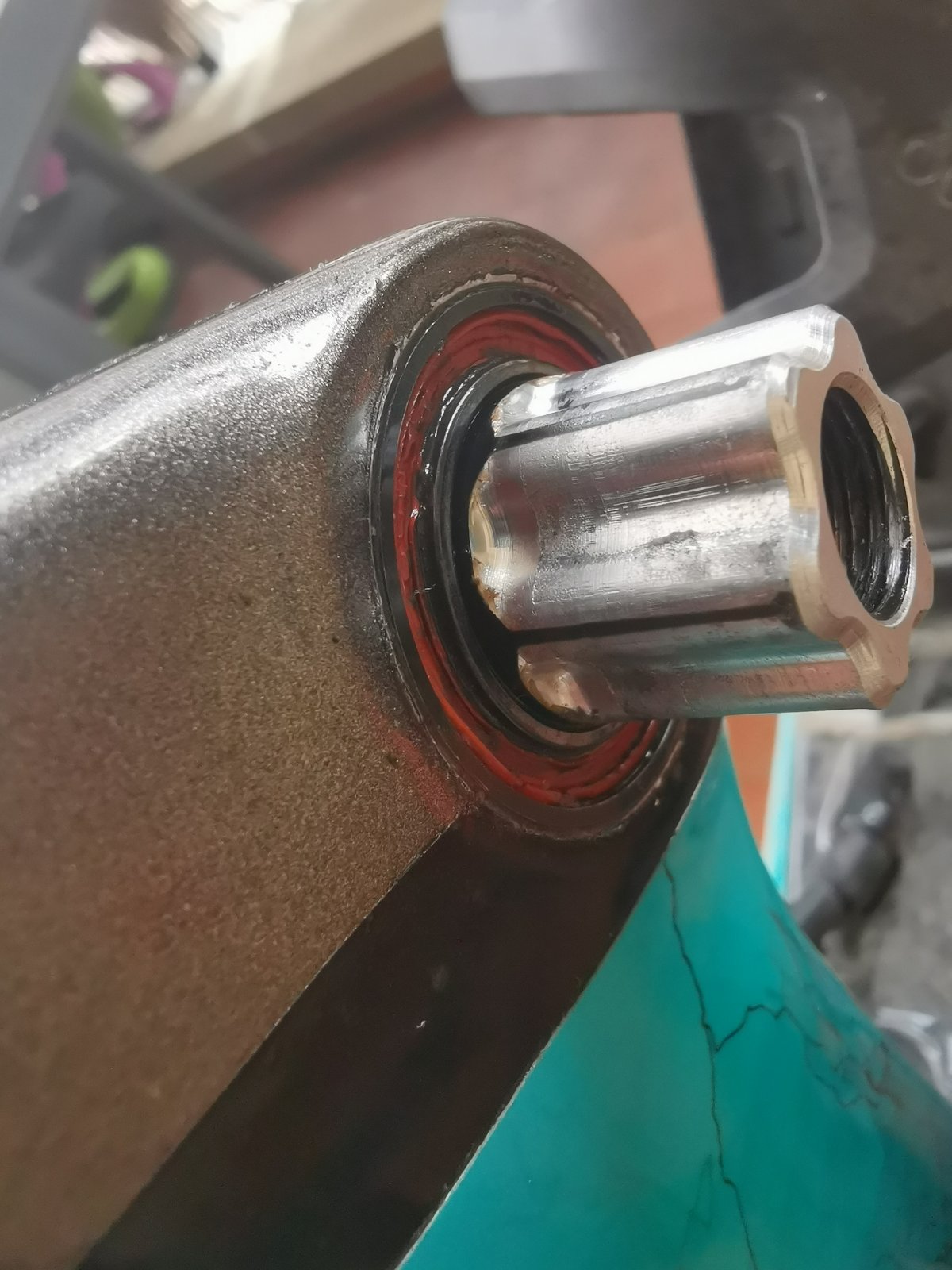

I finally give it up 😑
From the left side, the axle is not inserted completly until the end. There's some room between the left arm and the frame and despite of hitting the arm with a plastic hammer, there's one or two mm out of it should stay.
The axle is inserted correctly in the left arm spindle but the right arm despite of being in its place regarding to the frame, is not inserted completly in the arm.
Left arm:
Left space:
Besides of that, I tried to loose the left arm after put some loc638 and it's very tighten. I couldn't separate the arm from the axle so I can not extract the axle again to start from the beginning.
In my opinion, there's something wrong with the axle, it's not normal that is so tighten. It took me a lot of efforts to extract it and the same to insert it back.
Now with the arm fixed to the axle gives me in a dead road.

Jene, looking at the photographs, the gap appears correct.
When using the pre-load tool, there will always be a very small gap between the end of the axle and the linkage arm. There should be no part of the axle visible between the inside edge of the linkage arm and the frame. You have a lot of grease between the linkage arm and frame so I cannot tell in the photoif the gap is correct. If possible, you may want to wipe away some of this grease or else it will attract sand and dirt.
Let us know how you bike rides.
Cheers, Rod.

Hi Jene
This reply may help you in the future, I was also having problems removing the arms from the axle which I had secured with loc638, I used a bearing puller as shown in the attached photos, arms came off really easy. Note: washers need to be exactly 15mm outside diameter.

Hi Jene
Thanks Alan,
I apparently see in your photos that the key is the tabs of your tool. I didn't see a tool like that before. If I understood, You push the bolt and the washer while the tabs of the bearing tool is grappling the arm.
It's really a quite practical tool to have!
