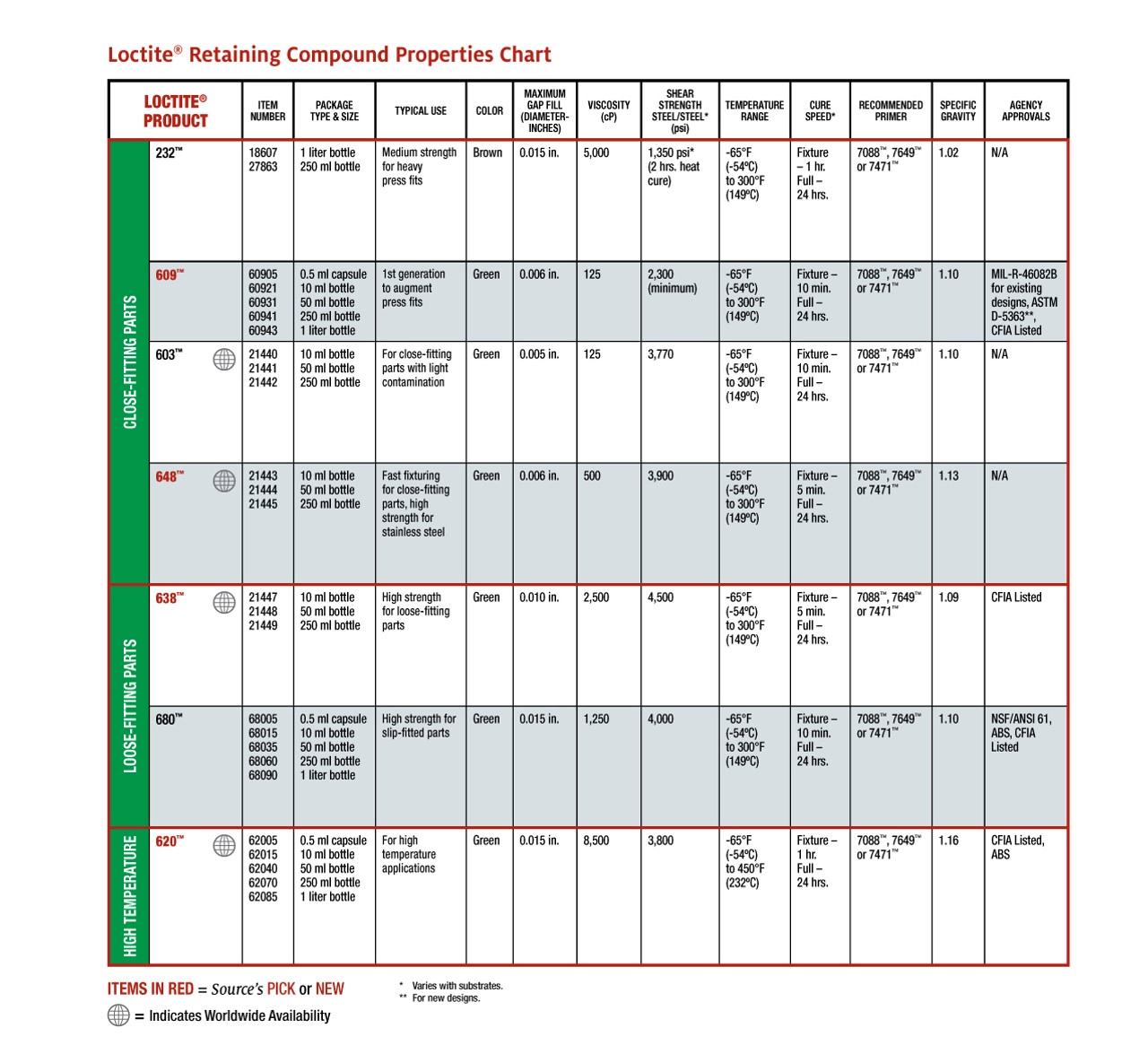

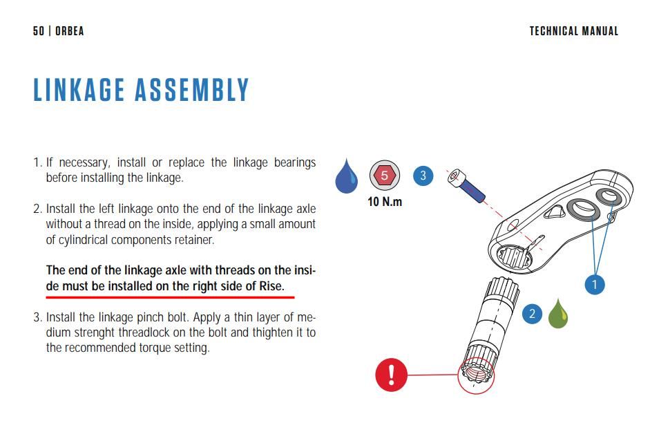

Note: Loctite 638 is made so that parts which have been assembled using Loctite 638, can be disassembled at a later date. Loctite 638 was designed for loose fitting cylindrical parts which require maximum holding power. However, Loctite 638 should not be confused with permanent thread lockers such as Loctite red which makes bolt removal difficult.

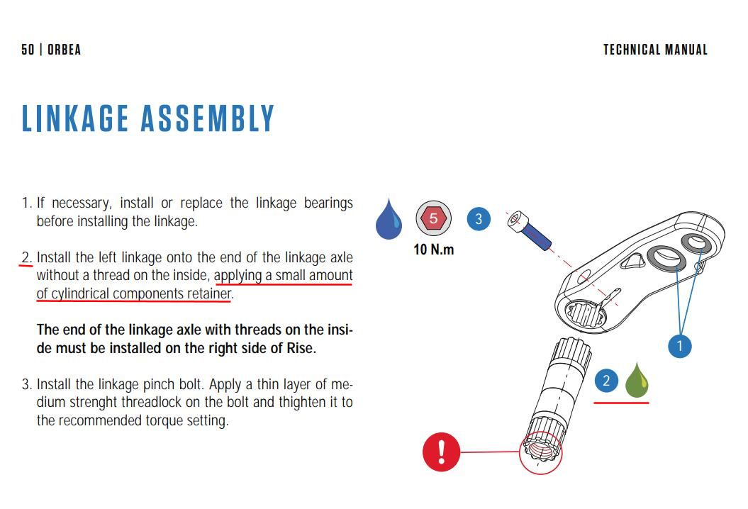

The Rise Blue Paper (Owner's Manual) specifies that a cylindrical retaining compound must be used. However, the Rise Blue Paper does not specify the type of retaining compound to be used.

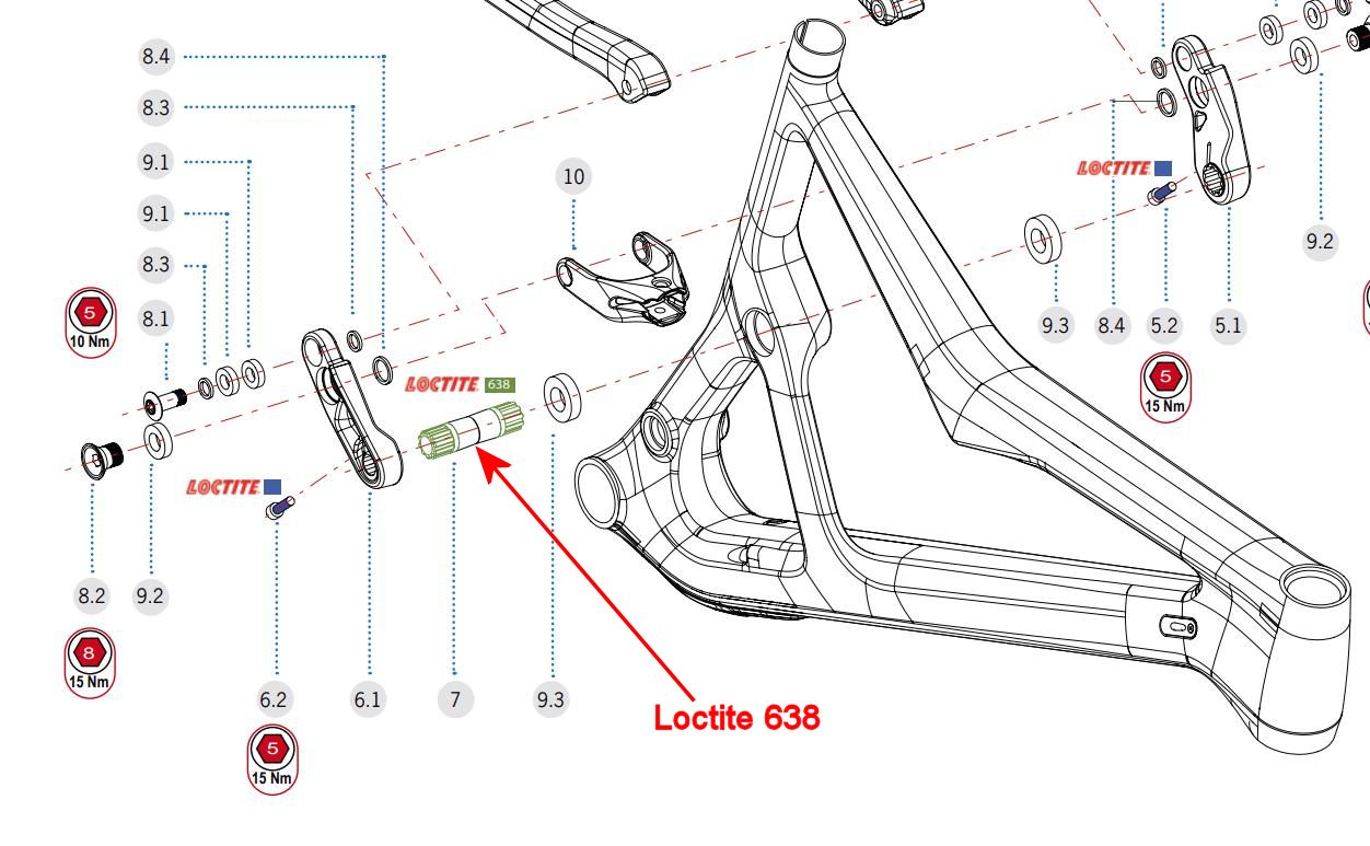

For this information, I went to the Orbea Occam Blue Paper. The Occam shares the same linkage design as the Rise. The Occam Blue Paper specifies that Loctite 638 be used on the upper pivot axle splines.

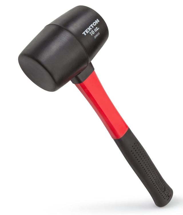

Regarding disassembling of the upper linkage after use of Loctite 638. I've found that the BFRM tool works best. Yep, Big F'n Rubber Mallet......All joking aside, I like to use a soft black rubber mallet so it won't damage or mar the finish on the linkage arms during disaasembly.
Tekton 16 oz. soft rubber mallet, $13 on Amazon.

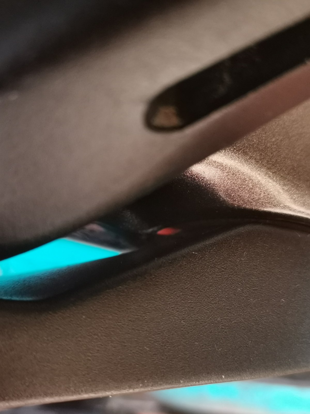

I'm not be able to loosen the upper axle 😭😭 I used a rubber mallet and hit it with a strength (not the most) in the left or right side but it was really impossible. Neither using the mallet nor using one arm to loosen it or applying heat. Anybody used the preload tool to loosen it?
Bearings are completly seized in the axle after 700km. The bearings of this part are pretty exposed to dust and water. Some cap or something would be a better design. The orange track of the bearing is quite visible in the photo.
BiGJZ74
Mar 17, 2021
574
444
American Canyon, CA
Bearings are completly seized in the axle after 700km. The bearings of this part are pretty exposed to dust and water. Some cap or something would be a better design. The orange track of the bearing is quite visible in the photo. View attachment 96002
Forgive me if you've already done this but pic shows yoke still installed. First Remove Rear Shock, Seat Stay bolts, and Shock Yoke . Loosen Pinch Bolts to Main Pivot. Linkage arm to Main Axle splines are extremely loose fitting from factory. If 638 has been installed you could possibly use Preload tool threaded half way in then hit with mallet. Or hit rear (near Seat stay) of one arm in then out to create the leverage to break the 638 free. On my 18' Rallon when I upgraded the linkage it was so tight to took almost 45minutes of pushing and pulling the arm in and out to get it off the axle.....and i'm usually one of the strongest in the room

Jene - I have a stuck pivot axle and I've bought (but not yet tried) some penetrant oil at Rod's suggestion. Next time I have the linkage arms off I am going to try this. At this stage my pivot is still working ok.
jene
May 12, 2021
86
10
Zaragoza
Guys, sorry for not sharing a photo previous to mount it. I was able to disassemble arms but the axle was impossible, really tight even using a heater. Perhaps I could mount one of the arms and hit it at the end to try to loose the axle as you suggest.

When I have two metals that are stuck together, I like to use a penetrating oil such as PB Blaster, Liquid Wrench or similar. WD-40 also works but it's not quite as effective. The penetrating oil will work it's way into the interface where the axle and bearings meet and help to soften/break up the corrosion. You want to spray the penetrant and let it soak in for an hour or so. You want to give things a really good soaking.
If corrosion has occurred, your going to need to hit the axle fairly hard to break it loose. The possibility of deforming the axle exists and you may want to have a new axle on hand. You don't want to be sitting on the sidelines waiting several weeks for a new axle to arrive. I would use a ballpeen hammer and a soft wood block placed on the end of the non-threaded side of the axle. Strike the block of wood firmly to drive the axle out of the bearings. Keep on spraying the axle with the penetrating oil as you are hitting the block. The striking motion will help work the oil between the bearings and axle and the axle will come out.
If the force of the required blow becomes too much and you fear damaging the carbon frame with heavy strikes, you should consider purchasing a bearing press/puller kit such as this one found on Amazon USA. On one side of the axle, you will need to fabricate a thin walled sleeve, copper pipe, etc., that will fit over the end of the axle spline and rests only on the pivot bearing and not the frame. Using the bearing press, you can then drive the axle out of the bearings.
